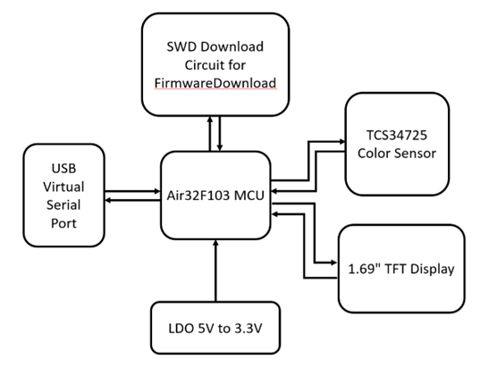

II. Overall Design Block Diagram
The following is the system block diagram of the color measurement system:
Figure 2 Color Measurement System Block Diagram
The entire system block diagram shows the communication between the Air32F103 microcontroller and the TCS34725 color sensor via the I2C interface, and integrates a 1.69-inch color TFT display screen, a USB virtual serial port, an SWD download circuit, and power supply and LDO circuits.
1) TCS34725 Color Sensor: Senses ambient colors and transmits raw data to the Air32F103 microcontroller via I2C interface.
2) 1.69-inch Color TFT Display: Receives color data from the Air32F103 microcontroller via SPI interface and displays it on the screen. Provides a user-friendly interface and real-time display of color measurement results.
3) Air32F103 Microcontroller: Receives color data from the TCS34725 sensor via I2C interface, performs data processing and analysis. Simultaneously, it communicates with the TFT display via SPI interface, sending processed data to the TFT display for real-time display.
4) USB Virtual Serial Port: Connects to a computer via USB interface, providing users with an interface to communicate with the system. This allows monitoring of system operation via computer and sending and receiving necessary serial communication data.
5) SWD Download Circuit: Provides an SWD interface for firmware download and debugging. During development, the firmware on the Air32F103 microcontroller can be easily updated and debugged via the SWD interface.
6) Power Supply and Low Dropout Regulator (LDO) Circuit: Used to provide stable power to the TCS34725 color sensor, Air32F103 microcontroller, and screen to ensure their normal operation.

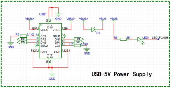

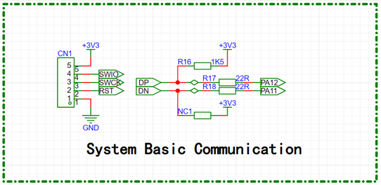

For the Type-C surrounding circuit, pins CC1 and CC2 are grounded via a 5.1KΩ resistor. After connecting to the PC via the data line, the device is selected as a SLAVE (slave) device. A reverse polarity protection diode is placed between the USB input positive voltage and the onboard positive voltage to ensure circuit safety. DP and DN differential data lines are led out as USB virtual serial communication lines. An LED and a current-limiting resistor are connected between VBUS and a pin of the microcontroller for convenient system operation, debugging, and visualization.
Figure 2 shows the circuit design surrounding Type-C.
        For the basic communication circuit, an SWD download circuit debugging interface is brought out. The DP and DN differential data lines of Type-C are connected to the PA11 and PA12 pins of the microcontroller through a 22Ω resistor, and the DP data line is pulled up through a 1.5KΩ resistor to realize the hardware circuit application of USB virtual serial communication.
Figure 3 shows the basic communication circuit design

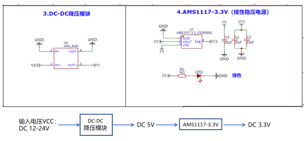

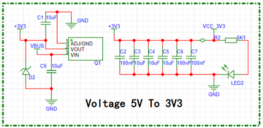

. For the power supply and low dropout regulator (LDO) circuit, the commonly used 3.3V low dropout linear regulator AMS1117-3.3 chip is selected as the 5V to 3.3V power supply and low dropout regulator. This chip is inexpensive and has stable performance, with overvoltage protection, which helps to prevent damage to the system from sudden increases in external voltage. Three sets of 10uF and 100nF capacitors are placed between the 3.3V forward voltage and GND. These are planned for the forward voltage input pins of the onboard microcontroller chip, color recognition sensor, and TFT display driver. This reduces voltage ripple generated during wiring, lowers power supply noise, stabilizes the power supply voltage, minimizes interference to the chip, and provides a reliable operating environment for each component. This is crucial for accurate measurement by the color sensor and stable operation of the microcontroller.
Figure 4 shows the power supply and low dropout regulator (LDO) circuit.

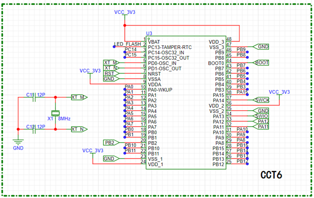

For the microcontroller chip's peripheral circuitry, considering the operating frequency requirements of LVGL and FreeRTOS, the microcontroller's internal 8MHz high-speed clock cannot meet the minimum operating requirements. Therefore, an external crystal oscillator is connected to the clock input pin of the Air32F103 microcontroller to provide a stable clock source. The Air32F103's clock source is divided by a PLL to obtain different system clock frequencies. All external pins of the Air32F103 microcontroller are brought out for connection to various peripherals, such as GPIO, USART, SPI, and I2C, configured according to application requirements.
Figure 5 shows the peripheral circuitry

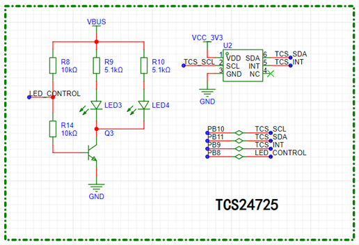

        for the TCS34725 color sensor. A 3.3V supply provides the operating voltage for the TCS34725 sensor. The sensor uses an I2C interface for data communication, with SCL (clock line) and SDA (data line) connected to the corresponding microcontroller pins. The microcontroller's LED_CONTROL pin is connected to a white LED via an NPN transistor, controlling the LED to provide illumination in poor lighting conditions, facilitating normal color signal acquisition by the TCS34725 color sensor.
Figure 6 shows the peripheral circuitry for the TCS34725 color sensor .

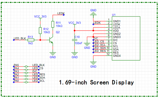

For the 1.69-inch color TFT display screen, the peripheral circuitry mainly involves power supply, display control, and data communication. To ensure a stable operating voltage for the 1.69-inch TFT display screen, a 3.3V power supply pin is connected according to the display screen's specifications; the microcontroller's SPI pins (MOSI, SCK) are connected to the corresponding SPI pins of the TFT display screen. The SPI clock frequency is set correctly and is compatible with the display specifications. Connect the microcontroller's GPIO pins to the corresponding control pins (Chip Select, Data/Command, Reset) of the TFT display. These pins are used to control data transmission, chip selection, reset, and other operations. Connect the microcontroller's GPIO pins to the TFT display's backlight control pins to adjust the backlight brightness.
Figure 7 shows the peripheral circuit of the 1.69-inch color TFT display.

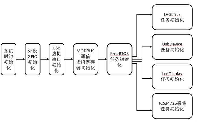

IV. Program Flowchart
The color measurement system based on the TCS34725 color recognition sensor involves the software architecture of TCS34725 color acquisition, implementation of automatic gain control based on a sliding window AGAIN, LVGL display, USB virtual serial port implementation for communication with the PC based on the MODBUS protocol, MODBUS protocol virtual register implementation, and FreeRTOS system porting. The software code architecture is described in two parts below.
Figure 8 shows the software initialization of the color measurement system.

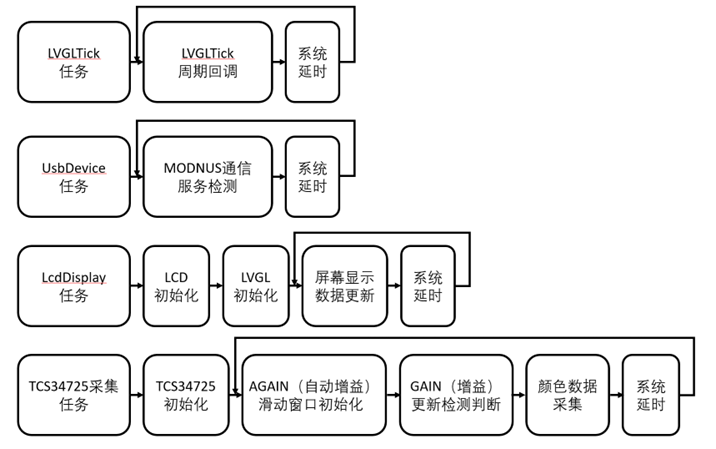

First, the system performs a power-on reset and RCC clock tree frequency division initialization to provide suitable operating frequencies for various peripherals and the system. Next, it initializes the GPIO parameters of the peripherals, including input/output modes, output speed limits, and whether pull-up/pull-down switches are enabled. Then, it initializes the USB virtual serial port and MODBUS communication virtual registers, allowing the PC to access the microcontroller's color and gain virtual registers generated by the color measurement system via the USB virtual serial port and MODBUS protocol, and read the values. Finally, it initializes the FreeRTOS tasks, which are divided into four threads.
The first thread is related to LVGL display refresh callbacks; the second thread is related to USB virtual serial port and MODBUS communication; the third thread is related to display data refresh; and the fourth thread is related to TCS34725 color acquisition.
Figure 9 shows the color measurement system's running code architecture .
After the color measurement system completes its functional initialization, it runs the FreeRTOS system, executing tasks in a multi-threaded manner. The first thread handles LVGL display refresh callback tasks, periodically calling the `lv_tick_inc(LVGL_TICK)` function to obtain the LVGL running clock. The second thread handles USB virtual serial port and MODBUS communication tasks, periodically calling the `RS485_Service()` function to process serial data, identify the MODBUS communication protocol, and respond to the PC. The third thread handles display data refresh tasks, calling the `lv_table_set_cell_value_fmt()`, `lv_led_set_color()`, and `lv_bar_set_value()` functions to update the display data. The fourth thread handles TCS34725 color acquisition tasks, periodically calling the `adjust_gain(rgb, &brightness_window)` and `TCS34725_GetRawData(&rgb)` functions to determine AGAIN automatic gain control and acquire and process color data.

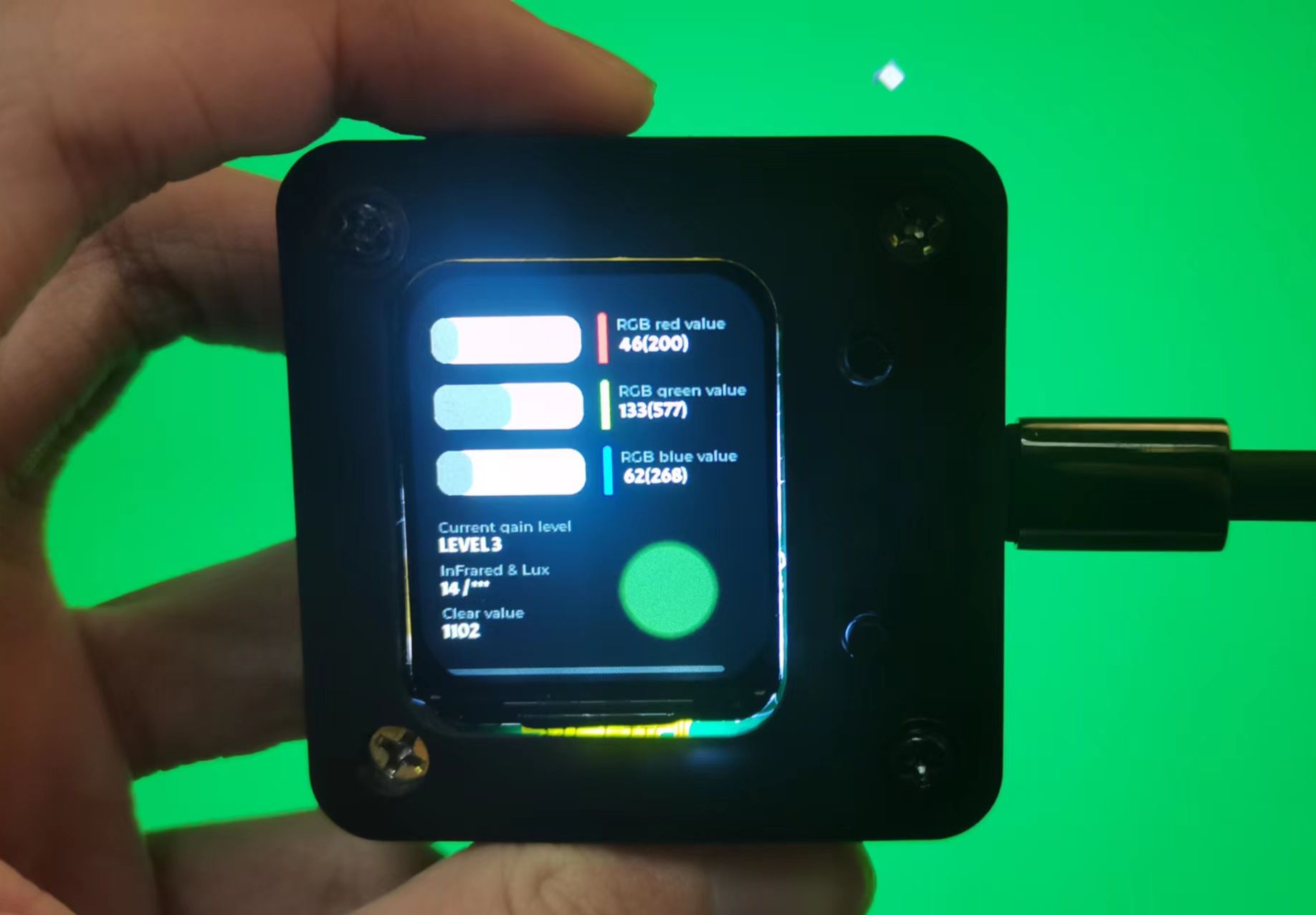

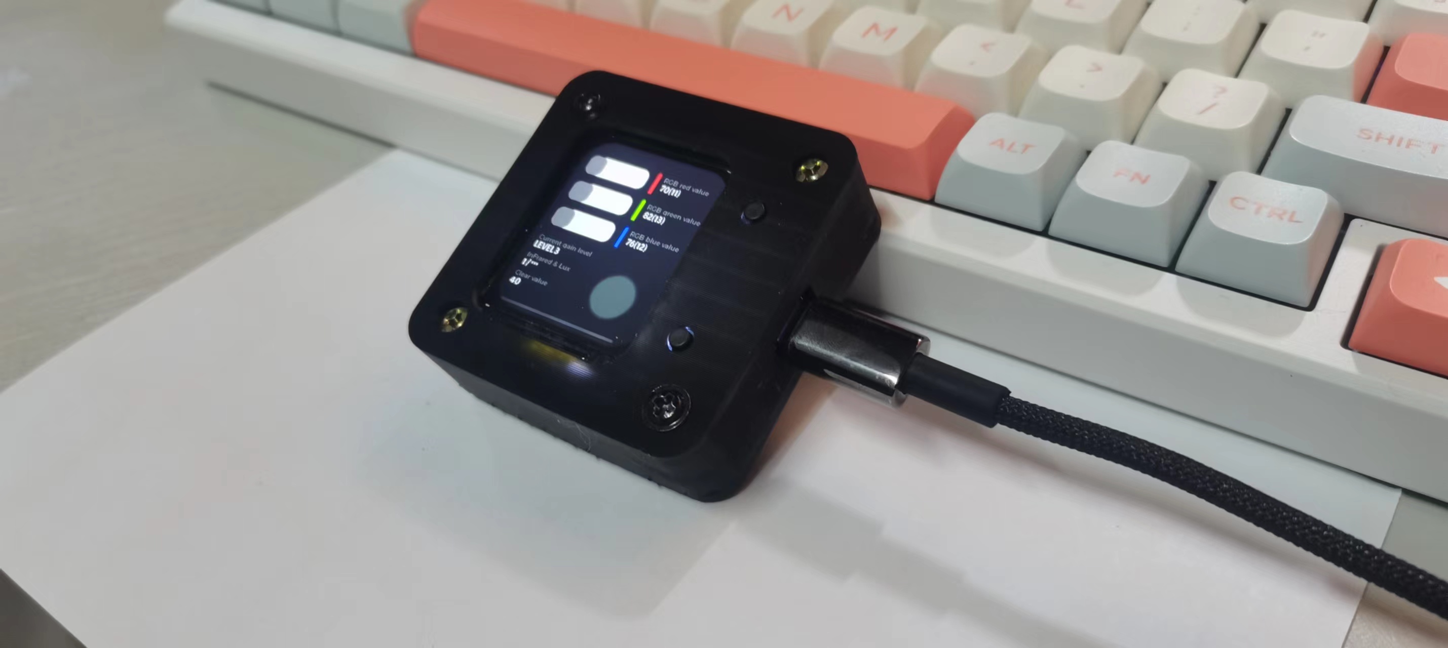

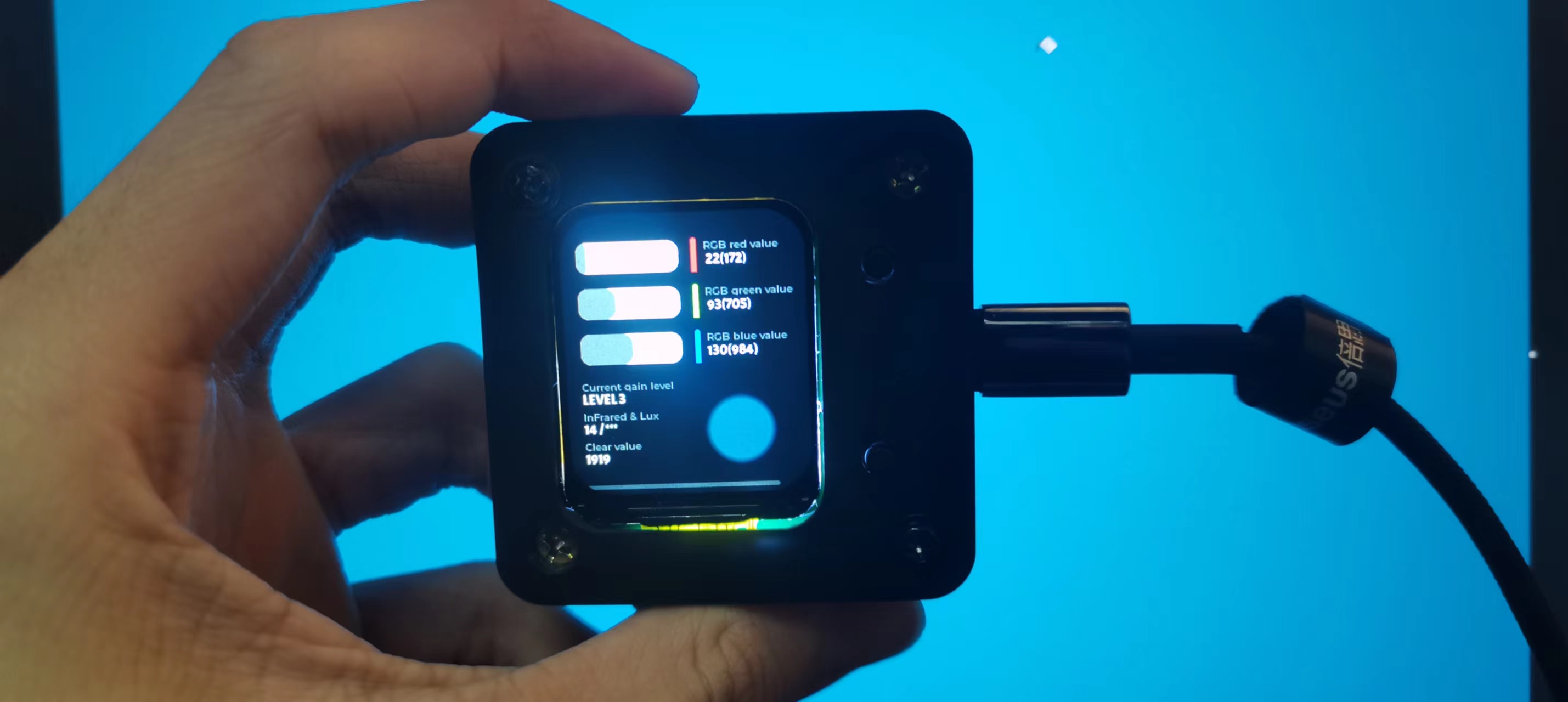

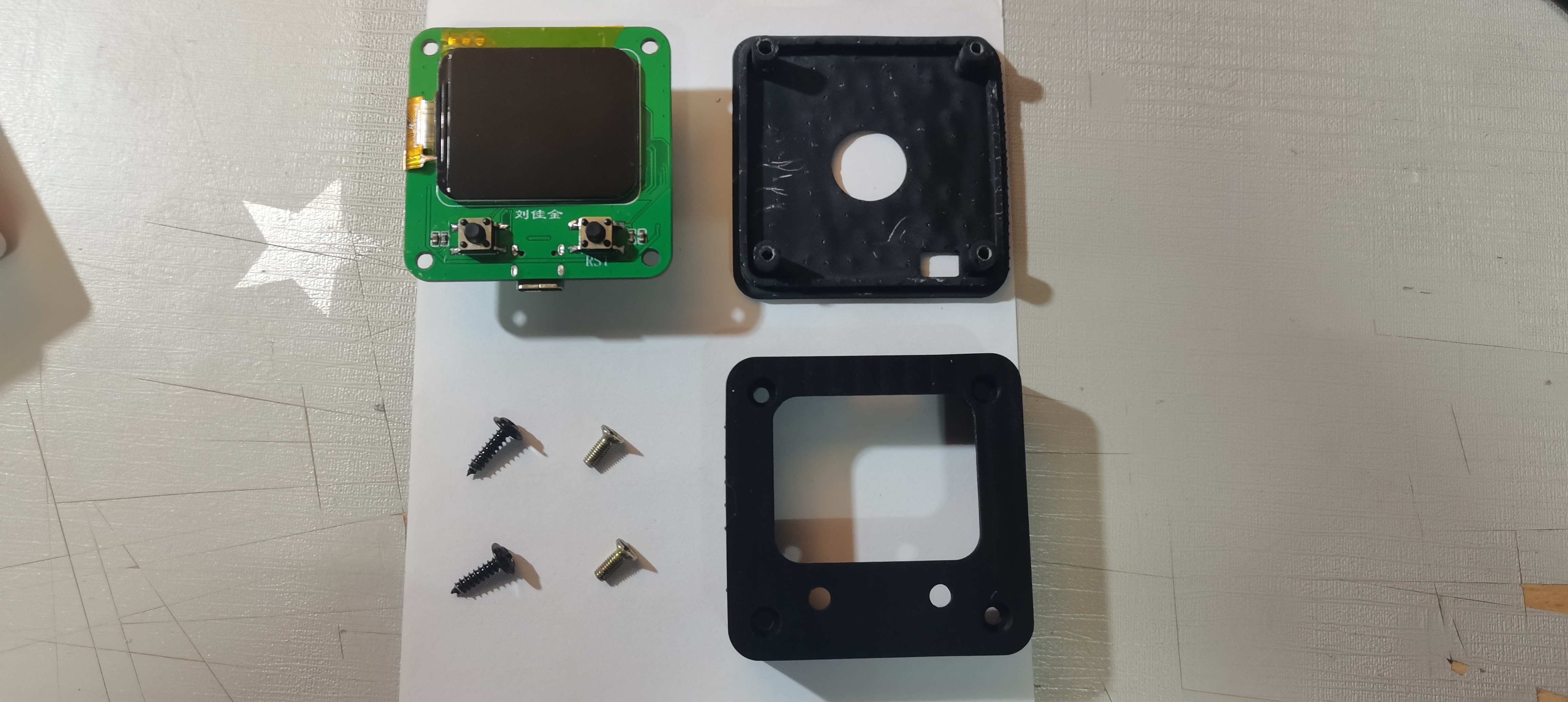

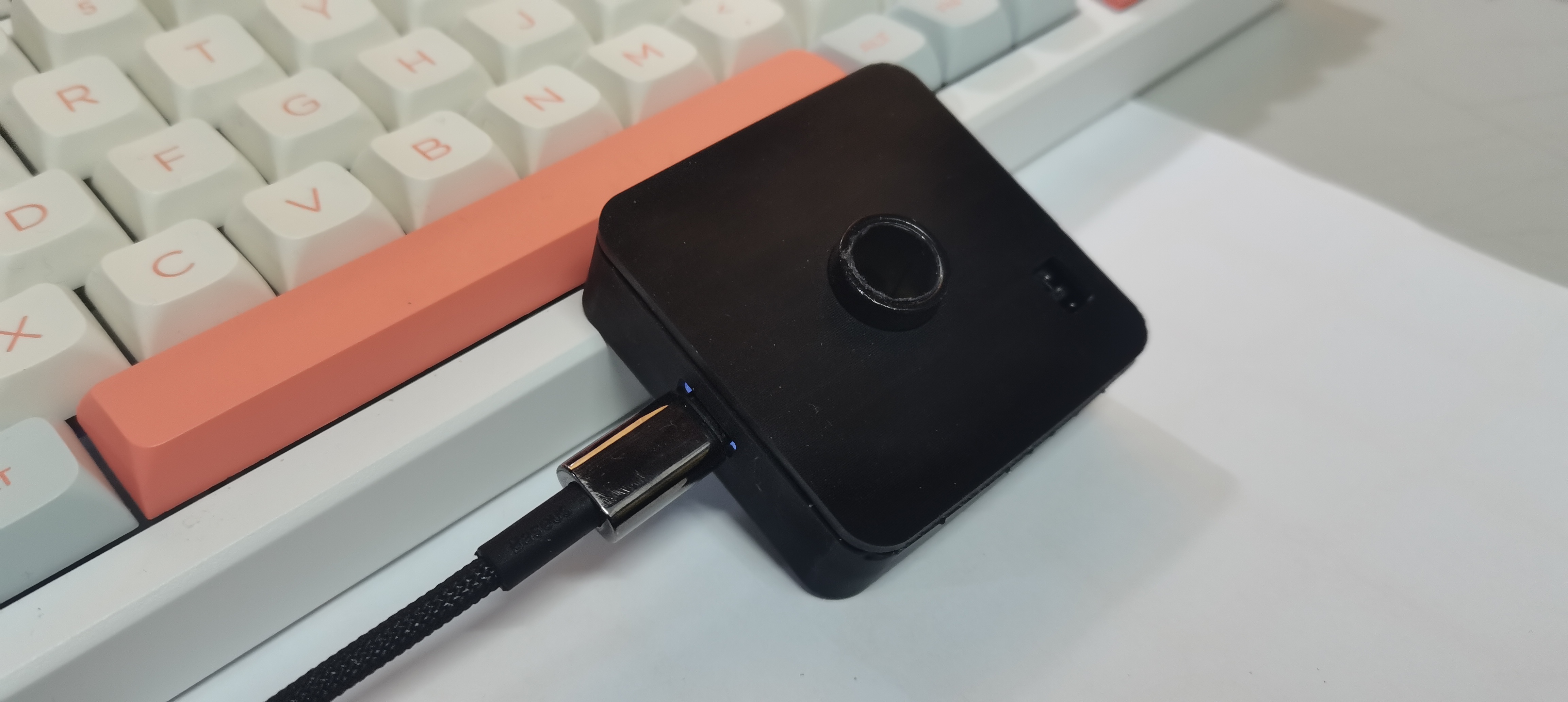

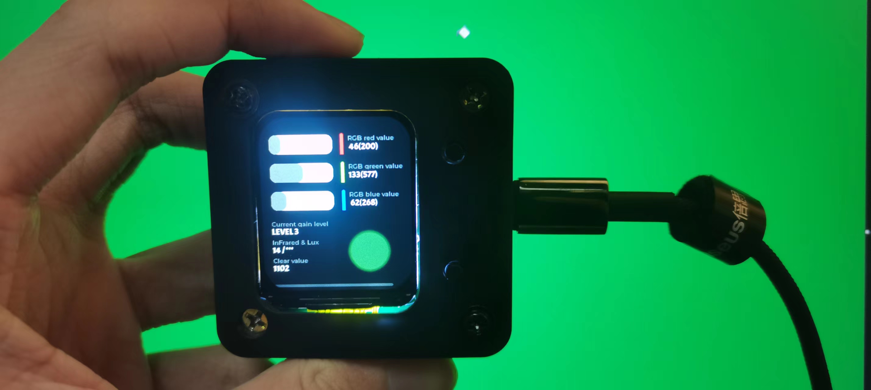

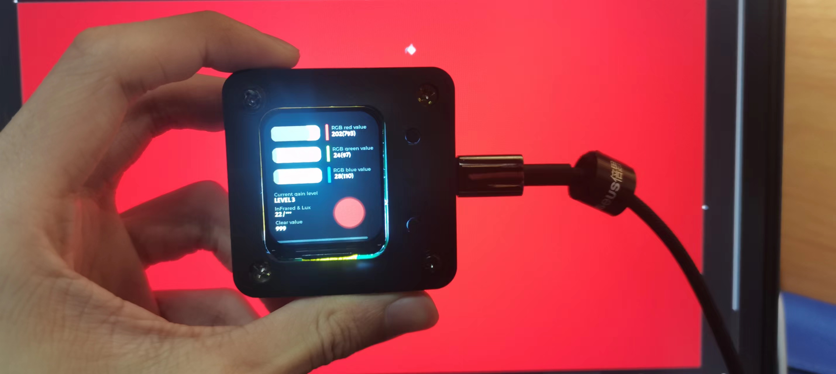

V. Physical Demonstration
VI. Notes
The source code I provided may differ slightly from the code architecture section in this article. The code architecture in this article is the best I could come up with after completing this small project and writing all the code. I haven't had time to modify the source code yet.
VII. Demo
Video I don't know how to upload a demo video, so I'll just post a few pictures here (I spent a long time tweaking the code).

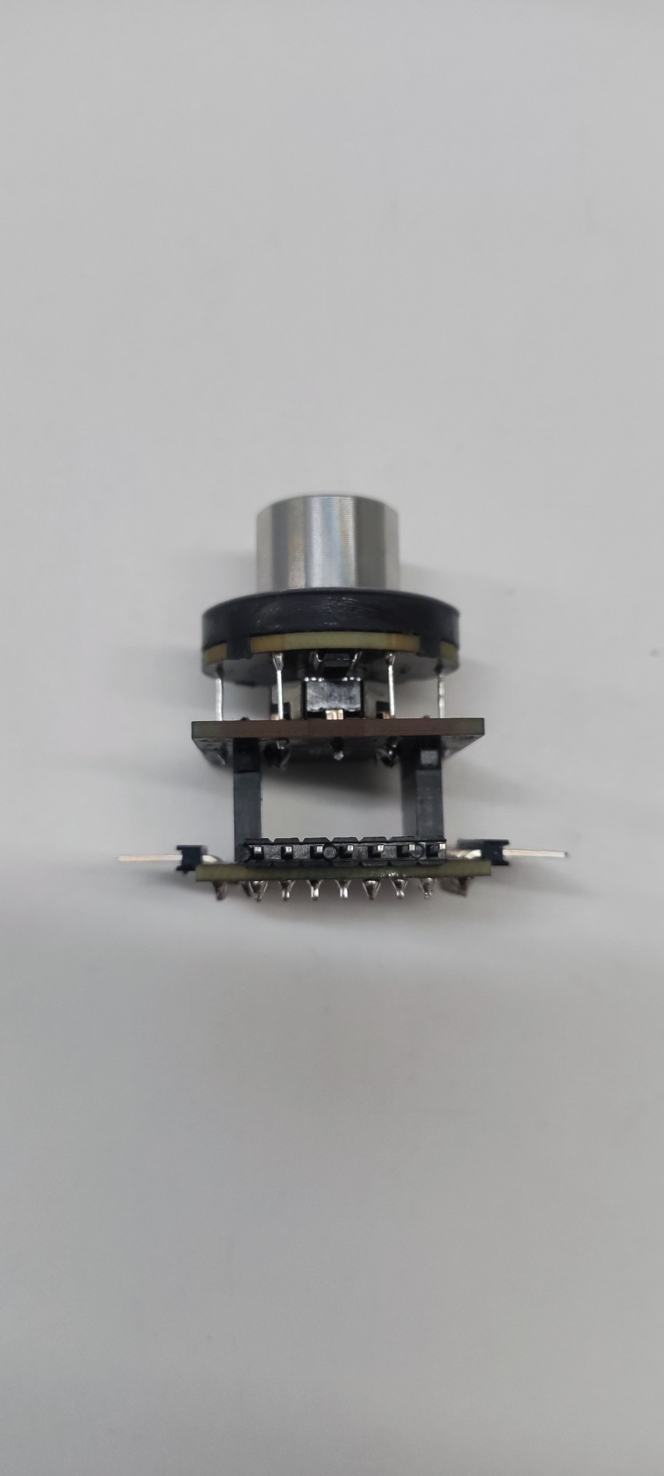

LED Encoder
The LED encoder
includes LED rings, schematics and PCB layouts of the upper and lower boards,
and the program's HEX file.
Project Description:
This LED encoder controls the display of an LED ring by rotating the encoder. It also provides multiple control output methods.
Open Source License
: TAPR Open Hardware License (Unauthorized reproduction prohibited).
Project Functionality:
Controls the display of an LED ring by rotating the encoder. It also provides multiple control output methods.
Project Attributes:
This is the first public release of this project and is my original work. This project has not won any awards in other competitions.
Project Progress
: Completed .
Instructions for Use:
1. Power Supply:
Connect PIN3 and PIN4 of the H2 interface to the positive power supply. The power input is 3.3-5V.
Connect PIN1 and PIN2 of the H2 interface to the negative power supply.
After power is supplied, the LED ring will light up and turn off according to the voltage of the potentiometer.
2. Mode Adjustment
: Press and hold the encoder for 3 seconds to switch modes.
After switching modes, an LED display will appear. Several consecutive lit LEDs indicate the mode.
The mode switching order is:
Mode 1 -> Mode 2 -> Mode 3 -> Mode 4 -> Mode 5 -> Mode 6 -> Mode 7 -> Mode 8 ->
Mode 1. Mode 1: Mode
1 LED display:
Mode 1 is pointer mode.
Mode 2:
Mode 2 LED display:
Mode 2 is pointer inverted color mode.
Mode 3:
Mode 3 LED display:
Mode 3 is a fan-shaped inverted color mode.
Mode 4: Mode
4 LED display : Mode 4
is a fan-shaped mode.
Mode 5:
Mode 5 LED display:
Mode 5 is a super fine-tuning mode. Mode
6: Mode
6 LED display: Mode
6 is a super meteor trail mode.
Mode 7:
Mode 7 LED display:
Mode 7 is the vehicle CAN communication mode.
Mode 8:
Mode 8 LED display:
Mode 8 is the analog encoder mode. 3. Install the upper and lower panels as shown in the diagram below. Design Considerations: 1. 3.3V power supply is recommended . 2. Minimize the number of times the upper and lower boards are plugged in and out. 3. Electrolytic capacitors need to be soldered in cases of high power supply noise. Other [LED Encoder 6 Modes Super Fine-tuning Super Meteor Trail - Bilibili] https://b23.tv/rtXNGqM [LED Encoder CAN Communication Mode Display Power-Off Protection - Bilibili] https://b23.tv/2WUQDH5 [LED Encoder Light Ring Making/Principle/Quick Start Tutorial - Bilibili] https://b23.tv/hMvm4IG

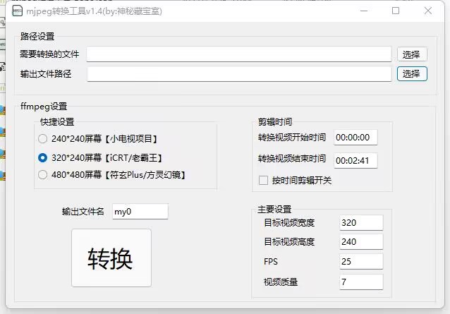

Video playback features pre-processed Mjpeg+MP3 files with synchronized audio and video
display, and JPEG files are shown.

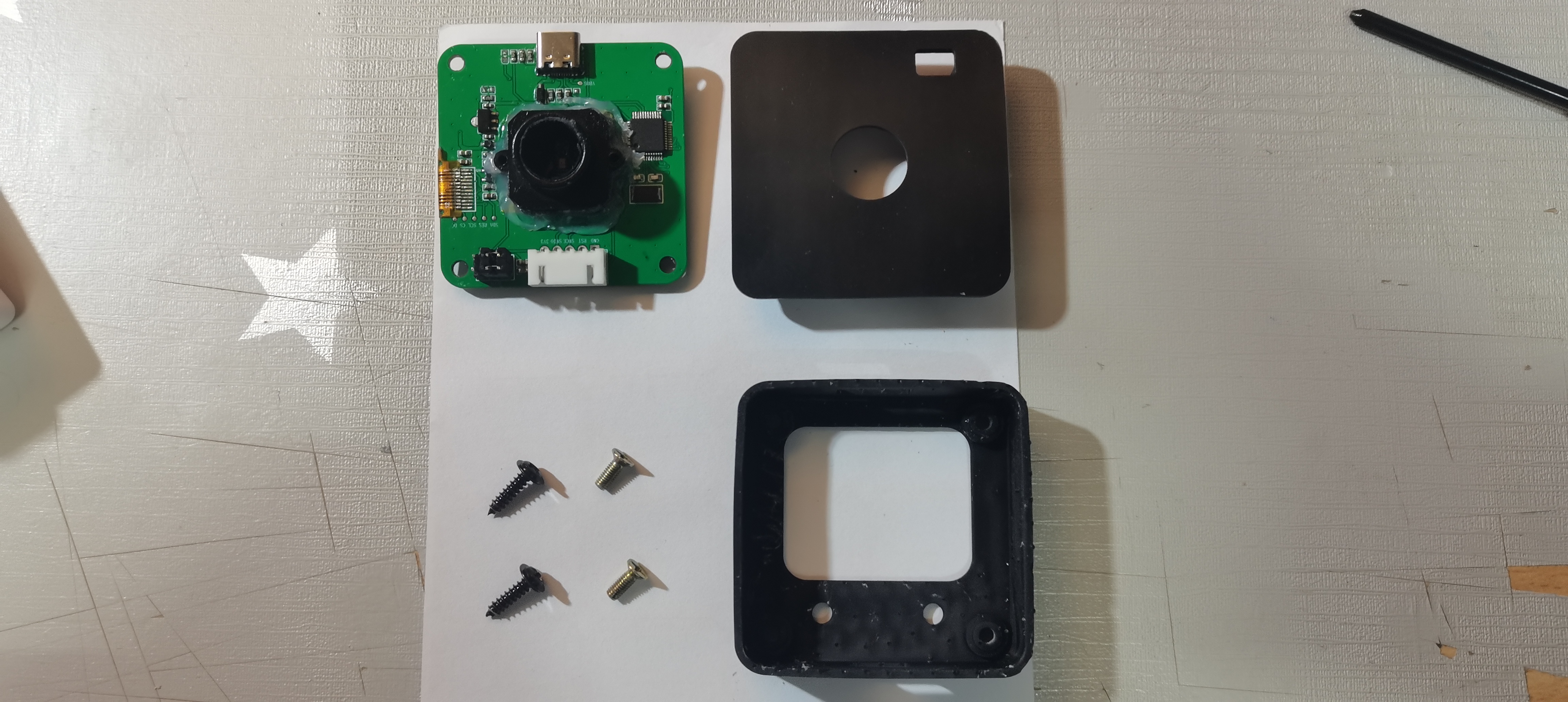

Soldering
this board is very simple (except for the MAX98357). Pay attention to the temperature of the RGB lights and the direction of the vertical FPC socket. Solder according to the direction drawn on the PCB.
The bottom pads are for the expansion dock, used to connect the speaker and extended RGB light strip on the expansion dock. The expansion dock will be updated later.
90% of the problems are caused by cold solder joints or solder bridges
The USB connector is for CH340X when plugged in correctly, and for CDC when plugged in incorrectly; both can be programmed. However, after programming with CDC, the serial port information is not visible; the default serial port information comes from CH340X.
How to determine whether it's CH340X or CDC? If the serial port name contains "340," it's CH340X; otherwise, it's CDC
. The firmware provided comes in two types: single-file version and upgrade version.
The single-file version is suitable for the first flash, flashing to address 0x0. Flashing will erase all contents, including activation code information. Single-file version filenames contain the letters "all."
The upgrade version is suitable for subsequent upgrades, flashing to address 0x10000. Flashing will not erase the settings.
Use the ESP32-S3 flashing tool in UART mode. SPI SPEED 80M, SPI MODE. The DIO firmware, speed 921600
, is available at https://pan.baidu.com/s/19-CHRh_MAejMqFVaL9os6Q?pwd=e8y5 Download here and find it in the iCRT directory. After
debugging
and burning, the serial port should show the boot information normally. If you can't see it, it means the soldering is not done properly.
Prepare a TF card, copy the directory from the directory structure provided in the cloud drive to the root directory of the TF card, insert it, and power on. You should see the picture and sound (no sound means the soldering is not done properly 98357).
Please provide the serial port information before seeking help . The AIDA64 secondary screen and weather clock of this device require network configuration.
After powering on, the device will automatically open an AP named Crt-Ap with the password 12345678. Connect your mobile phone to this AP. After a short while, a network configuration page will pop up, automatically searching for hotspots in the current environment. Select your hotspot and enter the password to complete the network configuration. Note: Some mobile phones will automatically disconnect from the hotspot and use the 5G network once they find that the hotspot cannot connect to the Internet. In this case, you need to reconnect to the AP. If the network configuration page does not pop up after connecting to the AP, you can also open it by entering 192.168.4.1 in your mobile browser. The device can be controlled through the buttons on the back and the web page. Button control: Long press to bring up the menu and confirm. Short press to proceed to the next item. Web Control: Simply click the corresponding button. In the Web Control, you can set the Gaode Map API KEY (mine is used by default), the city code (the city code is the first 6 digits of your region's ID card), and the AIDA64 host address (your computer's IP address). Activation is also in the Web Control; after providing me with the machine code, enter the activation code to complete the activation. AIDA64 : 1. Find an activated AIDA64 client (use your own). 2. Menu: [File] [Settings] [LCD], select Remote Sensor. 3. Port 80, resolution: any 1280×800, check [Enable RemoteSensor LCD Support]. 4. Click [LCD Item], click [Import] in the upper right corner, and then select the my_aida64_setting.rslcd file from my cloud drive. 5. After importing, some settings are required. Because everyone's CPU, GPU, motherboard, hard drive, network card, etc., are different, please set them one by one. 6. Note: Absolutely do not modify the text "Show" in the "Show Label". "unit" must be entered as "^" (without quotes), otherwise the device will not be detected. 7. After all modifications are complete, click OK, then minimize AIDA64. You can set it to start automatically on boot in the settings. (Settings, General, Run AIDA64 at Windows Startup) 8. Access the iCRT's IP address via a web browser. In the "Secondary Screen Host Address" field at the bottom, set your computer's IP address (the IP address of the computer running AIDA64), and then save. If port 80 is already in use, you need to add a colon after it and specify the custom port. For example: 192.168.0.100 uses the host address 192.168.0.100, defaulting to port 80; 192.168.0.100:9223 uses the host address 192.168.0.100, using port 9223. Note that the colon is an English colon… 9. Allow AIDA64 to access the network via the firewall, or manually open TCP port 80 (or a custom port). This is important! After setting this up, switch iCRT to the AIDA64 window to display computer status information. Music spectrum display has automatic gain control enabled by default, meaning the device dynamically adjusts the gain based on volume to display a better spectrum. You can disable dynamic gain in the web page and fix it to a specific gain. Having this next to your music player is great, trust me. Weather can be used by configuring the city code in the web page. If possible, you can also register your own Gaode API KEY and enter it. Temperature and humidity are displayed as two numbers, representing the temperature and humidity from the device's sensors and the Gaode weather data, respectively. The device temperature will exceed the current ambient temperature by a few degrees (this is unavoidable, as it generates heat). (A bright moon on a clear night is best viewed). For MJPEG playback , process the video using the following FFMPEG command, rename it to my0.mjpeg, my1.mjpeg, etc., and copy it to the custom directory on the TF card. To play audio synchronously, the audio file name should be the same as the mjpeg file name (my0.mp3, my1.mp3). ….)
`./ffmpeg -i your_video_file_name.mp4 -vf “fps=25,scale=-1:240:flags=lanczos,crop=320:240:(in_w-320)/2:0” -ss 00:00:13 -t 00:02:18 -q:v 7 my0.mjpeg` `
./ffmpeg -i your_video_file_name.mp4 -ss 00:00:13 -t 00:02:18 -b:a 128k my0.mp3`
Note that the `-ss` part is for editing; remove it if you don't need to edit.
Update: A simple conversion tool is provided in the cloud drive, written by Mysterious Treasure Room
It renames 320×240 JPEG files to p0.jpg, p1.jpg, p2.jpg, etc., and places them in the pic directory of your TF card.
Q&A:
If you purchased from the workshop, Huangyu (a second-hand marketplace), or a friend, all functions will be activated and tested before shipment, so there will be no hardware problems. The following applies to self-driving cars:
Over 90% of problems are due to poor soldering or solder bridging in modules, chips, etc. Please carefully check with a macro lens or mobile phone camera. The following assumes that improper soldering is ignored.
Q: Serial port not found A: Use a multimeter to check if the module is powered on normally at 3.3V. Also check the power supply of the CH340 chip.
Q: Unable to flash firmware A: Same as above.
Q: Screen not lit or displaying a distorted image A: Check if the ribbon cable is plugged in backwards or if there is backlighting.
Q: No sound, popping sounds, or white noise A: This is difficult to solder; it's usually due to improper soldering of the 98357 chip. Of course, if you mute the device in the settings, there will also be no sound.
Q: TF card initialization failed. A: The card is broken or the directory is incorrect.
Q: RGB LEDs are not lit. A: The LEDs are damaged by overheating.
Q: Microphone cannot pick up audio. A: There may be solder bridging at the bottom.
Q: Unable to access AIDA64.
A: Enter your computer's IP address in your browser's address bar to see if you can open the AIDA64 webpage. If you cannot open it, it's most likely that port 80 is occupied. Please set another port. For
other issues, please join the group for consultation: 739444215.

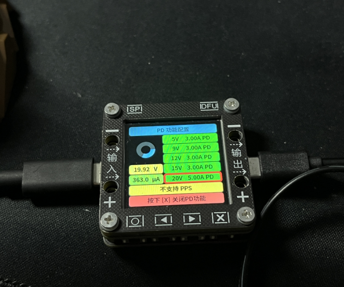

"Potato Mine Bomb" - Based on Zhirong SW7201 bidirectional fast charging
This portable backup power supply, based on the Zhirong SW7201 high-efficiency bidirectional buck-boost charge/discharge controller, was created as an April Fool's Day project in 2024. Its outer casing resembles the potato mine from Plants vs. Zombies, but it's actually a portable fast-charging power bank.
      The SW7201 is a high-efficiency synchronous 4-tube bidirectional buck-boost charge/discharge controller that supports charge/discharge management of 1-4 batteries, supports I2C control, and can provide a maximum power output of 100W. This project uses the SW7201 as the lithium battery management chip and the HSUB238 PD decoy chip to fast charge the lithium battery. It can also output 20V5A/100W of energy, enabling charging of electronic products such as laptops and mobile phones when you are out and about.
     SW7201 Chip Introduction:
 High-Efficiency Buck-Boost Switching Charge:
➢ Supports buck-boost charging of 1 to 4 lithium batteries, including complete charging cycle management
➢ Supports 3V-19.2V charging target voltage setting, supporting various types of lithium batteries
➢ Supports 100W input power
➢ Supports 4V-24V input voltage
➢ Supports I2C programmable control of input/battery current limiting
➢ Seamless switching between boost and buck
Reverse Buck-Boost Discharge:
➢ Supports 100W output power
➢ Supports 3V-22V output voltage
➢ Flexible selection of FB/I2C voltage regulation
➢ Supports I2C programmable control of output current limiting
➢ PFM/PWM mode automatically switches according to load size
The chip has a built-in 12-bit ADC.
The battery side uses one XT60 model aircraft interface and one DC005 interface, with reserved output pads for connecting other interfaces. The number
of lithium batteries (1-4) can be selected by configuring the BSSTT resistor on the chip; the inductor can be a high-power inductor ranging from 1 to 4.7uH, with different inductor COMP parameters corresponding to different resistors and capacitors.
Currently, four 4500mAh 21700 lithium batteries from Dongci are used as the battery terminals, and the charge/discharge rates meet the requirements.
The physical
PD decoy chip HUSB238 decoys 20V input
/output
. The accompanying video demonstrates using an electronic load to drive 60W and switching between different voltage levels. If using high-power loads for extended periods, a fan cooling system is still necessary, which will be considered for internal cooling in the future. Since there is only one color silkscreen roll, and black ink is currently being used for color printing, there is concern about wasting ink if the first printout is not done well. With successful verification, color proofing can now be enjoyed. Thanks to LCSC for their support of this event; we have gained valuable experience from this experience.
Switching voltage levels.mp4
Loading.mp4

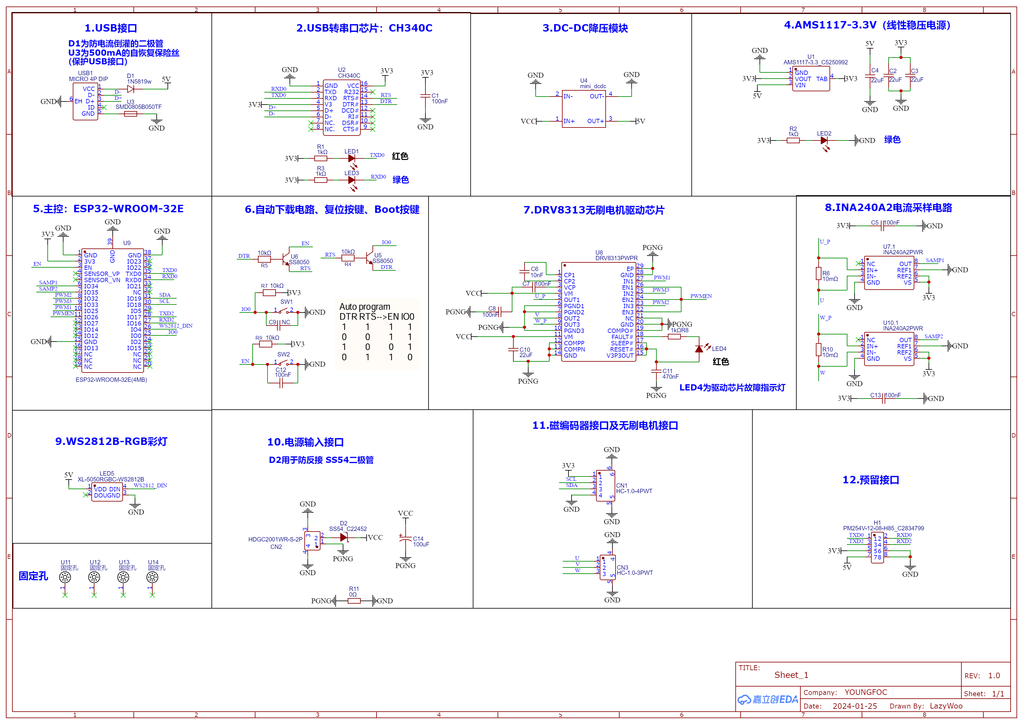

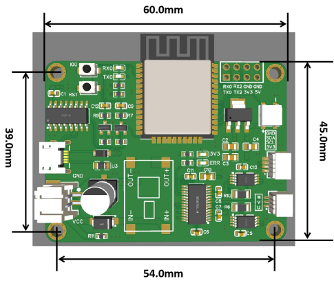

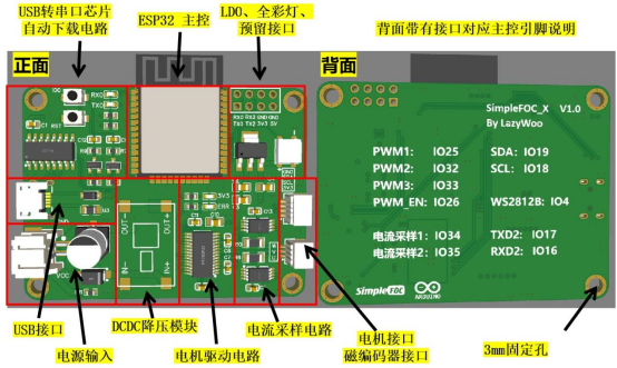

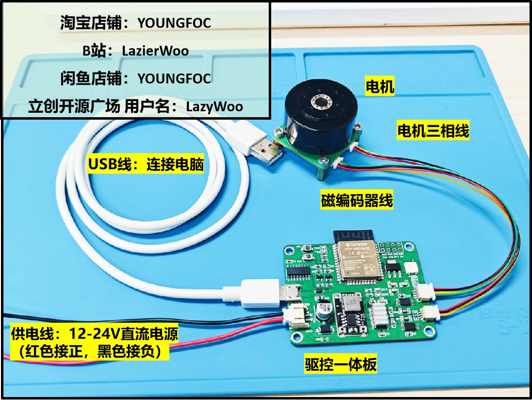

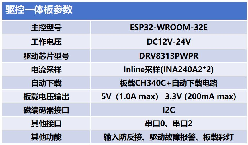

SimpleFOC_X Brushless Motor Drive and Control Integrated Board (Verified - Professional Version)
SimpleFOC_X is an open-source SimpleFOC driver and controller integrated board. It uses ESP32 as the main controller, DRV8313 integrated driver chip, INA240A2 current detection, and supports three closed-loop control: current loop, speed loop, and position loop.
1. Specifications and Specifications:
      The integrated driver board features an ESP32-WROOM-32E module with a high clock speed of 240MHz, delivering powerful performance. It includes Bluetooth and Wi-Fi, enabling various applications. The brushless motor driver chip is a DRV8313PWPR, with a peak current of up to 2.5A (@25°C@24V, continuous operation requires less than 1.5A). It employs an inline current sampling scheme, using the INA240A2 as the sampling chip, with a 0.01 ohm sampling resistor and a 50V/V amplification factor. The sampleable current range is -3.3A to 3.3A. A CH340C chip is integrated on the board for USB-to-serial communication and program downloading. An onboard automatic download circuit eliminates the need for manual reset during the download process. LED indicators provide overcurrent protection, short-circuit protection, undervoltage lockout, and overtemperature protection. An onboard DC-DC step-down module outputs 5V, and an AMS117-3.3V linear regulator outputs 3.3V. The board is also equipped with a reverse connection protection diode to prevent the power line from being reversed. The onboard WS2812B full-color LED can realize full-color light display.
2. Schematic diagram introduction

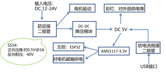

2.1 Power supply scheme
      The power supply scheme is shown in the figure below. The input voltage of SimpleFOC_X V1.0 is 12-24V DC voltage input. The reverse connection protection diode can prevent the DC power supply from being reversed and damaging the circuit, but it will cause a certain degree of voltage drop. The SS54 diode has a voltage drop of about 0.5V when it is fully loaded at 5A, but in this application scenario, the current cannot reach 5A, and its voltage drop is about 0.3V. When setting the power supply voltage in the program, you can subtract 0.3V from the input voltage to get the VCC voltage (which can also be ignored).
2.2 Introduction of each part
(1) USB interface
      USB Micro interface;

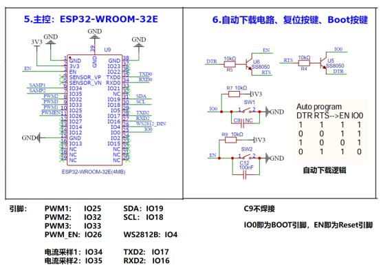

(2) USB to serial port circuit
      The USB to serial port chip uses CH340C. To adapt to the ESP32 level, a 3.3V power supply is used. The VCC and V3 pins are both connected to the 3.3V level. A 100nF capacitor is used for decoupling. The RTS and DTR pins are used for the ESP32 automatic download circuit.
(3) (4) Step-down module and linear regulated power supply
(5) (6) Main controller: ESP32-WROOM-32E and automatic download circuit

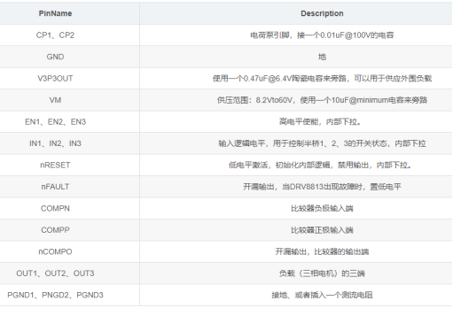

(7) DRV8313 brushless motor driver chip
      DRV8313 provides internal shutdown functions to realize overcurrent protection, short circuit protection, undervoltage lockout and overtemperature protection. When the LED4 fault light is on, the power should be turned off immediately and the cause of the error should be eliminated before powering on again. When only USB is connected and DC power is not connected, the fault light is lit due to undervoltage, which can be ignored. After powering on, the fault light will automatically turn off.
      The maximum current of DRV8313 is 2.5A (peak current) @25°C @24V. It cannot work for a long time at a current exceeding 1.5A.

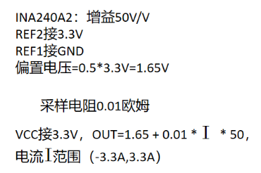

(8) INA240A2 Current Sampling Circuit
      INA240 has enhanced PWM suppression function and is an excellent choice for built-in current detection. Built-in current detection (Inline CurrentSense) is the simplest and most accurate technology to use. The sampling resistor is connected in series on the motor phase line. The detected current is always the motor phase current. Because the current in the inductor will not change abruptly, the sampled current is continuous and stable regardless of the state of the PWM duty cycle.
 The motor current is a sine wave. For the sampled differential signal, the negative half-cycle is negative. For easy processing, a bias voltage needs to be superimposed to ensure that the output of the whole cycle is positive.
(9) WS2812B-RGB Color Light

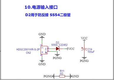

(10) Power Input Interface
Input voltage: DC 12-24V. D2 is used for reverse connection protection. D2 can withstand a maximum positive current of 5A, but there is a voltage drop of 0.5V under full load and about 0.3V during low current use. VCC = input voltage - 0.3V.
C14 is used for energy storage, and R11 is a 0Ω resistor used to isolate the motor PGND and digital GND.
(11) Magnetic encoder interface and brushless motor interface
The magnetic encoder interface is an I2C interface, powered by 3.3V, used to connect the AS5600 magnetic encoder.
U, V, and W are connected to the three-phase lines of the brushless motor.
(12) Reserved interfaces
The reserved interfaces include serial port 0 and serial port 2.
Demo video.mp4
