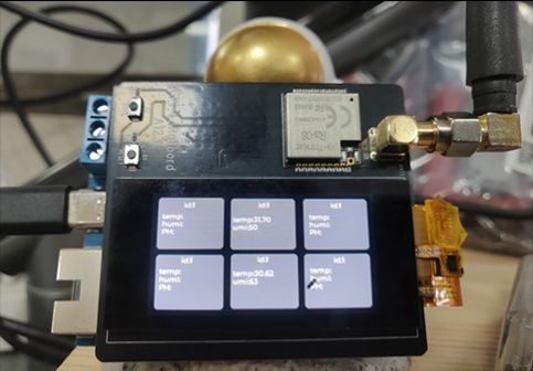

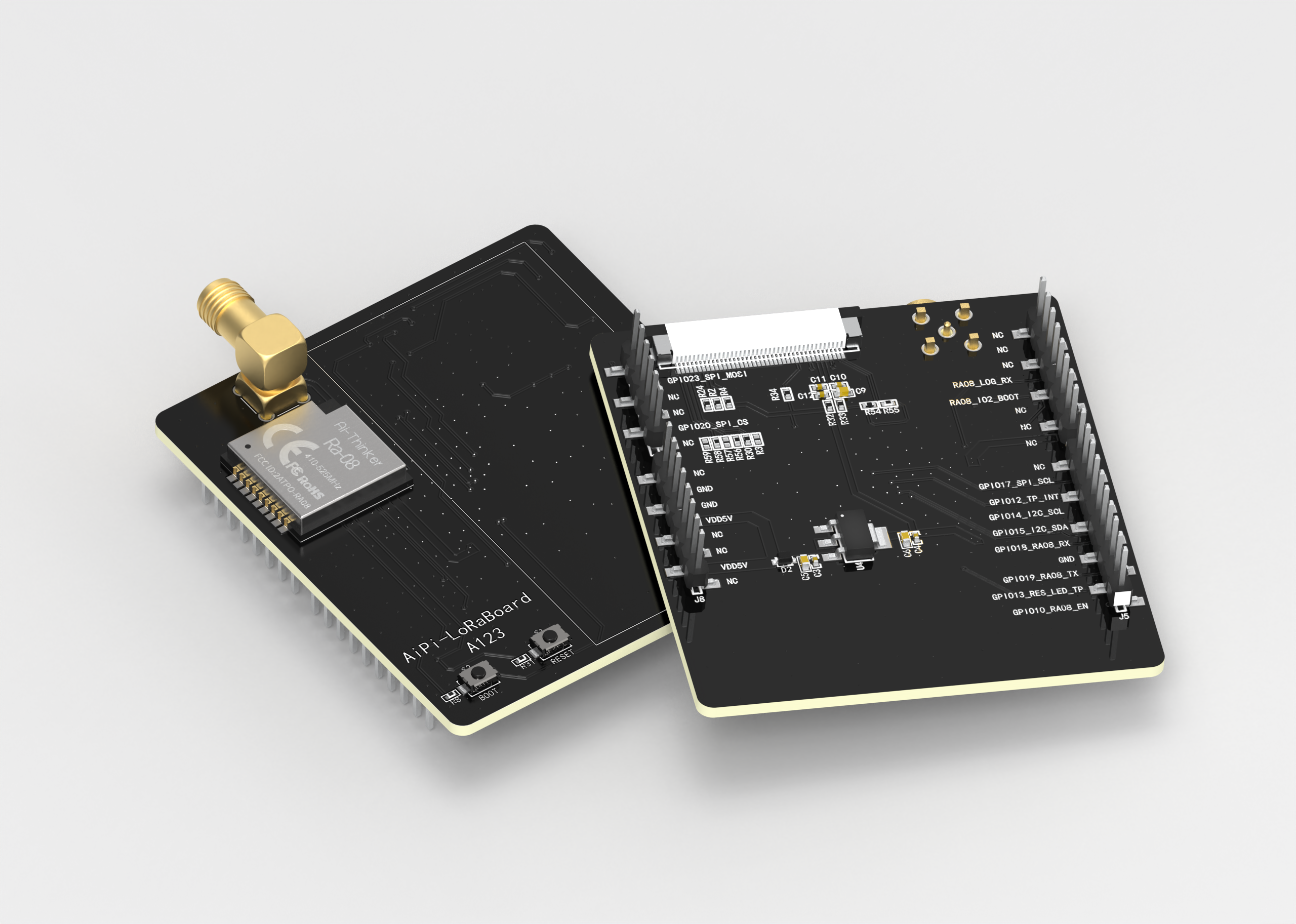

The AiPi-LoRaBoard is an expansion board for the AiPi-UNO-ET485 development board, featuring a Ra-08 module and a 1.9-inch MIPI-DBI capacitive touchscreen.
The Ra-08 operates in the 410MHz~525MHz frequency band and is compatible with Ra-01/SC, Ra-02, and other LoRa modules. The default antenna is a 433MHz "Little Pepper" antenna (communication distance was not measured). Replacing with the Ra-08H allows the use of the 803MHz~930MHz frequency band.
The 1.9-inch screen uses a MIPI-DBI interface, has 170*320 pixels, and supports capacitive touch.

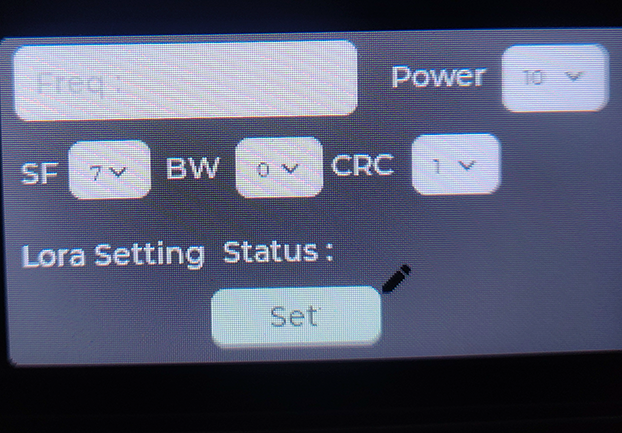

AiPi_uno_loraBoard.bin is the firmware for the AiPi-UNO-ET485, whose main function is to configure the Ra-08 as the master and display slave data on the 1.9-inch screen. It also allows setting the Ra-08's operating frequency band and some LoRa parameters, such as the spreading factor. Therefore, this firmware requires the Ra-08 to run the AiPi-LoRaBoard_v0.0.5.bin firmware to work.

After installing the AiPi-LoRaBoard on the AiPi-UNO-ET485 and powering it on, the AiPi-LoRaBoard's LoRa will operate with the following parameters:
Frequency (Freq): 470000000
Spreading Factor (SF): 7
Bandwidth (BW): 0
Checksum (CRC): 1

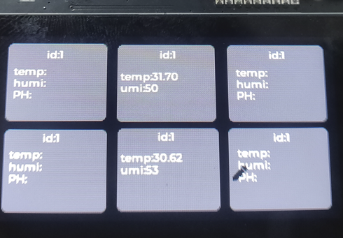

The default interface displays data monitoring, showing the data from the AiPi-LRW-TH1 by default.
Swiping left will take you to the configuration page, where you can configure the main LoRa parameters.
