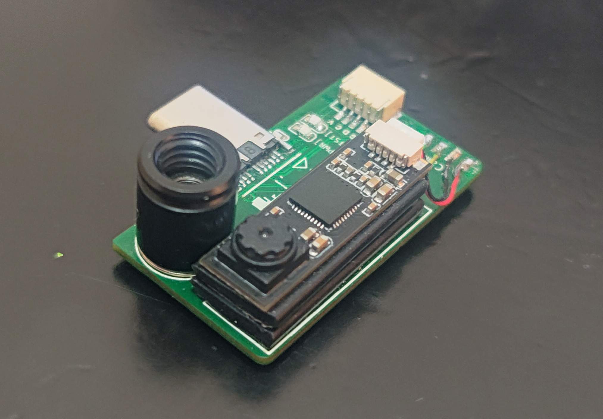

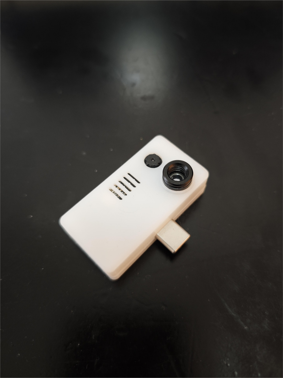

Project Description:
Visible light cameras offer high resolution and frame rate, while thermal imaging sensors measure temperature distribution but suffer from low resolution and frame rate. Visible light images are used to compensate for thermal imaging images, resulting in higher-quality heat distribution maps. The device itself contains a standard visible light camera and a thermal imaging sensor. After being read by the MCU, the data is transmitted to a mobile device via USB. The mobile device's powerful computing capabilities enable image processing and fusion, displaying the final image on the phone screen. The software is licensed under the MIT
license
, granting the licensee the right to use, copy, modify, merge, publish, distribute, sublicense, and sell the software and copies thereof. Licensees may modify the license terms as needed for the program. Copyright and license notices must be included in the software and all copies thereof, but the original author assumes no risk of use and has no obligation to provide technical support.
Project-related functions:
The overall functional framework of this project is as follows: The MCU reads thermal imaging sensor data via the I2C interface and then transmits it to a USB hub via the USB interface. The camera is a universal driverless USB camera, also connected to the USB hub. The USB hub connects to an Android phone. The Android phone has two devices: one is the camera, and the other is the thermal imaging sensor. The Android phone application layer obtains data from both sensors, fuses it using a certain algorithm, and obtains a high-resolution, high-quality thermal image.
Project attributes:
This project is being publicly disclosed for the first time and is my original work. This project has not won any awards in other competitions.

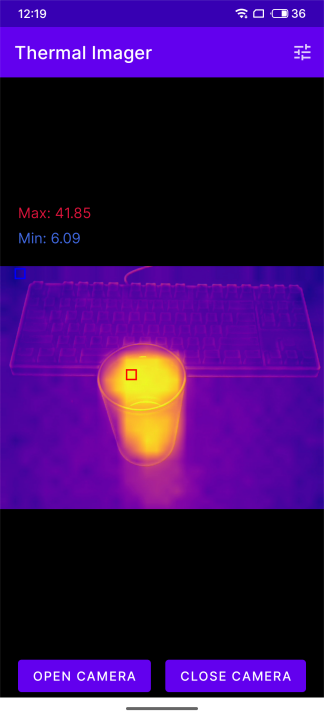

Added high and low temperature tracking, algorithm parameter adjustment, fusion mode switching, and frame rate switching functions.
Optimized the interface, fixed some bugs, and automatically locked screen rotation.

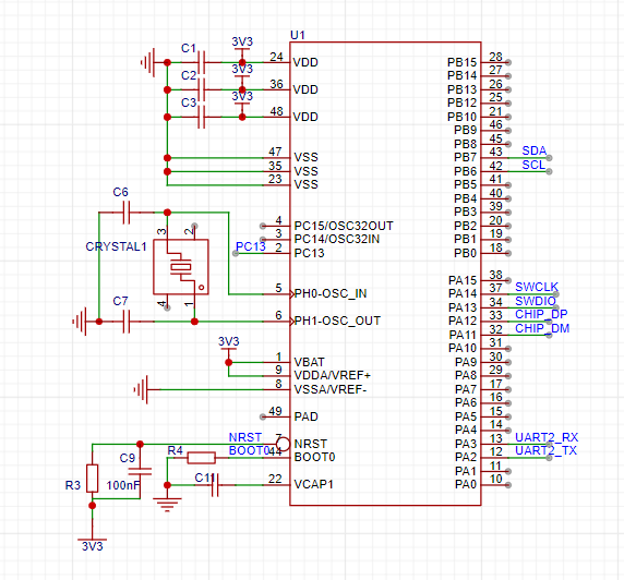

MCU
: The MCU uses STM32F411CEU6, with a floating-point unit that can process thermal imaging data. It has USB FS. The minimum system circuit is as follows.

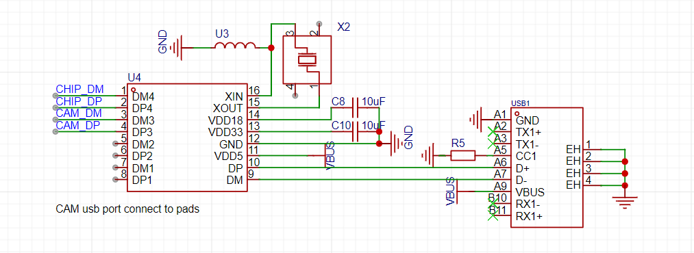

USB Hub:
The USB Hub uses SL2.1A and supports USB HS, which can be used to transmit camera data. According to the manual, a crystal oscillator U3 is connected here and does not need to be soldered. USB1 is a USB Type-C male connector used to connect to a mobile phone.
The camera uses a 640x480 UVC camera daughterboard, which is soldered to the CAM_DM/CAM_DP

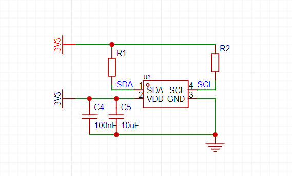

The thermal imaging sensor uses an MLX90640 with a resolution of 32x24 pixels and an I2C interface with a maximum speed of 1MHz.

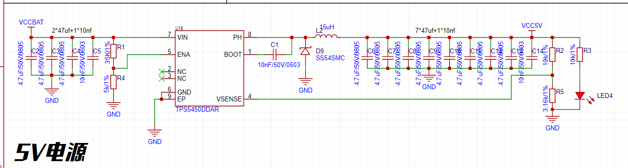

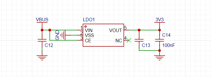

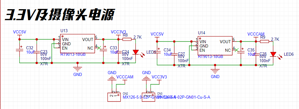

The power supply
uses an LDO for voltage regulation, model ME6211, which can directly use low-ESR ceramic capacitors for input and output voltage regulation.
Other
power supplies include LEDs and test LEDs .

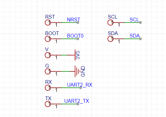

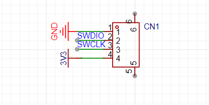

The SWD interface
test points are debugged, and the firmware uses UART2 as the debug serial port.

3D printed shell
: Download 3d_printed_casing.zip from the attachment. The document provides STEP and STL files for direct printing

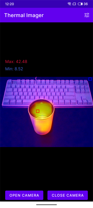

Android APP

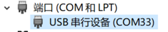

There are two USB devices here, one is a USB serial port, used to transmit thermal imaging data, and the other is a USB camera, used to transmit image data. The Android side mainly completes the data reading, fusion and display functions

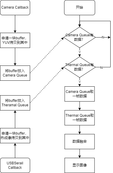

Software Framework
Both Camera and thermal imaging sensor data reading have corresponding libraries to support them. Both libraries use asynchronous callback for data reading, so a double buffer caching mechanism is used here. Taking Camera as an example:
initialize a queue of length 2. When the callback occurs, allocate a new buffer, copy the YUV data into this buffer, and then put this buffer into the queue.
A thread is started to continuously read data from the queue for data fusion.
If the thread reads too slowly, the callback will find that the queue is full, so it will take a buffer from the queue and discard it, and then put a new buffer into the queue.
If the callback never comes, the thread will find that the queue is empty and will skip the next read.
Because a new buffer is allocated for each callback, there is no concurrency problem with the buffer.
Adding and deleting data from the queue accesses the same data structure, which has a concurrency problem. Locking is required during operation.
As mentioned above, there are two queues, one for YUV data and one for thermal imaging data. A thread accesses both queues. Data is taken out only when both queues have data for data fusion. In summary, the overall software flow is as follows:
Android supports cameras using UVCAndroid. Reference article: https://blog.csdn.net/hanshiying007/article/details/124118486
This library is based on saki4510t/UVCCamera and provides a simpler interface. For previewing and data reading, refer to the CallbackDemo. You need to override ICameraHelper.StateCallbackd. Here, the camera data is retrieved and placed into a YUV queue. The format is as described in NV21
thermal imaging data reading and preview
3.2. The thermal imaging data is transmitted via USBCDC. On the Android side, it appears as a virtual serial port. In the Android development environment, felHR85/UsbSerial is used to provide virtual serial port operation support. In the callback, the thermal imaging data is placed into the queue.

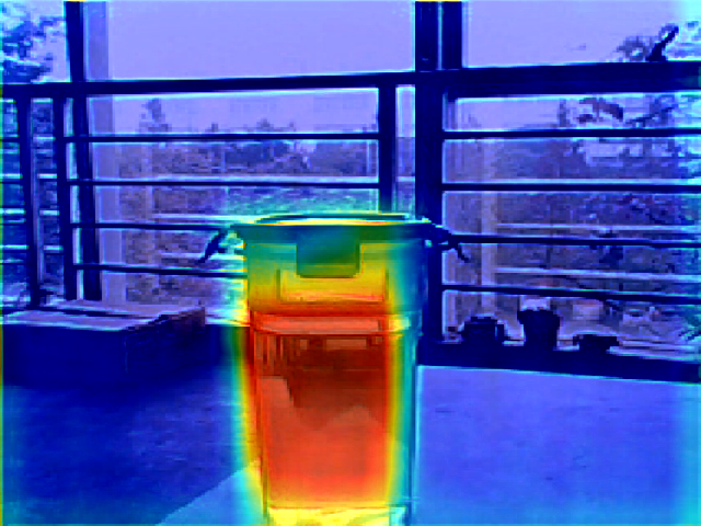

Data fusion and
data acquisition
use a single thread to retrieve data. Here, the camera frame rate is expected to be higher than the thermal imaging frame rate. Data fusion is only performed when there is data in the mYUVQueue queue. When there is no data in the mThermalQueue, the data
fusion algorithm

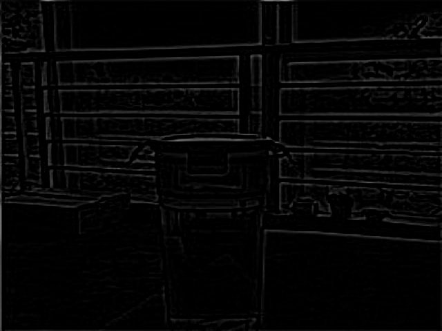

of the previous frame is used. Here, the camera captures a visible light image with a resolution of 640x480, while the thermal imaging captures the temperature distribution with a resolution of 32x24. The purpose of the fusion algorithm is to use the visible light image as a reference to give the thermal imaging temperature image more detail.
The first step of the fusion algorithm is to extract high-frequency information from the visible light camera. Since the current Android app integrates OpenCV, the previous method is no longer used. Here, Gaussian blur is used to extract high-frequency information. Refer to the blog: Using OpenCV Mat to extract and losslessly restore low-frequency and high-frequency information from images (Gaussian blur, subtraction, summation).
`Mat im_cam_l;
GaussianBlur(im_cam, im_cam_l, Size(11, 11), 5, 5);
Mat im_cam_h = im_cam - im_cam_l;`

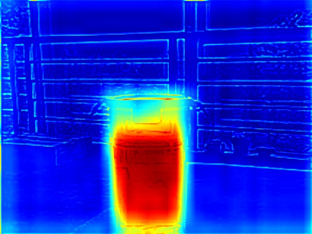

After extracting the high-frequency information, it is superimposed on the interpolated and enlarged thermal imaging image to obtain the fused image. Finally, pseudo-color is applied.
`Mat im_fusion = im_cam_h + im_them_scale;

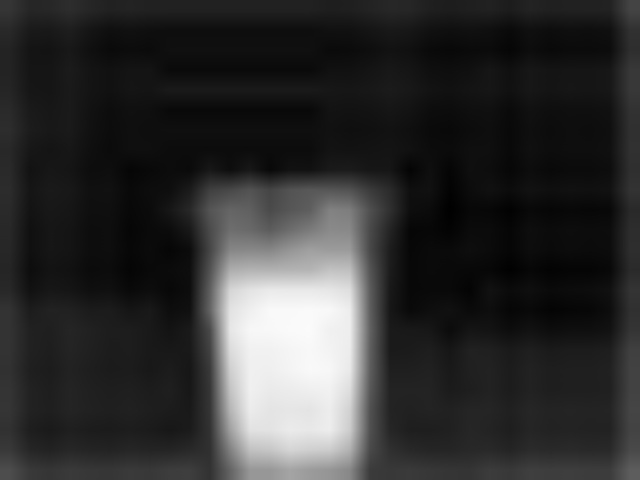

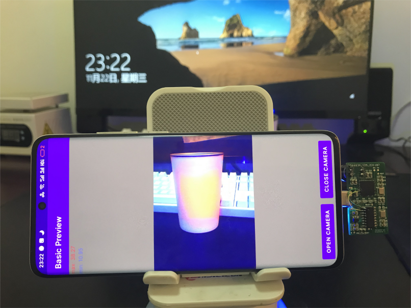

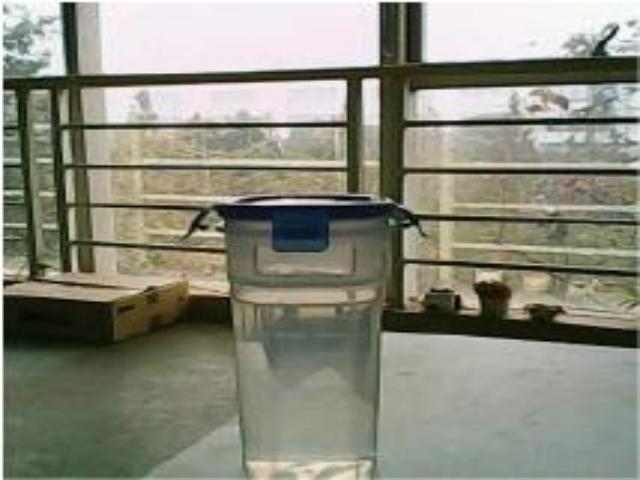

applyColorMap(im_fusion, im_fusion_color, ...;` The simulation results are as follows (COLORMAP_JET).
The first image is taken by the camera, and the second image is an image of the temperature distribution obtained from thermal imaging after interpolation and magnification. Both images have a resolution of 640x480.
First, high-frequency information is extracted from the visible light camera. The low-frequency and high-frequency information are as follows.
Then, the thermal imaging image is superimposed and assigned pseudo-color using the JET color table. The result is as follows.
Color mapping
: Color mapping directly assigns pseudo-color to the thermal imaging image and then superimposes it onto the visible light image in a YUV manner. Since the visible light image itself contains a large amount of information, it is equivalent to increasing the amount of information in the thermal imaging. The basic idea of ​​color mapping is to convert the RGB components of the thermal imaging into YUV components according to the formula, and then subtract 128 from each as the offset of the visible light image before superimposing it onto the visible light image. The color mapping effect is as follows.

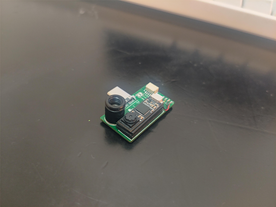

Design Notes:
1. U3 ferrite beads are for testing purposes only and do not require soldering! No soldering required! No soldering required!
The USB cable from STM32 to SL2.1A was reversed. After correcting with a jumper wire, it was verified to be working correctly. This has been fixed in the project, but due to time constraints, it hasn't been prototyped yet. If you're unsure, you can revert to the first prototype version (release_1) in version control and then correct it yourself
. 3. The prototype thickness of the board in the demonstration is 1.2mm.
4. The camera's USB speed is high, so impedance control is needed during prototyping .
5. Refer to this link for the camera daughterboard; the connection wire spacing is 0.8mm. Refer to this link as well
. 6. The MLX90640 sensor is relatively tall; it's best to elevate the camera daughterboard slightly. The following are earlier version

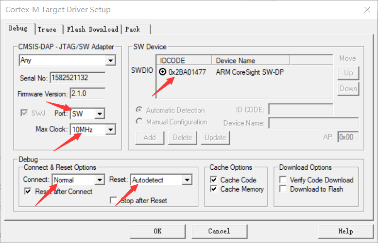

IV. Daily Use

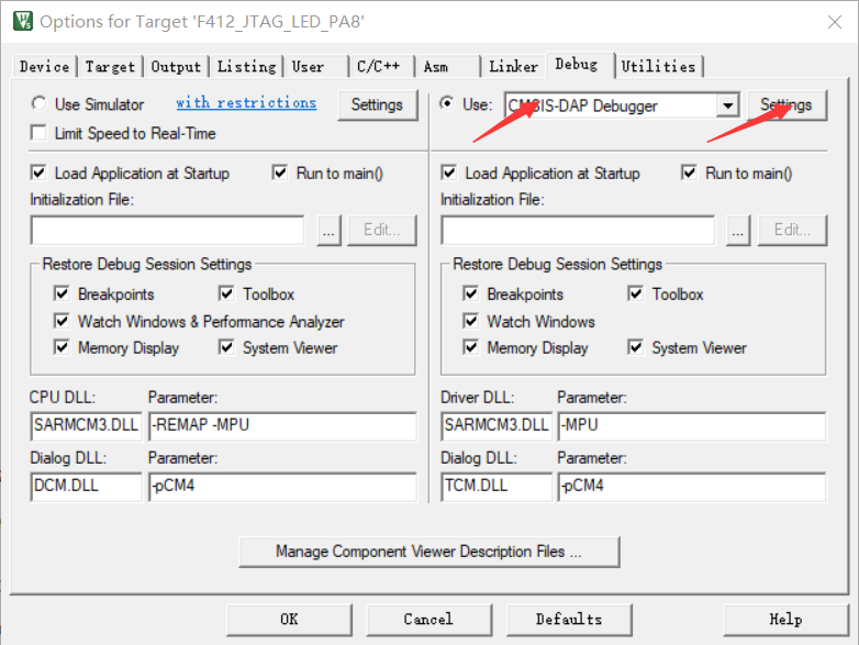

1. Keil Settings
If you encounter connection failures or unstable connections, you can try lowering the clock frequency and replacing the DuPont wires. In addition, some chip models may not be able to be debugged properly at high clock frequencies (the HK32F030MF4P6 I used is an example).
2. Interference:
If you encounter severe signal interference on the current wireless channel, try changing to a different communication channel. Excessive interference can lead to reduced speed and unstable downloads.

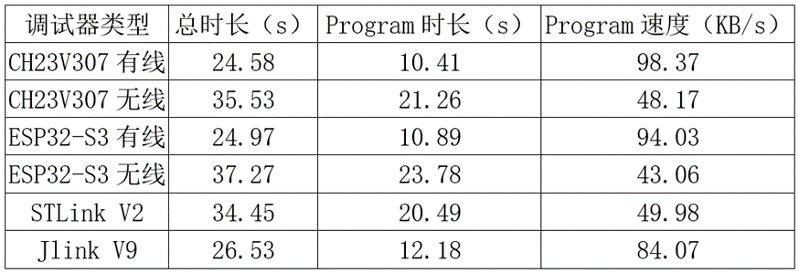

V. Performance Testing
Environment: Keil MDK 5.34
Target Chip: STM32F407VGT6
Firmware Size: Approximately 1024K
Testing Method: Timed with a stopwatch on a mobile phone, averaging three tests.
Since the Erase and Verify times are roughly the same for each downloader, the Program duration and speed, which reflect the downloader's download speed, are calculated.
In the table, CH32V307 is the previous version, and ESP32-S3 is this version. As you can see, this version of the debugger's performance is very close to the previous version. The wired mode speed slightly exceeds Jlink V9, while the wireless mode speed is slightly lower than STLink V2. I've also tested some wireless debuggers on Taobao, many of which have speeds of only a few tens of KB/s, which is normal, as the speed of a typical wired DAP is only 20+ KB/s.

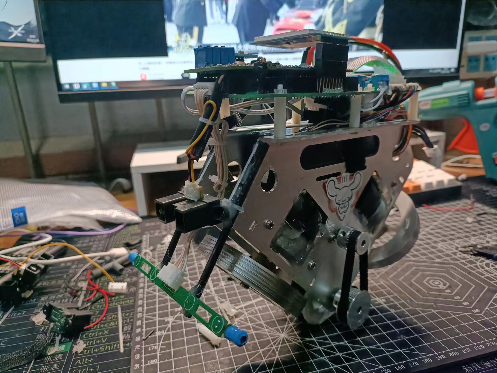

Based on the Liangshan School's self-balancing O-type wheelbarrow
The unicycle model in this project uses the O-model provided in the 18th Intelligent Vehicle Competition, and is designed with the Jialichuang Liangshanpai as the main control board, enabling it to complete the tasks in the 18th Intelligent Vehicle Competition.
This project uses the O-model unicycle provided in the 18th National Intelligent Vehicle Competition. It is designed using the JLCIC Liangshanpai main control board and can complete the tasks from the 18th National Intelligent Vehicle Competition (code is attached).
Open Source License: GPL 3.0 Project Functions
: 1. Unicycle structure, using one bottom wheel motor and two momentum wheel brushless motors. A 6s battery is used. 2. A DRV8701 is used as the brushed motor driver for the bottom wheel, and the motor's forward and reverse rotation and speed adjustment can be controlled via PWM. The brushless motor has its own driver and does not require additional drive . 3. Tracking can be achieved by sensing electromagnetic signals, similar to the method used in the National Undergraduate Intelligent Vehicle Competition. 4. A Bluetooth interface is reserved on the main control expansion board for easy communication with mobile phones, and a DAPlink interface is provided for easy downloading and plugging/unplugging. 5. The power board has a reverse connection protection circuit, one 5V power supply and two 3.3V power supplies, and one DRV8701 full-bridge motor driver . For safety, the power supply section is isolated from the core board. Note: This section describes the overall functionality of the project. Project Attributes : This project is being publicly disclosed for the first time and is my original work. The project won second prize in Shandong Province at the 18th Intelligent Vehicle Competition. This project is being publicly disclosed for the first time and is my original work. The project has not won any awards in other competitions. Project Progress: Overall project progress, application for project consumables costs. 9. Required! 2023-08-08 Project awarded; design scheme started on August 25, 2023; software scheme design completed on September 28, 2023; first version of hardware scheme completed on October 5, 2023; first version of hardware received and tested on October 15, 2023; second version of hardware design completed on October 18, 2023; second version of hardware received and tested on October 25, 2023; hardware testing completed and debugging started on November 14, 2023; basic tasks completed, video recorded on November 20, 2023; first shipment sent for testing and acceptance, and rectification completed on December 22, 2023; second shipment sent for testing and acceptance, and rectification completed on January 15, 2024; second shipment sent for testing and acceptance completed. And rectification design principle prompts: Design principle description of this project Model introduction 1.1.1 The main body of the model is 215mm long, 356mm high, and 116mm at its widest point. The whole car is made of anodized alloy. The double flywheel structure can stand in balance and can also turn freely . Purchase link: https://item.taobao.com/item.htm?abbucket=18&id=701275309058&ns=1&spm=a21n57.1.0.0.3332523c9gQgpf&skuId=4944447208762 1.1.2 The official brushless motor is a Nidec O-1104 DC brushless motor (DC24V, speed 6000r) used to control the rotation of the momentum wheel. The motor features a built-in brushless drive with a 100-line dual-channel encoder, suitable for high-precision feedback control. It supports PWM signal speed regulation and forward/reverse rotation, includes an emergency stop function, and supports forward/reverse switching and stepless speed regulation. Purchase link (the motor is included with the complete vehicle purchase; it doesn't need to be purchased separately, but can be considered for replacement parts): https://item.taobao.com/item.htm?abbucket=18&id=716033359390&ns=1&spm=a21n57.1.0.0.76f5523cDrhemB&skuId=5000259636337                                                                                                                                     1.1.3 DC brushed motor ( DC7.2V, 800rpm) provides strong support for the model car to complete competition tasks. Purchase Link: https://item.taobao.com/item.htm?abbucket=18&id=693298985042&ns=1&spm=a21n57.1.0.0.76f5523cDrhemB 1.1.4 The unicycle wheel has a diameter of 54mm and a width of 16mm. The rim is made of anodized alloy, and the exterior is made of environmentally friendly TPR material with a pattern, providing high friction and making it sturdy and impact-resistant. Other accessories are listed in the attached table. Control Principle: The unicycle control algorithm can be broadly divided into two parts: balance control and tracking control. Its overall anti-interference capability and response speed are important indicators for evaluating the overall performance of the unicycle. Balance Part: The front and rear balance of the unicycle is controlled by the bottom wheel. The algorithm uses a three-loop cascade PID to control its front and rear tilt angles, keeping it stable overall. The left and right balance of the unicycle is controlled by the front and rear momentum wheels. The algorithm also uses a three-loop cascade PID to control its left and right tilt angles, keeping it stable overall. The unicycle's balance control relies on a momentum wheel and uses cascaded PID control. This requires connecting three PID controllers in series: an angular velocity loop, an angle loop, and a speed loop. Based on response time, the angular velocity loop is the innermost loop, followed by the angle loop, and the speed loop is the outermost loop, similar to upright bikes and balance bikes. The code implementation of cascaded PID is relatively simple, and the concept is easy to implement: connecting three ordinary PID controllers in series and using different control cycles to achieve cascaded PID. However, the error input physical quantity of each PID is different, and the input of the inner loop PID must be related to the output of the previous loop PID. For the tracking section: the electromagnetic acquisition circuit is a necessary sensor for the intelligent vehicle to continue driving when the circuit is broken. The electromagnetic acquisition circuit consists of frequency selection, amplification, and detection, providing the microcontroller with a stable voltage induced by the energized enameled wire in the middle to determine the vehicle's position. Through Professor Zhuo's articles on signal and demodulation, we learned about signal-related knowledge and selected an operational amplifier and detector circuit as the electromagnetic acquisition circuit according to the electromagnetic vehicle guide published by the competition organizing committee. This circuit can simultaneously amplify and detect signals, resulting in low output impedance. For a straight conductor, when the cart, equipped with two coils symmetrical about its central axis, travels along the conductor, the induced electromotive forces (EMFs) in both coils should be the same in magnitude and direction. If the cart deviates from the conductor, meaning the two coils are asymmetrical about the conductor, the magnetic flux through the two coils will be different. In this case, the EMF induced in the coil closer to the conductor should be greater than that in the coil farther from the conductor. Based on the difference between these two asymmetrical signals, the direction of the cart can be adjusted to guide it along a straight line.
For curved guideways, i.e., curves in the path, the difference in magnetic field density on both sides of the curve results in different induced electromotive forces (EMFs) in the coils when the car carrying the coils reaches this point. Specifically, the induced EMF in the coil inside the curve is greater than that in the coil outside the curve, and this signal guides the car to turn.
Furthermore, when the car moves far from the guideway, causing the two coils to be on one side of the guideway, the induced EMFs in the two coils are also unbalanced. The coil closer to the guideway induces a greater EMF than the coil farther away. This guides the car back onto the guideway.
The acquired electromagnetic signals are first filtered using Kalman filtering, and then normalized. The normalized values ​​are limited to ±100, similar to the centerline error of the camera's final fitting. The normalized values ​​are then used for PID calculations. The
electromagnetic acquisition circuit is an essential sensor in intelligent vehicles. This circuit consists of frequency selection, amplification, and detection, designed to provide a stable voltage signal to the microcontroller, which is induced through the energized enameled wire in the middle, thereby determining the position of the car model. Referring to Professor Zhuo's tweets on signal and demodulation and the electromagnetic car guide released by the competition organizing committee, an operational amplifier detector circuit was chosen as the electromagnetic acquisition circuit. This circuit can simultaneously amplify and detect signals, with a relatively low output impedance.
For a straight conductor, when the car, equipped with two coils symmetrical about its central axis, travels along a straight line (i.e., when the positions of the two coils are symmetrical about the conductor), the induced electromotive forces (EMFs) in the two coils should be the same in magnitude and direction. If the car deviates from the straight conductor (i.e., the two coils are asymmetrical about the conductor), the difference in the induced EMFs of the two coils can be used to adjust the car's direction and guide it to travel in a straight line.
For an arc-shaped conductor, i.e., at the bend in the path, due to the different magnetic field densities on both sides of the arc, when the car carrying the coils travels to this point, the induced EMFs in the coils on both sides are different. Specifically, the induced EMF of the coil on the inside of the arc is greater than that of the coil on the outside of the arc; this signal can guide the car to turn.
Furthermore, when the car moves away from the guide wire, the induced electromotive force (EMF) in the two coils is unbalanced, with the coil closer to the guide wire exhibiting a greater EMF than the coil farther away. This signal guides the car back onto the guide wire.
The acquired electromagnetic signals are first filtered, then normalized using Kalman filtering. The normalized values ​​are then used for PID control to achieve stable car movement and guide wire following.

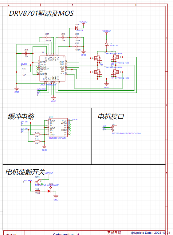

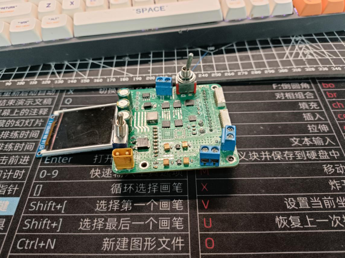

I. Power board section
 1. The system voltage regulator circuit uses a DC-DC step-down circuit with an input voltage range of 6V to 28V (this project uses a 6S battery for power), a maximum output current of 5A, and an output voltage of 5V in this project to power the entire system.
2. The LDO voltage regulator circuit uses an RT9013 to power the microcontroller and peripherals.
3. The DRV8701 is used as the motor driver, which is simple to control and can be PWM speed adjusted.
4. Brushless motor interface: Connects two momentum wheel brushless motors. If not for racing purposes, you can buy one without a racing label; search for "nidec brushless motor" on Taobao. They cost around 5-6 yuan with free shipping, very cheap. Those with a racing label cost 150 yuan.
5. Expansion board wiring terminals: Use a 14-pin cable to connect to the main control board as needed.
II. Main Control Board Section
1. Connection to Power Board
2. Bottom Wheel Encoder Interface, suitable for AB quadrature encoders
3. Wireless Serial Port, for remote control and parameter adjustment via Bluetooth module
4. DAPlink, external DAPlink interface for convenient testing
5. Buzzer, used to easily identify element flags (currently unused)
6. Buttons, for parameter adjustment (currently unused)
6. TFT Screen, using a standard 1.8-inch SPI screen
7. Gyroscope:
The gyroscope uses the MPU6050 module. The MPU6050 module is a 6-axis motion processing component from InvenSense, integrating a 3-axis gyroscope and a 3-axis accelerometer. It communicates with external devices via an IIC interface and includes a built-in Digital Motion Processor (DMP). The DMP significantly reduces the computational burden on the microcontroller, and this module is widely used in model aircraft and other products. Operating voltage is 3.3V to 5V.

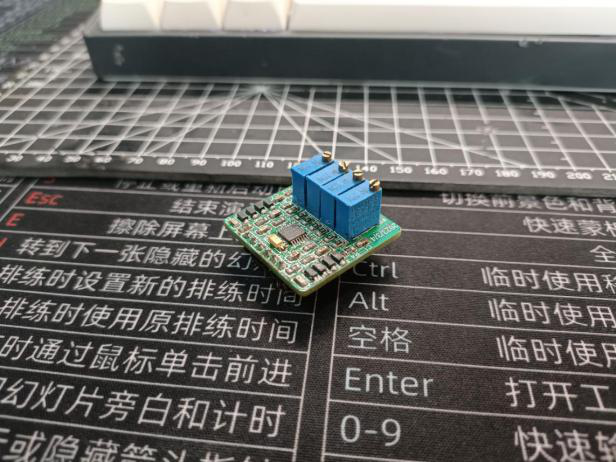

7. The operational amplifier module uses a ZF interface for ease of use, making it convenient for intelligent vehicle engineers to replicate and debug.
8. The inductor acquisition
task elements are relatively simple, using two inductors. The middle inductor is not used.

The power supply section
charges the product via Type-C, using the TP4057 charging and discharging chip. This chip is inexpensive and supports boost voltage to ensure stable system power supply.
The system uses a 3.3V power supply, therefore an LDO is used for voltage conversion.

the temperature sensor
, I selected two types to verify the effect. You can refer to the LCSC manual for details.
These are the two most accurate and affordable soldering irons I could find, offering the best value for money. Feel free to purchase them from LCSC's online store.
Soldering is quite complicated, so choose a good quality soldering iron, such as LCSC's Huanghua brand. LCSC, remember to pay me for advertising!
The T117
features ultra-low temperature measurement down to -103℃! Temperature accuracy ±0.1℃@+28~+43℃, I2C/single-bus digital output, 16-bit resolution/0.004℃, configurable temperature measurement as fast as 2.2ms, supports 4 I2C communication addresses; ultra-low power consumption 2μA@1HZ, 1.8V~5.5V wide voltage supply, small 2*2*0.75mm size, DFN6L package, built-in 112bit EEPROM user space. Widely used in smart wearables, thermometers, animal temperature detection, medical electronics, heat meters, gas meters, water meters, and other industries.
The MTS4
features I2C protocol digital output, compatible with both digital single-bus and digital sensors. Temperature measurement accuracy is ±0.1℃@+28℃~+43℃, with 16-bit output at 0.004℃. Measurement speed is configurable at 15.3ms/8.5ms/5.2ms/2.2ms. It boasts ultra-low power consumption of 3.1μA (AVG=16, 1 measurement/s), an ultra-small 1.6x1.2x0.55mm size, DFN4L package, and built-in 112-bit EEPROM user space. It is widely used in surface-mount small-sized smart wearables, electronic thermometers, animal temperature detection, medical electronics, cold chain logistics, and heat, gas, and water meters.
