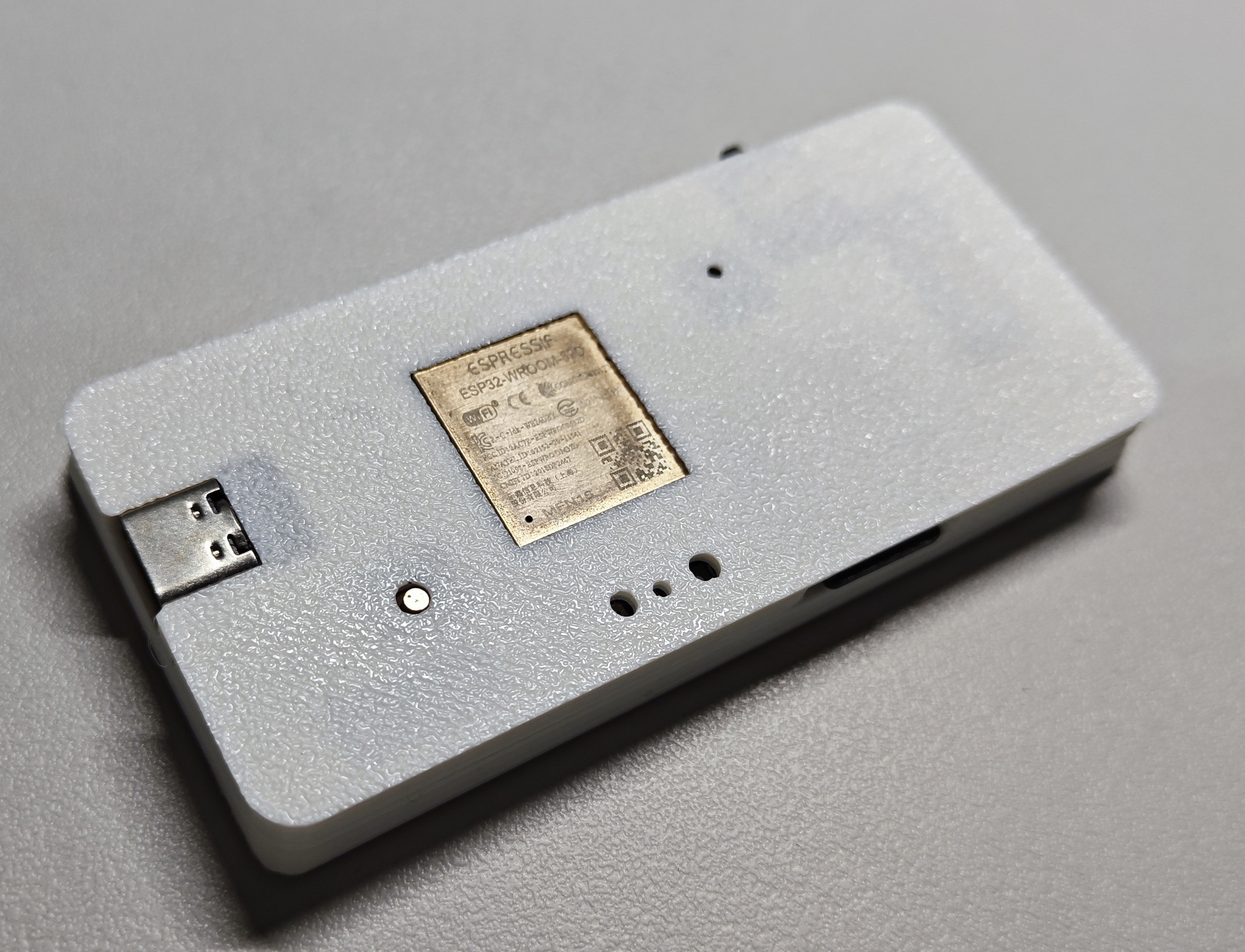

This document describes a project for a 2.9-inch programmable e-ink weather clock based on ESP32.

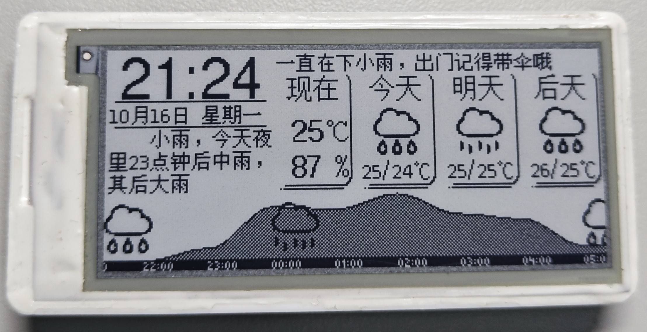

Local weather is obtained and displayed via the Caiyun Weather API

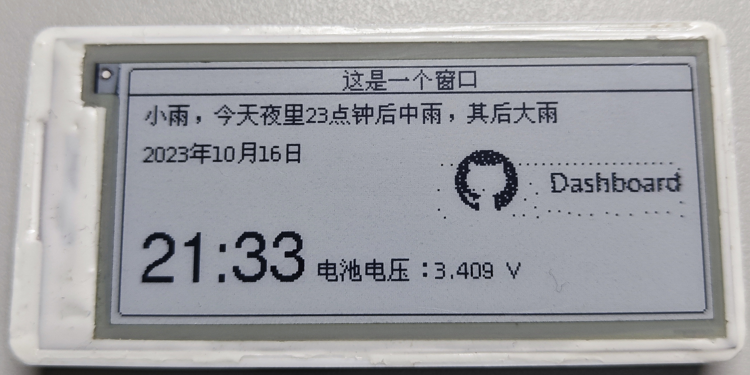

a built-in GUI framework includes dialog boxes and menus;

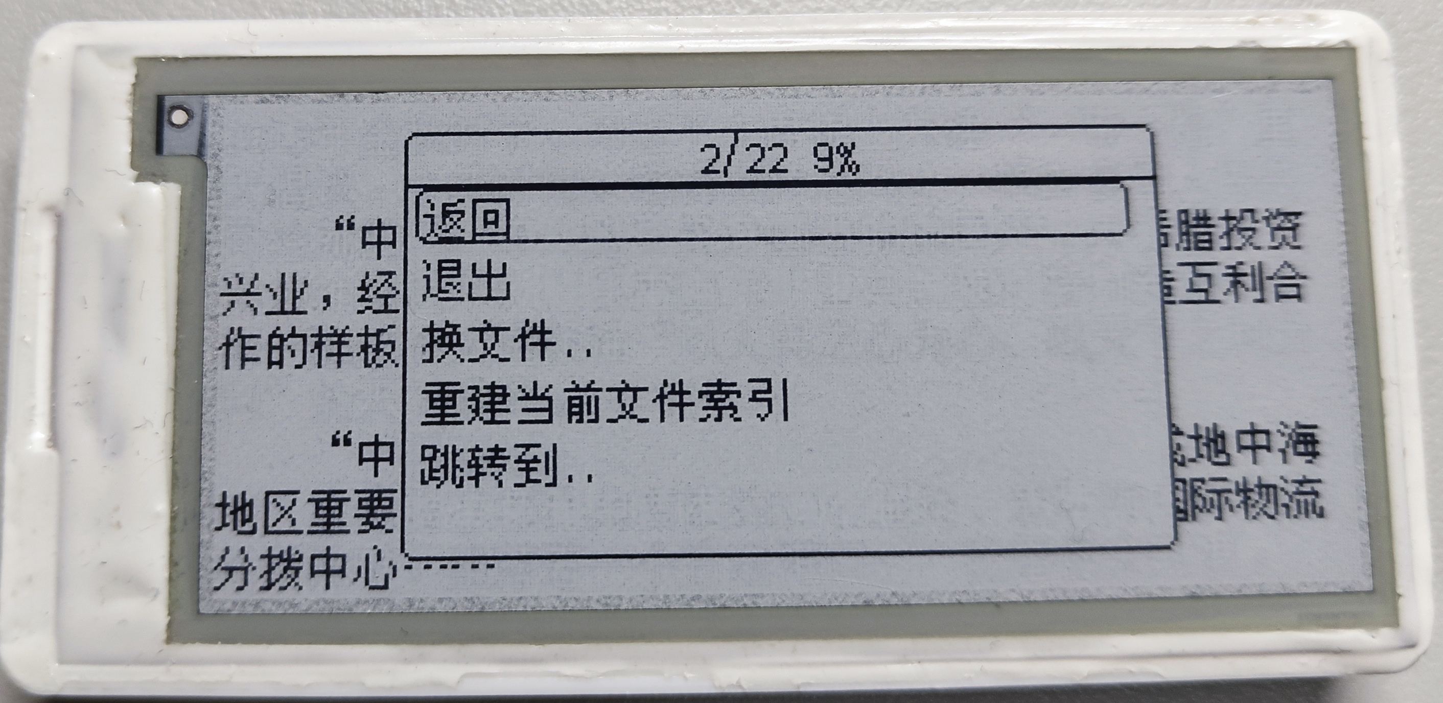

a simple e-book function

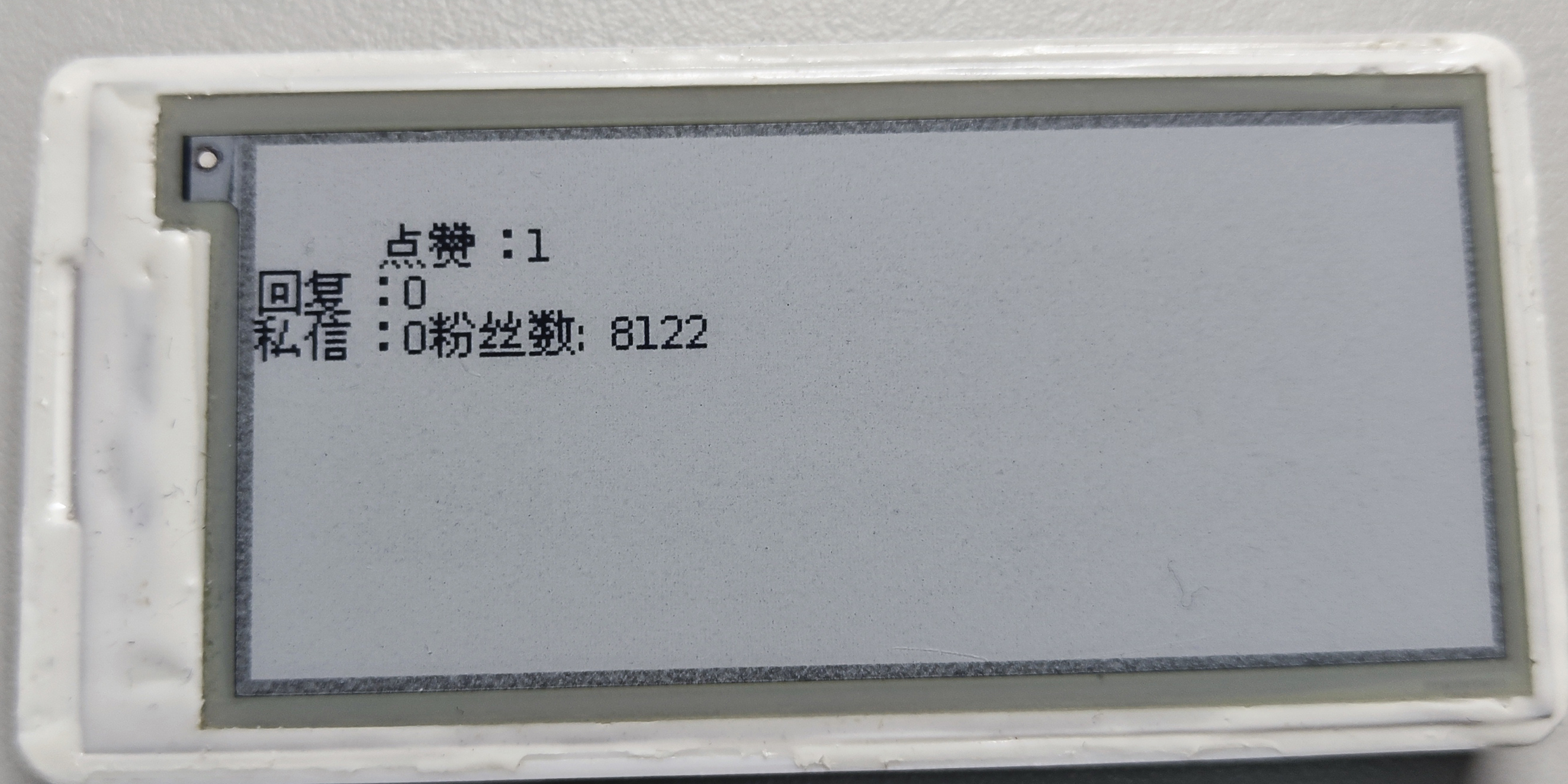

; a Bilibili fan display with
a complete settings menu;

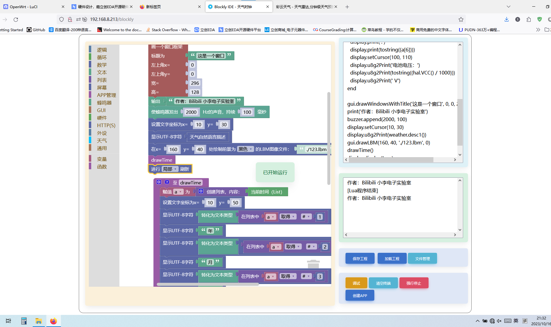

; and a built-in Blocky graphical development environment, allowing for the addition of features with just a browser

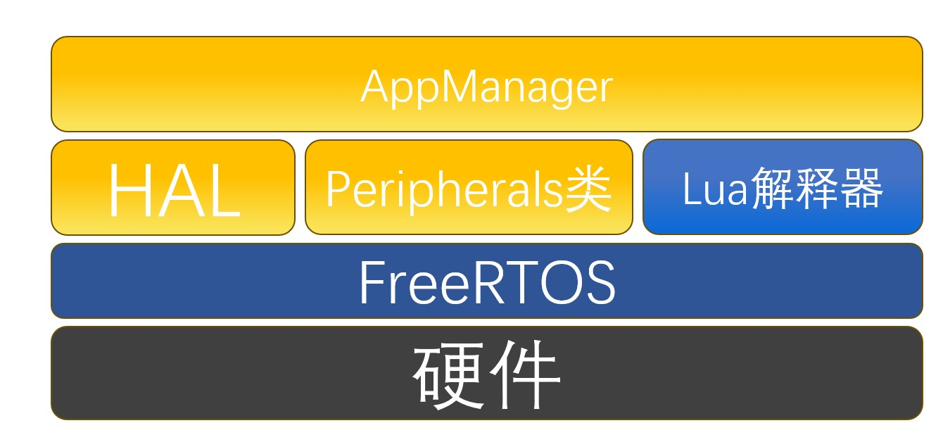

The design principles
and hardware are relatively simple. Except for the automatic power switching circuit, which I found online and don't know the principle behind, but it works and is very stable.
Overall Framework Diagram:
The AppManager class manages the lifecycle of all Apps (including Lua Apps).
The HAL class handles hardware-related functions and provides services such as automatic WiFi connection and NTP synchronization.
The Peripheral class manages installed peripherals and, during App runtime, switches peripheral power on/off (or enters/exits power-saving mode) as needed.
The Lua interpreter interprets and runs Lua Apps, enabling dynamic addition and deletion of Apps
. FreeRTOS is a real-time operating system provided by ESP-IDF, primarily used here to implement multi-threaded
software.
The system mainly runs the following three tasks
: AppManager: Executes App code and determines the next sleep time.
HAL: Automatically updates time and battery voltage and handles button events.
Lua Debugging: Created for debugging Lua on the web interface, facilitating immediate termination of program execution when needed and preventing Lua processes from blocking the web server.

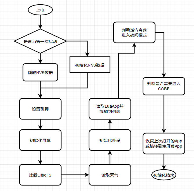

System initialization steps are as follows:
Physical Demonstration

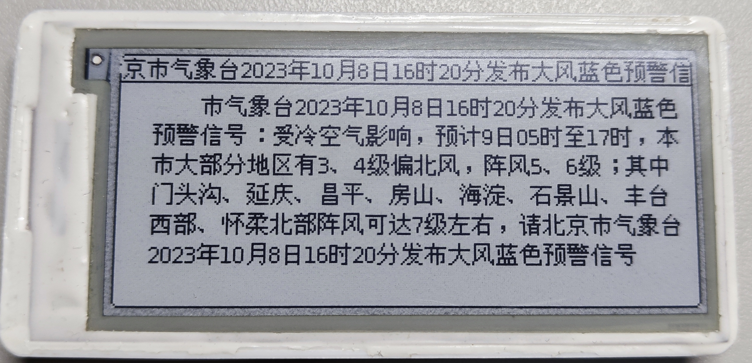

panel (shaded area below indicates rainfall)
, warning information (press any key to return)

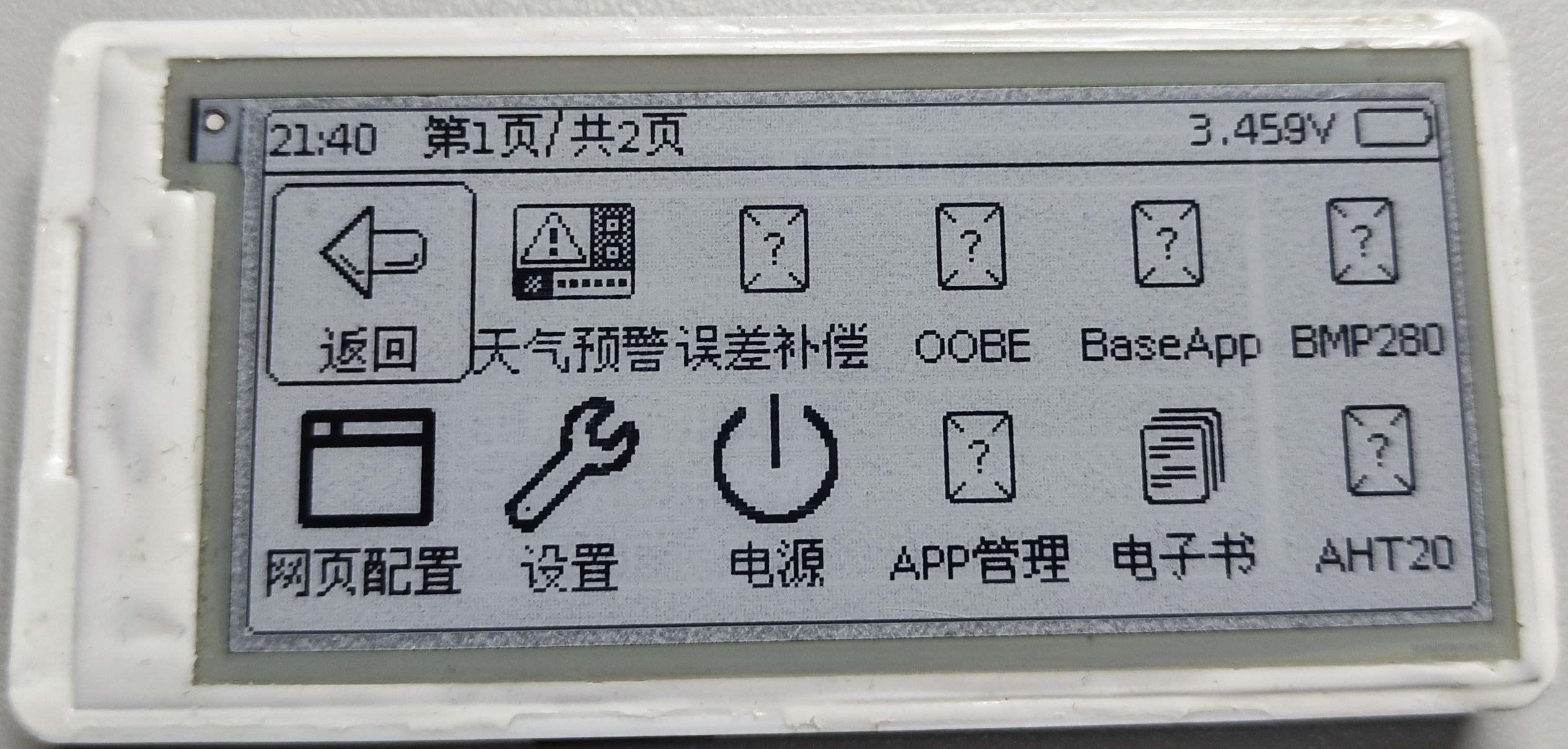

, app selection (long press the middle button in any app other than the e-book app, or select any app as the home screen app in settings),

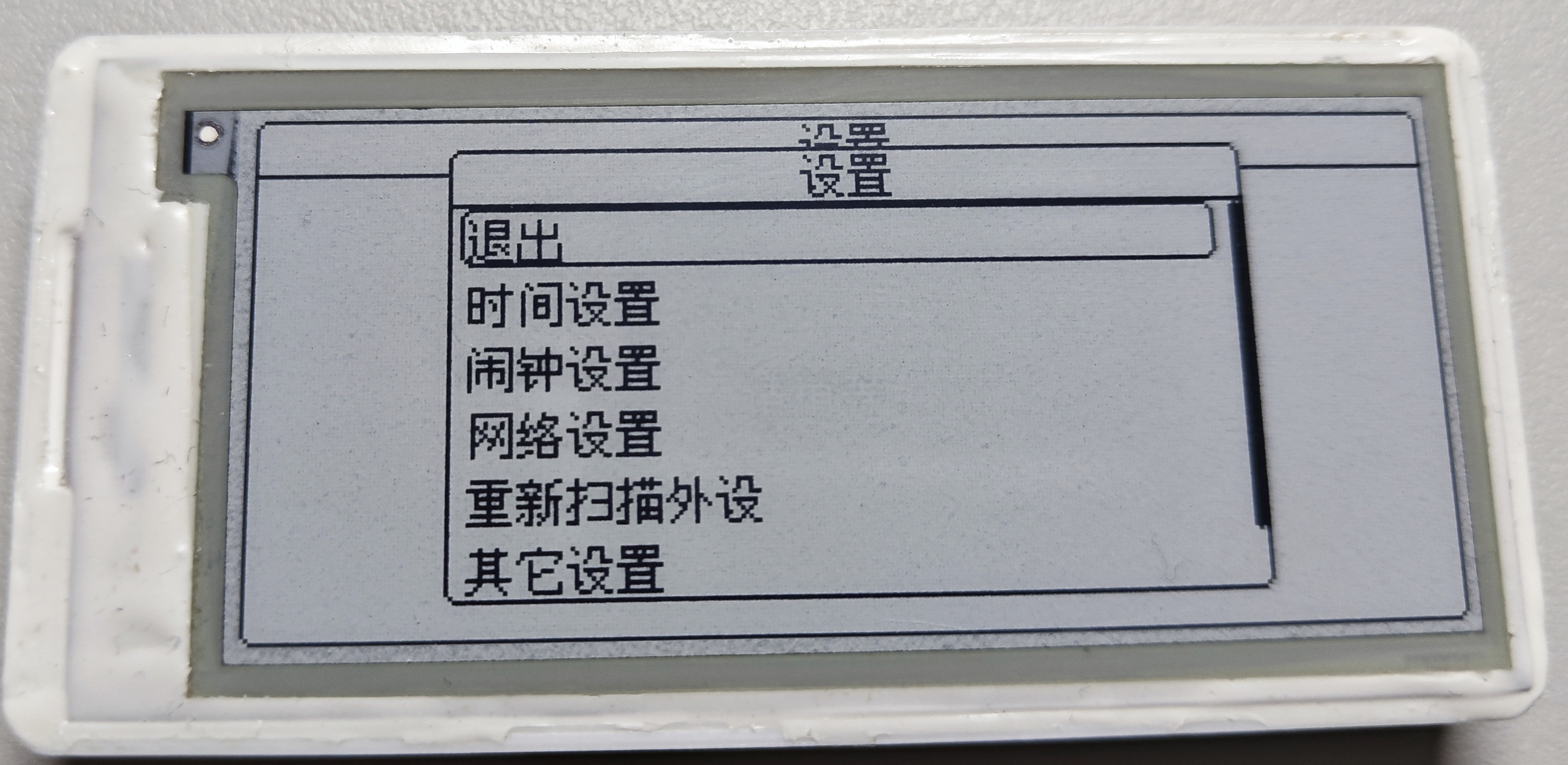

comprehensive settings menu

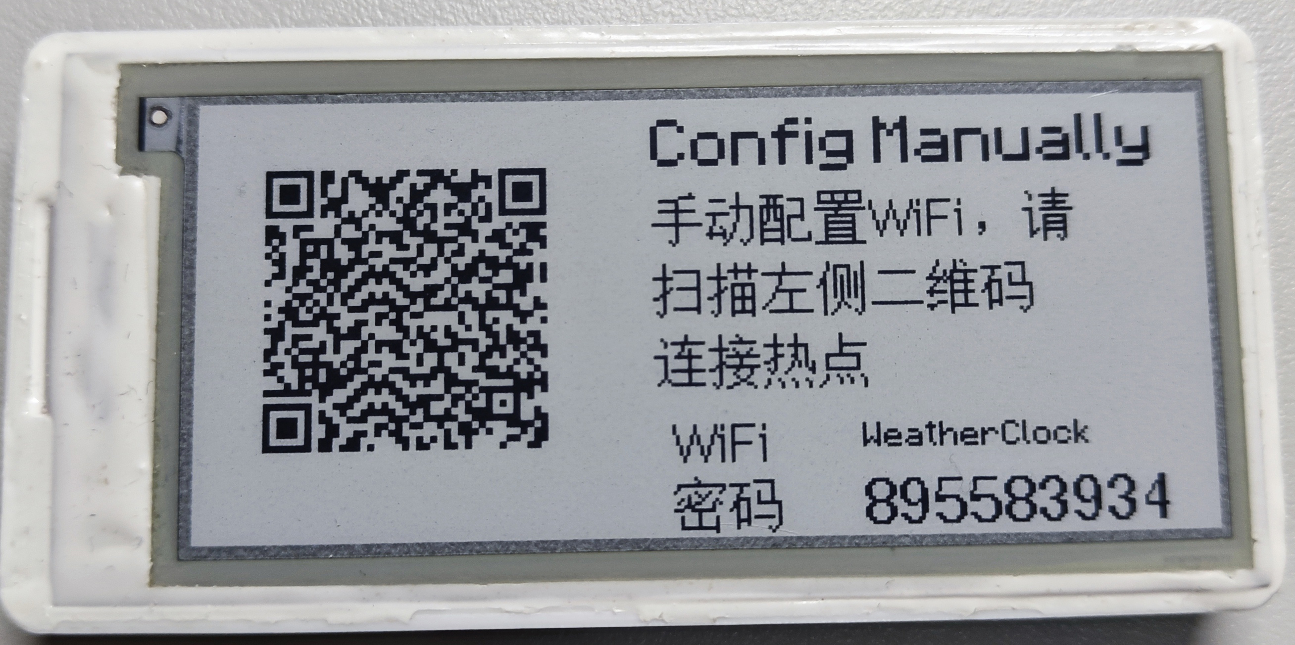

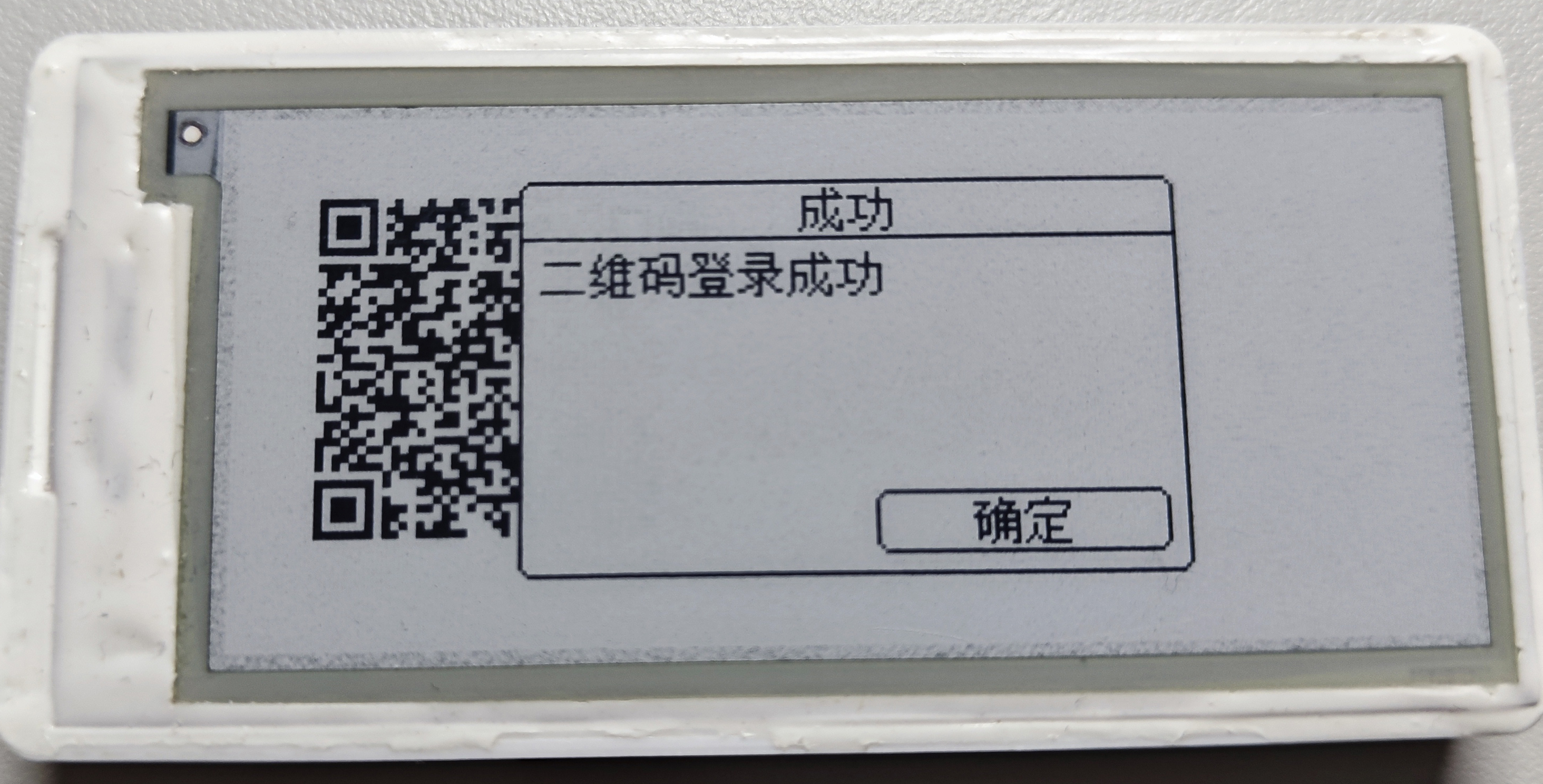

, QR code connection, configuration hotspot (you can also manually enter the password or use SmartConfig),
e-book (long press the left button to go to the previous page, long press the right button to go to the next page, and continue long pressing the right button to enter the menu) ,
Bilibili QR code login
. Cookies have been obtained; the remaining functions are up to you. Actually, it's because I don't know how to design UI [doge].
A simple Bilibili follower count display interface (very simple UI, but more functional than 80% of online works).

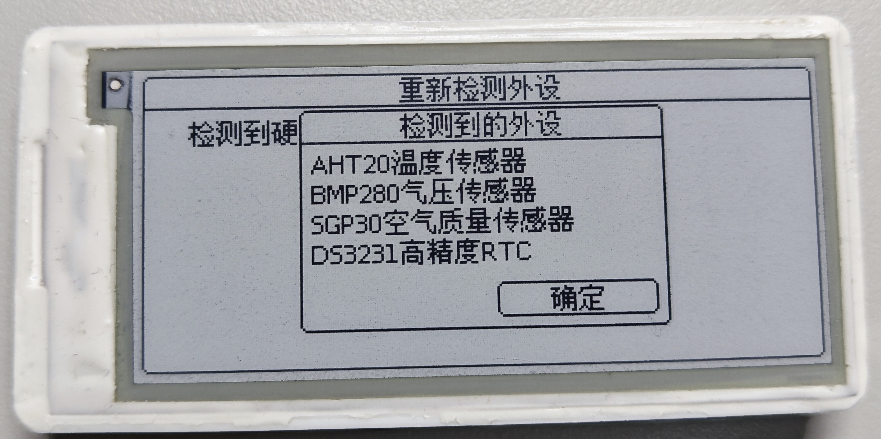

Automatic peripheral detection, which can be used to check if the sensor is correctly soldered
-- Blockly IDE. Introduction --
This feature was developed to solve the problem of custom watch faces.
It allows for easy code modification, project sharing, and reduced compilation and upload time for debugging.
Web interface (you can program using "blocks" on the left or directly edit Lua code, but Lua reverse conversion to Blockly is not supported).
Terminal functionality is implemented using WebSocket; Lua output and errors will be redirected here.
Lua execution results.

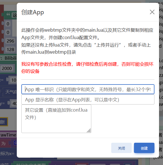

App creation: The
created app, except for being uninstallable or installable from a TF card, functions exactly the same as the built-in app (the built-in app is based on C++).
Detailed program writing instructions can be found in the Github Readme

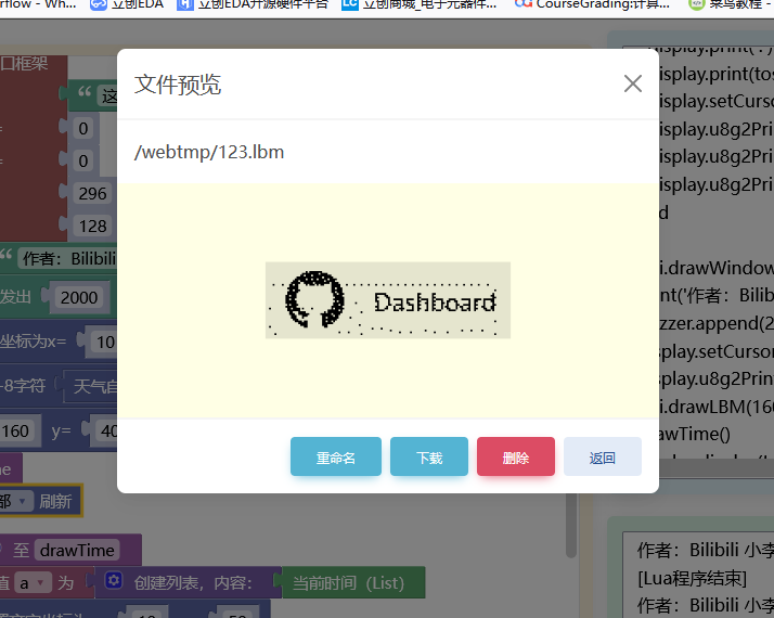

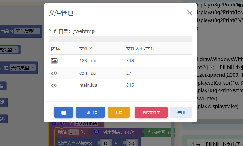

file management
preview. The "lbm" image file (actually an xbm binary, which can be saved as xbm using GIMP and then converted using the xbm to lbm tool in the GitHub repository's tools directory) is also
supported. Lua has implemented relative directories (if you need to access resource files, please place them in the webtmp folder; they will be copied when creating the app; "." represents the current directory, but ".." folders are not supported).
The SD card is mounted to /sd/, and the built-in littlefs is mounted to /littlefs.
The buzzer supports playing .buz files (the Python program for converting MIDI to buz is also located in the tools directory on GitHub).
More Lua functions are being added, and everyone is welcome to contribute their own code or project files.

This time the BOM is very complete, so you can buy directly according to it.
After small-batch production testing, the hardware is no longer buggy. If you encounter problems such as not being able to burn the program, it is only because the soldering is not done properly.
HW3.0 hardware has fixed all the previously mentioned problems. The software only supports version 2.0 and above.
If you choose a connector for the battery interface, it may not be able to fit into the casing.
Schematic Diagram: The entire page of "Optional Functions" can be left unsoldered. The system will automatically recognize what has been soldered.
ESP32 can use the ESP32-WROOM series. The system will automatically adjust the LittleFS partition size according to the remaining Flash capacity.
Do not buy an ESP32 with PSRAM!!!
After soldering, burn the program and follow the OOBE configuration.
One-click firmware flashing: https://diylxy.github.io/LiClockWebFlash/
The latest source code and pre-compiled firmware are at the top of this webpage
(the attachments include the source code updated on December 2, 2023, in accordance with open-source platform requirements).
The 3D model is also in the Github repository.
