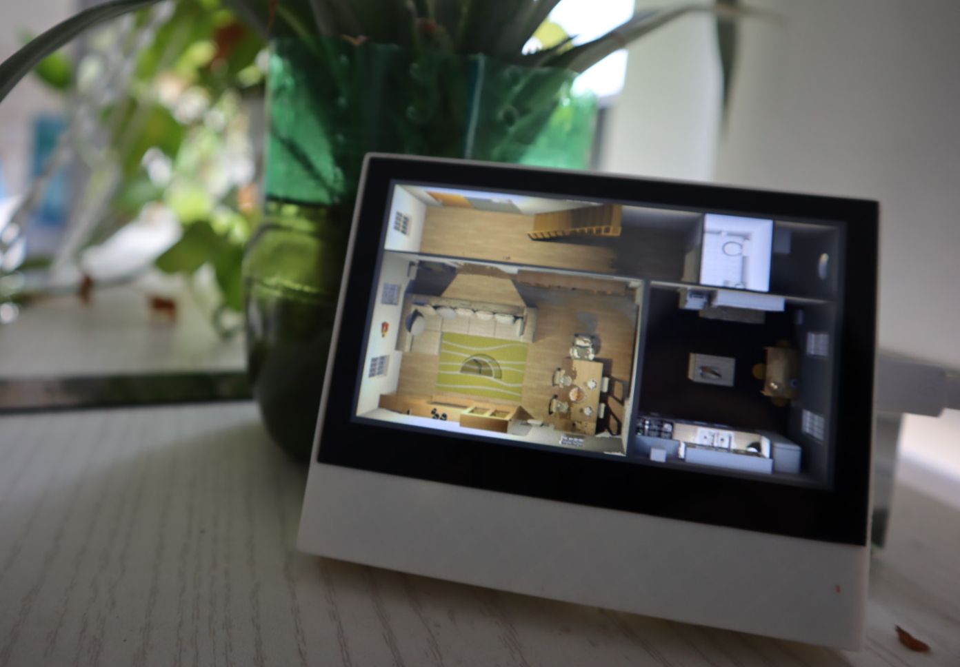

This project describes
how to achieve MQTT communication between devices via a home Wi-Fi intranet and fully integrate with other open-source microcontroller control projects. It aims to promote the concept of customized keyboards to the smart home field, attempting to break the monopolistic ambitions of major manufacturers in the IoT home and the fragmented state of apps. It returns to the core of smart homes, focusing on user experience.
The product is compatible with 86-bit boxes and provides development interfaces.
It uses Allwinner's domestic RISC-V chip D1s as the main controller, with full RGB888 output for the screen display;
it uses an XR829 chip for Wi-Fi + BLE communication.
It runs Allwinner's Tina Linux and the currently popular LVGL framework; it can also run bare-metal RTOS, such as RT-Thread and Melis...

A 4.3-inch screen was chosen because its rectangular shape better suits the apartment layouts of many homeowners (my own home).
Structurally, it is compatible with standard 86-pin box installation.

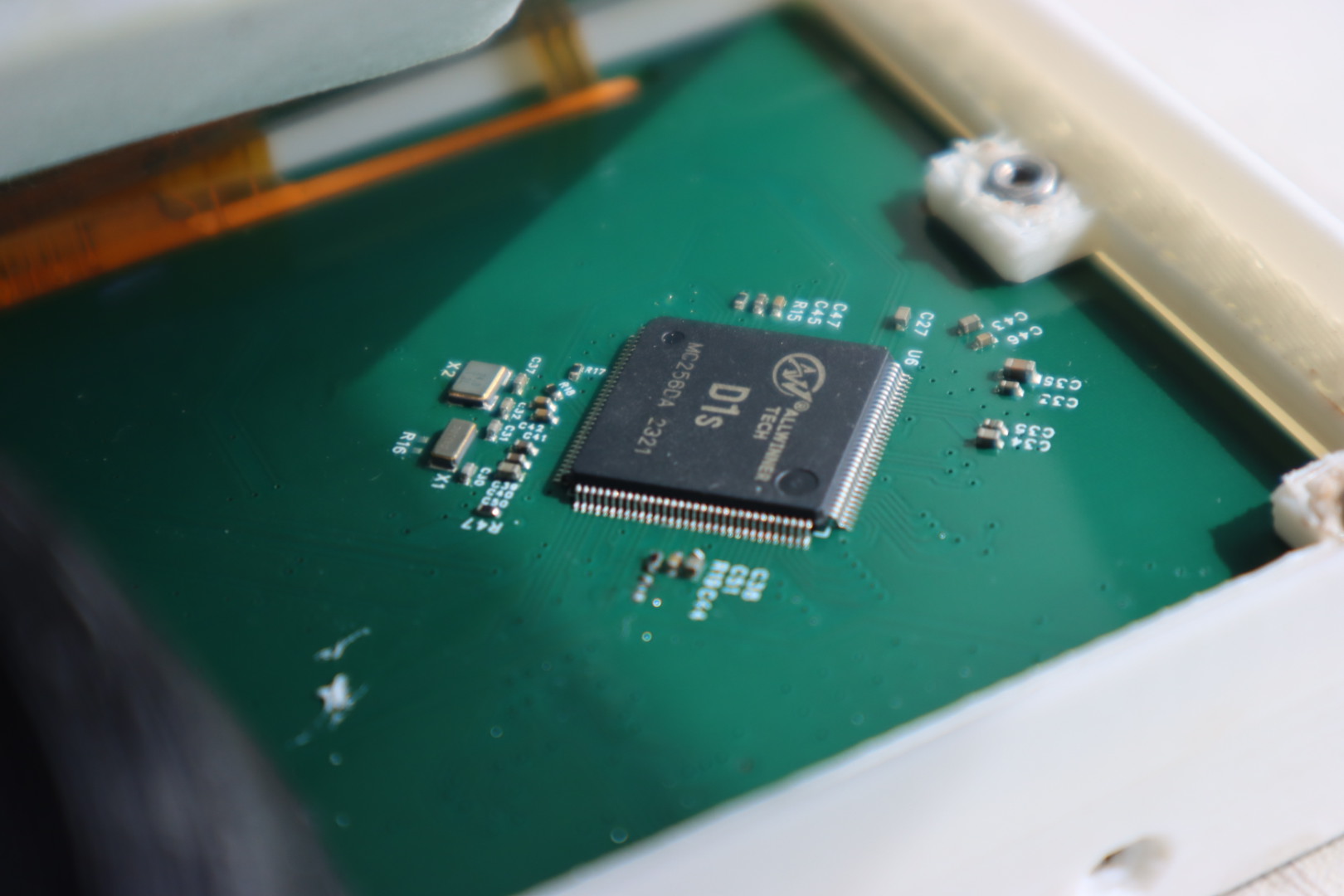

I should be considered one of the earliest developers to work with domestic RISC-V chips (Allwinner D1), so I have a good relationship with the Allwinner team. With the fearless spirit of soldering the main control chip myself and the thrifty spirit of using millet and rifles, I successfully applied for the first PCB and materials in the Spark Program:

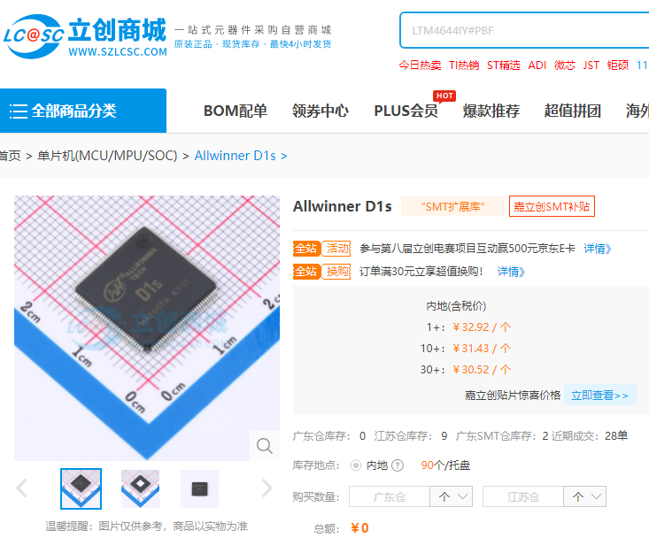

However... I did overestimate the difficulty of soldering the eQFP chip, but after soldering, I found that there were still some minor structural problems. After summarizing the various problems, we started the design of the third version of the PCB. During this period, there were many big and small things, but at the same time, LCSC's SMT component library continued to grow. In the second half of the year, I found that Allwinner D1s had been listed in LCSC's SMT component library! (PS: Allwinner is also in Zhuhai).
After the previous setback, This time, I decisively applied for JLCPCB's SMT (Surface Mount Technology). I also want to thank the Spark Program for allowing me to max out the process:
"It's really good!" To be
honest, the boards produced by SMT at Zhuhai Advanced Plant 2 are truly beautiful.

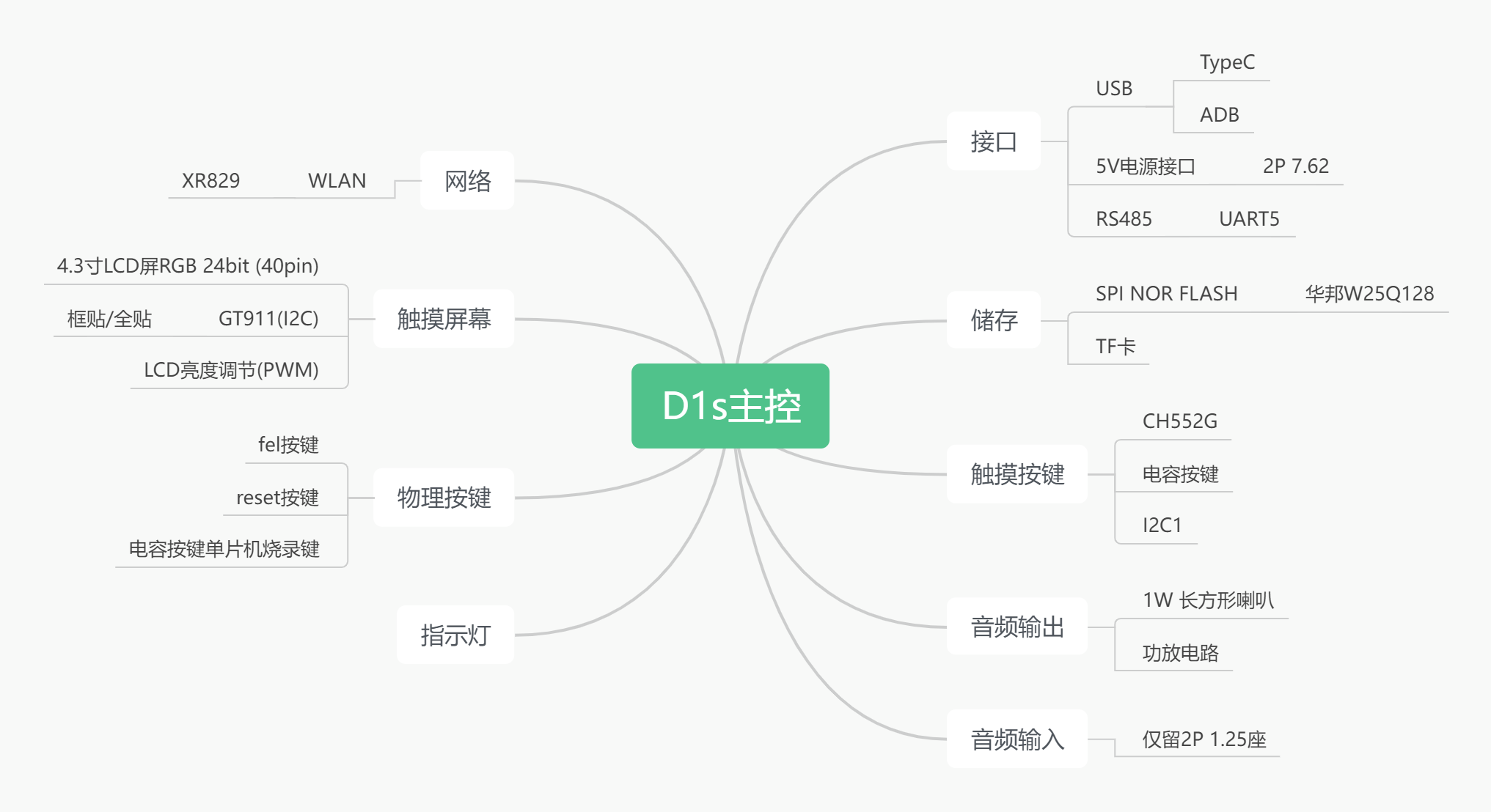

Design principles
are shown in the diagrams below:

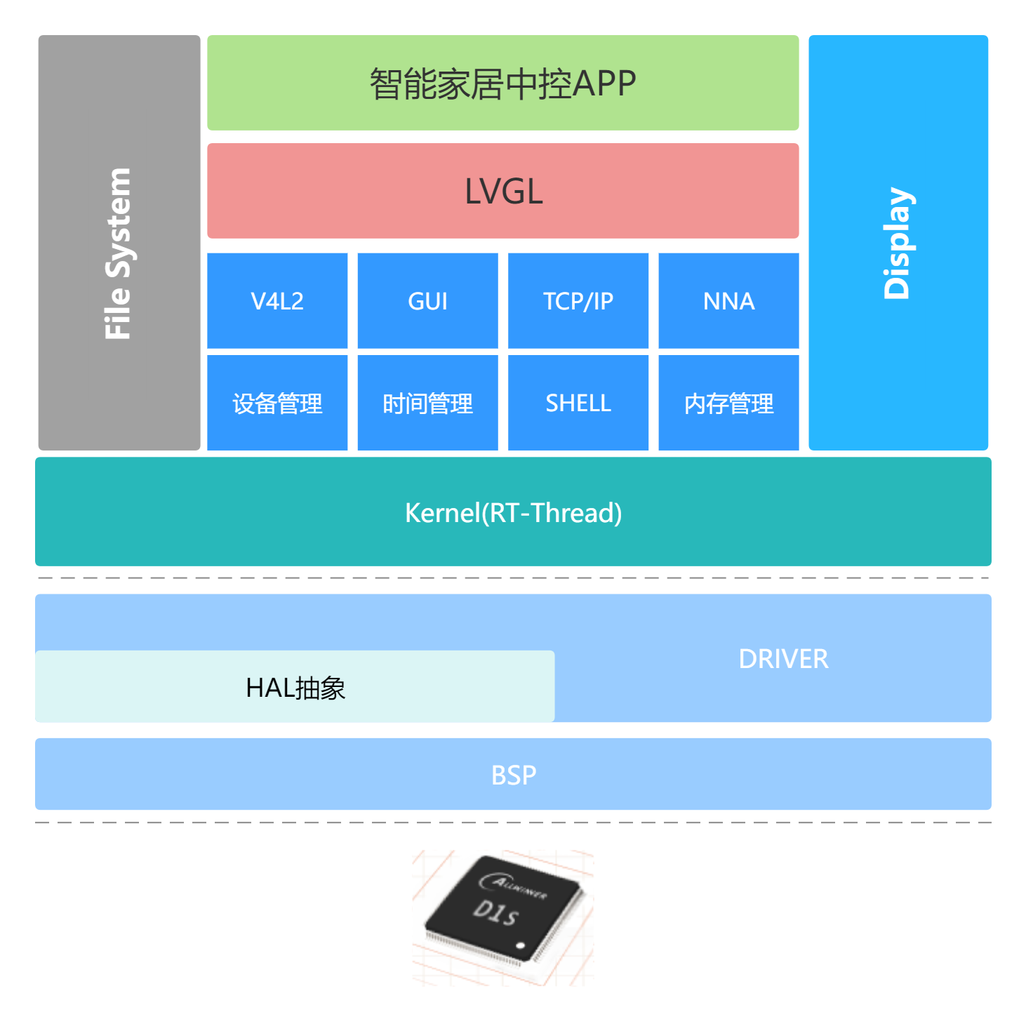

Software Description:
Talk is cheap! Show me the code: The GITEE repository
includes the Melis 4.0 system. I spent several nights filling in the gaps... and even caught a cold... QAQ.
The latest software roadmap and progress will be kept updated in the repository's description~

Software architecture diagram
The plan is to integrate with Alibaba Cloud's MQTT service, currently in the planning stages...
Community experts are porting the NES emulator...

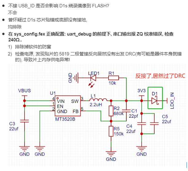

My SMT version requires manual soldering of B5819.
It is necessary to check whether the D1 component is reversed, otherwise it will cause a deep pit of inability to calibrate the on-chip DDR.

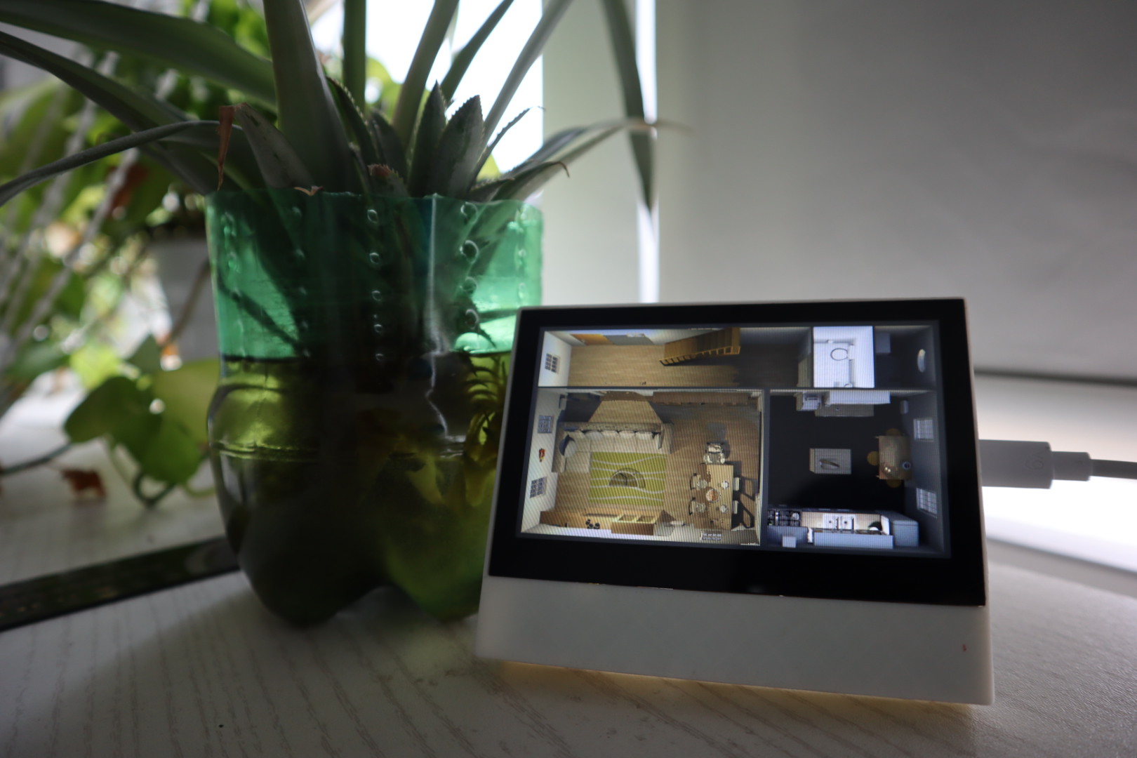

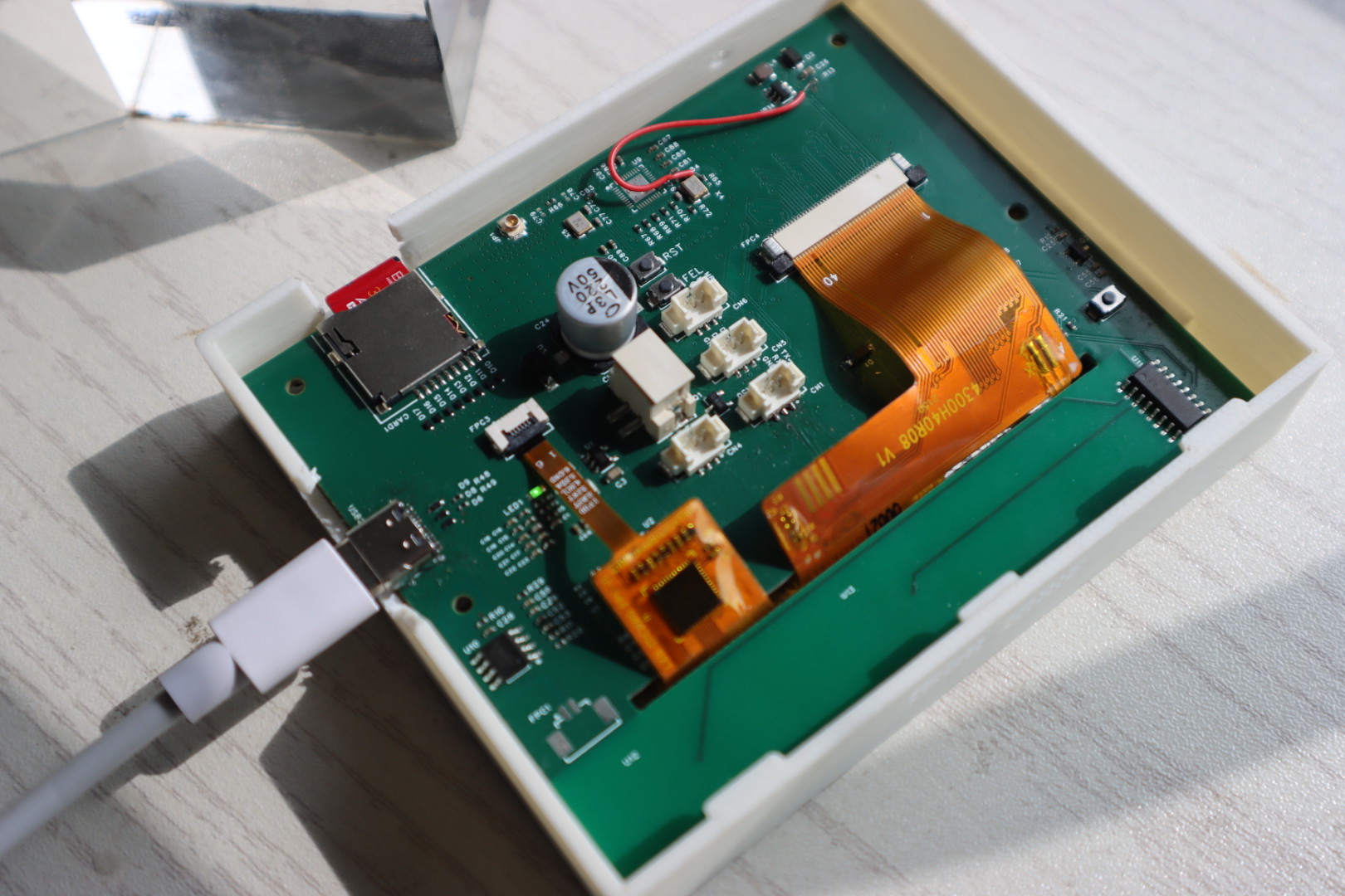

Physical display
taken from Canon EOS M6 MarkII:

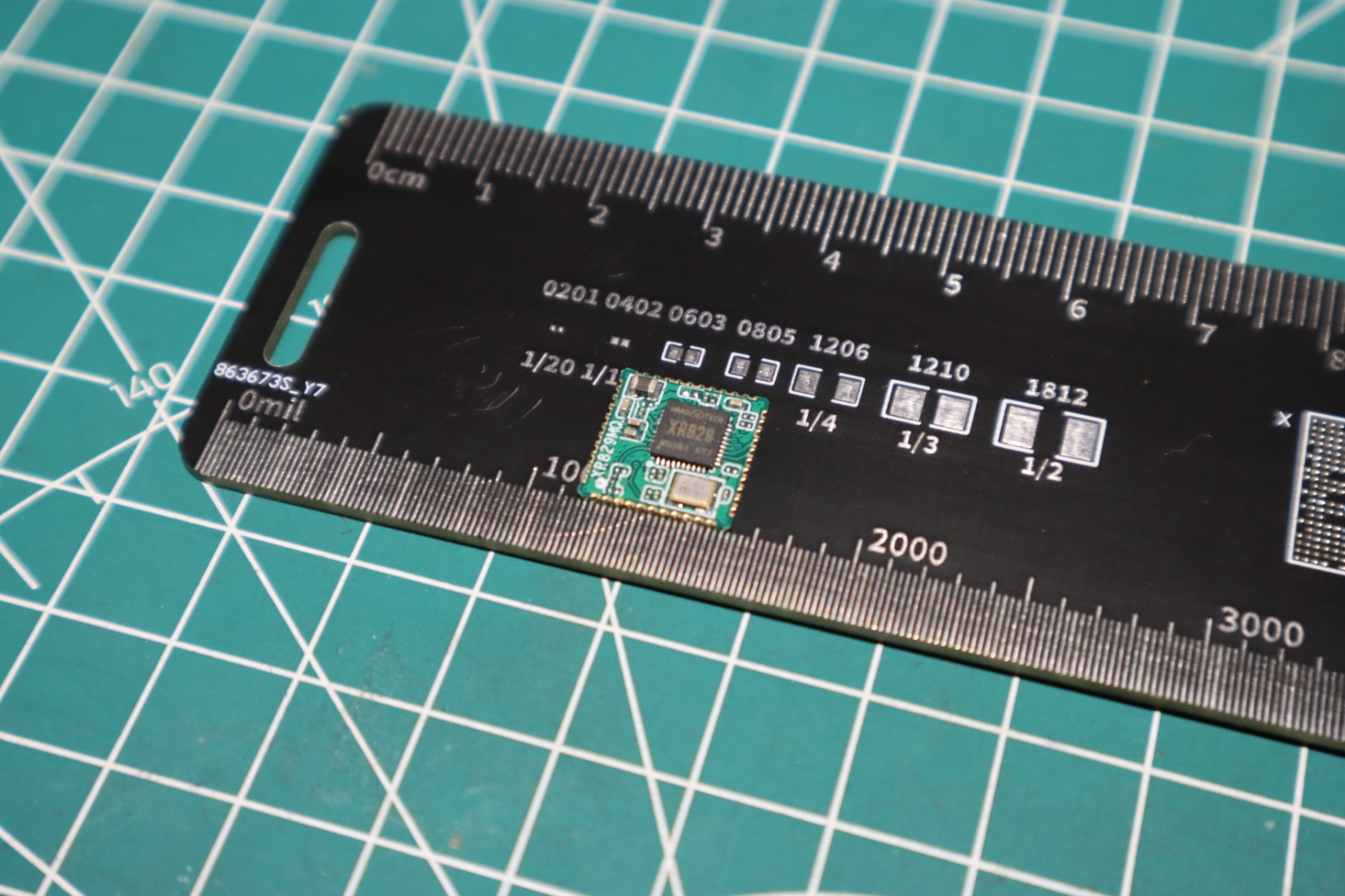

equipped with XR829 wifi+ble integrated module: (The project currently uses the chip instead of the module, and plans to switch later)
