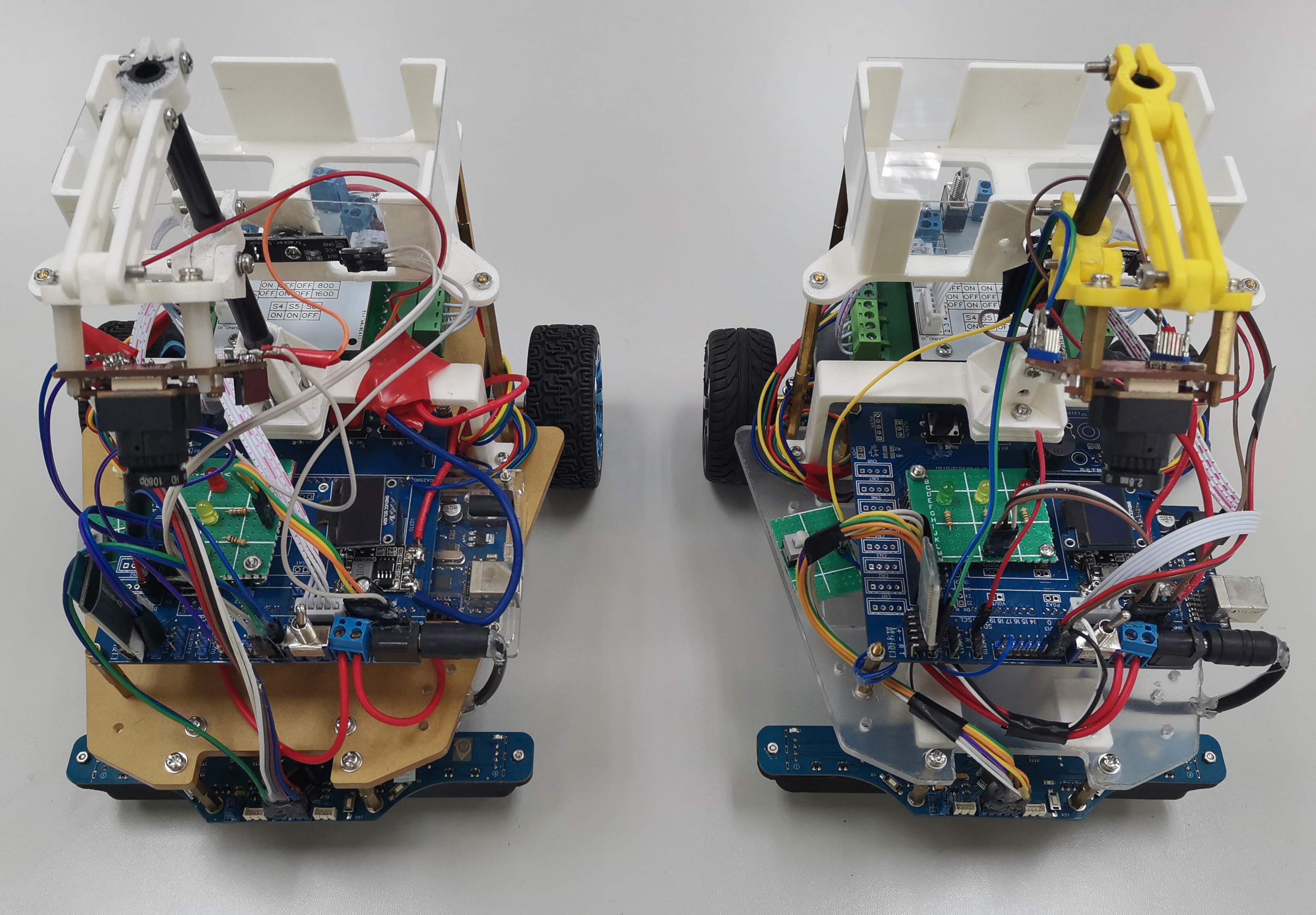

7. Physical display
    Car 1 and car 2 both use the same plan and model. Due to cost reasons, our team only has one openmv4plus on hand, and deep learning can only be run on 4plus. Therefore, Car 2 is equipped with openmv4 and uses template matching for identification.
