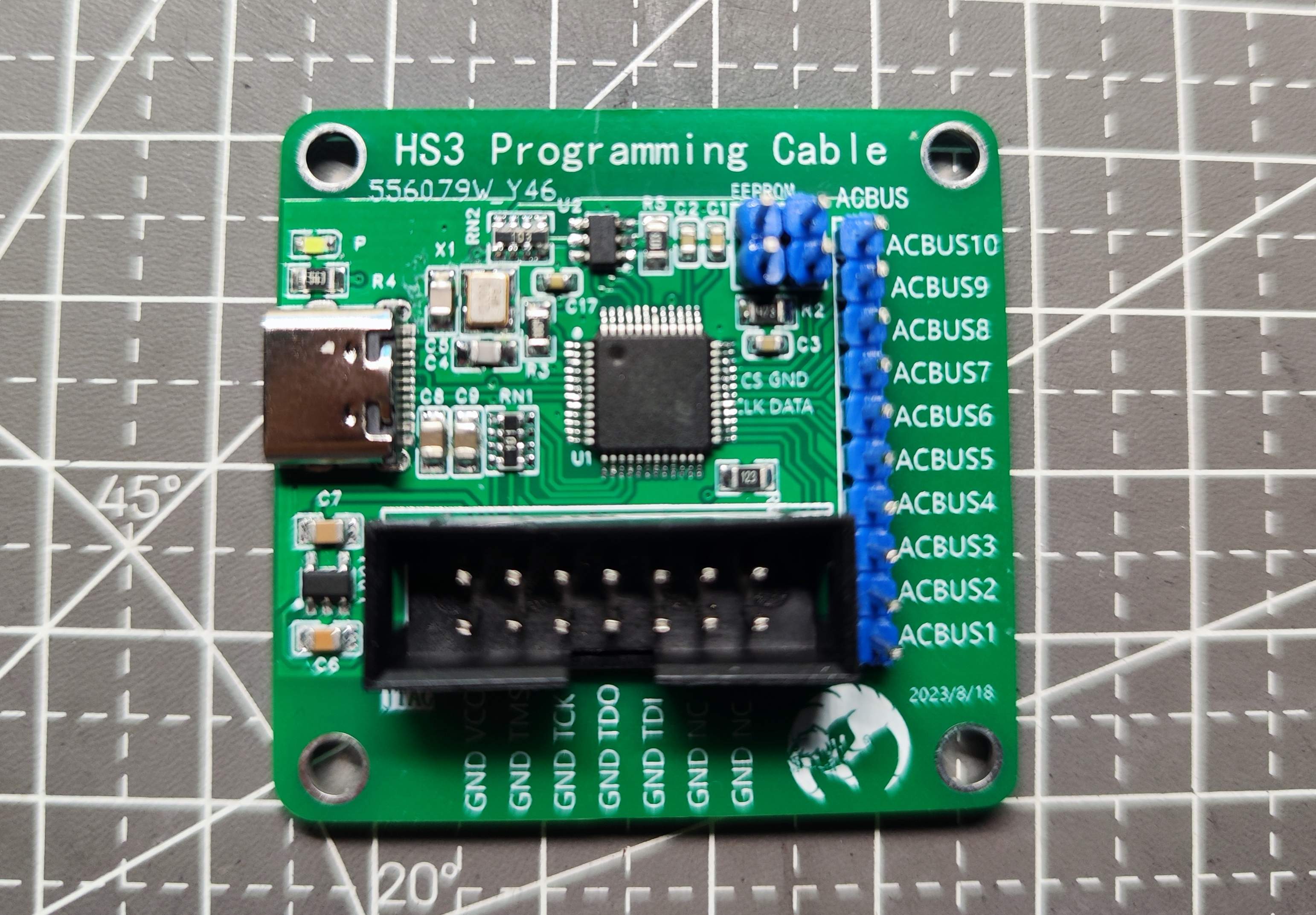

There are two main
types of Xilinx programmers: Xilinx's Platform Cable and Dejie's JTAG HS. Open-source programmers are mostly based on the JTAG HS3, which uses the FT232 microcontroller and has a maximum speed of 30Mbps.
Previously, creating an FT232 programmer required finding firmware and using additional tools to program the EEPROM. Bilibili's TeraiyTech improved the solution, allowing direct EEPROM programming via the FT232. Vivado version 23.1 added programmer creation functionality, allowing control of the FT232 EEPROM programming within a TCL, instantly turning the FT232 core board into a Xilinx programmer.
Official tutorial: UG908
https://docs.xilinx.com/r/2023.1-简体中文/ug908-vivado-programming-debugging/ Schematic reference design for programming FTDI devices supported by Vivado Hardware Manager
: https://china.xilinx.com/products/boards-and-kits/vck190.html#resources
Production steps
: 1. Connect the FT232H core board to the computer and ensure the device is working properly
. 2. Open the TCL terminal and execute the command `program_ftdi`.
Note: Vivado version must be 23.1 or higher.

3. Connect the development board and perform a JTAG scan test. The development board is the ZYNQ
core board from Zhengdian Atom.
