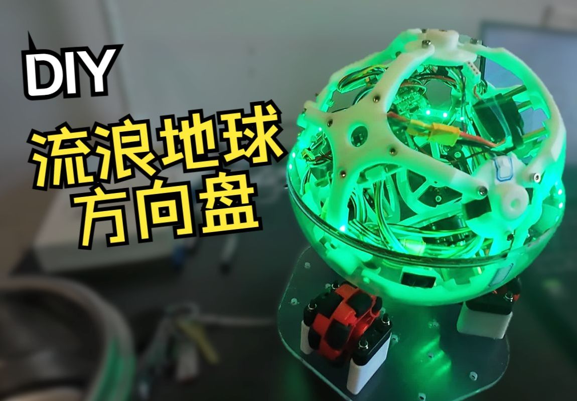

1. Project Description
This project aims to create a spherical version of a balanced cube. In terms of overall architecture, three brushless motors drive three orthogonally mounted flywheels, and the entire sphere rests on a chassis composed of three omnidirectional wheels. Omnidirectional wheels allow movement in both the forward direction and axial direction. Therefore, a chassis composed of three omnidirectional wheels allows a balancing ball to perform three-degree-of-freedom, full-attitude free maneuvering. The ball, on the omnidirectional wheel chassis, achieves full-attitude free maneuvering using the principle of conservation of angular momentum. Additionally, the balanced cube created in this project can be connected to a computer and used as a steering wheel for various racing games, with operation similar to the steering wheel in the movie *The Wandering Earth*.

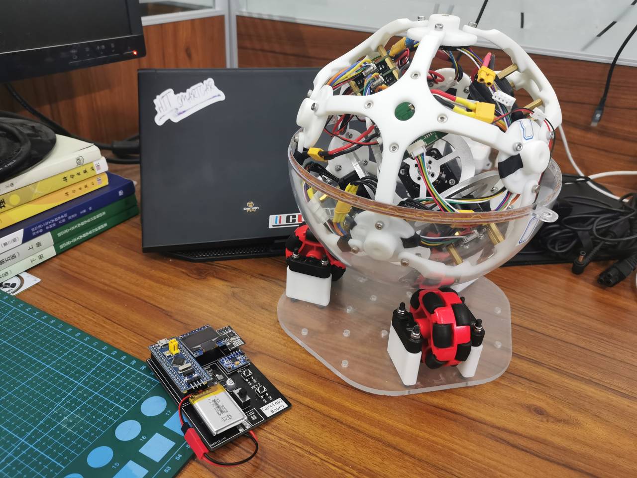

4. Project-related functions and physical demonstrations:
The balance ball allows for free rotation in all postures;
the balance ball features three-axis angular velocity closed-loop control and assist mode
; and the balance ball's three-axis attitude tracking requires a terminal to enable
real-time publishing of its own three-axis attitude. It can mimic the steering wheel in the game "The Wandering Earth" for playing various racing games .

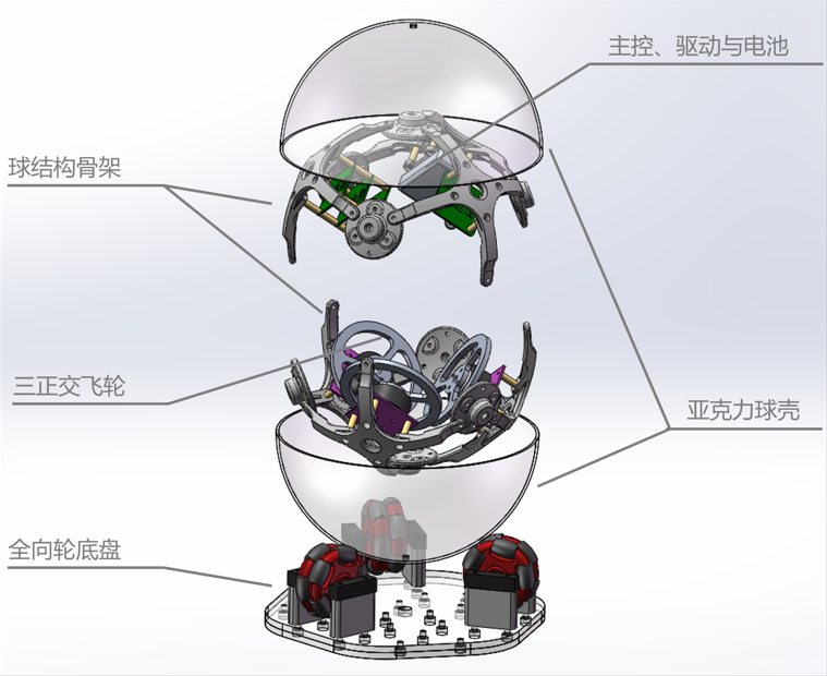

5.1 Structural design

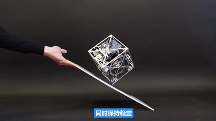

: The structural design concept of the project largely references the classic balance cube of Zurich:
As shown in the diagram, the balance cube has six faces, which can be divided into upper three and lower three faces according to their distance from the ground. It is clear that the three orthogonal flywheels of the balance cube are installed on the lower three faces, while the battery, circuit board, etc., are installed on the upper three faces.
Based on the principles of solid geometry, it is logical to assume that a cube has a circumscribed sphere. Taking the circumscribed sphere of the balance cube and projecting all six faces outwards onto it, we get our balance ball.
The 3D model established based on this is as follows:

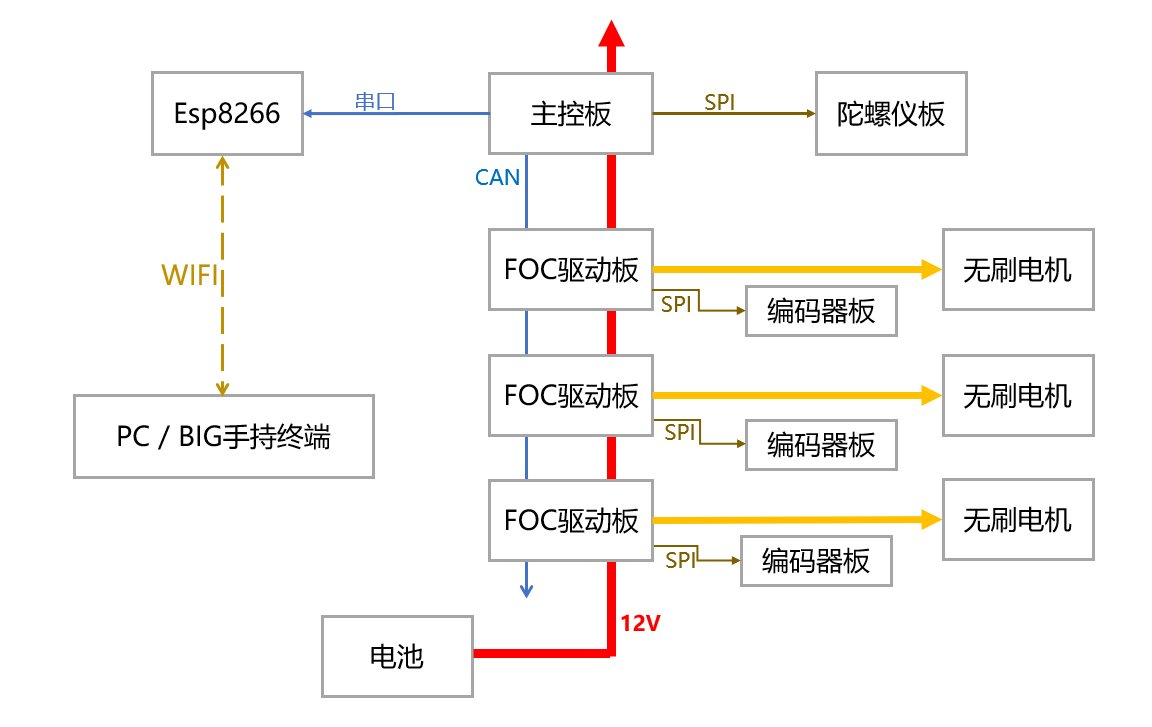

5.2 Hardware Design
This project designs a main control board, an FOC driver board, an encoder board, and a gyroscope board. The project hardware topology diagram is as follows:
Among them,

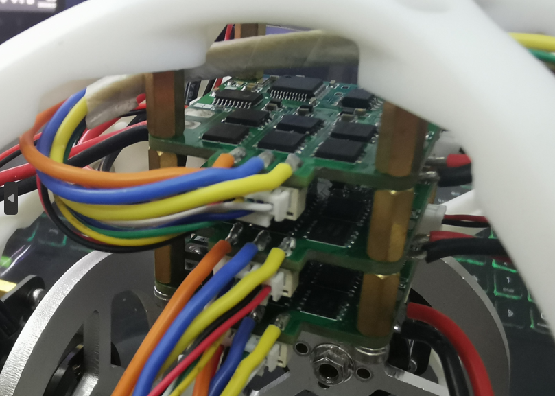

the main control board and the FOC driver board are all powered by cascading and also transmit target commands through cascading via CAN bus.
There are three FOC driver boards in total. Each FOC driver board is connected to an encoder board to obtain the position of the brushless motor and drive a brushless motor.
The main control board is connected to a gyroscope board to read attitude information in real time.
The main control board is connected to an ESP8266 communication module .

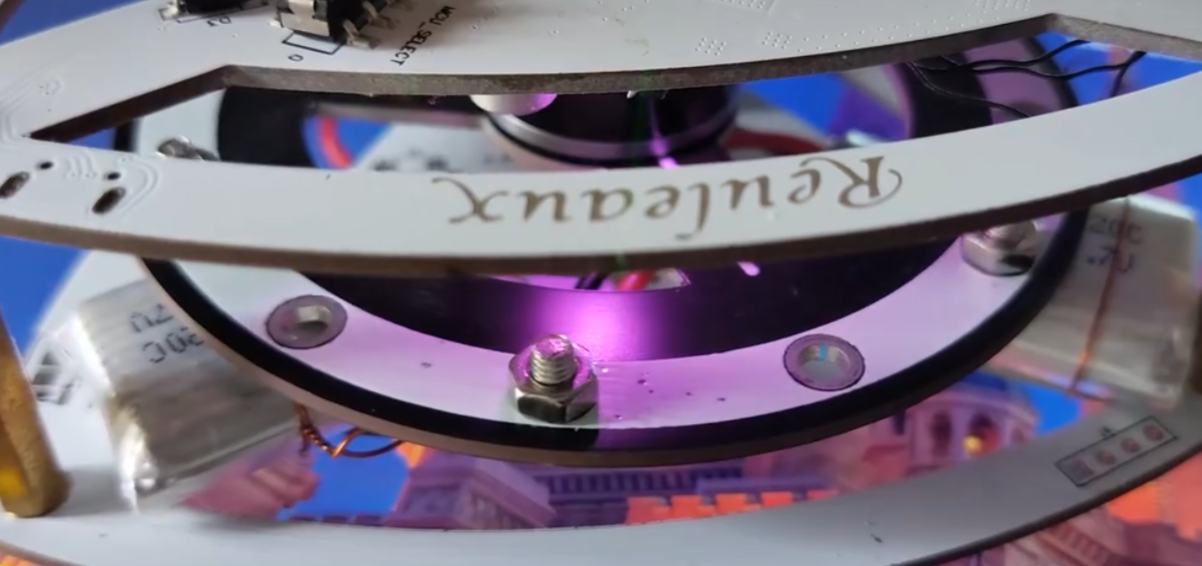

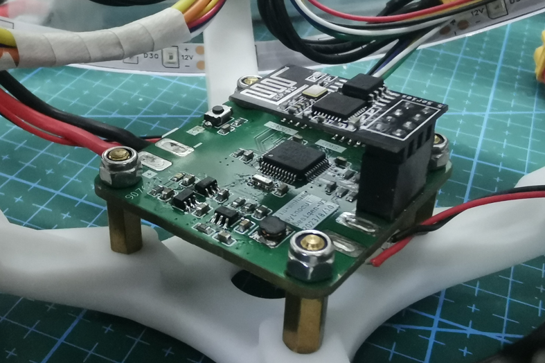

5.2.1 Main Control Board
The main control board is a four-layer board, which can be printed free of charge by JLCPCB. It mainly completes WIFI wireless communication, reading gyroscope attitude, attitude calculation, control mode management, and control algorithm operation.
Main controller: STM32F103C8T6;
Crystal oscillator: Murata CSTCE 8M ceramic tripod crystal oscillator (same as the one used in Zhihuijun's robotic arm, no load capacitor required);
CAN communication chip: TJA1050T (note that 5V power supply is required, otherwise the microcontroller's CAN transmission and reception will freeze )
; Power management: JW5026+ME6211;
Wireless communication: classic pin-type Esp8266
; all sockets used in the wireless communication module are GH1.25 model;
all can be purchased on Taobao, the estimated cost price for a set is approximately 30 RMB (electronic component prices may vary).
Matching encoder board: ICM20602, MPU6050, ICM42688P (currently has issues, overheating severely, please use the ICM20602 module instead).
Note: The encoder board is fixed to the innermost apex of the sphere using hot melt glue, parallel to the ground.
5.2.2 Driver board:
The driver board is a four-layer board, which can be printed free of charge by JLCPCB. The driver board primarily handles the FOC speed closed-loop drive.
The driver board design references the Lemon FOC open-source board and is based on the GD32 microcontroller.
Reference address: [Happy New Year] Lemon FOC Open-Source Board - JLCPCB EDA Open-Source Hardware Platform (oshwhub.com).
The driver board hardware is independently designed, and the software is directly programmed with Lemon FOC code. The original open-source project allowed setting current, speed, and position closed-loop modes via PuTTY serial port assistant; however, due to project requirements, a speed step change mode was adopted here.
When using the original firmware, be sure to modify the power undervoltage protection and speed protection parameters in the serial port debugging assistant to prevent motor stoppage caused by excessively rapid speed changes.

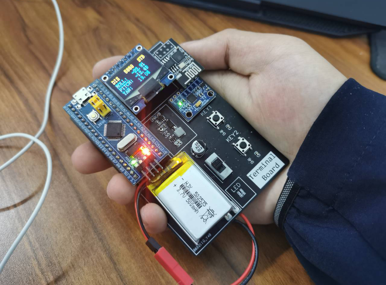

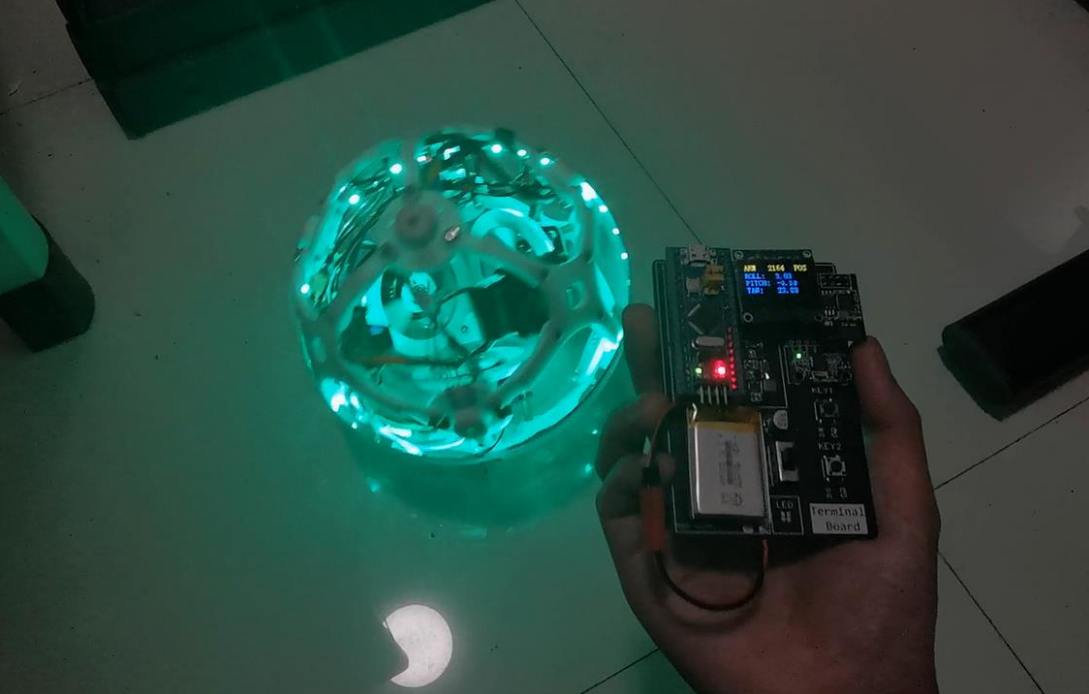

5.3.3 BIG Handheld Terminal:
The BIG handheld terminal is a two-layer board, which can be printed free of charge by JLCPCB. The BIG handheld terminal mainly performs functions such as remotely changing control modes, safety management, real-time status display, and publishing target pose.
This module is modeled after Zhihui's PICO small terminal design, mainly completing some human-computer interaction functions. Because it's geared towards beginners, it looks rather rough. Since PICO means small, and Zhihui's PICO is indeed very small, but my handheld terminal is quite large, I named it BIG.
The handheld terminal parameters are as follows:
Main controller: STM32F103C8T6 sapphire core board;
Display: 7-pin OLED display, SPI mode;
Battery: 1s 300mAh lithium battery;
Gyroscope: Classic MPU6050 module;
Wireless communication: Classic pin-type Esp8266 wireless communication module.

5.3.2 Three-Axis Attitude Tracking and Follow-Up:
Building upon Section 5.3.1, attitude angle feedback is added. The BIG handheld terminal collects its own attitude as the target value for the balancing ball's attitude. The difference between this target value and the actual value of the balancing ball's attitude forms the PID controller. This ultimately achieves three-axis attitude tracking and follow-up.
Because the omnidirectional wheel chassis introduces significant friction into the system, this function currently requires the ball to be placed directly on the ground, not on the omnidirectional wheel chassis.
Considering the limited effectiveness of pure PID, this project will later deploy control algorithms such as LQR for further comparative testing.

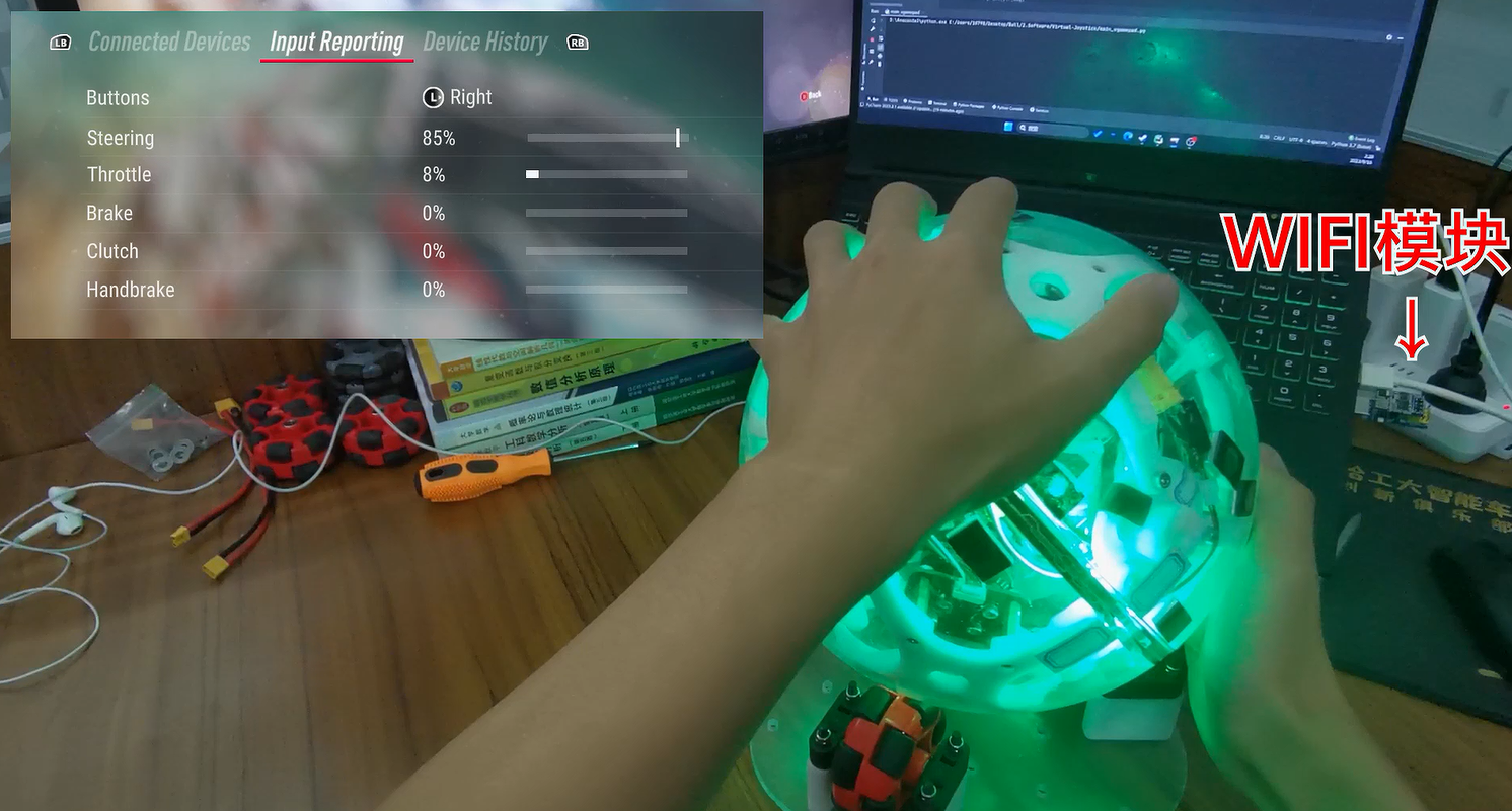

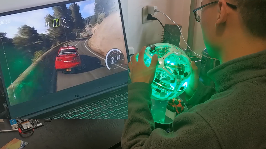

5.3.3 Playing Racing Games as a Steering Wheel
We accidentally discovered that our ball is very similar to the spherical steering wheel in The Wandering Earth. Therefore, we used a Wi-Fi module to connect to the computer, received real-time attitude information from the spherical simulator, and used the Python vGamepad library to map it to virtual Xbox game controller joystick values ​​(steering wheel, accelerator, brake, etc.). This allows us to recognize the virtual game joystick in racing games like DiRT Rally 2.0 and obtain control data.
Because the control data is encapsulated in the form of an Xbox controller, there are no compatibility issues regardless of the racing game played.

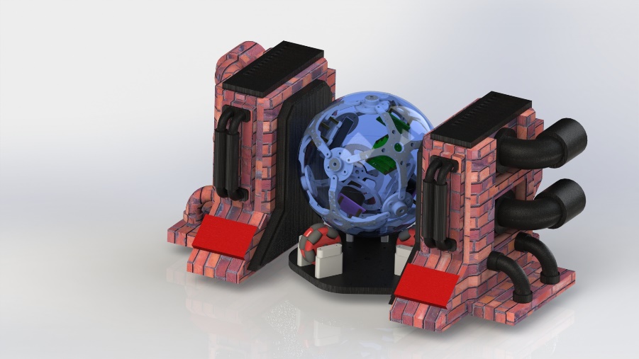

5.4 Concept Design (Fun)
The ball can be transformed into many interesting things by adding outer decorations. For example,
anything round can be used to capitalize on a trend.

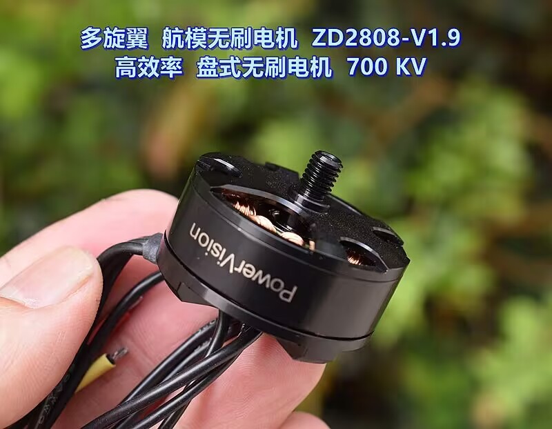

6.2 Motor Selection
The selection of flywheel and brushless motor is very important. Due to the high friction of the entire system, the low-kV gimbal motors used in the common Reilly triangle and balance cube in the open source community are difficult to meet the torque requirements. I accidentally found this motor on Taobao's second-hand motor section:
After testing, the load capacity of this motor is very suitable for this project, the cost is low (only 16 yuan), and it saves space. Considering that these used motors are often sold out quickly, if they become unavailable, a DJI 2312 Phantom motor could be considered as a replacement.
Additionally, if the aluminum alloy flywheel provides insufficient reaction torque, a solution similar to this open-source project could be used to create a custom flywheel and drill holes in the outer edge to install bolts, increasing the flywheel's moment of inertia.
Reference: Self-balancing Reilly triangle based on LQR controller (Bilibili

7. Project Progress (
First Open Source, August 30, 2023)
: Completed parts:
All structural and hardware design and construction are complete; the structural and hardware design is mature and convergent.
All logic code is written.
Basic control algorithms are written, enabling basic angular velocity and attitude closed-loop control.
