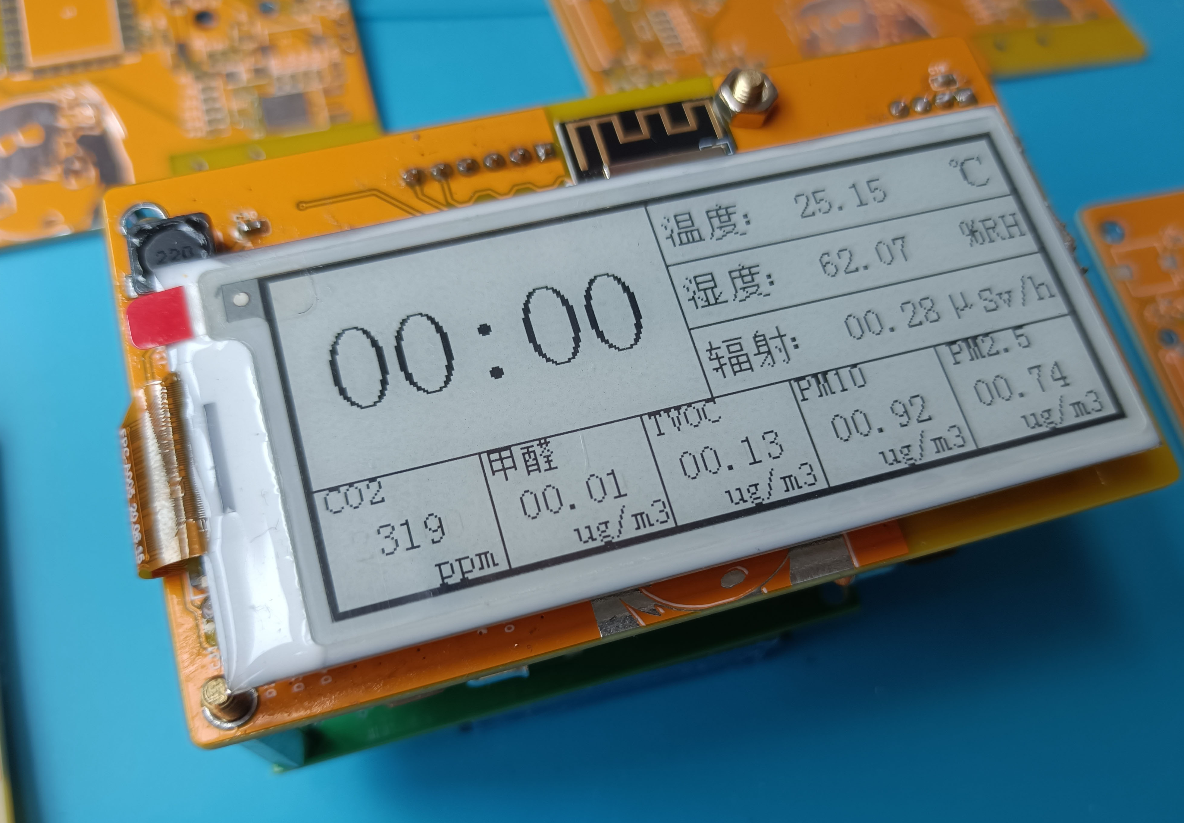

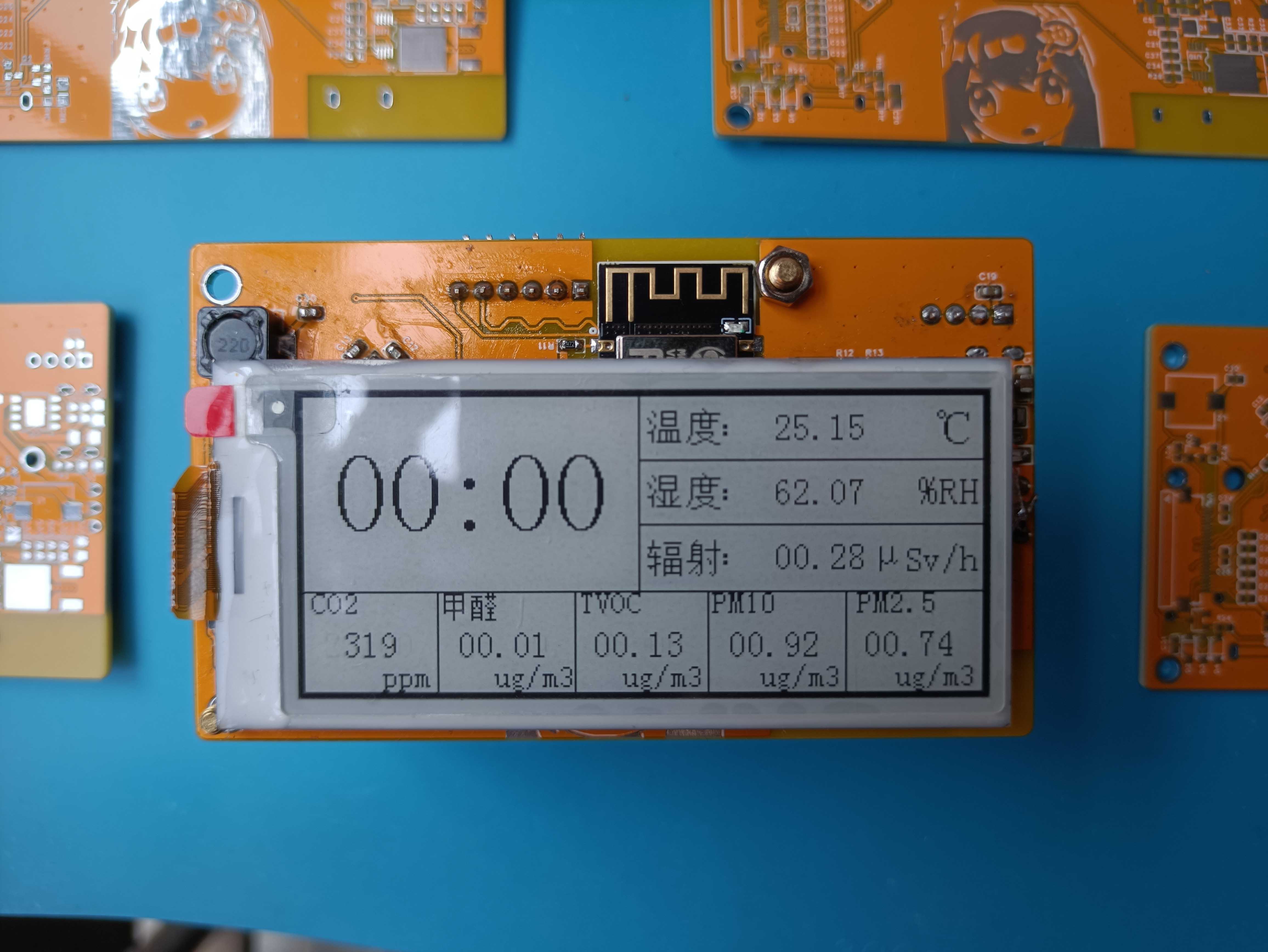

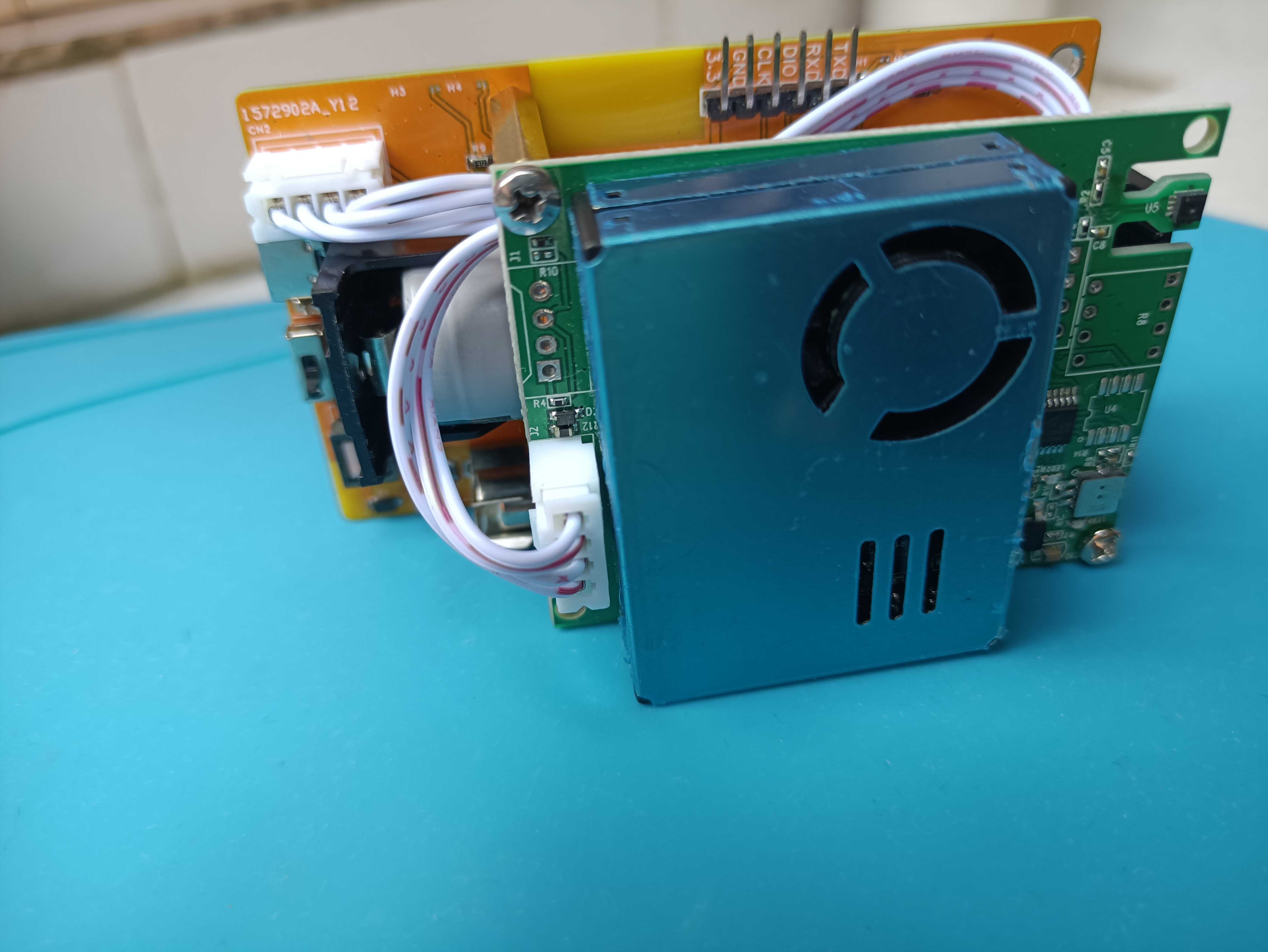

* 1. Project Function Introduction: This project
can detect formaldehyde, CO2, TVOC, PM2.5, PM10, temperature, humidity, and ionizing radiation. It uses an N32G430C8L7 as the main control chip, an ESP12 as a Wi-Fi module for network connection, an e-ink display using SPI communication, a seven-in-one air quality transmitter connected via serial port, a Geiger counter sampling via ADC, and a built-in 18650 battery allowing for mobile detection. Charging is via a Type-C interface.

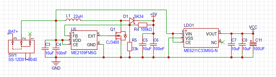

1. Power Supply Circuit
: 1. Select ME6211 C30 or higher (A suffix indicates different package sizes). The maximum operating current varies depending on the suffix; please refer to the relevant manual.
2. The 100uF capacitor can be modified or removed based on cost (the first version used 1117, this tantalum capacitor is a legacy), keeping it is better.

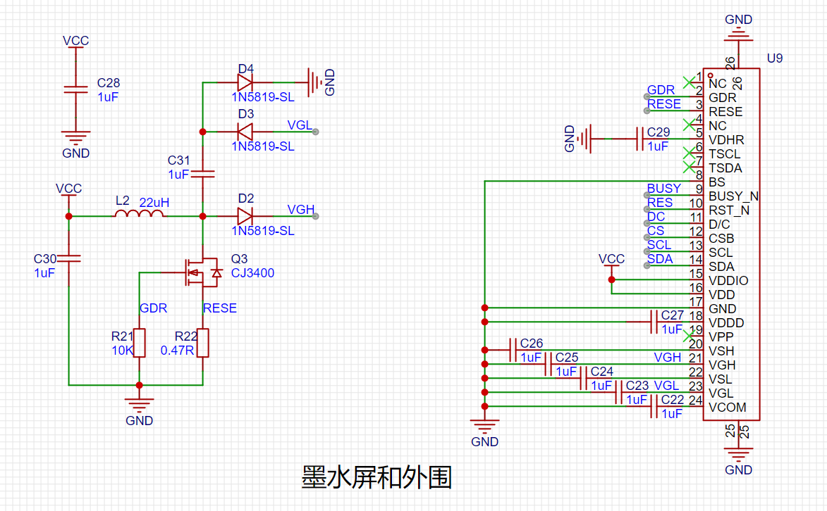

2. E-ink Screen Circuit:
1. The inductor model can be smaller; please refer to the official circuit.
2. The e-ink screen interface header is 24-pin.
3. This project uses a Zhongjingyuan 2.9-inch e-ink screen.

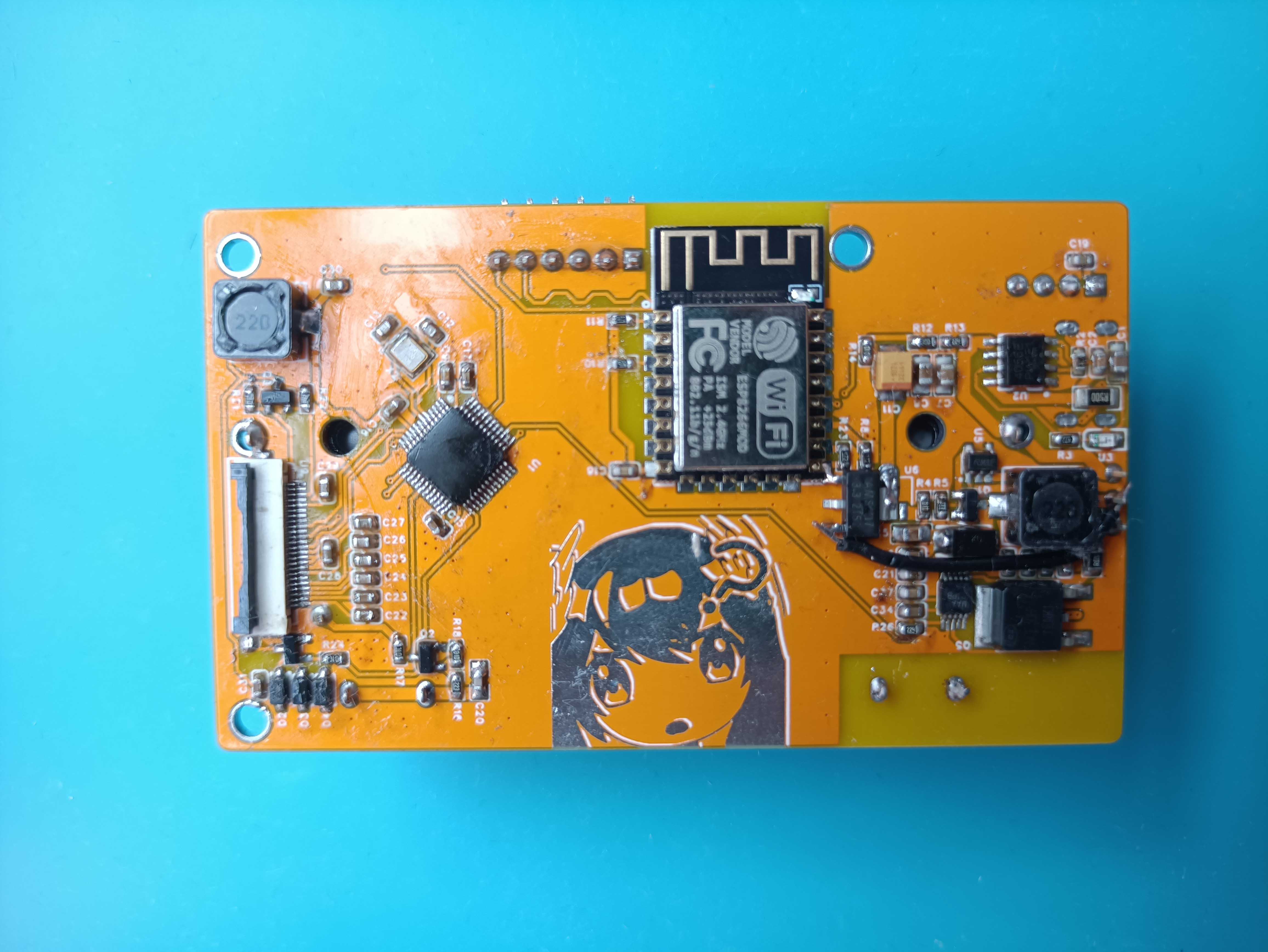

3. MCU Circuit:
1. Use 0201 pads to bring out the BOOT and RST pins instead of shorting them.
2. Pin compatibility with STM32F103C8T6 (but STM32 program not written).

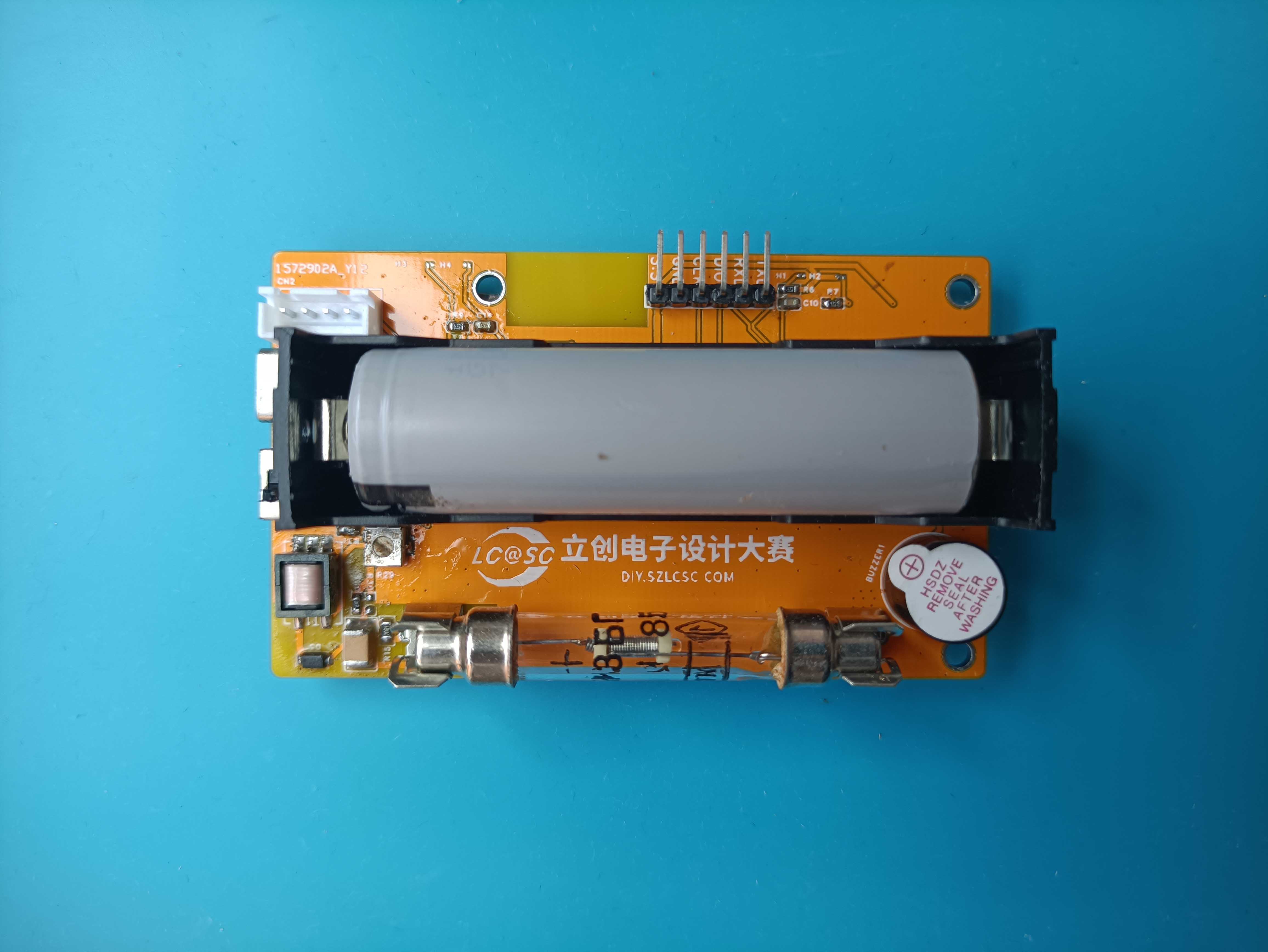

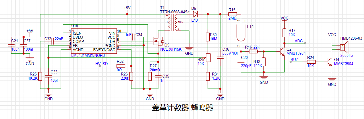

4. Geiger transistor circuit
: 1. Due to the high cost and scarcity of the 060S-045 transformer, I actually used the 060S-058, turns ratio 1:18, 120uH.
2. Measure the voltage across C36, rotate potentiometer R29 to fine-tune the output voltage to 400V. If the voltage is insufficient, reduce the resistance of R31.
3. HV_SD is the boost enable pin. If the microcontroller control pin cannot control the enable, remove the 0 ohm pin and abandon the enable function.
4. After completing the board, I realized the LM3481 is too expensive. If possible, I suggest choosing other Boost converter chips as alternatives, even a 555 would be fine.
