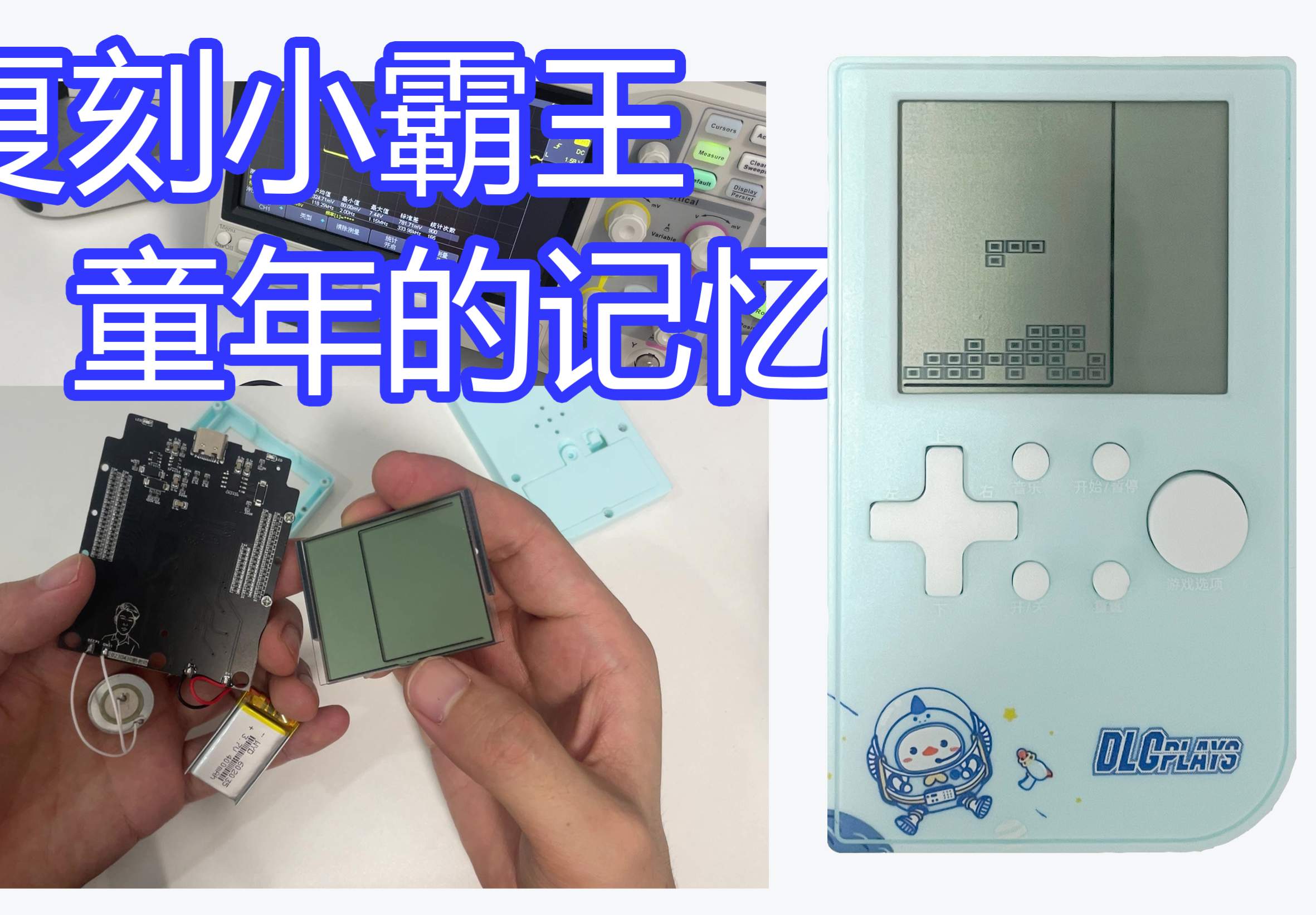

The game console shown in the picture below is familiar to many born in the 80s and 90s. In the era before widespread mobile phones, these inexpensive game consoles brought joy to many children's childhoods.
Classic games like Tetris and Battle City are deeply ingrained in the memories of a generation.
When I was an undergraduate, after finishing my studies in microcontrollers and displays, I really wanted to make a game. I remember using a Nokia 5110 screen and even finishing half of it before my lab supervisor criticized me for neglecting my studies, so I abandoned it.
I've always believed that game programming involves far more logic than ordinary projects, and learning microcontrollers through game projects can better train students' thinking and cultivate their interest in learning. So, after starting work, I restarted this project, hoping to provide a platform for electronics enthusiasts to create small games.
The project uses a 51 microcontroller as the main control chip and borrows the original game console's casing, screen, buttons, and speaker to implement the Tetris functionality. In addition, the power system of the original game console was upgraded to a lithium battery with a Type-C charging interface, making it more in line with modern usage habits. The biggest highlight of this project is the use of the original game's screen, enabling the development of an authentic game experience. The core components of the entire product are shown in the image below.
This product might be a bit childish for elementary school students, but it's perfect for university students.
It can serve as an everyday toy for electronics enthusiasts, as well as a game development device, helping to cultivate basic game development thinking and increasing beginners' interest in electronics and programming.

First, several similar game consoles were purchased, and this model suitable for modification was selected.
Then, it was disassembled to analyze its working principle. These game consoles almost all use dedicated chip chips, making it difficult to obtain information from the chip itself.
3.2 Drive Principle Analysis
By measuring the signals on the circuit board with instruments, it can be found that the buttons change between high and low levels, and the buzzer is a PWM signal. These are relatively simple to analyze.
The complex part is the LCD screen drive signal. This type of screen mostly uses multi-level scanning drive, and there is relatively little relevant information online, so it has to be explored little by little. Using an oscilloscope to observe the waveforms of the 36 CD drive pins, it can be found that their level forms are roughly divided into two categories. One type is the waveform signal shown in the figure, which is very regular, with four level segments: VCC, three-quarters VCC, one-quarter VCC, and GND. The other type is a relatively irregular waveform signal, with three level segments: VCC, half VCC, and GND.
Based on scattered information found online, the regular signal is from the COM pin, and the irregular signal is from the SEG pin. Simply put, the COM pin controls which column the screen is currently scanning, and the SEG pin controls which row.
