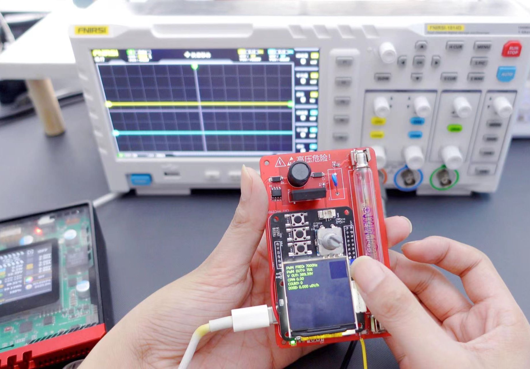

Let's make a Geiger Counter that's a bit risky.
The core working principle of a Geiger tube:

We chose to try a solution that directly uses the MCU to generate PWM
(using a PWM capable pin for PWM signal transmission) .

1. Boost Circuit:
        Since the on-state voltage of the N MOSFET IRFP450 we selected is 4V, while the I/O voltage of our MCU module is 3.3V, the PWM signal generated by the MCU needs to be amplified to a sufficient voltage to fully turn on the MOSFET. Ultimately, we chose the EG3001 as the driver chip. The circuit can boost the voltage normally when VCC is 5V. When selecting a MOSFET, please choose a model with strong voltage withstand capability.
2. Pulse Detection:
        When high-speed X-ray particles enter the Geiger tube, the high-speed particles can cause ionization of the low-pressure gas inside the tube, leading to gas breakdown and rapid discharge, resulting in an output pulse current signal. The count of the pulse signal, i.e., cpm, is calculated/adjusted and displayed on the screen, or combined with functions such as a buzzer, to intuitively reflect the measurement of X-ray particles, i.e., the intensity of radiation. Here, we use IO14 as the pulse signal monitoring port.

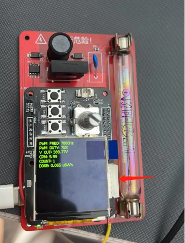

3. MCU and Display:
        We designed a pluggable MCU module with reserved encoder, buttons, I2S, and screen. This allows it to be plugged into the Geiger counter board or other modules, and supports development and experimentation with other MCU solutions such as STM32/CM32. Meanwhile, since the board has a reserved I2S circuit to replace the buzzer, it can support playing various sounds for audio alerts.
        By adjusting the encoder, you can see the voltage under different duty cycles and the number of Geiger tube breakdowns. Our current PWM frequency is set to 7kHz. After reducing the PWM duty cycle from 75% to 50%, the voltage drops to 250V, which is lower than the minimum operating voltage of the Geiger tube, and the CPM value drops directly to 0. In actual use, since the 7kHz frequency is audible to the human ear, you will hear a faint buzzing sound. If you don't want to hear it, you can replace the inductor and capacitor to find a suitable PWM frequency. The software

        As we know from the principle of the Geiger tube, when the Geiger tube detects the presence of ionizing radiation particles, the inert gas inside is broken down, generating a pulse signal, which is also the number of breakdowns. The basic counting parameter of the Geiger counter is the number of breakdowns per minute, or CPM. The more particles, the higher the CPM, and the greater the radiation dose. However, in various news reports, professional literature, or popular science articles, the unit of measurement we usually see is radiation dose units like uSv/h. Therefore, the core problem of software implementation is how to convert the CPM count value into radiation dose data that we are more familiar with.
        In fact, each Geiger tube is provided with a conversion factor at the factory, which is used to convert CPM into radiation dose. The conversion factor is usually calibrated in the laboratory using Co-60 or Cs-137, etc. The value of this conversion factor is usually an approximate value, and different laboratory conditions and the use of radioactive isotopes will affect the final result.
        For example, the conversion factor of the J321/M4011 we used this time is 153.8 CPM = 1 uSv/h. If we cannot find the conversion factor for a particular tube, we recommend using the tube's background CPM value divided by the background radiation dose in its country of origin. For example, if the median average radiation intensity in my country is approximately 0.15 uSv/h, and the tube is manufactured domestically with a background value of 20, then the approximate final CPM would be 151, i.e., 151 CPM = 1 uSv/h. (x = 1/0.15 * 20 = 151). More detailed radiation-related information can be found on the official website of the National Nuclear Safety Administration.
