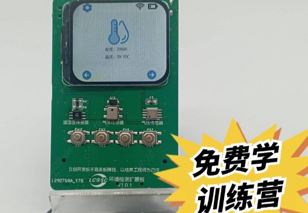

Environmental monitoring expansion board
Design of a Wireless Handheld Environmental Monitoring Instrument Based on the Liangshan School of Environmental Science and Technology

I. Hardware Design

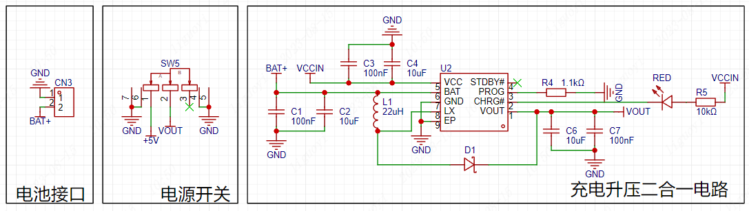

1. Charging and Boost Circuit Design
1.1 Introduction to Charging and Boost Chip

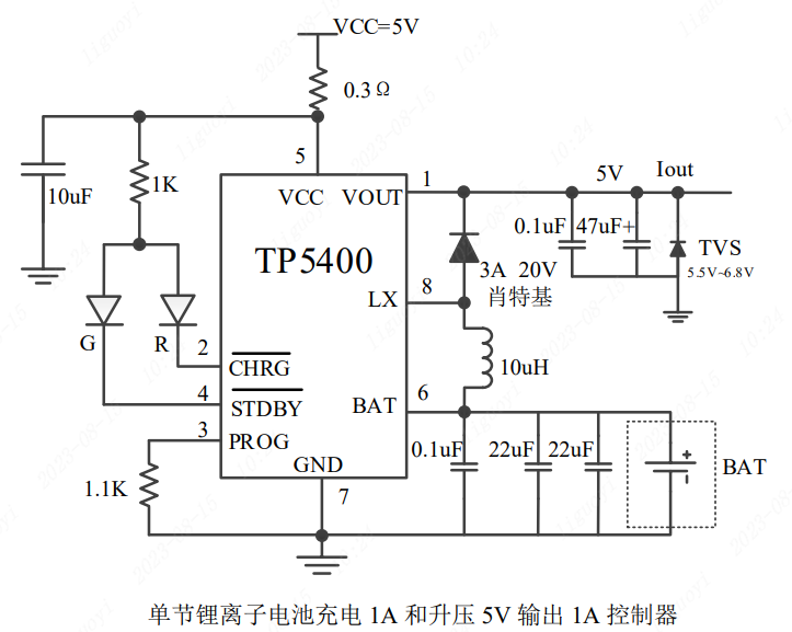

According to project requirements, we need to design a compact, battery-powered environmental instrument. Using a battery requires consideration of charging and discharging. This case uses the TP5400 lithium battery charging and boost control chip.
The TP5400 is a dedicated single-cell lithium-ion battery charger and constant 5V boost controller for power banks. The charging section integrates high-precision voltage and charging current regulators, pre-charge, charging status indication, and charging cutoff
functions , and can output a maximum charging current of 1A. The boost circuit uses a VFM switching DC/DC boost converter manufactured with CMOS technology, exhibiting extremely low no-load current. It features very low no-load power consumption (less than
10uA) and a boost output drive current capability of up to 1A. It requires no external buttons and is plug-and-play.
1.2 Application Circuit Design
The reference circuit in the TP5400 datasheet is as follows:
Pin Description
VOUT (Pin 1): Output voltage detection pin. Connects to the boost 5V output terminal.
CHRG (Pin 2): Charging status indication terminal with open drain output during charging. When the charger is charging the battery, the CHRG pin is pulled low by an internal switch, indicating that charging is in progress; otherwise, the CHRG pin is in a high-impedance state.

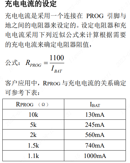

PROG (Pin 3): Charging current setting, charging current monitoring, and shutdown pin. Connecting a 1% accuracy resistor Rprog between this pin and ground sets the charging current (1.1K in a typical circuit sets a charging current of 1000mA). When charging in constant current mode, the voltage on this pin is maintained at 1V. The PROG pin can also be used to shut down the charger. Disconnecting the setting resistor from ground pulls the PROG pin high with an internal 2.5μA current. When the voltage on this pin reaches the 2.7V shutdown threshold, the charger enters shutdown mode, charging stops, and the input power current drops to 40μA. Reconnecting Rprog to ground restores the charger to normal operation.
TDBY (Pin 4): Battery charging complete indicator. When the battery is fully charged, STDBY is pulled low by an internal switch, indicating that charging is complete. Otherwise, the STDBY pin will be in a high-impedance state.
VCC (Pin 5): Charger input power voltage. Charging input power pin. Typical value is 5V, and it should be bypassed through at least one 10μF capacitor. When VCC drops to within 30mV of the BAT pin voltage, the TP5400 charging section enters stop mode.
BAT (pin 6): Charging current output. This pin provides charging current to the battery and regulates the final float voltage to 4.2V. A precision internal resistor divider on this pin sets the float voltage. In stop mode, this internal resistor divider is disconnected, and the internal power supply operates in boost mode.
GND (pin 7): Ground.
LX (pin 8): Output terminal of the internal power transistor in the boost circuit.
Based on the reference circuit, the following application circuit is derived:
battery voltage is BAT+, Type-C charging voltage is VCCIN, and VOUT is the 5V output voltage.
This circuit is the power supply section of our entire device, so it is recommended not to skimp on capacitors where necessary. In practical applications, the STDBY pin is unused. This pin is a charging completion indicator. During charging, a light (CHRG) illuminates to indicate that charging is in progress. Once charging is complete (STDBY), we can do nothing, as the charging light will turn off, indicating a full charge.

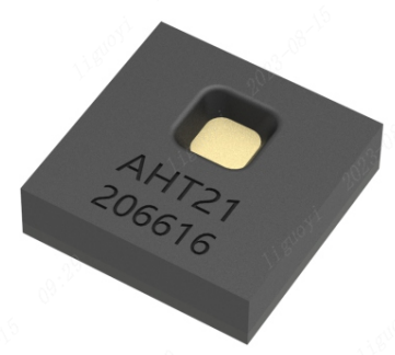

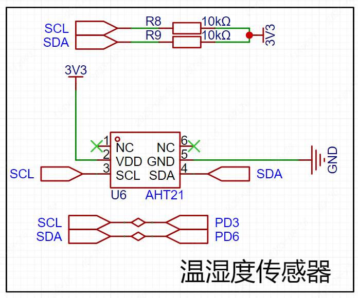

This case uses the AHT21 temperature and humidity sensor. The AHT21, as a new generation of temperature and humidity sensor, sets a new standard in size and performance: it is embedded in a dual-in-line flat no-leads SMD package suitable for reflow soldering, with a bottom surface of 3x3mm and a height of 0.8mm. The sensor outputs a calibrated digital signal in standard I2C format.

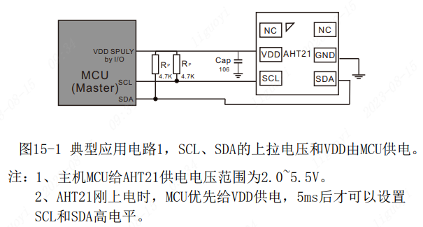

2.2 Application Circuit Design

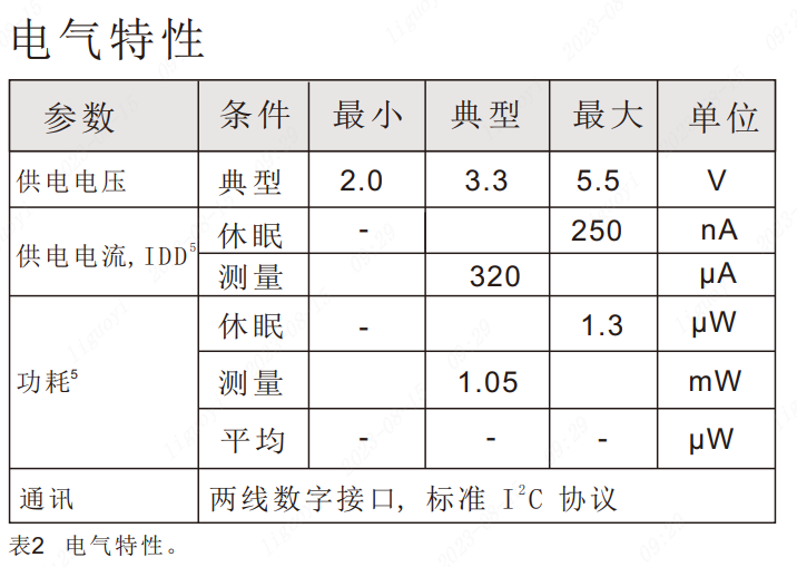

To design its circuit, we need to understand its electrical characteristics. See the figure below:
the input voltage is 2.0~5.5V, and the communication uses the IIC interface.
The datasheet provides two typical application circuits.
Referring to the typical circuits in the datasheet, we derive the following application circuit for our actual use. We use PD3 on the development board as the SCL interface of the IIC interface and PD6 as the SDA interface of the IIC interface.

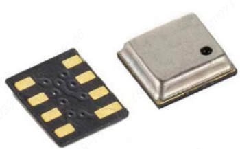

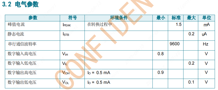

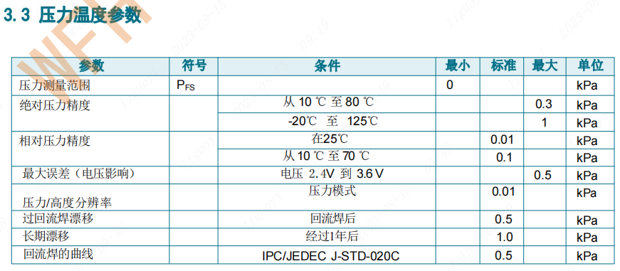

This case study uses the WF183D digital waterproof barometric pressure sensor. The WF183D is an economical digital pressure and temperature sensor that internally incorporates a MEMS pressure sensor, a high-resolution 24-bit ΔΣADC, and a DSP. The WF183D provides high-precision, calibrated digital pressure and temperature output via UART, with very simple communication connectivity.
Key features include
direct digital pressure and temperature readings,
operating voltage: 2.4V~3.6V,
pressure range: 0~180kPa (absolute pressure)
, operating current: 1.5mA
, and standby power consumption: < 2uA.
Other notes:
The product is pre-calibrated for pressure and temperature, allowing for plug-and-play operation without requiring further calibration by the customer.
Furthermore, the use of UART communication reduces the requirements for the MCU, lowering the overall cost for customers.
The WF183D has an IP65 waterproof rating, meeting the requirements of most waterproof products.

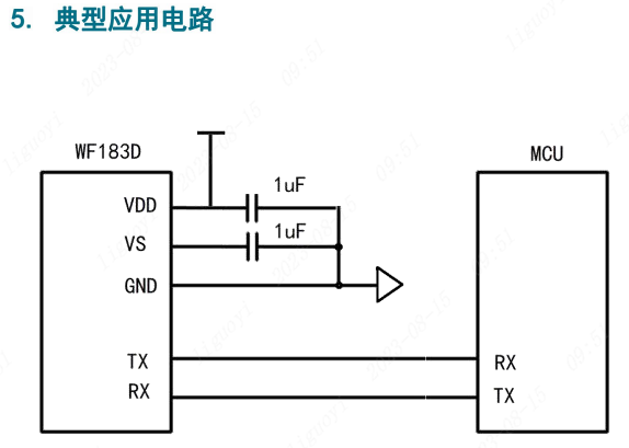

3.2 Application Circuit Design

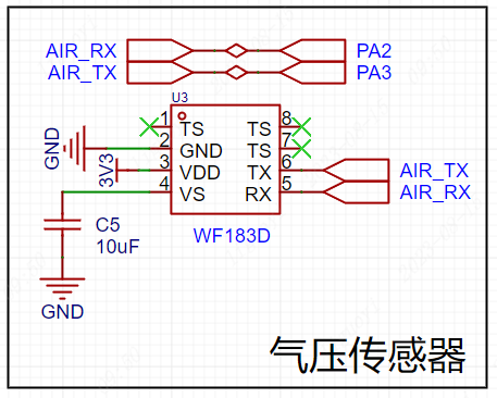

The datasheet provides a typical circuit for this sensor.

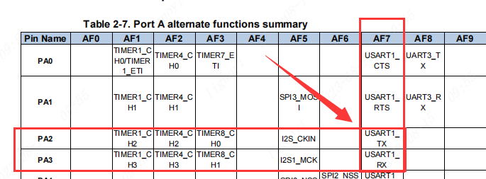

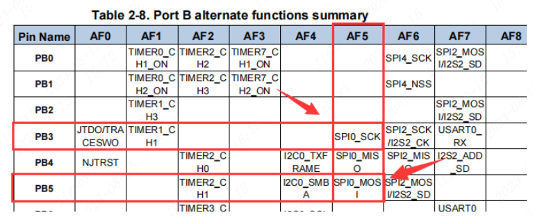

Since the sensor uses serial communication, we need to determine which serial port on the development board to use for communication. Referring to the GD32F470 datasheet, this case ultimately uses serial port 1 (TX=PA2, RX=PA3). The
application circuit is as follows:

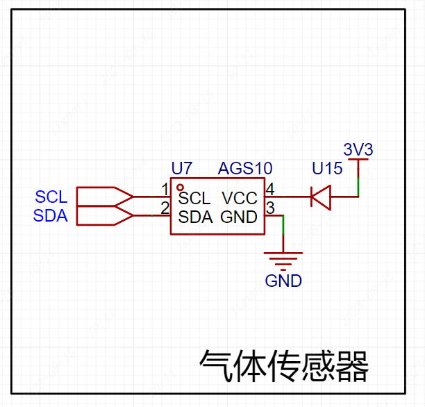

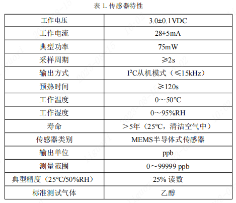

This case study uses the AGS10 TVOC sensor, a MEMS TVOC sensor with digital signal output. It features dedicated digital module acquisition technology and gas sensing technology, ensuring extremely high reliability and excellent long-term stability. It also boasts low power consumption, high sensitivity, fast response, low cost, and a simple drive circuit. The AGS10 is
primarily suitable for detecting various volatile organic gases, such as ethanol, ammonia, sulfides, benzene vapors, and other harmful gases, and can be applied in air purifiers, home appliances, and fresh air systems.
Sensor Characteristics :
The sensor uses the standard IIC communication protocol, adaptable to various devices. The IIC physical interface includes two interfaces: a serial data signal (SDA) and a serial clock signal (SCL). During design, both interfaces need to be pulled up to VDD through resistors ranging from 1kΩ to 10kΩ.
4.2 Application Circuit Design
The sensor operates at 3V, while our voltage options are only 5V and 3.3V. A Schottky diode can be connected in series at the sensor's VCC pin. The voltage drop of a regular diode is between 0.6V and 1.7V, while that of a Schottky diode is typically between 0.15V and 0.45V. The gas sensor also uses an IIC interface. We know that the IIC protocol allows multiple devices to share a single IIC bus, provided their device addresses are different. Here, the IIC interface is connected to the IIC interface of the temperature and humidity sensor. Since these two sensors have different device addresses, they can directly use the same IIC interface.
The actual application circuit is as follows:

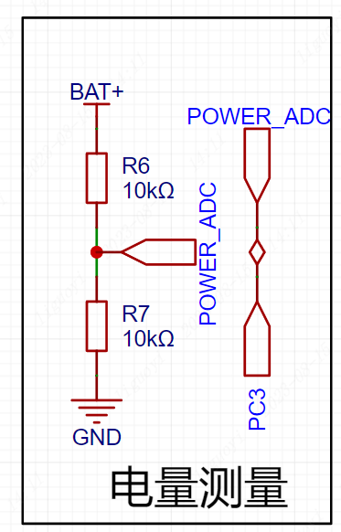

5. The circuit diagram of the ADC for power measurement
is as follows. Here, the ADC is measured by voltage division of resistors. Because the IO port can only be compatible with a maximum of 5V, exceeding 5V will burn out the IO port. The two resistors R30 and R18 are connected in series to reduce one component. Alternatively, a 20K resistor can be used directly. The value of the resistor can be calculated based on the IO port level. After voltage division, it should not exceed the voltage that the IO port can tolerate. Select a suitable value. Next, we will demonstrate how to convert the ADC value to the voltage value through calculation.
Premise: Assume that the ADC is 12-bit, and the battery power supply is at most 4.2V and at least 3.2V;
-------Knowing the voltage, find the ADC value-------
(1) The voltage ratio of the ADC terminal: 10K/(10K+10K)=0.5;
(2) When the battery power is at its highest, the voltage obtained by the voltage divider at the ADC terminal is:
0.5 - 4.2V = 2.1V. When the battery power is at its lowest, the voltage obtained by the voltage divider at the ADC terminal is:
0.5 - 3.2V = 1.6V. The
ADC value when the battery power is at its highest is: (2.1/3.3V) - 4095 = 2606. The ADC value when the battery power is at its lowest is: (1.6/3.3V ) - 4095 = 1613.
-------Calculate the voltage from the ADC
value------- Through the inverse operation of the above formula, we can know that the voltage value collected for any ADC value is: V_value = (ADC * 3.3) / 4095 Unit: V

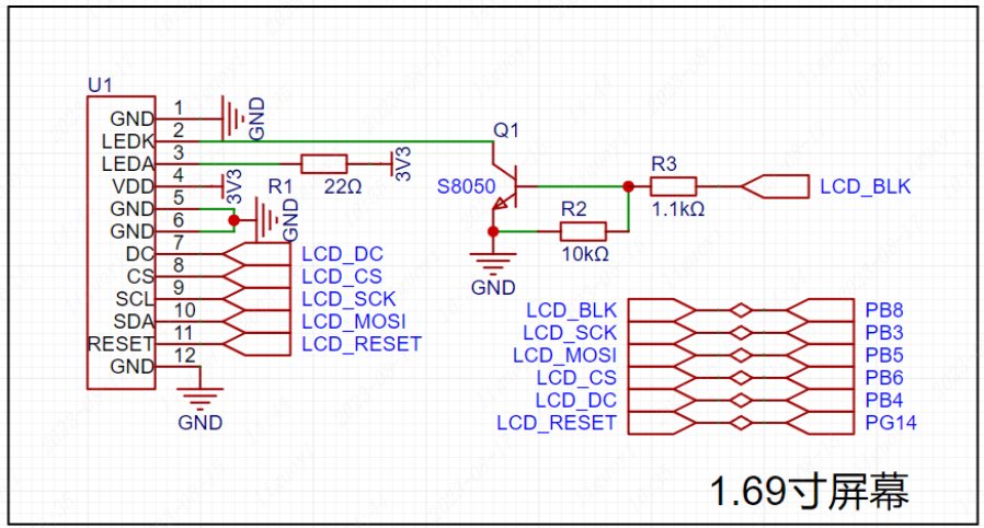

6.1 Screen Introduction
The screen uses a 1.69-inch IPS high-definition rounded corner screen with 240*280 pixels and SPI communication. A 1.69-inch screen is a common small-sized display screen, which refers to the diagonal size of the screen being 1.69 inches (about 4.29 cm). Although it is relatively small, it still has a wide range of uses and functions in some application areas. This screen has a higher pixel density (total pixels/size), resulting in finer image quality and fewer control I/Os, making the peripheral circuitry relatively simple.
6.2 Application Circuit Design
This screen uses SPI communication. To achieve faster refresh rates, we can connect to the hardware SPI pins when selecting the pins for the development board. In this case, we connect PB3 (SPI0_SCK) and PB5 (SPI0_MOSI).

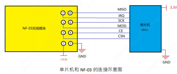

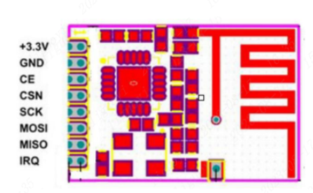

Module pins are as follows:
Note:

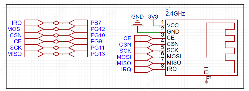

CE can be continuously connected to a high level, but the module must be set to power-down mode when writing to the register. It is recommended to connect the CE pin to the microcontroller's GPIO port;
IRQ can be left unconnected, and the interrupt status of the STATUS register can be obtained using SPI polling. However, it is recommended to use the microcontroller's external hardware interrupt, connecting the IRQ to the microcontroller's external trigger pin to trigger the microcontroller interrupt;
ensure good grounding with a large ground plane, low power supply ripple, and add filter capacitors as close as possible to the module's VCC and GND;
the reference circuit in the datasheet is as follows:
the actual application circuit

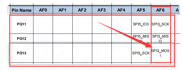

is as follows: This module uses SPI communication. To make the communication speed faster, when selecting the pins to connect to the development board, we can connect to the hardware SPI pins. In this case, PG11 (SPI3_SCK), PG12 (SPI3_MISO), and PG13 (MOSI) are connected.

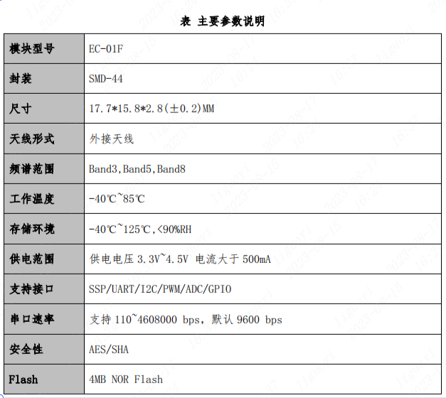

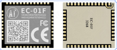

This case study uses the EC-01F, an NB-IoT module developed by Axiomtek. The NB-IoT portion uses the EC616S as its main chip. This chip is a highly integrated NB-IoT SoC, supports ultra-low power consumption, and fully supports the 3GPP Rel14 NB-IoT standard, making it a high-performance NB-IoT chip.

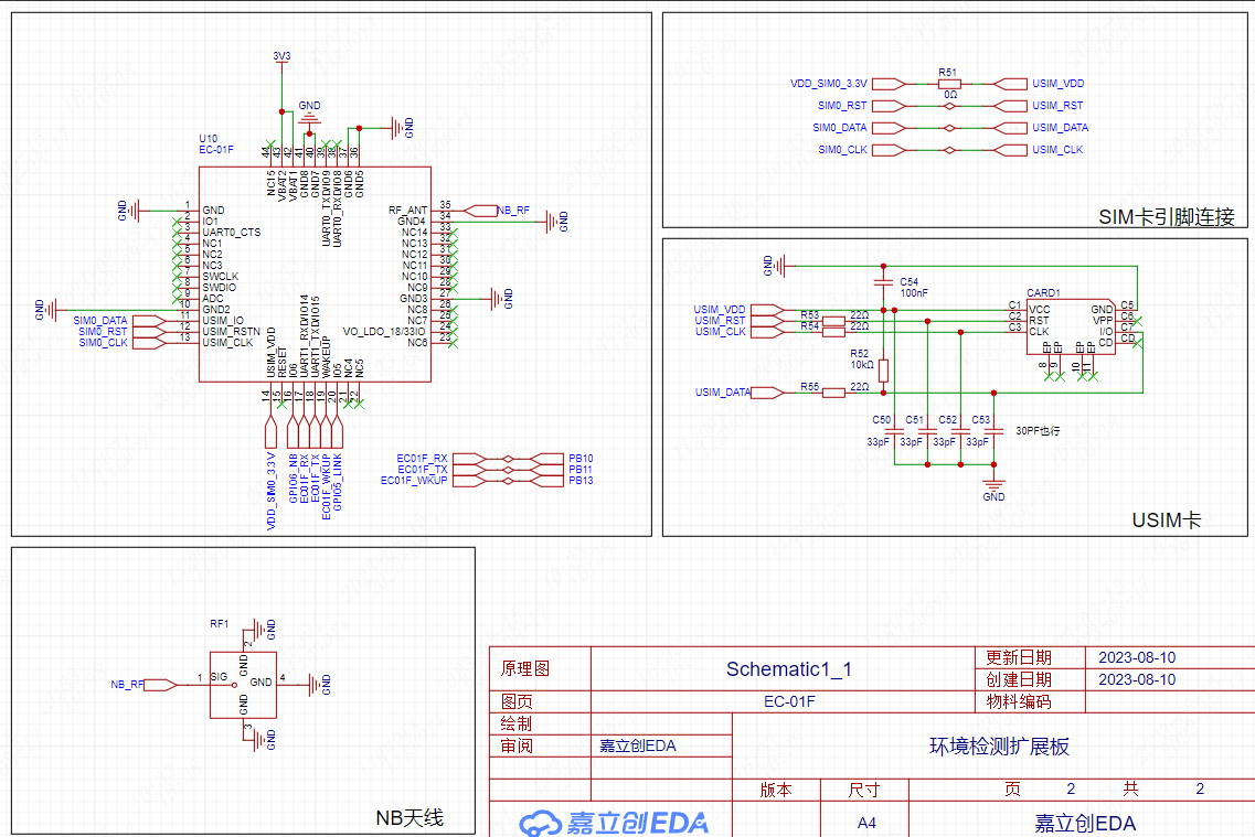

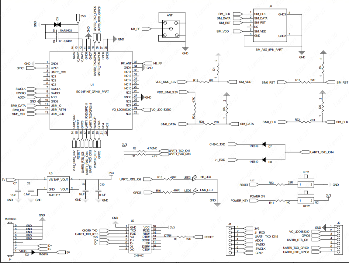

8.2 Application Circuit Design
The module's specifications do not include a complete application circuit. However, the official documentation provides a development board based on the EC-01F, and the schematic is open-source.
We discarded some unnecessary parts and redrawn the design. We only need the EC-01F, SIM card slot, and antenna mount. The module's power supply requires at least 500mA of current. The 3.3V on our LCSC Liangshanpai development board is derived from a DC-DC circuit, fully meeting the power requirements.
The following is the actual application circuit design:
Note that
the 22Ω and 33pF resistors for the USIM card are mandatory; otherwise, it cannot be recognized! Please refer to the specifications for the rest.
