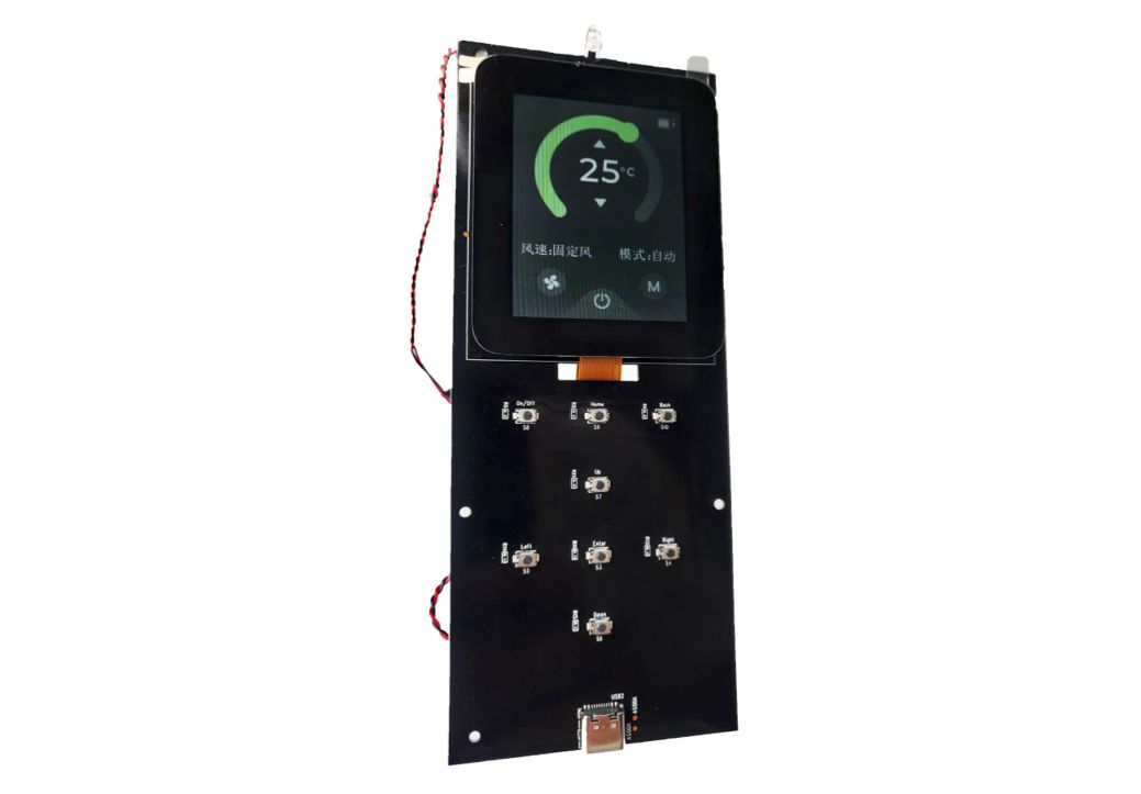

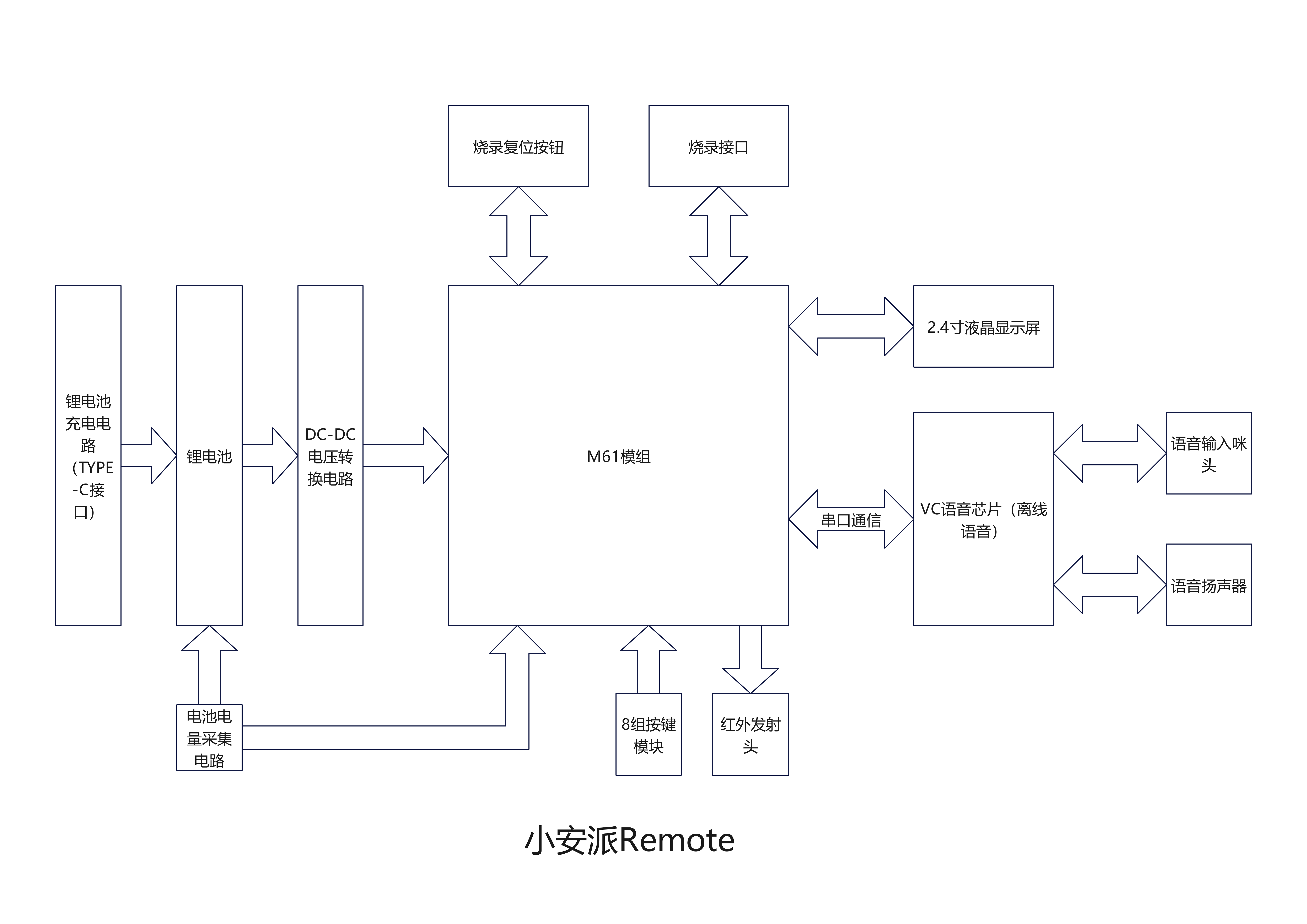

Overview:

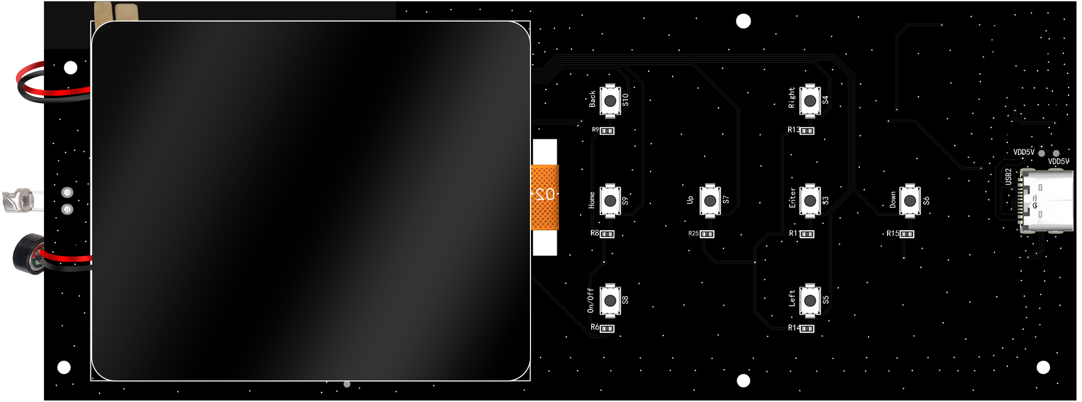

The Xiao An Pai-Remote features a 2.4-inch LCD display module, battery level detection module, offline voice module, infrared transmitter module, 8-button combination module, lithium battery charging module, and DC-DC voltage conversion module.
The Xiao An Pai-Remote's factory firmware includes infrared compatibility for Midea air conditioners, allowing control via buttons, touchscreen, and offline voice.
It utilizes the Anxinke M61 wireless module as its control core, driving the 2.4-inch LCD screen through the M61 chip. Each button has an independent I/O input port. Offline voice communication with the M61 is via serial port, and battery level is detected through ADC voltage sampling.
System Block Diagram :

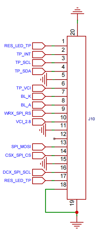

2.4-inch Touchscreen LCD Display
: The 2.4-inch screen interface uses an integrated FPC cable for both display and touchscreen, but with an 18-pin connector.

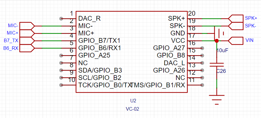

VC Voice Chip:
The VC-02 offline voice module operates on 5V power and communicates with the M61 module via serial port, providing external speaker and microphone outputs.

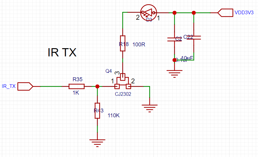

Infrared Transmitter:
Equipped with an infrared transmitter module, it emits infrared signals to control the device.

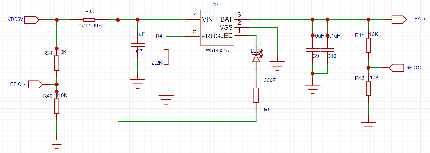

Charging Circuit:
The battery is charged via a USB interface.

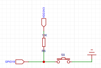

Eight independent buttons
are provided, which will not be shown here.
