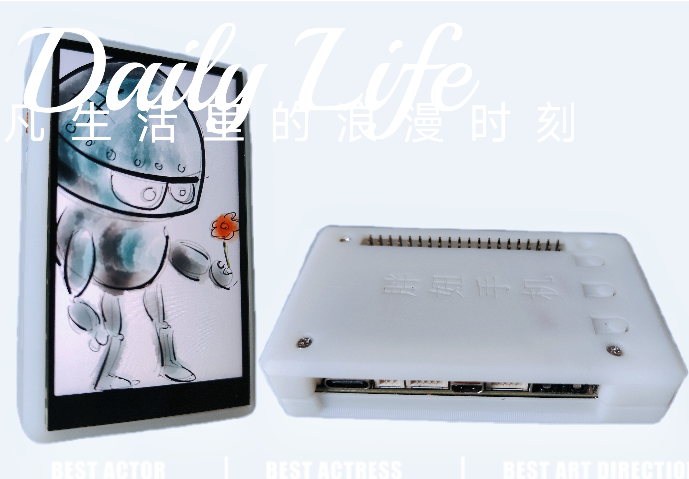

I. Project Description:
    Based on the Taishanpai development board, this project aims to replicate an extended mobile phone, a project sponsored by a training camp. It mainly involves tasks such as environment setup, SDK compilation, device tree modification, driver writing, code burning, expansion board schematic design, PCB design, component purchase, soldering, and debugging. This provided a preliminary understanding and learning of the Linux development process.

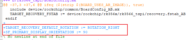

    3.
            When developing a system for rotating the screen, it was necessary to modify the Android system's orientation. The official documentation lacked relevant information, so I found the specific settings by reading the provided patch file.

      I wasn't very familiar with component procurement and casing design. I directly used the official drawings for prototyping. Because I didn't verify the assembly dimensions, I used the default parameters from the hardware design when purchasing fixing screws and spring pins, leading to deviations during final assembly. I had to repurchase and replace them.
