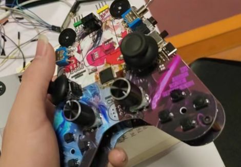

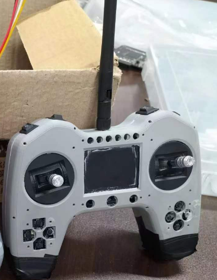

Project Introduction:
As an Rcer member and fellow embedded hardware engineer, designing a remote control that is feature-rich, has a smooth feel, operates seamlessly, and is even presentable is the minimum requirement. Based on the project's requirements, this Vol. 1.0 version of the Rc remote control was designed.
Vol. 2.0 and Vol. 3 versions will feature a redesigned exterior and utilize the Rtos operating system and state machine programming to debug the peripheral transmitter demo. The receiver will be open-sourced after the 23RC competition (attached is an unflattering picture of version 2.0).
—P.S.: The software and hardware for this project were 100% debugged by myself. However, due to my software skills being far inferior to those of the embedded software team members, after debugging the hardware and writing the bare-metal demo code for all peripherals, it was handed over to the embedded software team members for onboard debugging. Project Analysis:
This remote control is a multi-functional remote control based on the STM32F4 platform.
Configuration:
(I) Main Controller: Uses an STM32F405RGT6 main controller with a main frequency of 168MHz, 1MB FLASH storage, and 192KB SRAM. This controller was chosen because it is based on the high-performance Arm Cortex-M4, has a high frequency, and supports up-to-date system latency and protocol layer speeds on RTOS systems. It also supports FPU floating-point unit calculations, making the calculation of joystick error filtering algorithms very convenient. Furthermore, the sufficiently large RAM provides good support for multi-threaded, multi-state processing programming and DMA memory buffer allocation.
(II) Communication: Dual communication modules are used, utilizing NRF24L01+Lora (Lora was deleted after a minor bug was found during debugging of the previous board, so only single communication is used). A high-power 500mW high-performance PA+LNA module is selected for 2.4G wireless communication. This module has significant advantages over the low-power version of the same module. After actual testing, its communication quality through walls is significantly improved, and the air speed is adjustable. Currently, the maximum communication distance can reach 1Km.
(III) Display: 0.96-inch 4PIN I2C OLED display screen. The IO port usage is small, reducing resource consumption. At the same time, a UI interface based on u8g2 has been designed, and the relevant API functions are encapsulated for user calls. For UI design, the mainstream are currently LVGL and U8g2. LVGL is more commonly used in LCDs, while u8g2 has less memory usage and is very friendly to small-screen OLEDs. At the same time, the functions in the library are simple to operate and easy to call.
(IV) Channels: 28 physical channels, including 18 analog channels and 10 switch channels, comprising: 4 joystick channels, 4 two-stage toggle switch channels, 2 three-stage toggle switch channels, 2 potentiometer knob channels, 4 button channels, and 2 switch reset channels.
(V) Menus: Up, Down, Left, Right, Add, Subtract, Confirm, Exit (8 menu buttons are planned to be supported). The buttons will be programmed using a state machine algorithm—the classic Switch-case method. Combined with U8g2, it will implement a multi-level menu with progressively advancing pointer switching, currently achieving up to three levels. It efficiently debouncing buttons, and the advantage of using state machine programming for switching between long and short presses is that it allows for layer-by-layer state transitions.
(vi) Peripherals: An external USB-to-serial communication matrix keyboard module is added for dual-MCU dual-machine communication. It controls 16 keys through 8 I/O ports and implements hardware debouncing + software debouncing. This matrix keyboard module was a pre-implemented function in the previous demo and has been deleted from this board. Only the classic MPU6050 IMU & gyroscope has been added to realize motion-sensing remote control operation, which is controlled by changing the posture of holding the remote control.

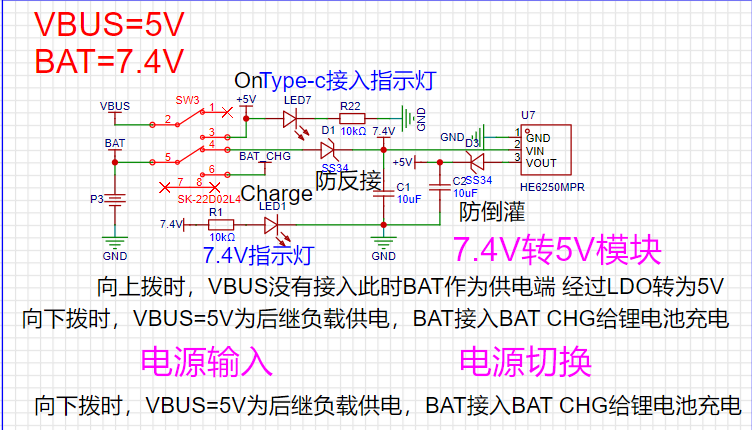

(vii) Power supply: It is powered by a 2S lithium battery and has a built-in 5V1A charging management circuit. It also supports the Power_Charge switching circuit and supports Type-C power supply and lithium battery power supply. The charging and discharging modes can be switched through Charge. It has built-in reverse connection protection to prevent board explosion caused by the Xh2.54 positive and negative male connector.
(VIII) Control: The MCU's internal 12-bit high-precision ADC is used to sample the voltage of the dual model joysticks. There is one throttle joystick and one directional joystick. For the global coordinate system X and Y, simple hardware filtering is applied. For software processing, the measured linear curve of the voltage value in the 0-3V range shows a deviation of approximately 200mV within every 50-100 data points. The filtering algorithm used is the mean filtering algorithm, which is simple and provides smooth operation of the steering wheel chassis even after processing to one decimal place.
(IX) Warning: A BJT switching circuit is used to control the passive buzzer, providing low voltage, danger warnings, and low battery warnings. A pre-installed power-on beep function is also included to indicate that all peripherals have been fully reset and are ready for operation.
(X) Monitoring: Includes a four-channel LED driver circuit. The lithium battery voltage is collected via a three-resistor lithium battery voltage acquisition circuit to achieve power monitoring. Four LEDs display four levels of power level, and the current battery level and corresponding monitoring indicators can be displayed through a UI interface. Figure ①: Mind Map Schematic Design Description

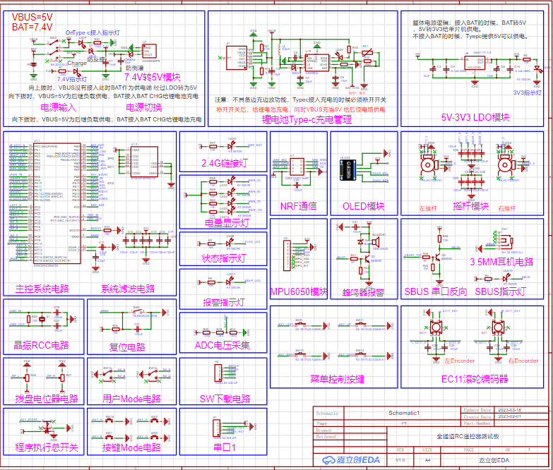

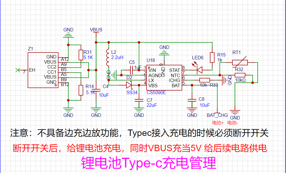

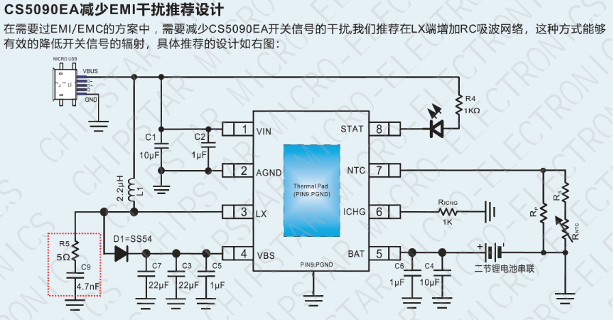

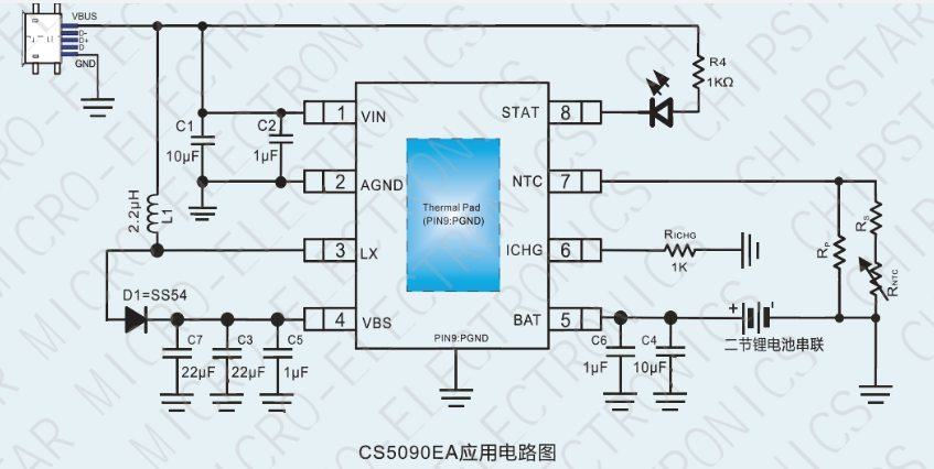

of RC Remote Control Based on STM32F405RGT6 PS: This schematic is for reference only. The circuit design of each module will not be emphasized; it is relatively simple. Various peripherals are mainly for software demo writing. This schematic description mainly emphasizes the circuit design and precautions for the Power & PowerCharge circuits. ①Power & Charge & USB ① This is the power input and power switching section. When flipped up, Vbus is not connected. At this time, Vbat acts as the power supply terminal, supplying power to the load through a low-dropout LDO. When flipped down, BAT is disconnected, and BAT is connected to BAT_CHG as the Charge pin, acting as the 2S lithium battery charging pin. Flipping down allows connection to Type-C, which acts as the power supply terminal and can also power the overall circuit and charge the lithium battery. ② The lack of simultaneous charging and discharging means it does not support charging the lithium battery while simultaneously discharging it. However, it supports power supply via Type-C when connected, thus achieving simultaneous charging and discharging in another way. When charging via Type-C, the lithium battery's charge circuit must be disconnected, i.e., the switch must be flipped down. Power is then supplied to the BAT pin of the CS5090E. The CS5090E datasheet will be analyzed below. ③ The 6-pin Type-C uses a switch to switch between lithium battery mode and charging mode. The main charging management IC, CS5090E, performs balanced charging for the 2S lithium battery. Its main features are described below using its datasheet. This is a domestically produced dual-cell lithium battery boost charging IC that supports Vin=5V, a maximum charging current of 1.5A, integrates a high-power switching MOSFET for reduced power consumption and high conversion efficiency, has a switching frequency of 500kHz, and incorporates four loops to control the charging process: a constant current (CC) loop, a constant voltage (CV) loop, and a temperature regulation loop. It supports LED charging status indication and includes circuit protection functions: output overvoltage protection, short circuit protection, and input undervoltage protection. The IC integrates PESD protection and can withstand 2KV high-voltage breakdown. ④ Pin Definitions ⑤ Typical Circuit Application Diagram Note: The selection of external passive components should be based on the actual application requirements .

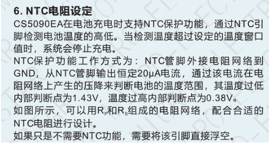

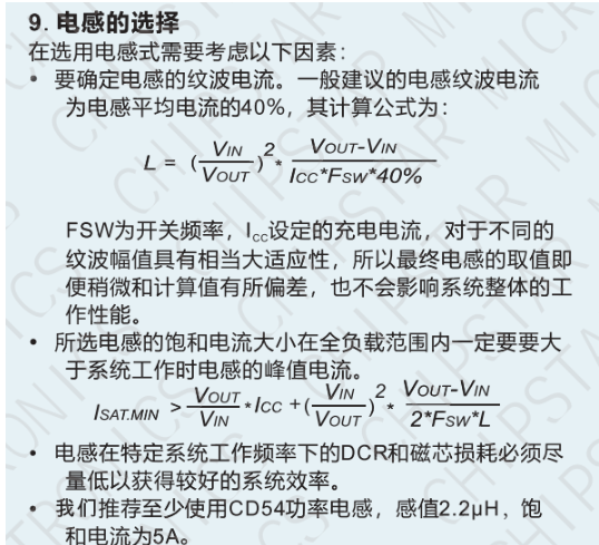

⑥ For example, if the inductor ripple current needs to be controlled within 40% of the average inductor current, the saturation current of the selected inductor must be calculated according to the formula in its datasheet. This saturation current must be greater than the peak inductor current during system operation within the output load range to ensure low DCR and low signal loss at the characteristic operating frequency, thus guaranteeing system efficiency.

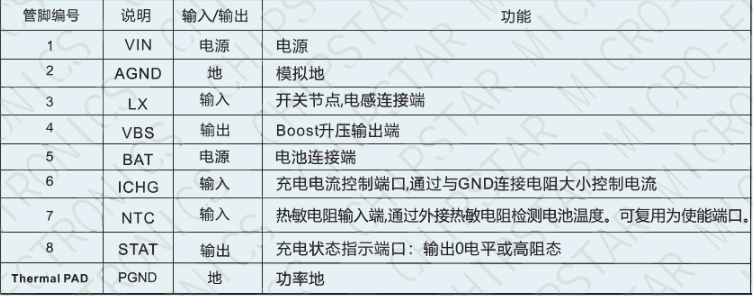

⑦ For example, the charging management IC itself supports NTC thermistor over-temperature protection. The battery temperature is detected through the NTC pin. The protection mechanism works as follows: after connecting the NTC to GND via an external resistor, the NTC_Pin outputs a fixed 20uA current. The voltage drop generated by this current determines the battery temperature range. In its internal temperature-voltage fitting linear curve, the internal low temperature judgment point is 1.43V, and the internal high temperature judgment point is 0.38V. If the NTC function is not needed, this pin is left floating. It is worth noting that: generally, lithium batteries purchased nowadays have built-in temperature protection functions. The NTC thermal protection function added to the charging management IC is just an additional feature.
CS5090E wiring layout recommendation: ① The charging management IC is particularly prone to EMI electromagnetic interference, so it is necessary to design an EMC electromagnetic compatibility solution for it. According to the datasheet, the interference generated by the high-frequency switching signal of its high-power switching transistor should be addressed by adding an RC first-order filter network to the LX pin, which can effectively reduce the radiation of the switching signal.
②PCBA Precautions: (1) The power supply traces should be as wide as possible. It is better to lay all copper and open the solder mask layer. The power supply traces should be used to supply power to the CS5090E separately. (2) This is a typical BOOST boost module. Its main current loop should be as small as possible. The traces should be short and thick. (3) The LX pin traces should be as short as possible to reduce EMI. The RC first-order filter circuit should be placed close to the pin. The input capacitor of the power supply end should be placed as close to the chip as possible. The bottom heat sink is the power ground PGND and should be connected to the whole board with all copper. The fan hole

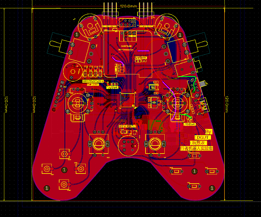

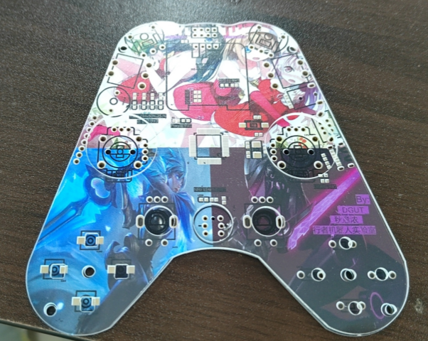

PCB design instructions
PS: This PCB uses the arc wiring method for single-path wiring for the first time. The overall layout wiring does not look very good at first glance. Please forgive the trouble caused to everyone. This board is designed with a 2-layer board. I will not introduce the PCB in detail. The main point is that the user's hand feel for each function peripheral needs to be properly matched with our layout design to enhance the user experience. The copper transparency is 30%. The traces of other modules will not be explained in detail. The layout wiring of the power supply part will not be specifically extracted here.

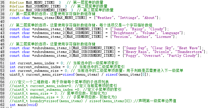

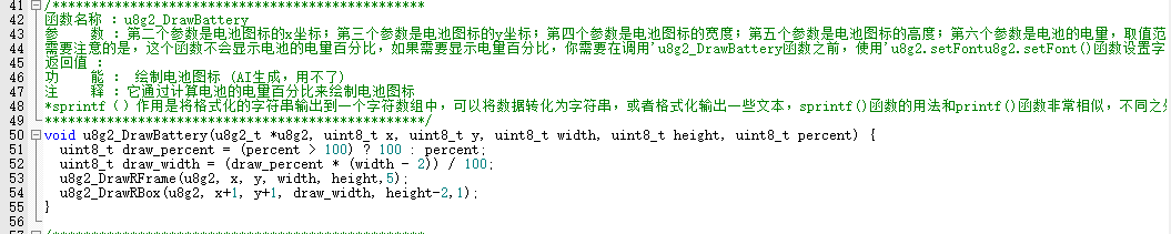

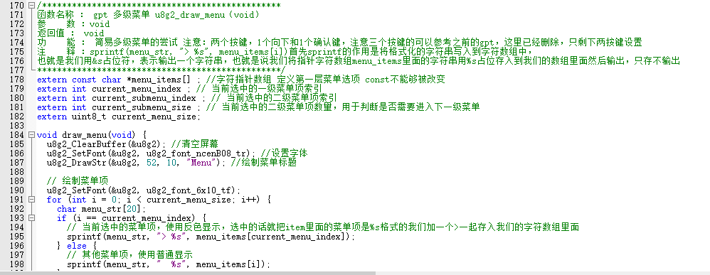

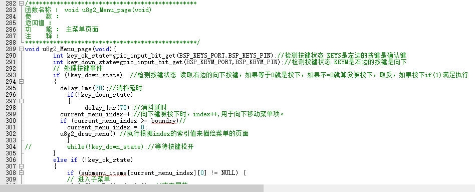

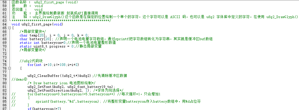

① U8g2 Code Block API (GD32F450 compatible with F429) :
U8g2_Init,
U8g2_Progress (progress bar
), U8g2_Draw Battery Icon , U8g2_Main Interface
(UI including battery level display, progress bar, and related parameter information), U8g2_Three-Level Menu Interface API:
U8g2_Handling Submenus of Multi-Level Menus by Key Index Value.

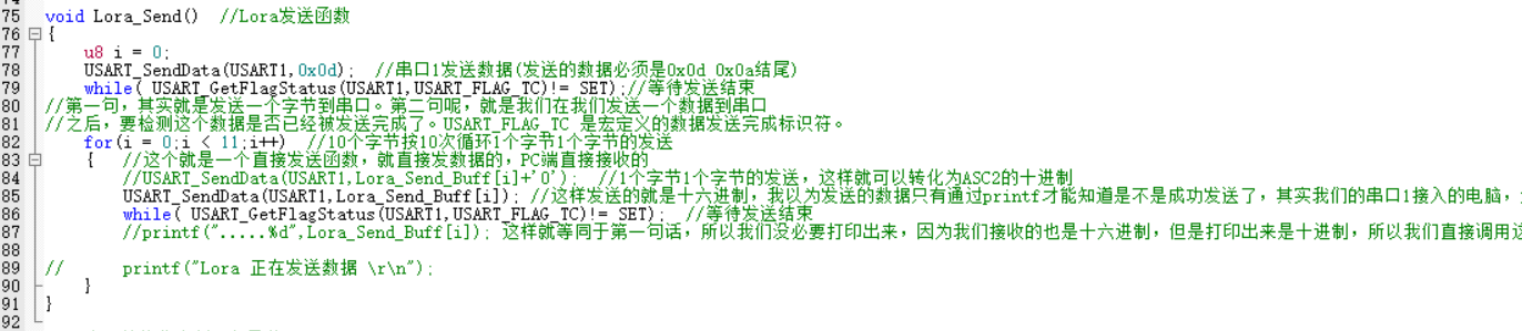

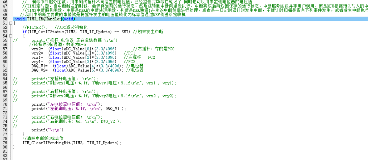

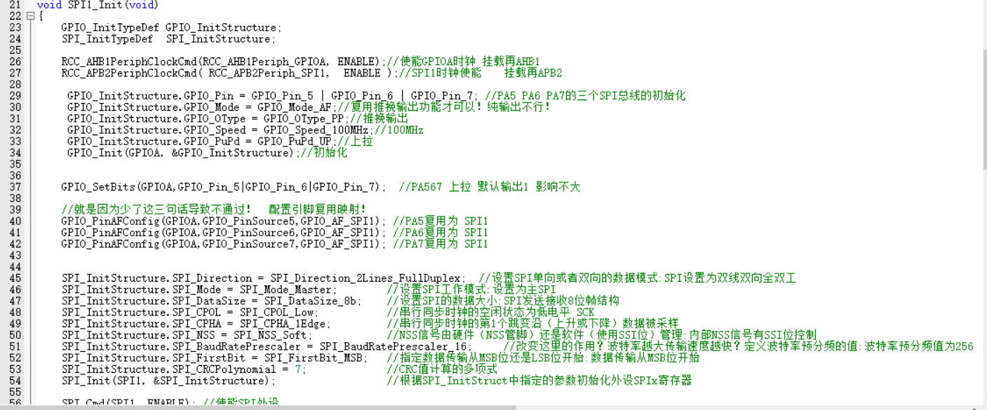

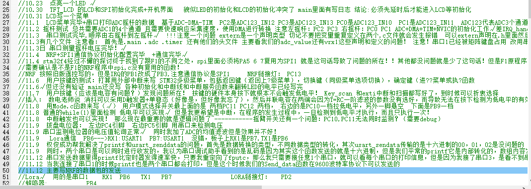

Debugging Log:
! ... The following only introduces the key peripherals:

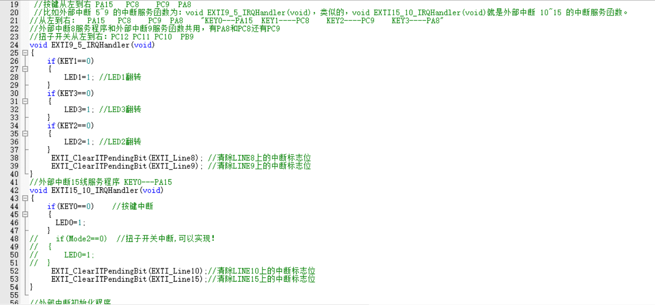

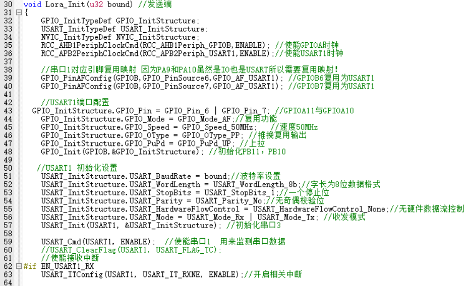

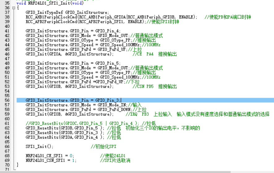

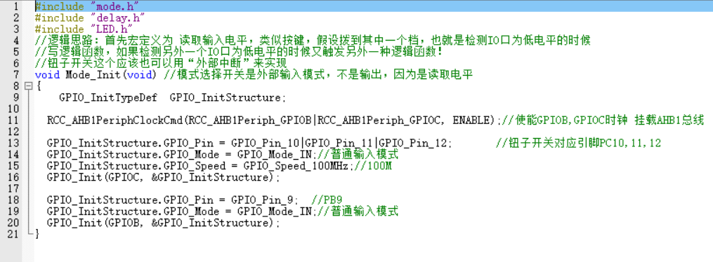

24L01.c,
TIM3_IRQHandler(),
Mode.c
, Lora.c

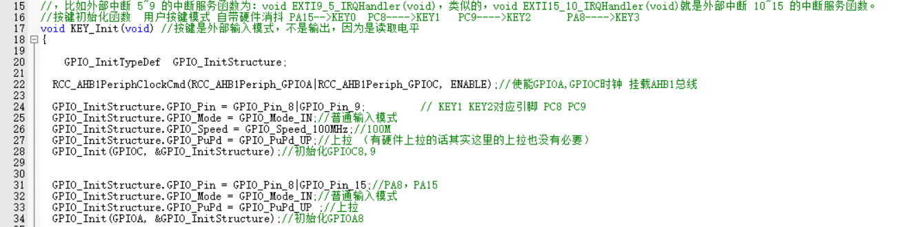

, KEY.c
, SPI.c
, and EXTI.c.

Finished product image:
Perfectly compatible with the basic 17+4 casing and positioning board.
The remaining space on the bottom shell can only accommodate a thin battery of about 500mAh.
The receiver is difficult to solder (it's very small and has two surface-mount capacitors on the back).
