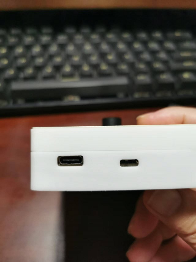

3. Power supply uses a dual-power supply of a 3.7V lithium battery and a 5V Type-C port. Charging is performed simultaneously with the 5V Type-C port power supply. A TP4054 is used for charging. An ME6231 LDO provides a stable 3.3V power supply to the CW32 development board. The 3.3V on the motherboard needs to be connected to the 3.3V on the CW32 development board. A 12V boost circuit FP6291LR provides power to the 0-10V, 0-20mA signal generator. An LM358DR dual op-amp is used. Considering the load capacity of the current source, the 12V power supply can be boosted to 24V later to match industrial applications.

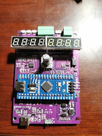

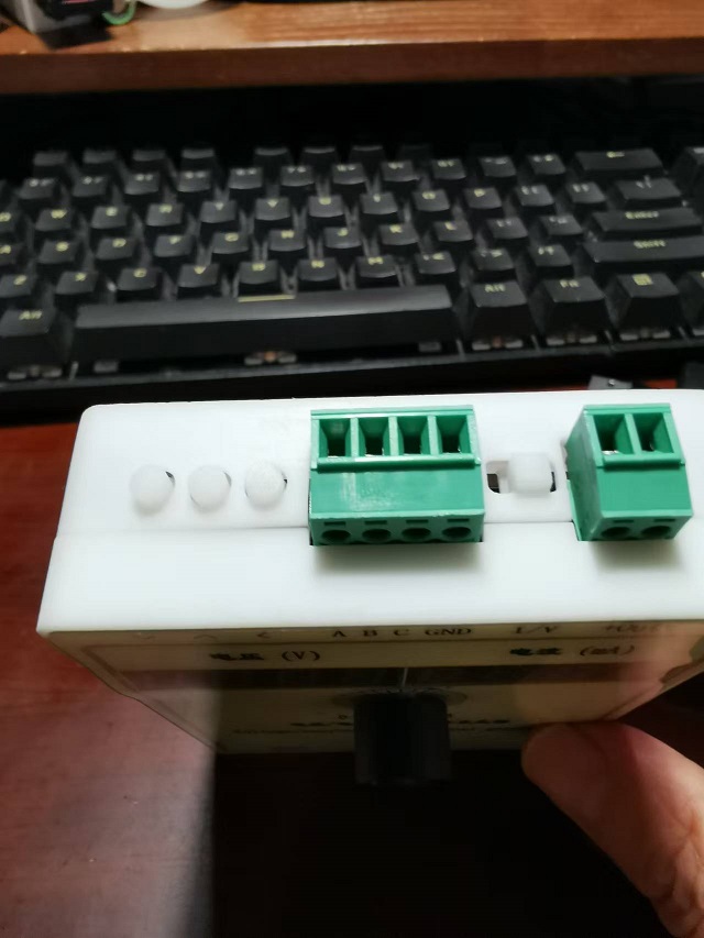

The PCB is generated directly from the schematic. Three function buttons are placed on the top. Voltage and current outputs use 2P ports, and the pulse output 4P port is also placed on the top. The LED digital tube is placed in the upper-middle part of the front panel. Next is the encoder, placed on the center line. The voltage generator circuit is to the right of the encoder, and the current generator circuit is to the left. The CW32 development board is placed in the lower middle section, followed by the charging port, power converter, and 3.3V circuit. The layout follows LCSC EDA's guidelines; numerous online videos explain the specific layout and routing methods.

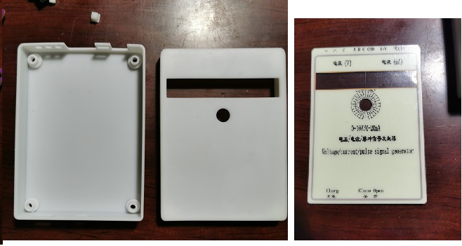

The 3D shell is a standard top and bottom cover structure. The top button design includes three button caps and a switch handle.

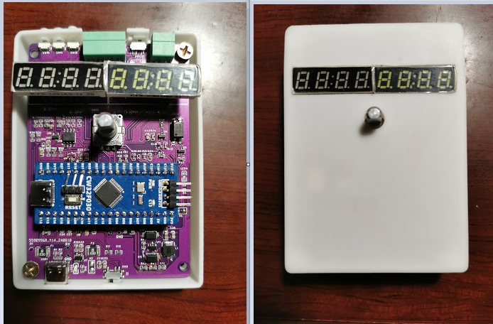

During 3D shell simulation, it was found that the LED digital tube sank too low. When soldering the circuit board, the digital tube pins should not be cut off; they should be soldered higher.
Because my development board is plugged into an IC socket, the entire circuit board is quite thick. The LED digital tube needs to be taller than the development board, so even without cutting the pins, it's not tall enough. Therefore, I added mounting brackets on top to raise the height of the LED digital tube.
The panel printing was also designed according to LCSC EDA's panel design tutorial.

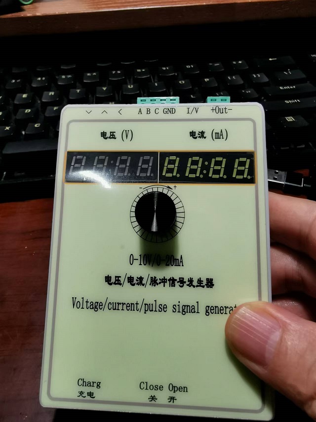

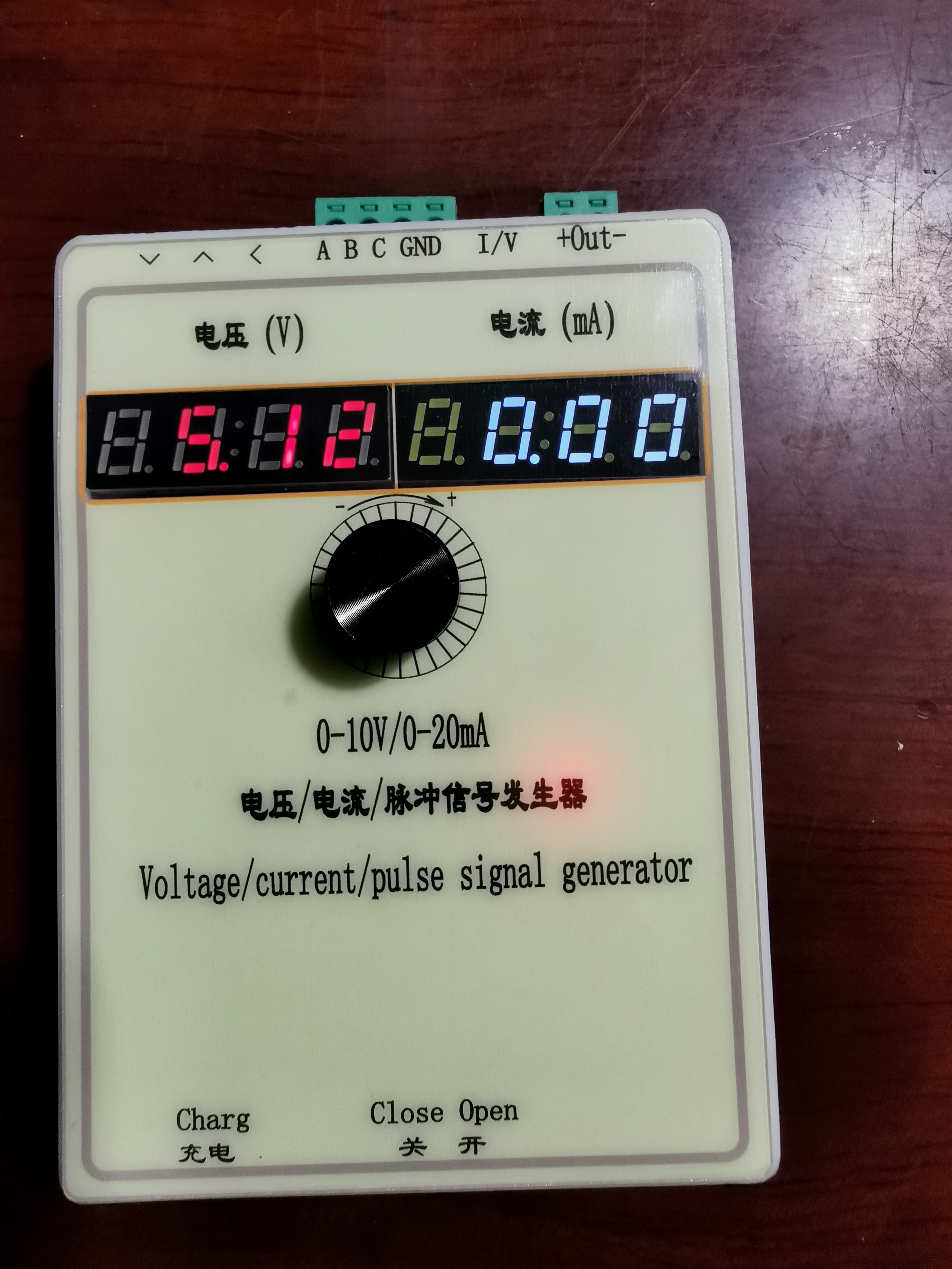

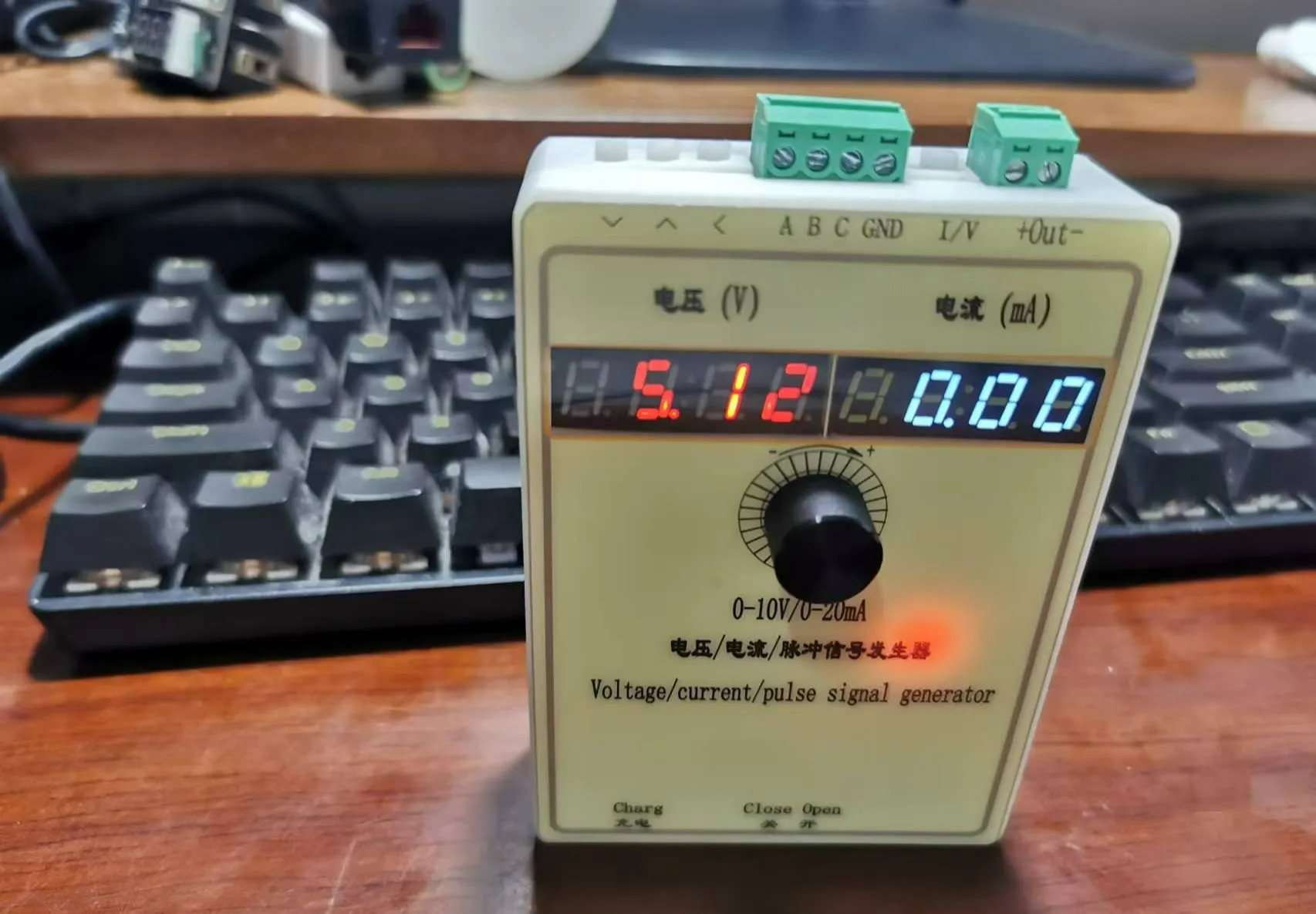

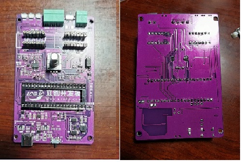

the front and back of the PCB board after production, as shown in the figure. Here, it should be noted that if the CW32 development board is placed on the 40-pin inline IC socket, it will be much higher. This causes the LED digital tube to sink, so the digital tube is also soldered with a socket. There are no components on the back, which is convenient for attaching the lithium battery with double-sided tape.
The appearance after inserting the digital tube and development board:

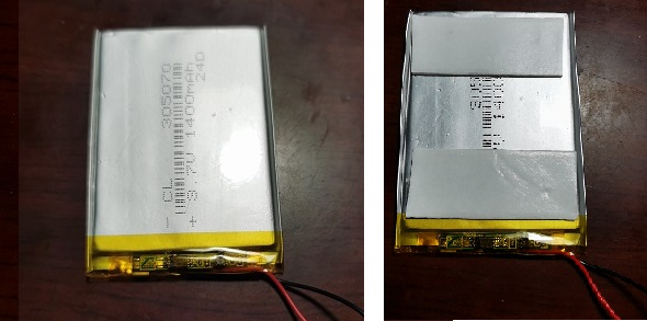

The appearance after attaching double-sided tape to the battery: The battery can be a 1000-1300mAh polymer lithium battery. The dimensions are smaller than the board's length and width (9cm x 7cm) and thickness (less than 6cm). This is what it looks like
after attaching the battery to the back of the PCB:
Casing and panel:
Circuit board installed: Panel attached, assembled: Actual product display. Notes: Because my development board is plugged into an IC socket, the entire circuit board is quite thick. The LED digital tube needs to be taller than the development board to display on the casing; otherwise, it will sink, as shown in the 3D preview. However, even without cutting the LED digital tube leads, it's not tall enough, so I added mounting brackets to raise the LED digital tube's height. See the attached program : EC11 Voltage and Current Simultaneous Acquisition and Display.rar. Demo video: https://b23.tv/RT94Otn
