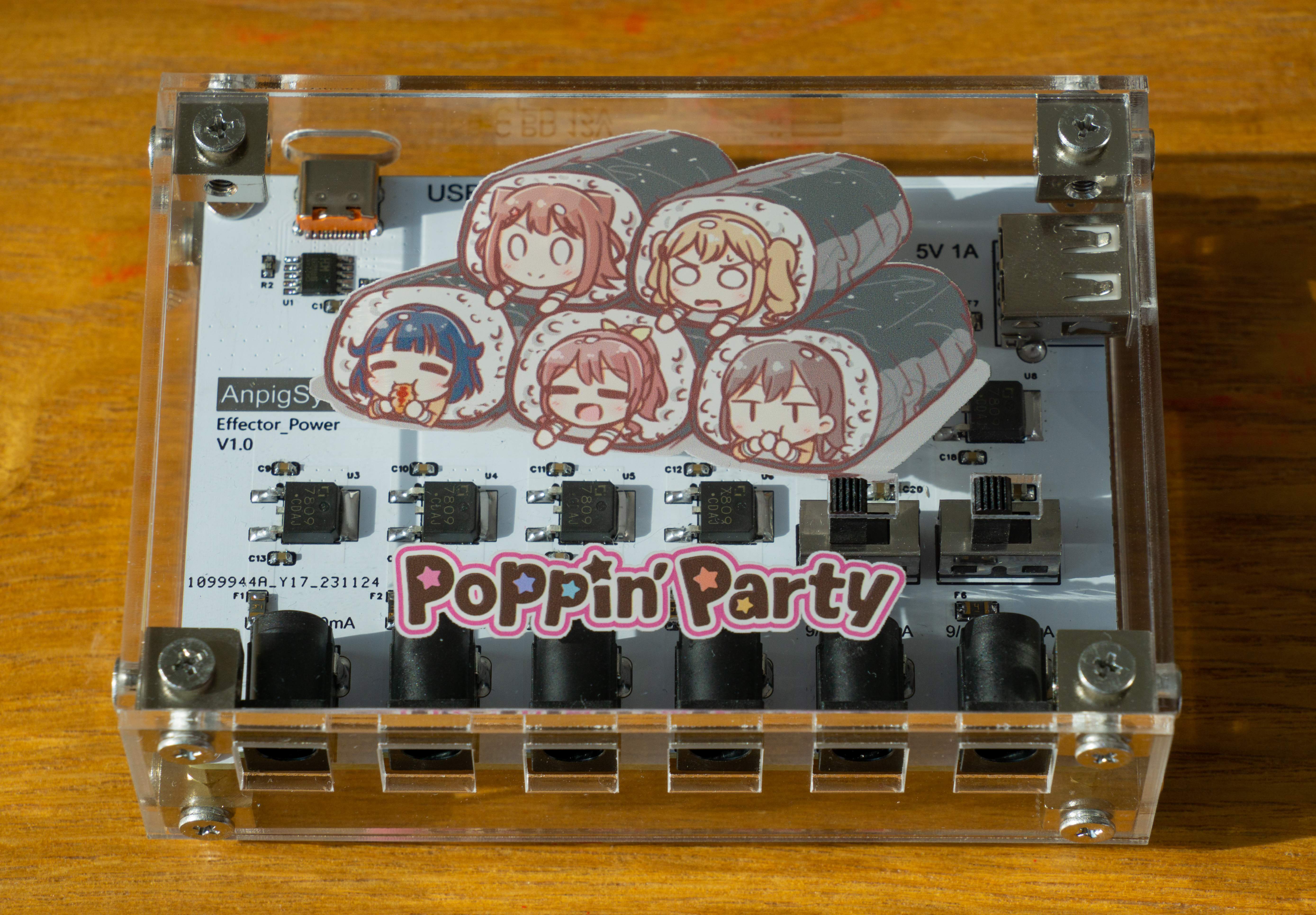

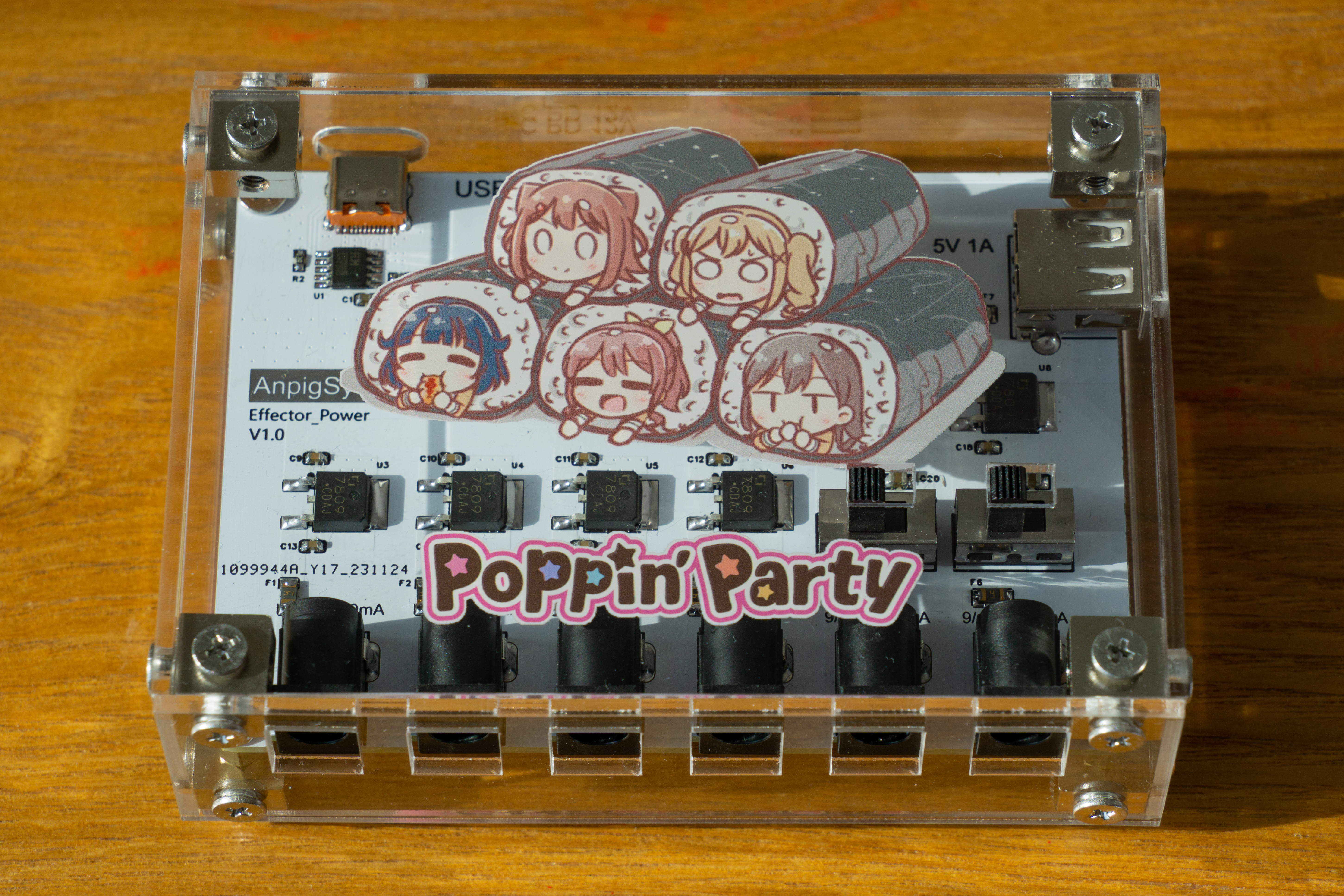

This is
a power supply for an effects unit using USB PD input. It features four fixed 9V outputs (500mA each), two selectable 9V/12V outputs (500mA each), and one USB-A output port (5V 1A).
Important notes:

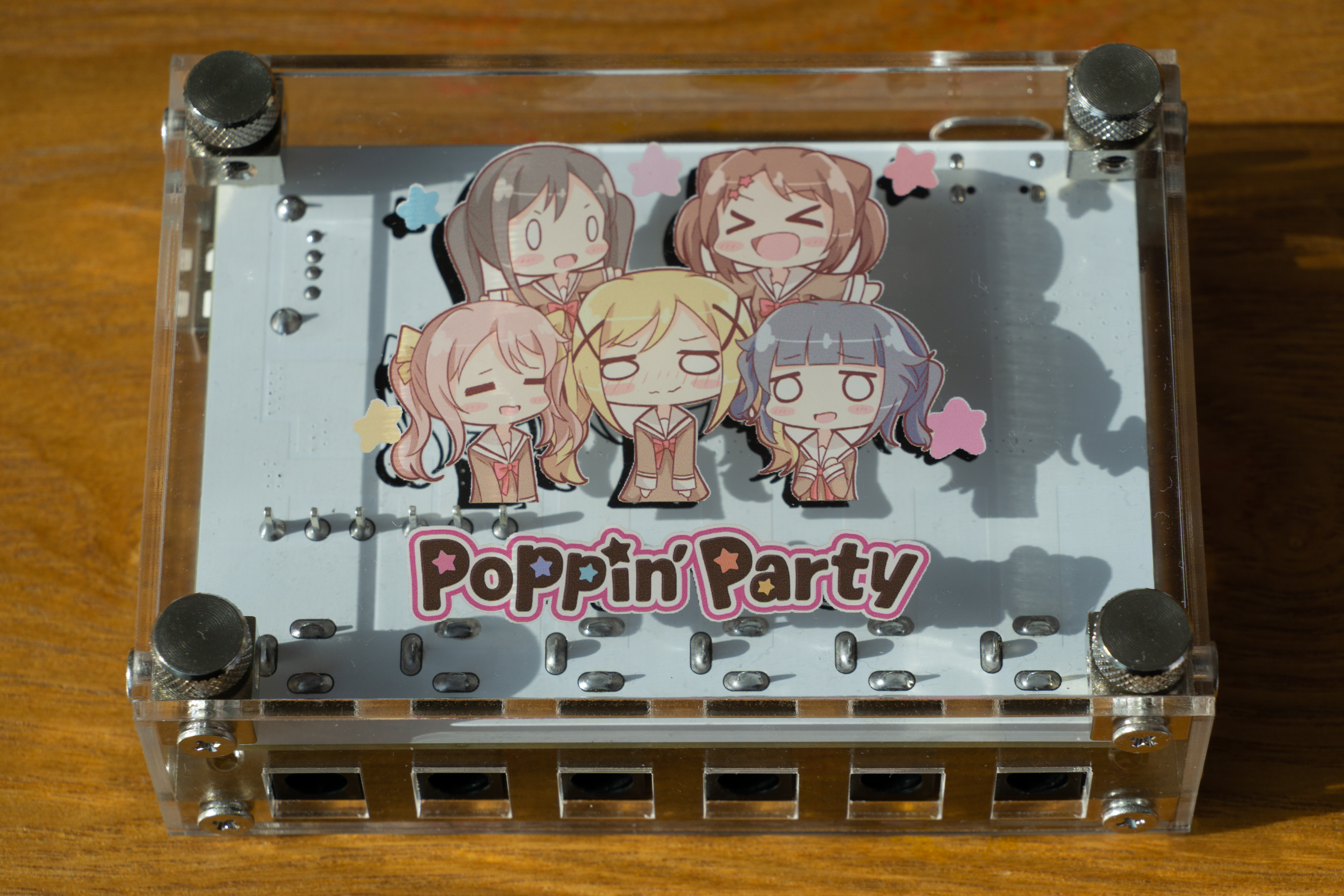

All DC outputs are externally positive and internally negative, and each has an individual resettable fuse. The power supply for the USB-C input must support the PD protocol and be able to output 12V.

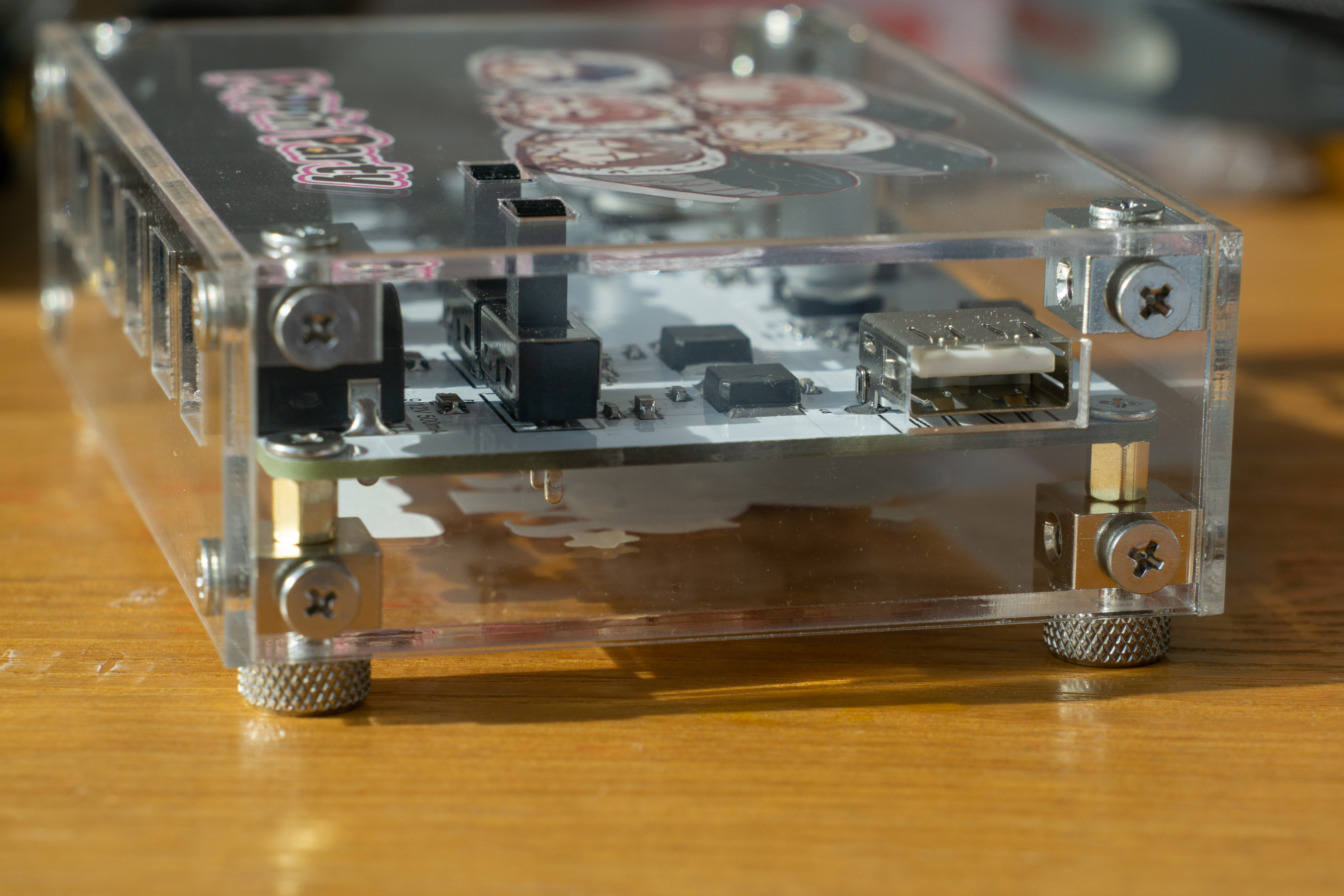

Screw and nut selection: M3+4mm flathead screws are used, bottom screws are M3 thumbscrews, copper pillars are M3*5+3 single-headed copper pillars, and the square tee nuts are 10*10*6mm.
Slide switch selection: The sample shown is SS12D10G9, 9mm high, only slightly exceeding the top shell. A longer one couldn't be found. If found, a longer
shell could be used with JLCPCB panel printing, 2mm thick, and printed on the back. The original source of the patterns on the shell and PCB could not be found; thanks to the original creator!
Sample image:
PDF_Effector_Power.zip
Altium_Effector_Power.zip
PADS_Effector_Power.zip
BOM_Effector_Power.xlsx
