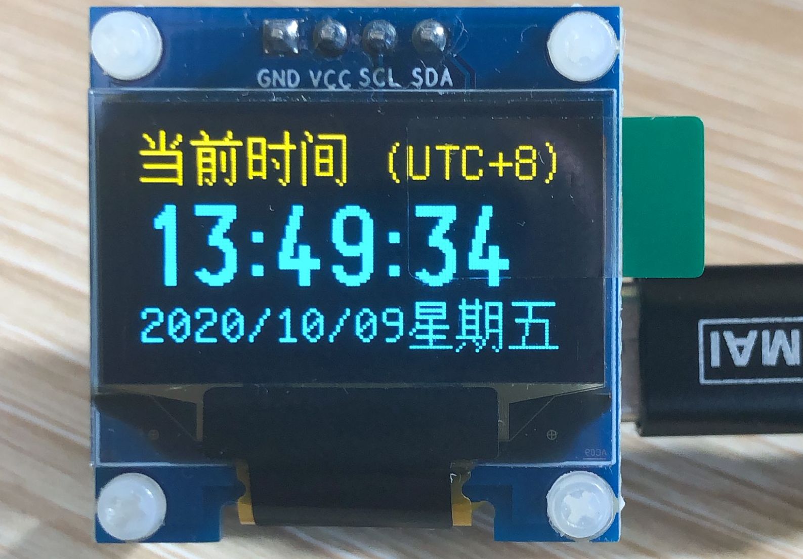

Before the National Day, I told Zhou Gong that I would open source two network clocks, but it has been delayed until now~
First open source a 1.3OLED network calibration clock. This clock is based on ESP-12F. In actual use, it is also possible to use 12S and 12E.

Then there is the entity diagram that I personally like

Hardware part: There is nothing special to pay attention to. I bought the components from Lichuang Mall and just soldered them:) When buying OLED, pay attention to the wiring sequence on the top. It is 35.4mm long and 33.5mm high. The fake Baoyouxin has finished products. The connection between the screen and the motherboard is a 3MM screw hole and bracket post. There are so many fakes~
Software part: The code basically has comments. I will mention some things that need attention.
1. The 1.3-inch OLED uses the SH1106 chip driver, while the 0.96 OLED uses the SSD1306 chip driver. Ours is a 1.3-inch one, so we write SH1106;

3. The bug part of this code : Because it uses the DYWiFiConfig library, the library itself has a small bug, so if you use this code directly, the clock will always transmit the AP defined in "#define AP_NAME "Esp12F Clock 1.3" The signal is unencrypted. Initially, this problem is not big, but when you connect to this AP and open 192.168.4.1, you will find out? ? ? ? Are your wifi account numbers and passwords clearly written on the page you open ? ? ? ? Interested friends can actually test the specific effect, but I won’t show the picture here.
    Solution: Comment out the following line of code in the second "If you don't need the Web background, you can comment out this line" position in the source code. I tried the first place, and it will cause an error that cannot be booted . Just follow the picture. Already :)
