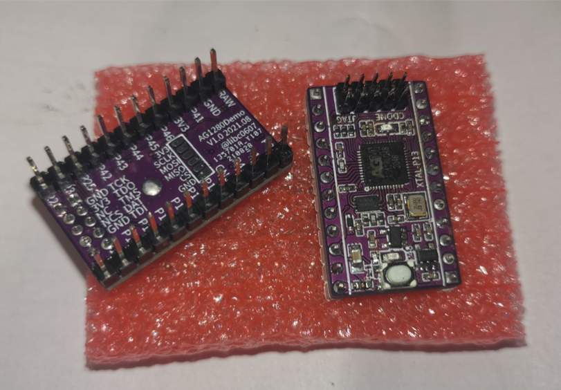

AG1280Q48 Minimum System Board V1
AG1280Q48 Minimum system
main.png3d.png Version V1.0
  • The shape and pin definition refer to Arduino Pro Mini, four-layer board
  • Only a single 3.6V~5.5V power supply is needed, there are two LDOs on board, and the IO level is 3.3V
  • Other onboard peripherals include: active crystal oscillator, SPI Nor Flash, buttons, programming interface, lights
  • The SPI Flash power supply has a diode and can be programmed independently from the flying wires on the back.
  • Mine was already ashes after I finished it.

Prepare a USB Blaster. I have tried the one from Taobao for more than a dozen yuan and the one from Zhengdian Atom, both of which can be used. The difference is that the cheaper one is slower.
First connect the USB Blaster to the board according to the pin definitions, then power on the board and connect the USB Blaster to the computer.
Open Tool - Program in Supra and click Query Device ID;
the Device ID of AG1280Q48 is 0x00120010. If connected correctly, this value will be read. Select the burning file just generated, where:
  • blinky1280_sram.prg is programmed into the internal SRAM and is lost after power failure.
  • If you need to save it after power off, select blinky1280_hybird.prg
Here we take SRAM as an example. After successful programming, as shown below, the light on the board should flash. 101.pngIMG_20210923_212945.jpg Use an oscilloscope to measure other pins and you can see the square wave output: 24204739.png
