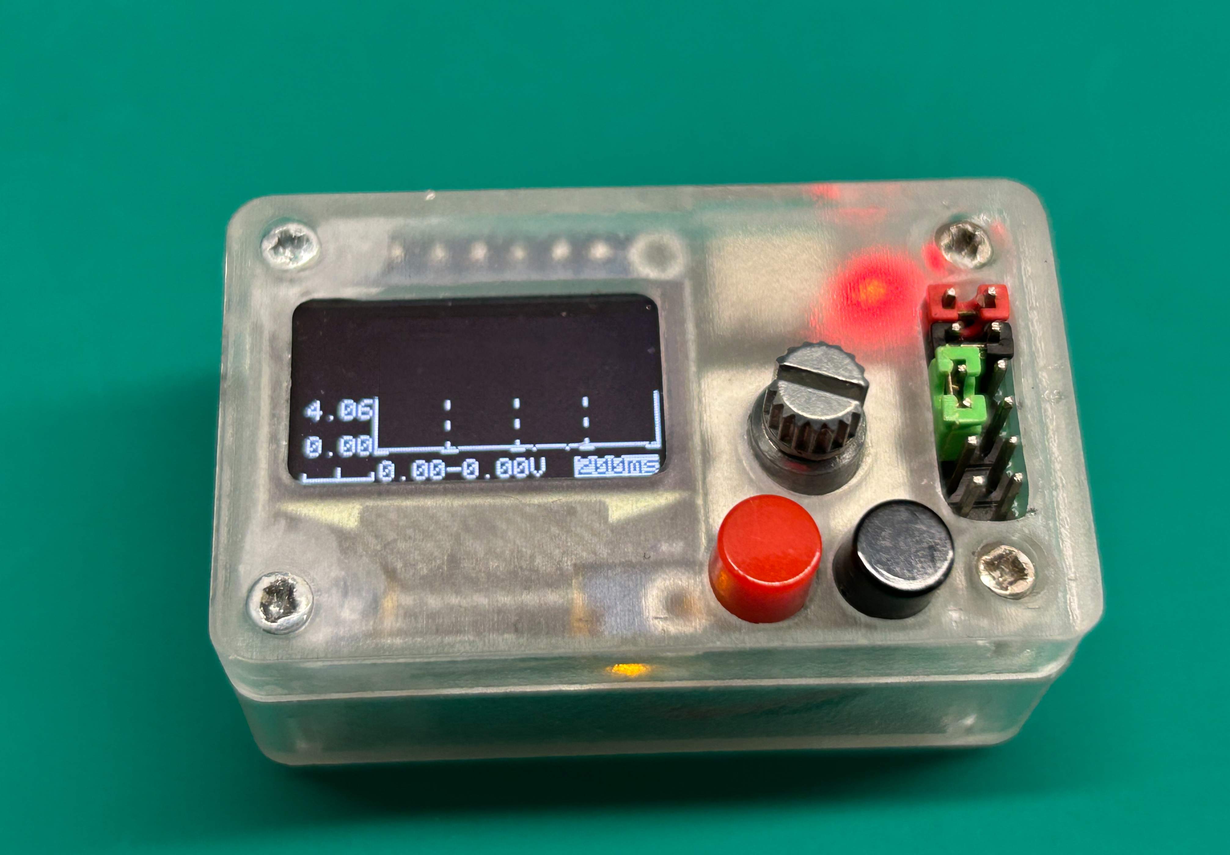

Functionality Overview:
1. Based on the Lao Liu oscilloscope, retaining all functions of previous Lao Liu versions. Hardware has been miniaturized as much as possible, undergoing multiple revisions. Currently, the size is 28x48mm. To reduce height, a surface-mount EC11 encoder is used. Both surface-mount and through-hole EC11 encoders can be used; simply adjust the soldering position.
2. Uses the STC8A8K64D4 chip. The STC8A8K64S4A12 chip has increased significantly in price, but its functionality is essentially the same as the STC8A8K64D4.
3. Added the CH340N chip, enabling direct USB program download and serial port read/write.
4. An IP5306 charge/discharge management chip has been added, allowing for lithium battery connection and portability. In oscilloscope mode, the 35-second automatic shutdown function is not enabled when using battery power; a pulse is sent via the P36 interface to prevent automatic shutdown. In lithium battery mode, pressing the P36 button once powers on using lithium battery power, and double-clicking disables lithium battery power.
5. An I2C tool function has been added, supporting reading and writing to I2C devices and dumping. Delay is supported.
The write format is writing to device 0x0c, writing 0x01 to register 0x0a, with a 100ms delay.
The read format is reading the value of register 0x0B from device 0x0c. A 1000ms delay format is used for
scanning and
dumping I2C devices, where 0c is the address of the device to be dumped. The
default I2C baud rate is 115200, accessible via a serial port tool; inputting
the baud rate provides help.
6. Upon power-up, the I2C tool function is entered by default and automatically scans for I2C devices. Once the device has been scanned, if a second scan is needed, press the P36 key or rotate the EC11 encoder. Pressing the P36 key once activates the IP5306, restarting the timer after 35 seconds and automatically powering off.
7. Press and hold the P36 key, then press the RST key again to automatically enter oscilloscope mode. In oscilloscope mode, there is no 35-second automatic shutdown limit when using battery function. When you press and hold the EC11 key and then exit, the 35-second automatic shutdown function will be automatically activated.
Hardware Notes:
1. If you only want to experience the oscilloscope function and do not need other functions, you do not need to solder the corresponding components IP5306, CH340N, AMS1117, Q1, Q2 and corresponding peripheral components. There are corresponding soldering shorting points in the PCB. Shorting the two power supplies to +5V is sufficient.
2. Pins 1 and 2 of J6 need to be shorted together to power the MCU. The purpose of this pin is to ensure that the MCU is completely powered off during the first download; otherwise, the download will fail.
3. Shorting pins 5 and 7 of J6 together allows communication via USB->CH340N->STC microcontroller serial port. Removing this shorting allows pins 7 and 9 to be used as TTL tools.
4. If using the I2C tool function, pins 3, 4, and 6 of J6 are I2C level selection pins, supporting 3V3 and 1V8 levels.
5. The physical demonstration shows the PWR power button for IP5306; updated versions have merged it with P36 for easier use.
Download Notes:
1. For the first download, use an external serial port tool. When downloading with an STC microcontroller, the serial port must be connected first, then the microcontroller must be powered on. Remember this order.
2. Download settings are as follows: IRC frequency selected as 27MHz.
3. Uncheck "Use the reset pin as an I/O port" so the RST button can be used as a reset button. Pressing this button again during the next download will automatically download.
4. Check "Add important test parameters at the end of the program area". It took me two days to recover from this mistake; the voltage readings are inaccurate if the oscilloscope function isn't enabled.
