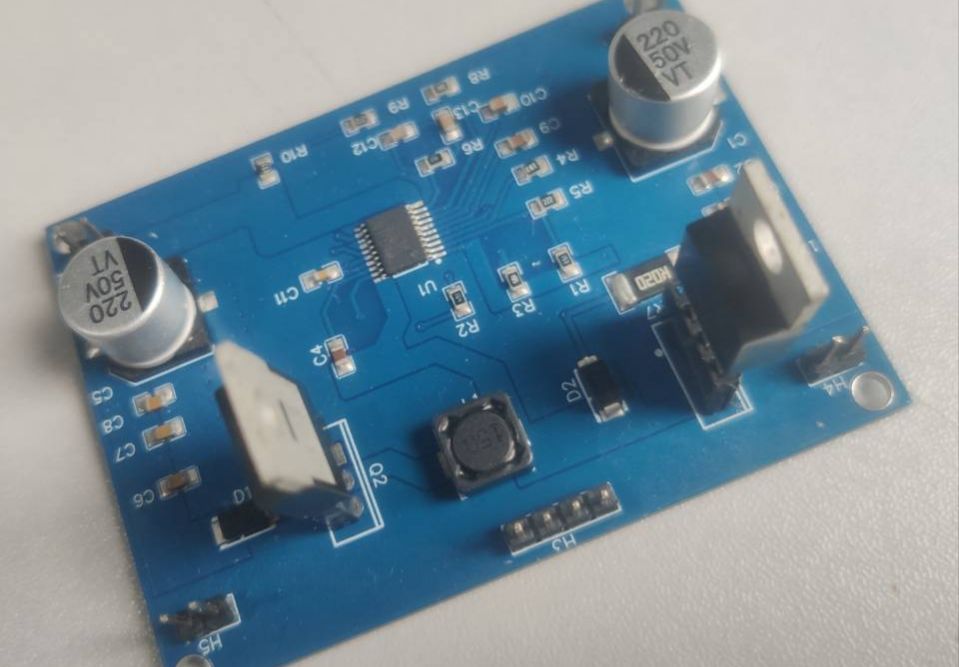

This design is a step-up and step-down module, using LM5118 to control the MOS tube to convert the step-up circuit and the step-down circuit. The design input of this design is 12V-24V and the output is a fixed 18V. The output voltage can be changed by changing the voltage division ratio of the three resistors R8, R9, and R10. The MOS can choose the same type of N-channel MOS tube according to the output requirements.
