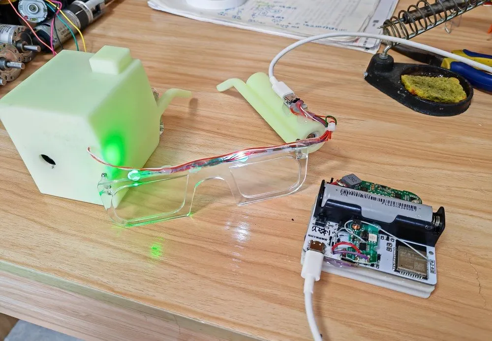

Homemade Succubus Glasses

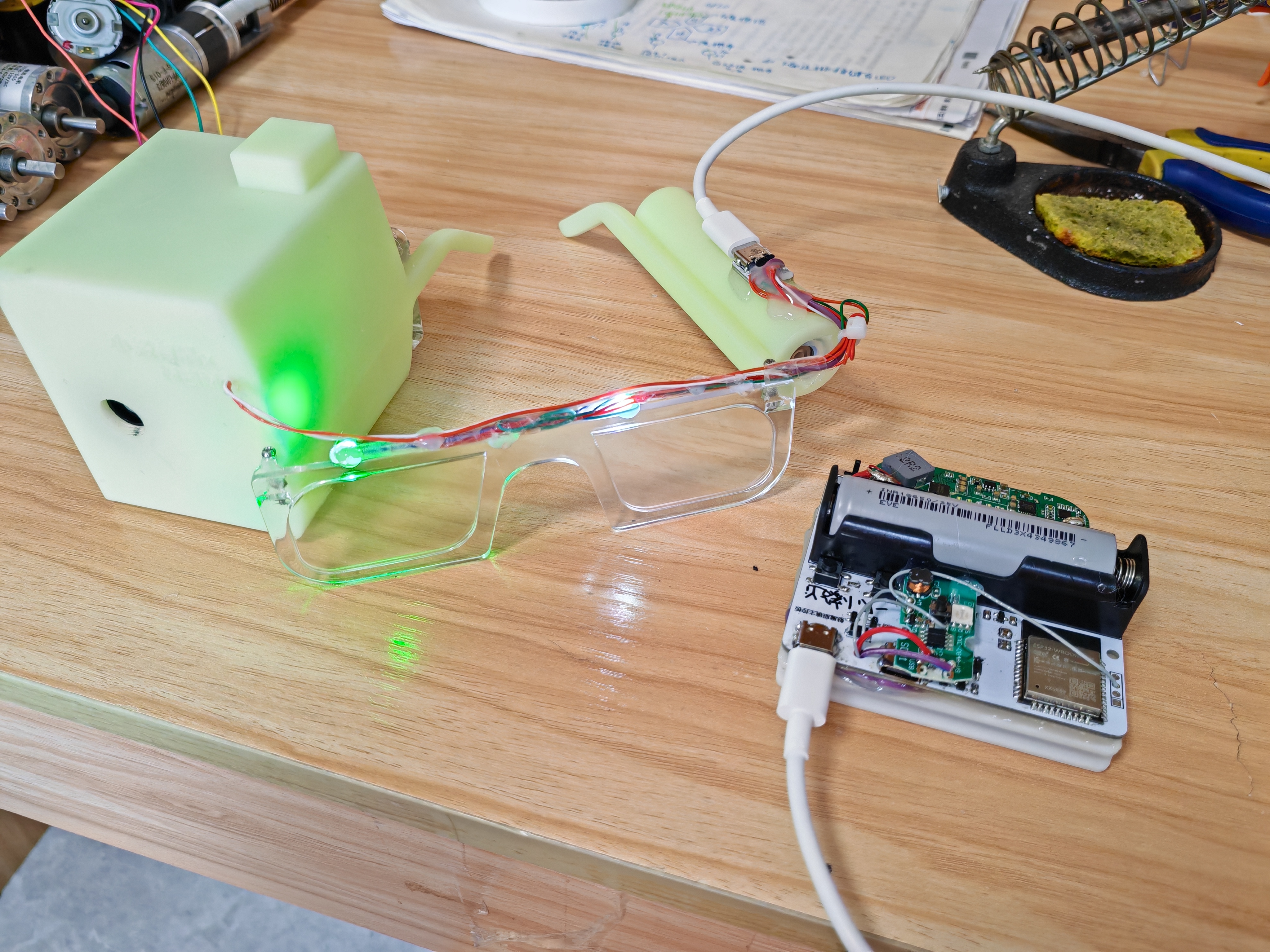

I. Design Functions:

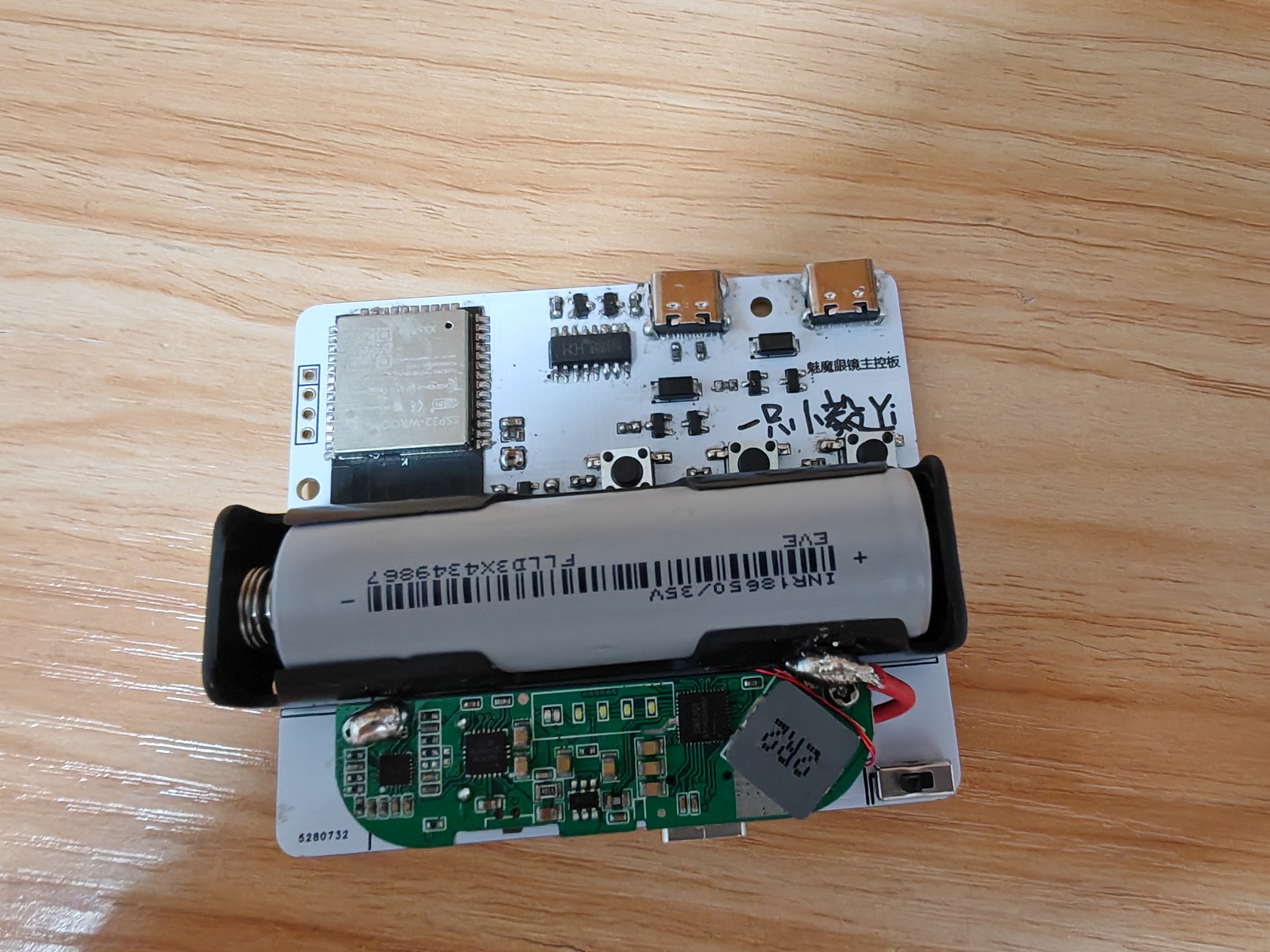

A magical pair of glasses with features including RGB lights on the lenses for displaying changing lighting effects, a bubble machine on the left frame for blowing colored bubbles, and a humidifier module on the right frame for creating a smoky atmosphere. Suitable for pranks and creating a lively atmosphere at parties. All functions can be controlled via a mobile app or a button. II. Structure:
The glasses themselves, along with a motherboard and battery box hanging on the back of the neck, are connected via a double-ended Type-C cable (proprietary protocol).
The glasses integrate two RGB lights, an ultrasonic atomizing plate with corresponding cotton swabs, a bubble machine, and a corresponding bubble solution bottle. An adapter board inside the glasses converts the cables of these devices to Type-C for easy connection to the main control box
. The box contains the circuitry and battery; the left Type-C port is used for uploading programs, the right Type-C port connects to the glasses, and the bottom Type-C port is used for charging (supports reverse charging as a power bank).
Materials used:
Bubble machine (core removed from disassembly). https://detail.tmall.com/item.htm?id=701462940556&spm= a1z09.12.0.0.11ca2e8dny0jW0&_u=j20c6g5s2te348
Humidifier (Core removed after disassembly) https://detail.tmall.com/item.htm?id=733374679653&spm=a1z09.12.0.0.11ca2e8dny0jW0&_u=j20c6g5s2t1d04

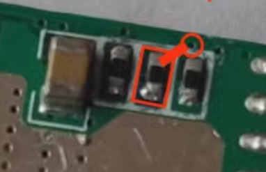

Power Bank Motherboard https://item.taobao.com/item.htm?spm=a1z09.12.0.0.11ca2e8dny0jW0&id=701513981873&_u=j20c6g5s2t54e6
(The resistor on the back needs to be changed to 10k.)

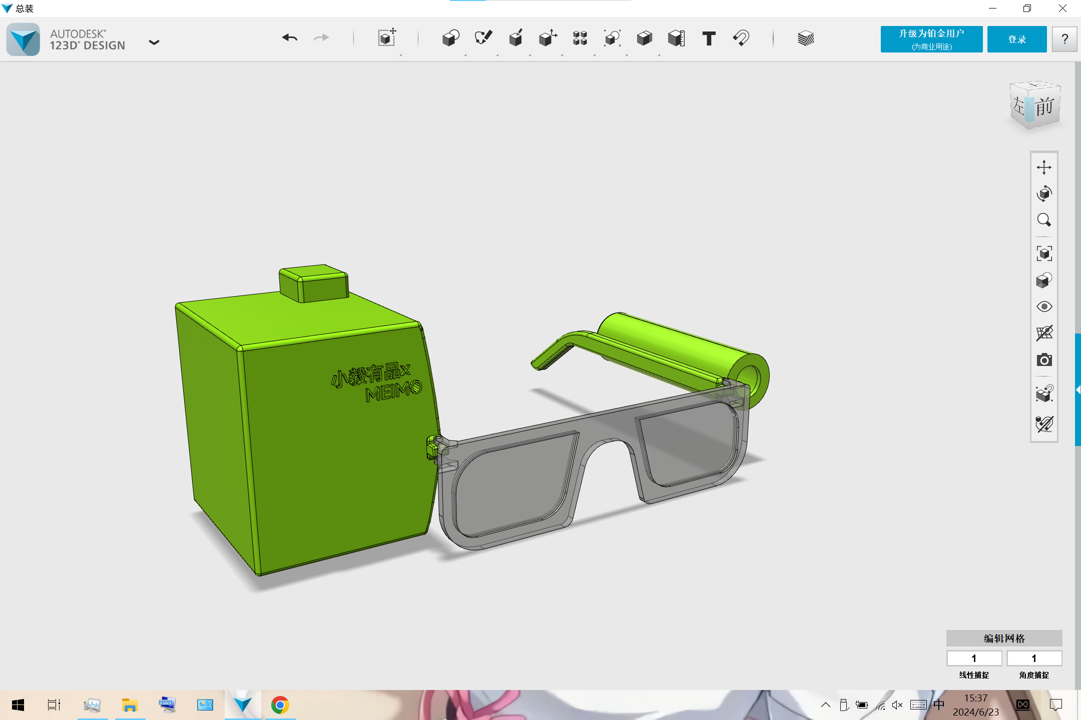

See the attached 3D printing file. Below is the assembly diagram: the bubble machine is installed on the left temple, and the spray module is installed on the right temple (left and right directions shown in the diagram). The humidifier is filled to hold the spray cotton strips.
III. Circuit details
are in the editor below. The actual circuit board diagram is shown below.
IV. Code:
See the attached ESP32 code (all.ino).
You need to download "Bluetooth Serial Port SPP" (attached base.apk) on your phone first, and then follow the instructions in the attached video.
V. Finished Product

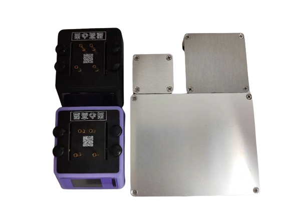

ECHO Heated Stand (V2)

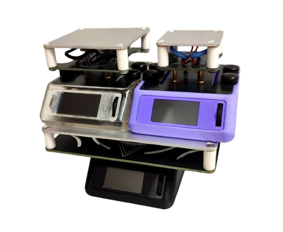

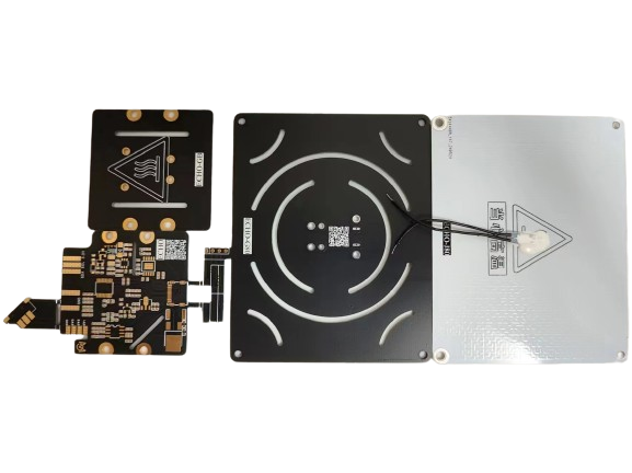

The ECHO heating stage V2 version combines domestically produced STC microcontrollers with domestically produced EDA design software, a powerful collaboration!
Update Log
2024/06/28
  Released ECHO Heating Platform V2
Precautions
: After setting up the ECHO heating platform:
Activate and set
the power. Clean
the heating plate
. Heat at approximately 220℃ for 1 minute to oxidize the aluminum substrate surface.
After completing the above steps, the heating plate will have very little solder adhesion.
Optimal operating temperature: 100-240℃, short-term operation at 300℃ is fine. Due to the insulation material of the aluminum substrate, excessively high temperatures will produce harmful gases and cause irreversible damage! Open Source
License
This project uses the CC-BY-NC-SA 3.0 open source license, i.e., Creative Commons Attribution-NonCommercial-ShareAlike.
CC: Creative Commons License
BY: Attribution, you must give appropriate attribution, provide a link to this license, and indicate whether modifications were made (to the original work).
SA: ShareAlike, if you remix, transform, or build upon this work, you must share your contributions under the same license as the original.
NC: NonCommercial, you may not use this work for commercial purposes. The ECHO heating platform V2 uses an STC8H8K64U microcontroller with built
in USB functionality, powered by a CH224K decoy chip, and supports PD3.0/2.0 protocols. The screen is a 0.96-inch TFT LCD display with a 45° angled display. The heating plate is made of aluminum (in three versions: H34/H50/H100), and the outer shell is 3D printed (PLA or FDM). The controller and heating plate are pluggable, facilitating the use of different heating platform models.
The domestically produced STC8H8K64U chip
features built-in USB hardware, supporting software updates
. The Type-C power interface supports PD3.0/2.0 protocols.

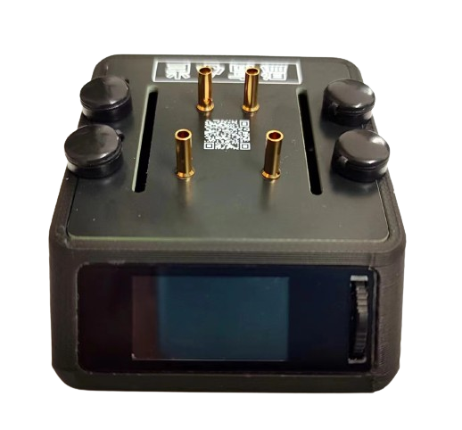

A 0.96-inch TFT color LCD screen
with a 45° angled display makes data viewing more convenient
. A front-mounted dial switch facilitates one-handed operation.
Three operating modes are available: constant temperature mode, curve mode, and reflux mode.
The controller and heating platform have a plug-in design, supporting the replacement of heating plates of different areas. The outer
shell can be printed using photopolymer 3D printing. Different colors and materials can be selected
using JLCPCB 3D printing.

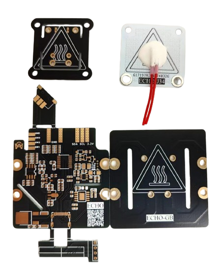

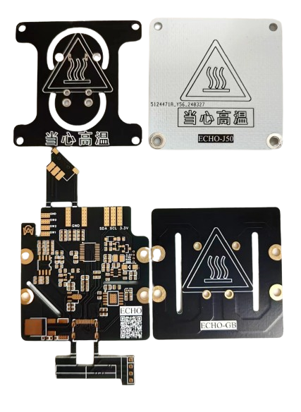

ECHO34 requires printing four PCB files: ECHO-Control Board, ECHO-Cover, ECHO-J34, and ECHO-G34.
                                    Figure 1. PCBs required for ECHO34. The
ECHO50 requires printing four PCB files: ECHO-Control Board, ECHO-Cover, ECHO-J50, and ECHO-G50.
                        Figure 2. PCBs required for ECHO50 .
                            The PCBs required for ECHO100 (not yet open source).

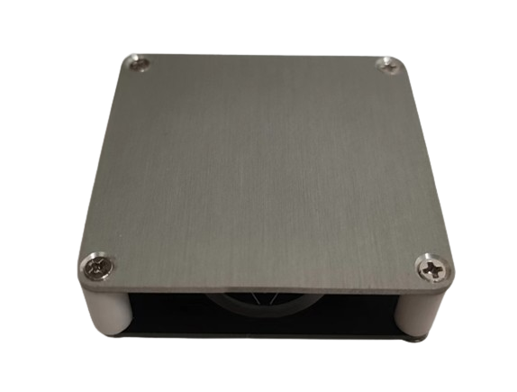

ECHO-J34 and ECHO-G34 are combined to form the H34 heater.
                                 Figure 3. The H34 heater
ECHO-J50 and ECHO-G50 are combined to form the H50 heater.
                             Figure 4. The H50 heater
ECHO-control board and ECHO-cover plate are combined to form the controller.
                              Figure 5. The controller
can be combined with the H34 heater/H50 heater/H100 heater to form ECHO34/ECHO50/ECHO100 respectively.
                                        Figure 6. ECHO Whole Box

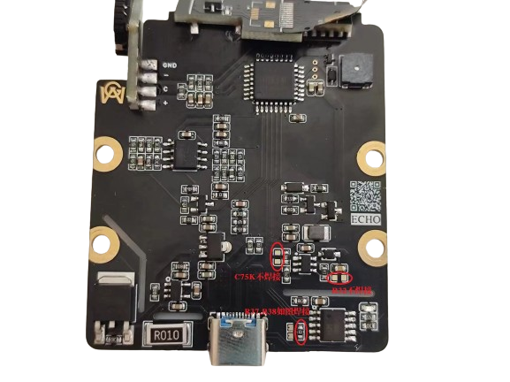

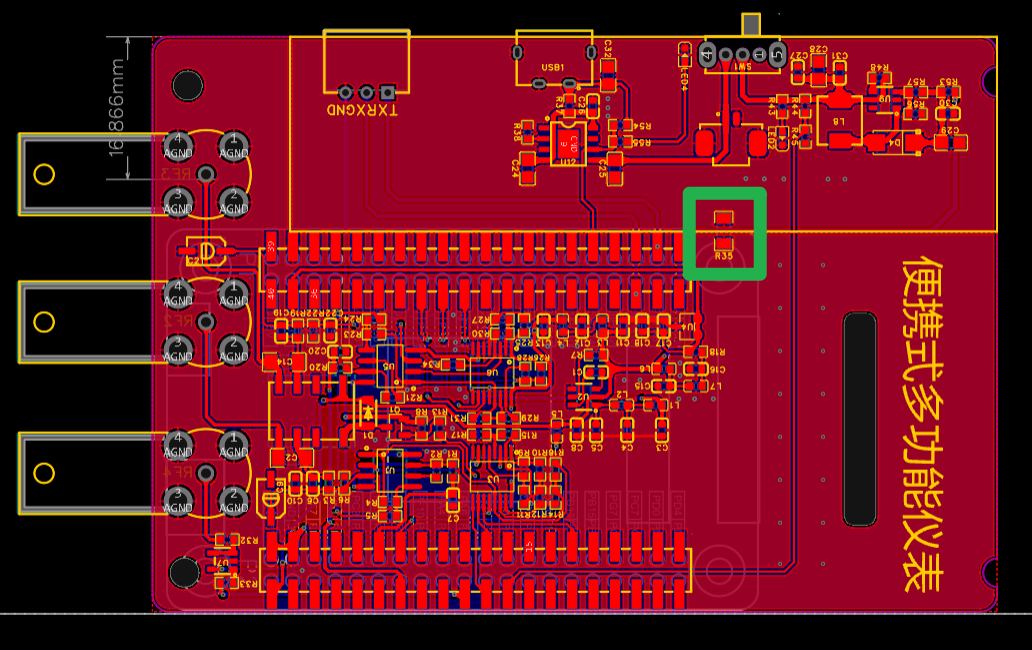

The above picture is a physical soldering diagram. There are three points to note:
Do not solder the C75K capacitor
. Do not solder R32
. Solder R37 and R38 as shown in the diagram.
Solder the 8P base of the screen to the corresponding 8P screen. 13P is for soldering the screen.

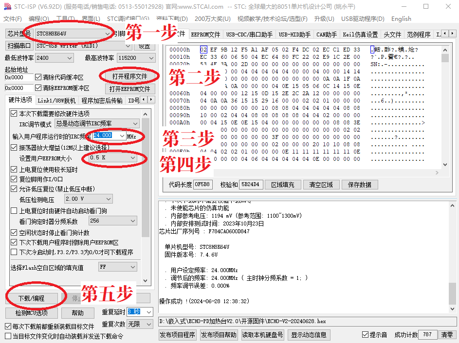

II. Program Download Tutorial
Ensure correct soldering before proceeding!
Open the STC-ISP software on your computer, plug in the Type-C data cable,
press and hold the ECHO heating station function button, and quickly insert the Type-C data cable's C port into the ECHO heating station's C port
. If the soldering is completely correct, the STC-ISP software will display "STC-USB Writer (HID1)," as shown in Figure 7.
If the hardware is not correctly identified, repeat steps b and c until it is correctly identified
                   (Figure 7).
After successful hardware identification, perform the following operations (Figure 8):
Chip model selection: STC8H8K64U;
IRC frequency: 24MHz
; EEPROM size: 0.5K;
Open program file: ECHO-V2-20240628.hex
(Download
                                                                                   Figure 8). Software configuration:
Before downloading the program, abnormal voltage inducement is normal. Test the 3.3V output voltage using a standard 5V power supply.
After downloading the program, the screen should display correctly. If not, check it yourself.

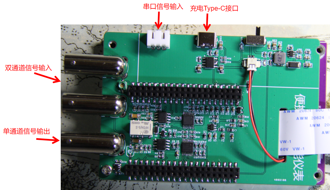

This project is a portable multi-functional instrument designed based on the Liangshanpai development board and the matching 4.3-inch RGB touch screen priced at 98 yuan. It has functions such as dual-channel oscilloscope, signal generator, and serial port data viewer. The 148 yuan version will also be open source after the subsequent program is adapted.
The specific usage video has been released on Bilibili. Welcome to watch: [Click to jump to Bilibili physical demonstration video!]

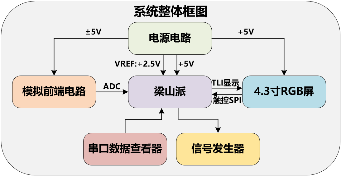

1. The overall system block diagram is as follows:
Some contents of this project refer to the official case of Liangshanpai oscilloscope [oscilloscope expansion board], and supplement and improve it in many aspects to realize the functions of rechargeable portability, dual-channel signal acquisition, 4.3-inch large screen, full touch human-computer interaction, serial port signal viewing (supports Chinese characters) etc.

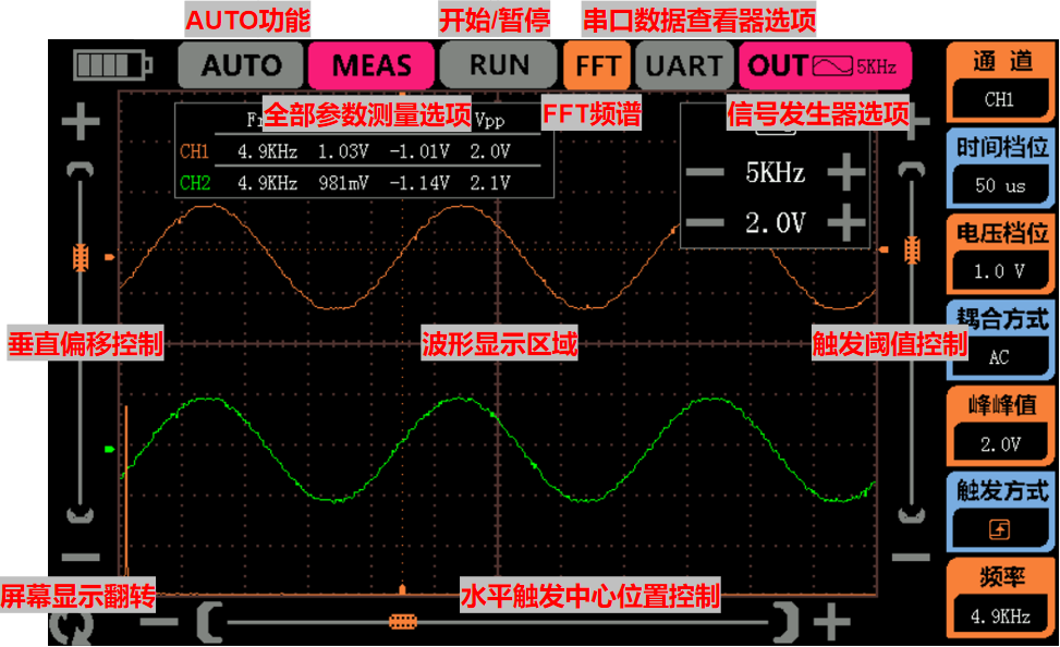

(1) Oscilloscope
① Supports dual-channel maximum ±10V peak-to-peak signal input, sampling rate of 2MSPS, and the measured waveform can be displayed stably.
② Supports one-key Auto function, which automatically adjusts the waveform to the appropriate display conditions.
③ It has a trigger function, which can realize the adjustment of waveform vertical offset, horizontal offset, trigger threshold, etc.
(2) Signal generator
① Supports the output of five waveforms: sine wave, square wave, triangle wave, positive sawtooth wave, and anti-sawtooth wave.
② The output frequency supports continuous adjustment in 1KHZ-50KHZ.
③ The output peak-to-peak value supports continuous adjustment in 0.1V-2.5V.

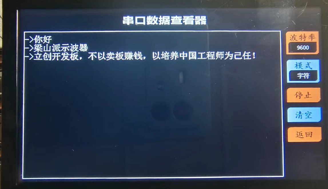

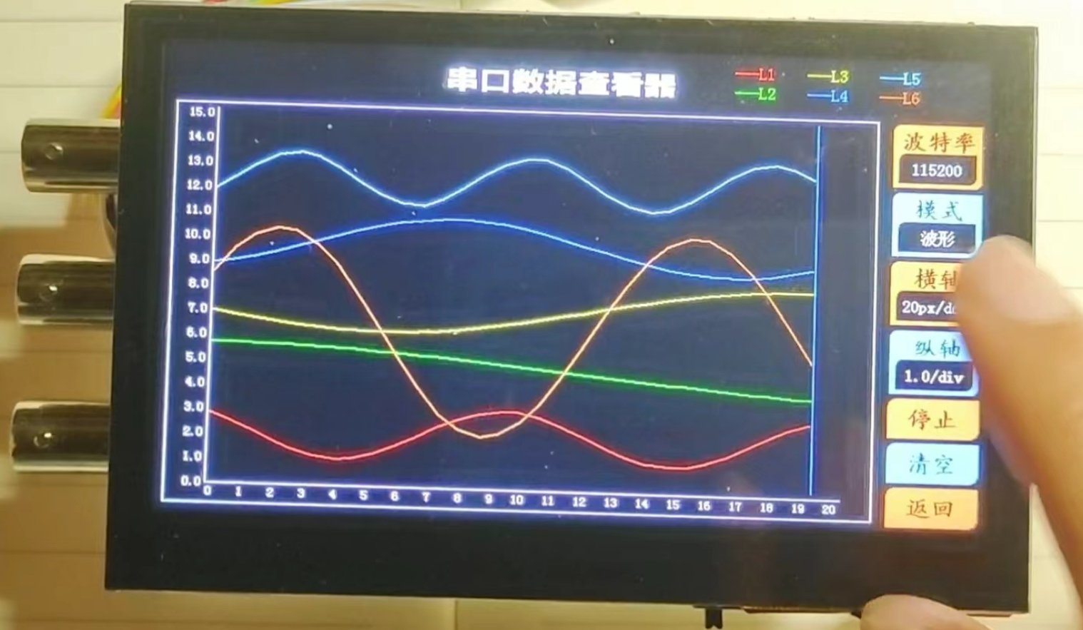

(3) Serial port data viewer
① Supports adjustment of multiple baud rates.
② Supports text display, HEX data display, and waveform analysis display functions.
③ Supports receiving and displaying any Chinese characters.

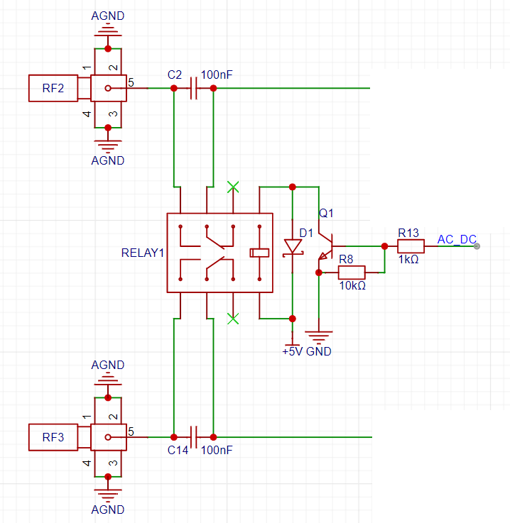

1. Signal coupling circuit
The microcontroller controls the corresponding GPIO high and low levels, thereby controlling the solid-state relay to realize AC/DC coupling of the input signal.

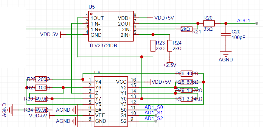

2. Analog Front-End Circuit:
The analog front-end circuit is based on the official case study of the Liangshanpai oscilloscope expansion board. For details, please refer to: [Oscilloscope Expansion Board]
Signal Attenuation Circuit:
Signal Gain Processing and Vertical Shift Circuit:

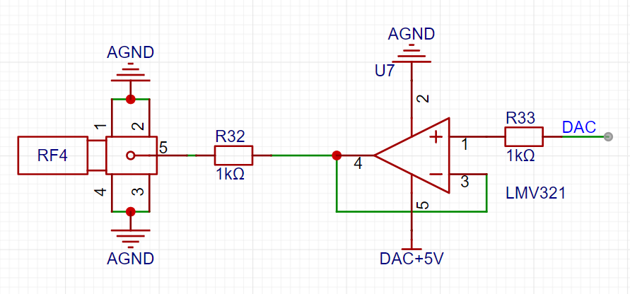

Signal Generator Circuit.

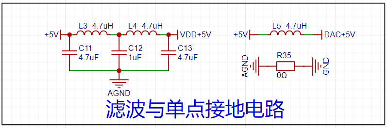

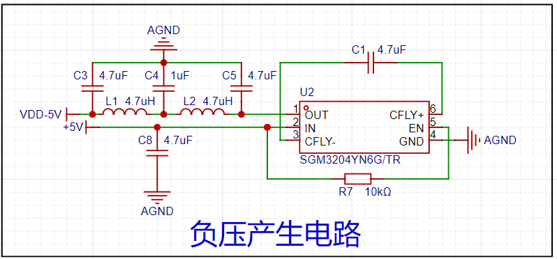

3. Power Supply Circuit
: An SGM3204 charge pump generates -5V to power the dual power supply of the operational amplifier.

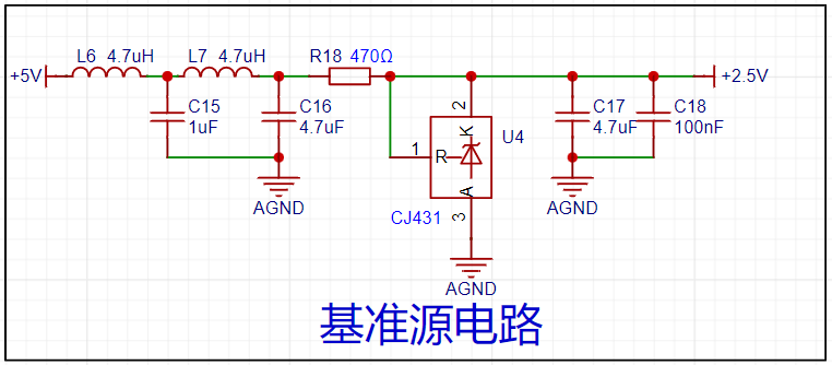

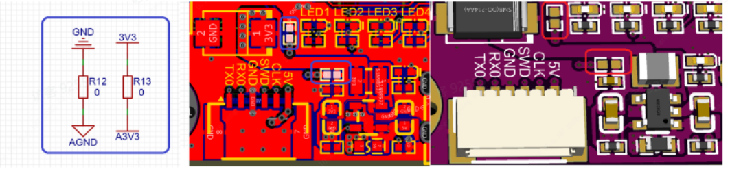

A CJ431 generates 2.5V as the reference voltage for the microcontroller's ADC. Note that the default reference voltage for the Liangshanpai ADC is 3.3V. Therefore, it is absolutely essential to remove the 0-ohm jumper resistor for the corresponding A3.3V AGND on the Liangshanpai; otherwise, the measured data will be incorrect, and the circuit may even be damaged.

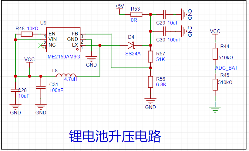

An ME2159AM6G is used to boost the lithium battery voltage to 5V.

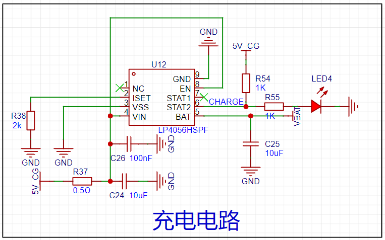

The lithium battery charging management uses an LP4056HSPF. During charging, an LED will light up to indicate that charging is in progress; the LED will turn off when charging is complete. Due to space constraints, this project uses a 3mm thick, 50mm*60mm 1200mAh lithium battery to power the entire system. Hot melt adhesive is used to install it between the PCB and the RGB screen.

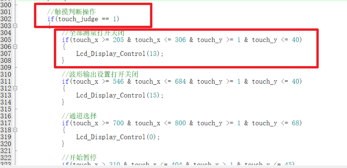

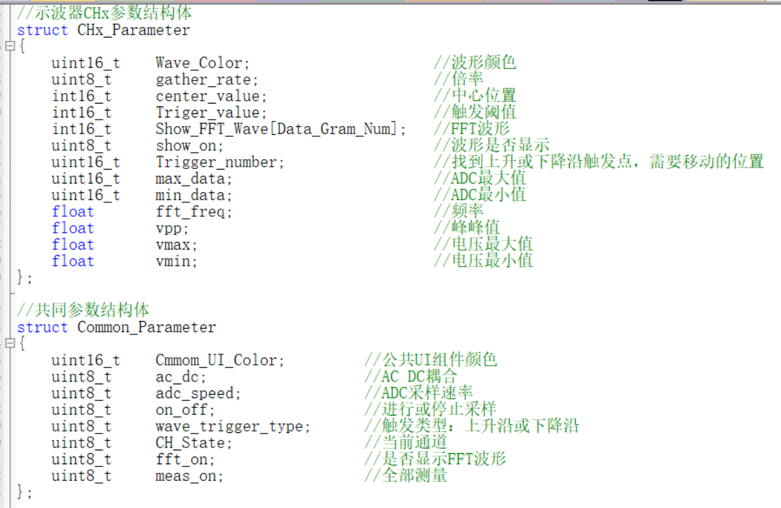

The OSC.h and Wave_out.h files define relevant structures that encompass almost all modifiable parameters of the oscilloscope.
The Init_Oscilloscope function allows for convenient initialization of parameters such as sampling channel waveform color, initial sampling rate, initial signal gain, and AC_DC.

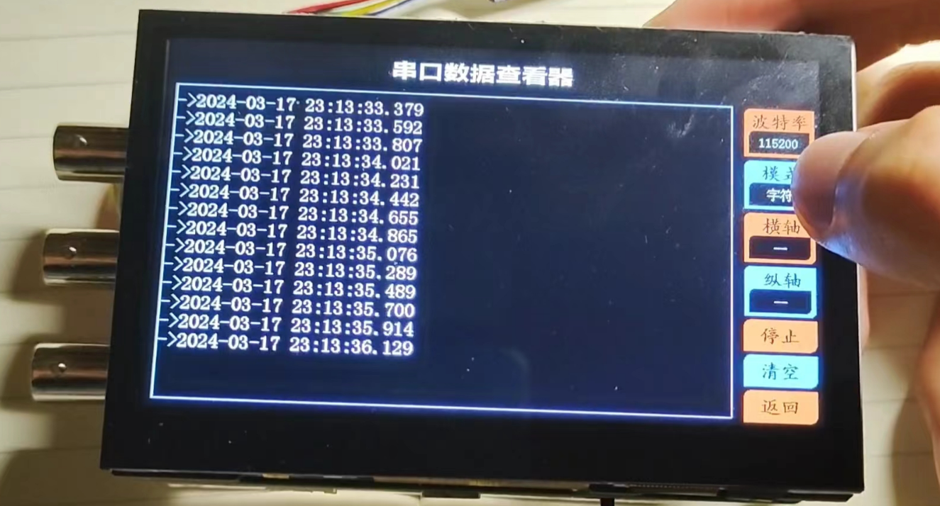

3. Screen Touch Control:
The 4.3-inch screen used in this project supports up to 5-point simultaneous touch, but for ease of control, this project only supports single-point touch. As shown in the program below, when the touch_judge variable equals 1, it indicates that the screen has been pressed. Then, touch_x and touch_y are used to determine the area pressed, finally identifying the pressed position and executing the corresponding function. Based on the different touch priorities of each button, the touch position determination is placed in the timer interrupt service function and the corresponding function. Due to my limited experience, I feel this method is somewhat inefficient (or perhaps requires LVGL?). I welcome expert advice and suggestions for simpler and more convenient coding methods.

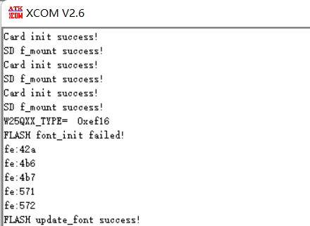

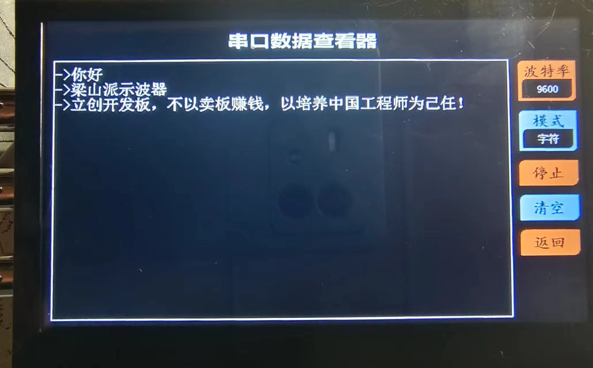

4. The method for receiving and displaying Chinese data in the serial port data viewer
is more in line with language habits. Since we sometimes use Chinese for serial port data debugging, this project saves the font information to the SPI_Flash on the Liangshanpai board, adding the function of receiving and displaying Chinese serial port data. It has functions such as baud rate adjustment, data parsing mode adjustment, start/stop monitoring data, and clear window. The Chinese display is shown in the figure below.
The steps for flashing the font into the SPI_Flash are simple. Just prepare a 16G or 32G TF card (other capacities haven't been tested, so I don't know if they will work), insert it into a card reader and connect it to the computer. Create a folder named FONT in the root directory of the TF card, decompress the font file (provided in the attachment) and store it there. Then insert the TF card into the TF card slot of the Liangshanpai board, flash the Chinese font flashing program in the attachment, and reset. Next, use a serial port assistant on the computer to monitor the real-time status of the font library writing process. The whole process takes about one or two minutes. When you receive "FLASH font_init success!", the font library writing is complete, and the serial port data viewer can then receive and display Chinese data!

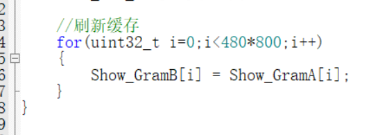

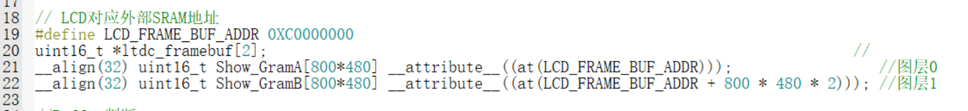

5. Screen Refresh
This project uses EXMC to refresh screen data. After initializing the screen display parameters, simply modifying the screen cache data stored in the external SDRAM will automatically refresh the screen data. Users do not need to manually refresh, which is very convenient, and the display frame rate is also very high. The Liangshanpai has a built-in RGB FPC interface, which can be connected to the screen's RGB interface using a ribbon cable, which is also very convenient.
Since the waveform and some components need to be superimposed on the grid, if the screen display function is called immediately every time the screen display content is changed, the waveform will flicker. Why is this? If you refresh the waveform grid (raster) to the screen first, and then refresh the waveform itself, the previously displayed waveform will be overwritten during the grid refresh process. This will cause a brief period where the waveform is not displayed on the screen. Then, when the waveform is refreshed again, it reappears. This intermittent display of the waveform creates a flickering effect. To address this, a dual-buffering approach is used: Buffer 1 is used for screen refresh, and Buffer 2 is used for temporary pixel data modifications. When an update is needed, Buffer 2 is moved to Buffer 1. However, this is a rather crude approach, using direct copying. This has obvious drawbacks: it blocks CPU operation (on an 800*480 screen), reducing efficiency. Therefore, I welcome suggestions from experts on more efficient display methods (such as alternating between the two buffers for screen display; I tried this, but it didn't work, so frustrating!).

Specifications: Ease of Use: The entire board uses 0603R, 0603C, LQFP, and TSSOP packages, making soldering very easy. High Performance: Peak drive capability up to 60A, with PWM resolution up to 5000 points, high-performance SVPWM lookup table output, and stable operation as low as 14us. Communication: Uses CAN protocol for control, with a control frequency up to 1kHz. Internal closed-loop frequency up to 16kHz, and can transmit encoder data back. Strong Compatibility: The board comes with 4x2.8mm holes (M2.5 screws recommended), and can support motors with various hole positions via adapter boards. Currently, it is compatible with the ZD2808 motor (this motor is recommended). Sufficient Safety: Although it lacks a current loop, it still has stall current limiting protection, and actual testing shows it to be quite stable.
Cost: The total cost is less than 50 RMB (based on three sets of motors, calculated on average per motor, as shipping costs are also included). If only the PCB and component costs are considered, it is even less than 15 RMB. Therefore, the cheaper the salvaged or new motors you can find, the cheaper the entire set will be. We will add information on purchasing channels and recommendations later to help you better replicate and use the motor.
Function Introduction: The motor has common enable functions (it can rotate freely after being disabled; at this time, you can use the encoder readback function to obtain encoder values ​​for teaching purposes). In addition, the motor has speed mode, position mode, servo mode, and a three-stage switch mode. The servo mode also has a unique automatic boundary finding function; when switching from other modes to servo mode, it will automatically find the boundary and automatically return to zero.
Finally: We recommend this motor for use as a wheel-side motor in smart car projects. The high-speed response of FOC is significantly simpler than that of brushed motors. Especially its compact integrated drive and control, the convenience of the built-in high-precision magnetic encoder, the simple direct-drive structure, and the powerful full-torque output at startup are all advantages of using a brushless motor. The software and hardware are completely open source, without any restrictions. You can modify a single character and claim it as your own; I am simply sharing my research results. We also welcome everyone to research high-performance motor drives, which is particularly significant for improving the upper and lower limits of top-level algorithm control.

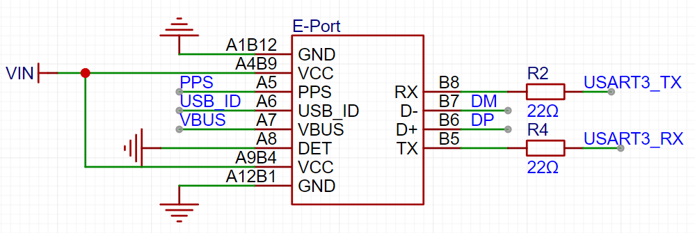

1. E-Port Interface Design
From a hardware perspective, the E-Port interface is compatible with the ordinary USB Type-C hardware interface, but the related pin functions need to be redefined. Depending on usage requirements, USB Type-C female connectors come in many types, with mounting methods including through-hole, surface mount, vertical mount, and recessed mounting, and pin counts of 2 pins, 6 pins, 16 pins, and a full-featured 24 pins.
For the E-Port interface, a 16-pin Type-C interface is sufficient.
Draw the E-Port device and bind a 16-pin Type-C package; connect the VCC pin to the VIN network, and ground GND and the DET pin used to detect load connection status; connect the serial communication to the microcontroller accordingly; and reserve relevant interfaces.

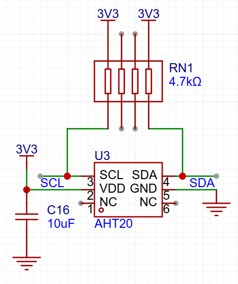

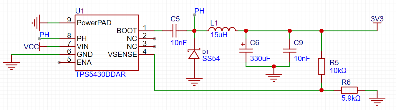

4. The AHT20 temperature and humidity sensor design
references the AHT20 datasheet. The circuit design is as follows:

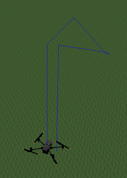

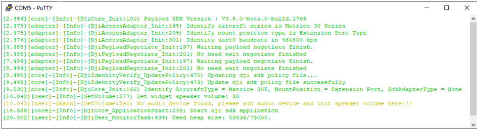

Connect the drone, burn the Bootloader and PSDK sample application into the chip, and the output information is as follows:
The drone connection is normal, and the drone can be controlled through the PSDK; for example, drone flight control (running in the DJI Assistant 2 software):
See the attached video for specific running effects.

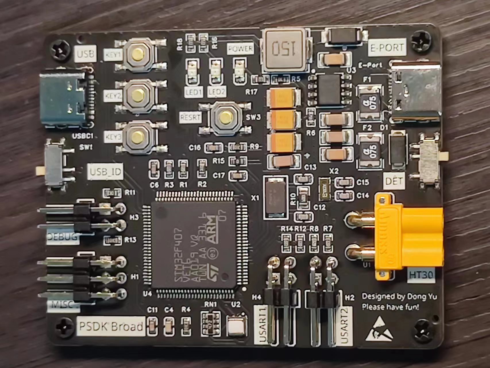

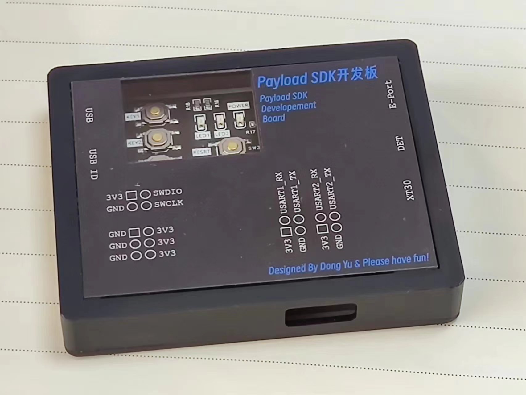

The physical
circuit board is shown below:

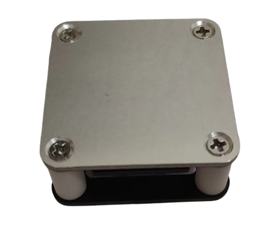

(1) The interfaces for connecting the drone and the debugging equipment are designed on the left and right sides respectively, which is convenient for connection and debugging;
(2) There are 4 screw holes around the board for connecting the PSDK bracket and fixing it on the drone.

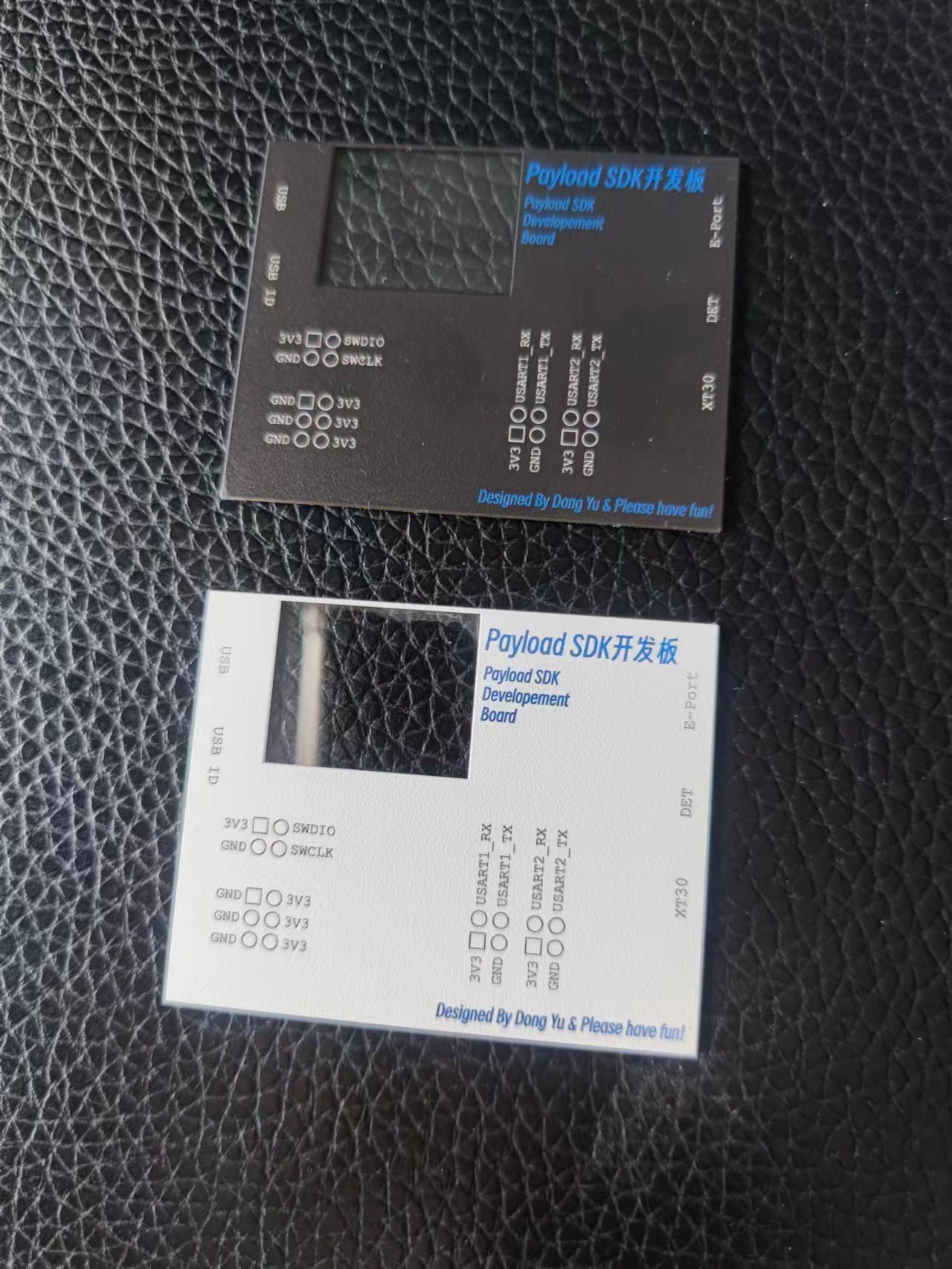

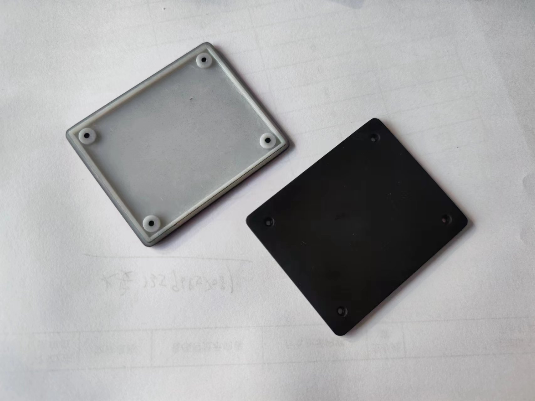

Of course, a shell also needs to be set for it, which is also sampled at Jialichuang.
The front part here uses Imagine Black material, while the bottom uses ordinary nylon paint, which has a better effect. However, it is a bit thin because of the bottom cut, but fortunately there is a panel to support it:
I made two kinds of acrylic panels here, black and white. The function of each interface and the definition of the header pin are marked on it.
The complete assembly is as follows:

When designing, you must make sure that the DET pin of E-Port is grounded, otherwise the drone will not be able to recognize the development board.
