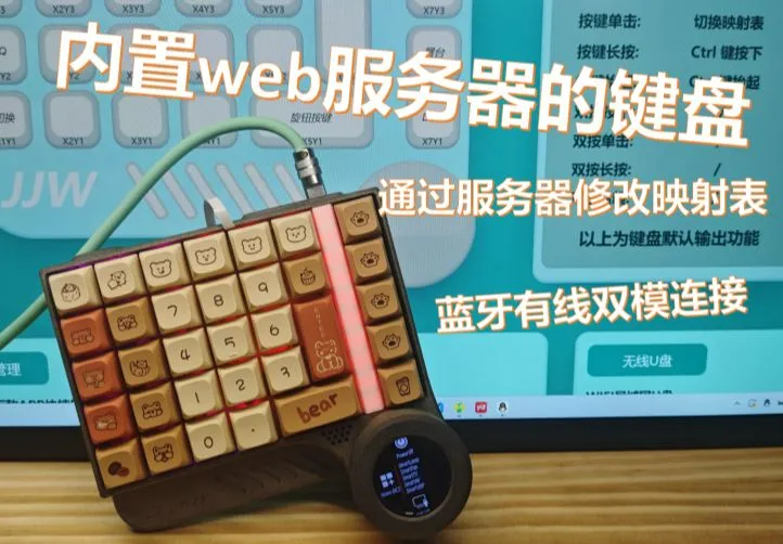

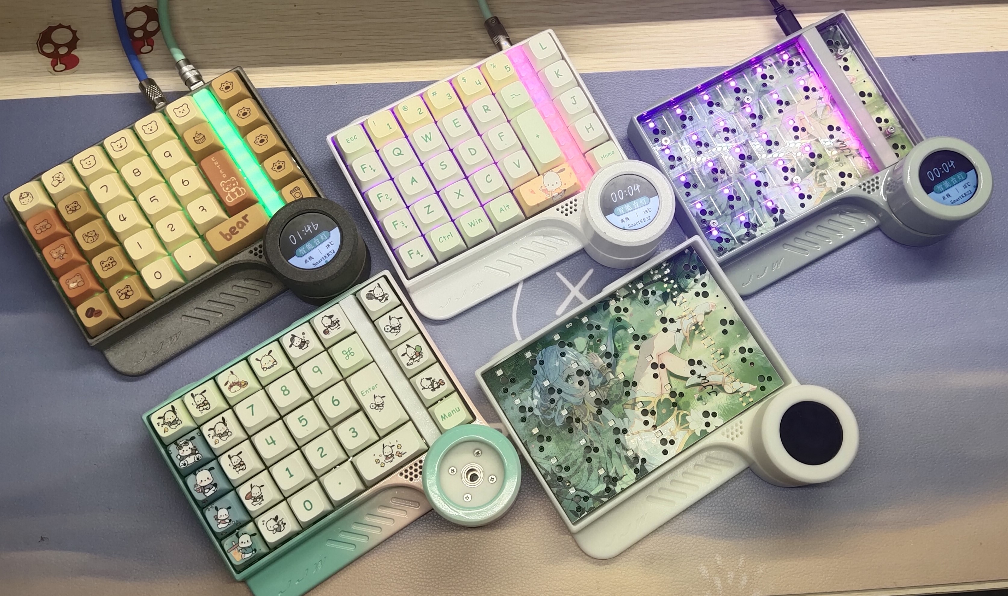

As an embedded systems enthusiast, my needs for various design software applications differ, and so does my usage of keyboard shortcuts. Most keyboards on the market don't fully support the number of macro definitions required by every software. Many custom keyboards have knobs, but these are mostly for adjusting computer volume, screen brightness, etc., and the knobs are located on the right side of the keyboard, which isn't convenient for design needs. Therefore, I combined the design of a keyboard and SmartKnob, integrating them into one unit. I also integrated a Surface dial and adopted a left-handed design to improve the utilization of the smart knob. Combined with the mouse and the multi-key mapping table on the keyboard, this achieves faster work. Furthermore, this design can control some smart home devices (including smart lamps, desktop power supplies, etc.).

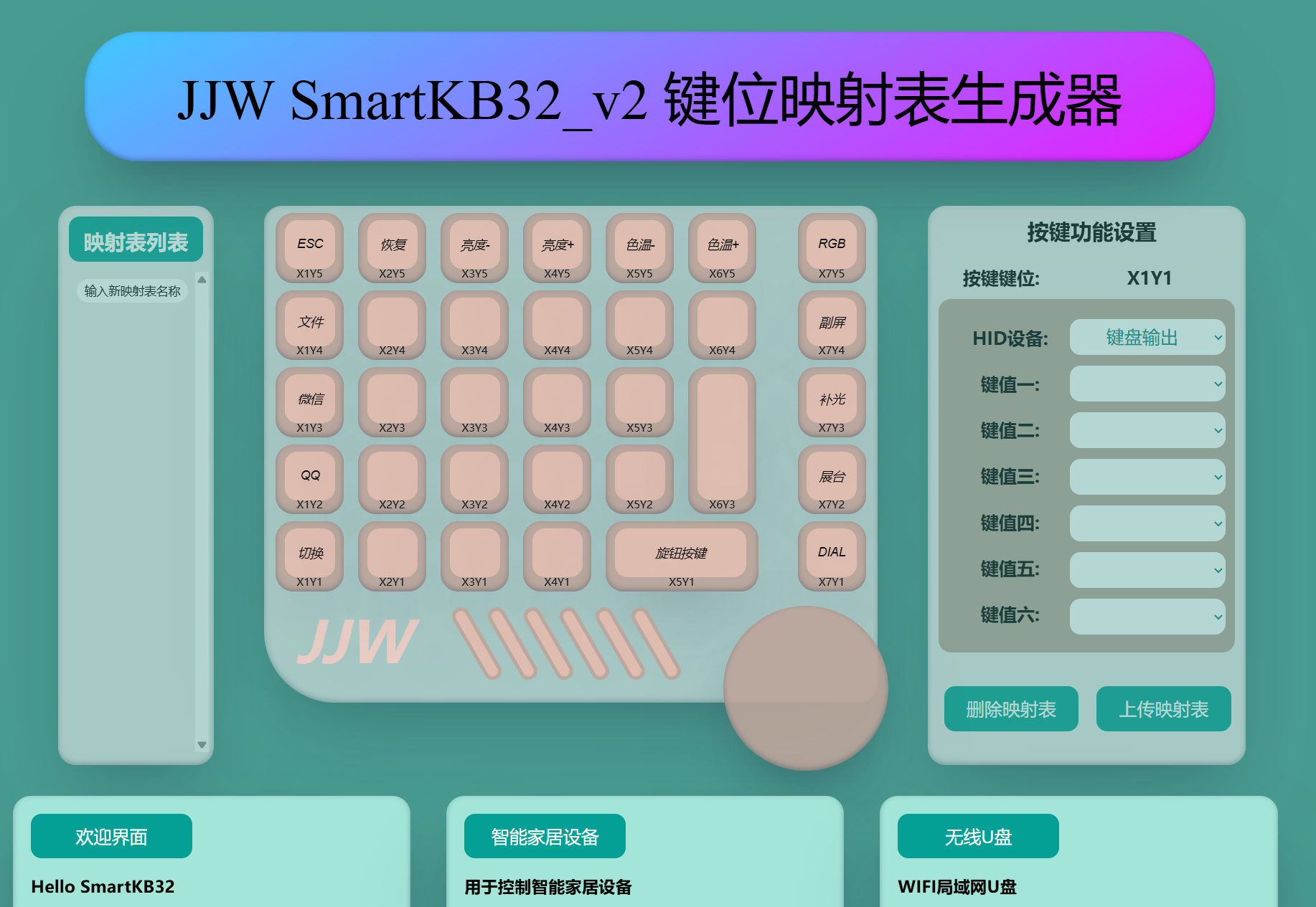

Webpage Mapping Table Generation:
Utilizes a built-in server to modify key mapping tables in real time, compatible with computers, mobile phones, tablets, etc.

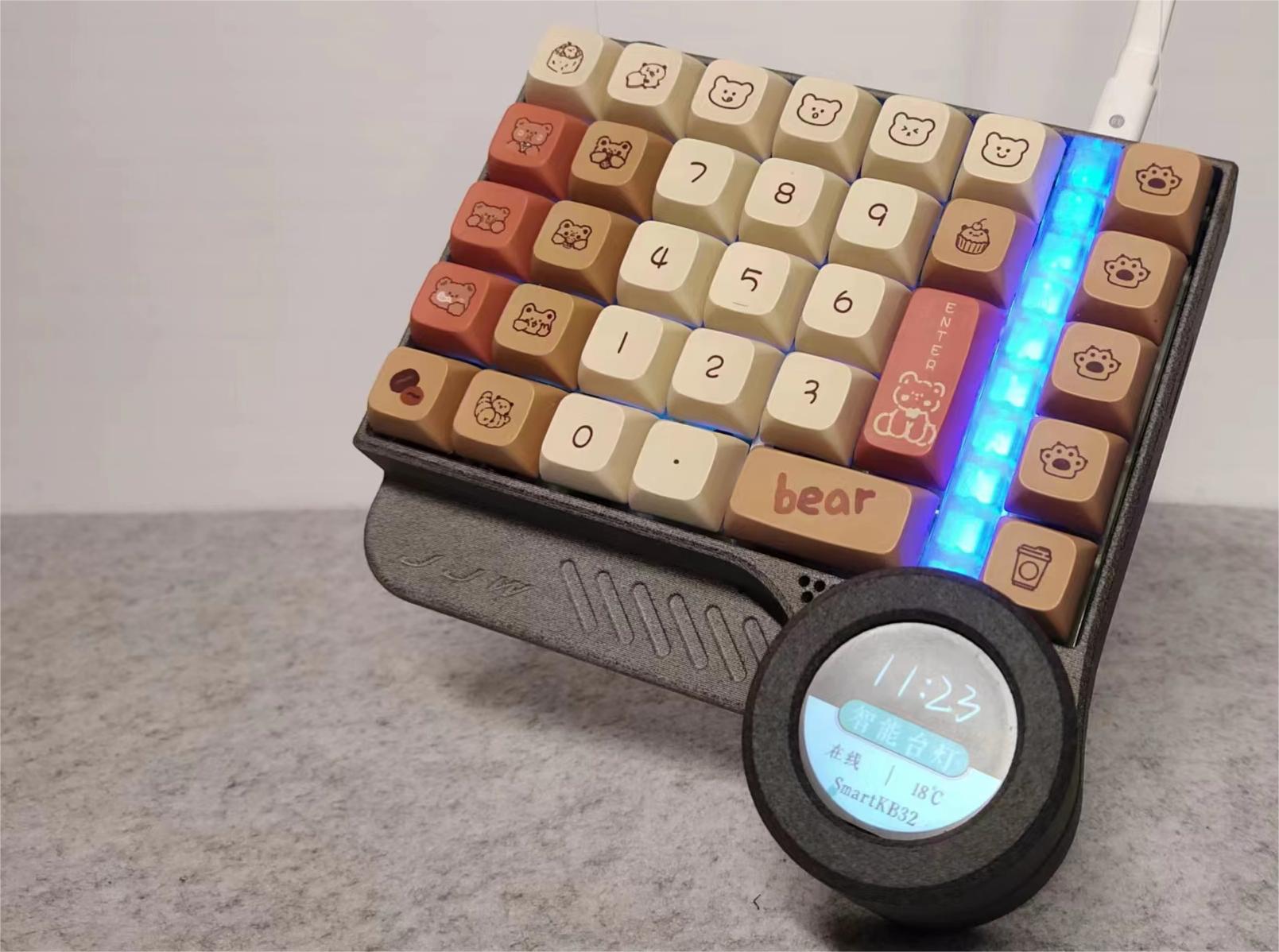

Utilizing an SD card to store key mapping tables, theoretically, hundreds of APP mapping tables can be pre-stored. The keyboard has a dedicated mapping table switching button, allowing quick switching to the desired mapping table.
SD card storage of server data enables operations such as adding, modifying, and deleting mapping tables via a computer connected to the ESP32S3 via Wi-Fi.

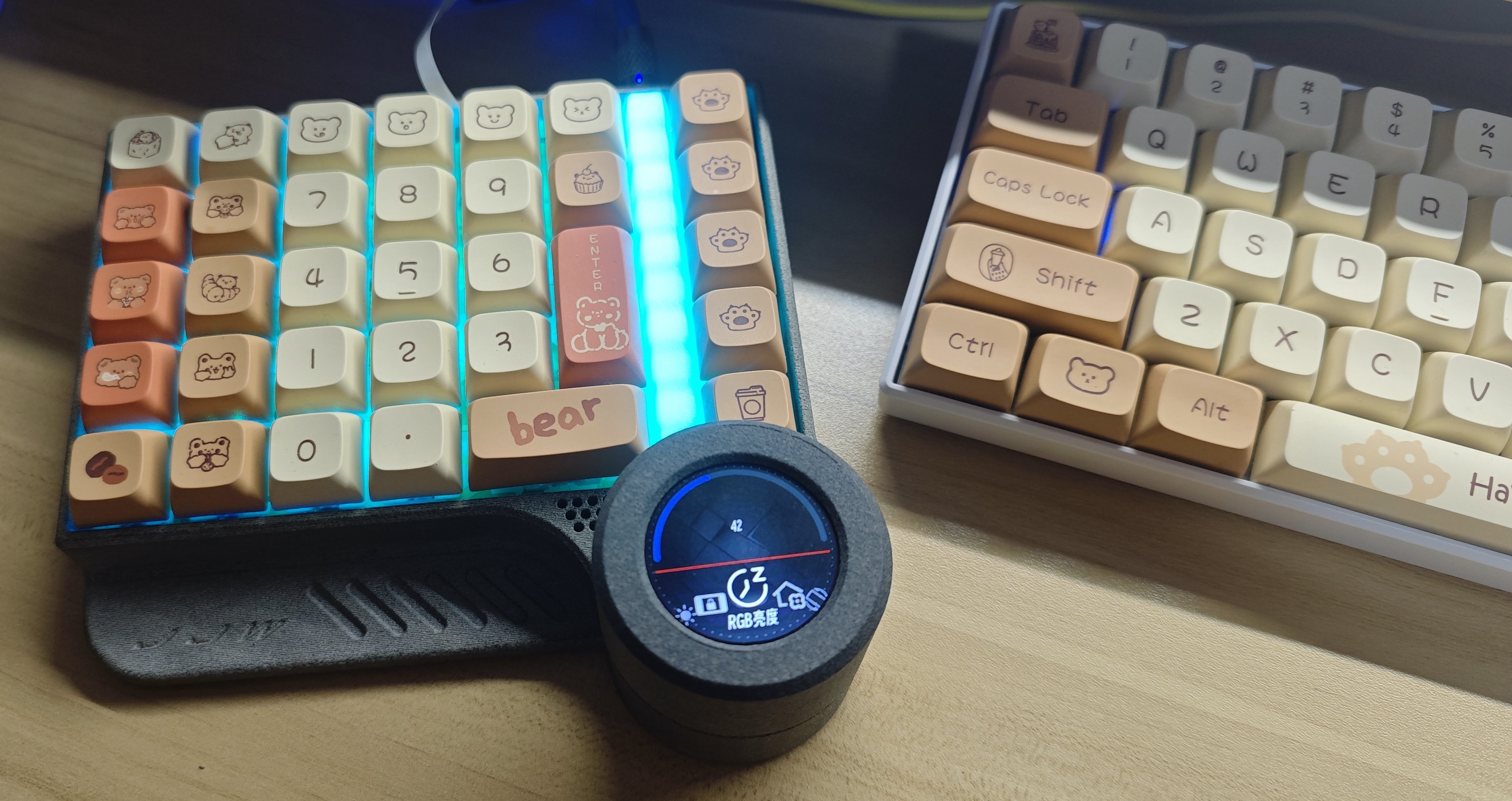

The left column of keys on the keyboard, when long-pressed, has the same output control as a normal full layout; clicking a key switches the mapping table (e.g., the lower left key, when long-pressed, outputs Ctrl; clicking the key switches the mapping table).
Project description:
Control of smart home devices: The color temperature and brightness of the smart desk lamp can be controlled via the buttons in the smart desk lamp control area; fine-tuning of color temperature and brightness can be achieved using the knob. Desktop power can be controlled via buttons in the desktop power control area, supporting multiple triggering methods to achieve different functions.

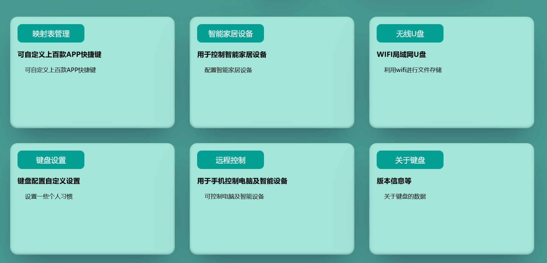

I. The function description of each button in the function area can be viewed on the server's welcome page.
II. Clicking the corresponding button will jump to the corresponding function.

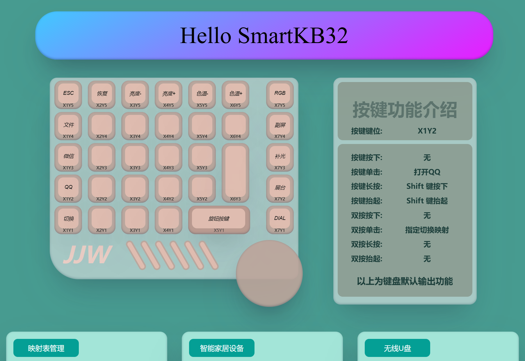

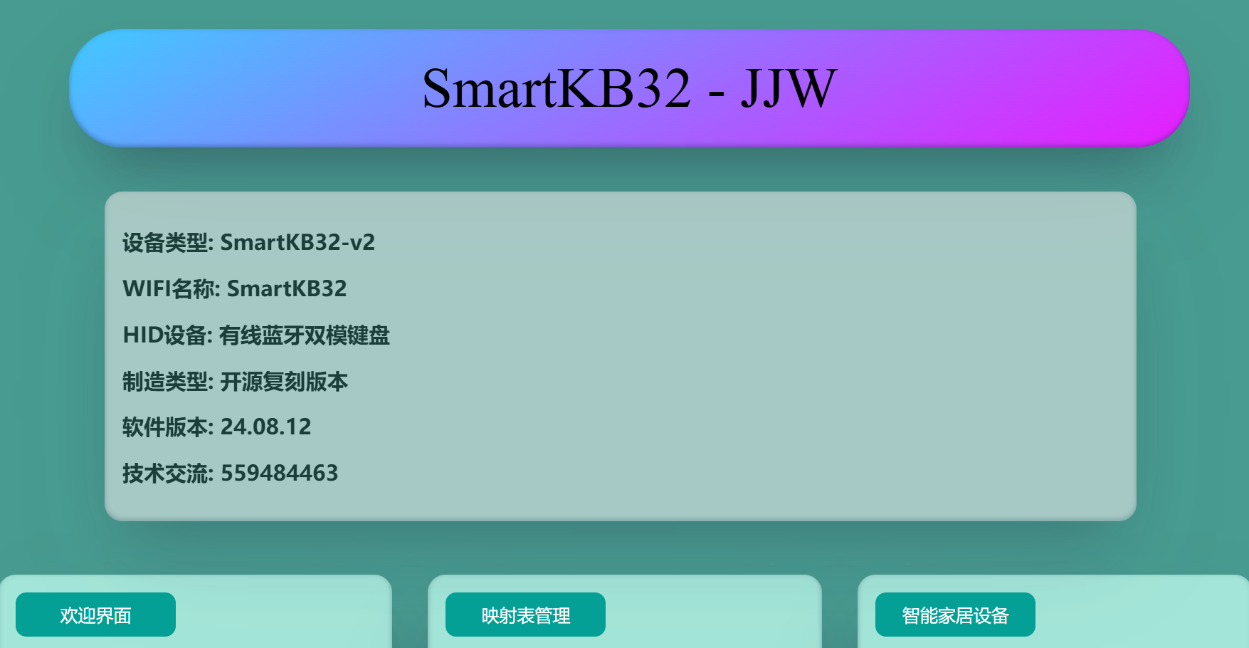

Web page mapping table generator
Mapping table generator 3.0: After three iterations, the mapping table generator has been successfully integrated into the built-in web server. Computers or mobile phones connected to the ESP32S3 hotspot or connected to the same network as the keyboard can access the built-in server by opening a browser and entering 192.168.4.1 to make modifications, or by accessing the server through the IP address displayed on the knob.

I. Built-in device information for version control, etc.

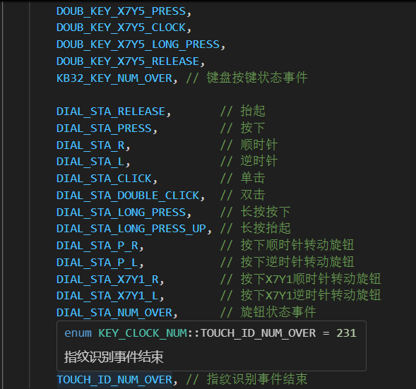

II. Over 230 preset key trigger events for different controls.

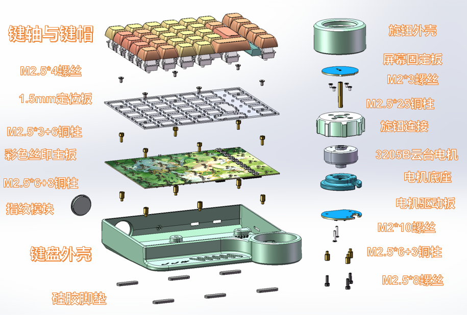

Hardware Description :
I. Exploded view of assembly structure .
Design Principles
: Main Control Section: Communicates with the computer via Bluetooth to achieve Bluetooth keyboard functionality.
Communicates with self-made devices via ESPnow.
Utilizes MPU6050 for closed-loop control of the fork knob.
Utilizes WM8978 for sound effects.
Secondary Control Section: Enables remote control via Wi-Fi and LED technology, as well as linkage control with Mi Home devices and support for Xiao Ai speaker voice control.
Utilizes 74HC165 chip for sampling the state of each key.
Utilizes 74HC595 chip for controlling status indicator lights.
Utilizes DS1302 chip for accurate timing function
. Utilizes Max4466 for sound sampling.
Replica Notes:
The accessories include two types of knobs: one for the 2804 motor version and one for the 3205B motor version. Choose one.
The keyboard PCB thickness is 1.6mm.
The screen and motor driver PCB thickness is 1.0mm (the 3205B gimbal motor without limiters has a 1.6mm thickness).
The keyboard positioning plate thickness is 1.5mm.
The motor is fixed in the middle using M2.527mm copper pillars (the 3205B gimbal motor without limiters uses M2.52mm copper pillars).
The radial magnets for the 2804 or 3205B gimbal motor without limiters are
: outer diameter 10mm, inner diameter 6.3mm, thickness 2mm (not required for the 3205B gimbal motor without limiters).
