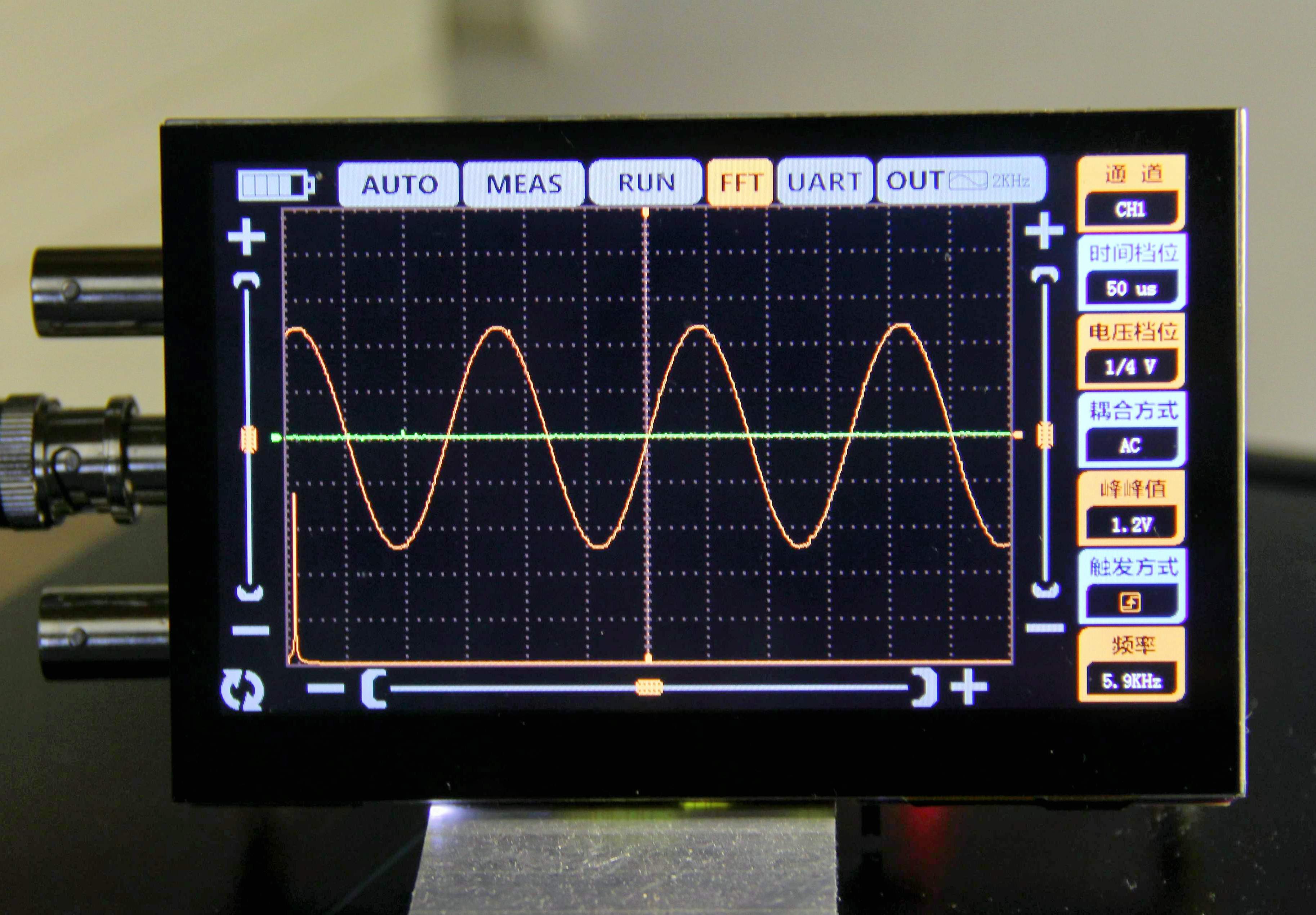

This project is a portable multi-functional instrument designed based on the Liangshanpai development board and the matching 4.3-inch RGB touch screen priced at 98 yuan. It has functions such as dual-channel oscilloscope, signal generator, and serial port data viewer. The 148 yuan version will also be open source after the subsequent program is adapted.
The specific usage video has been released on Bilibili. Welcome to watch: [Click to jump to Bilibili physical demonstration video!]

(1) Oscilloscope
① Supports dual-channel maximum ±10V peak-to-peak signal input, sampling rate of 2MSPS, and the measured waveform can be displayed stably.
② Supports one-key Auto function, which automatically adjusts the waveform to the appropriate display conditions.
③ It has a trigger function, which can realize the adjustment of waveform vertical offset, horizontal offset, trigger threshold, etc.
(2) Signal generator
① Supports the output of five waveforms: sine wave, square wave, triangle wave, positive sawtooth wave, and anti-sawtooth wave.
② The output frequency supports continuous adjustment in 1KHZ-50KHZ.
③ The output peak-to-peak value supports continuous adjustment in 0.1V-2.5V.
