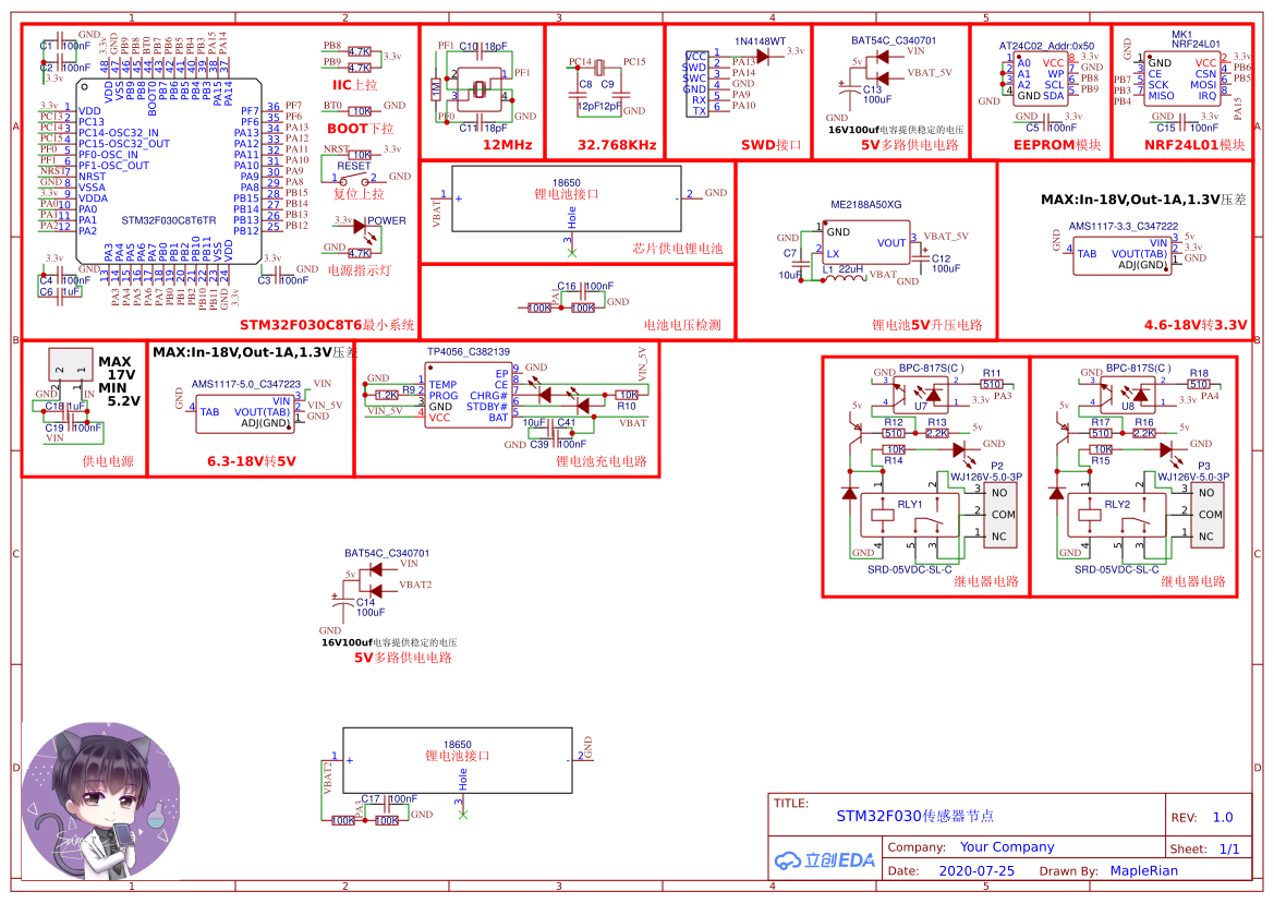

STM32 series core board and universal expansion board
  • Current main projects
  • Sensor sample has been applied for and is waiting for testing
  • The first purpose of this board is to read ambient temperature/open solenoid water valves and 220VAC equipment control
  • The board is powered by batteries, so it needs to run with low power consumption. The STM32F series is not a low-power series, so it can only use standby mode to save power as much as possible.
  • By the way, let me complain: The STM32L series (that is, the low-power series) is too expensive. I hope that domestic MCUs can provide configuration software similar to STM8/32CubeMX for generating BSP like STM.
  • Using version management, sensors, actuators, and gateways have corresponding versions.
  • Sensor/actuator controlled by STM32F030C8 chip and gateway application board controlled by STM32F401CCU6/STM32F411CEU6 chip
  • Available/simultaneous use of nRF24L01+ and SX1278 modules to transmit data
  • The sensor is a temperature sensor node by default. For other types, please use the 4P module to expand
  • Optional EEPROM for data/instructions storage
  • Optional charging function
参考设计图片
