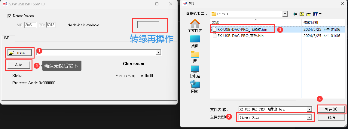

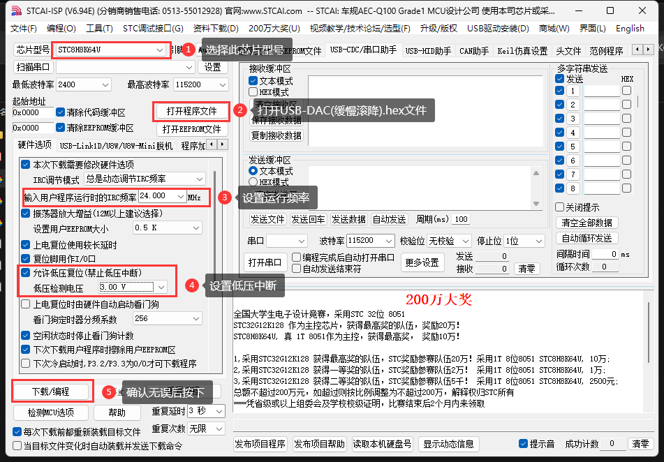

is a small USB headphone amplifier based on the CT7601 and STC8H8K64U. It features
a complete ±15V power supply in a small size, high output power (1000mW) and high swing (Vpp~30V) , analog volume control with perfect precision loss, 254 levels of ultra-fine granularity achieving near-stepless adjustment, excellent channel balance (<0.1dB) , integrated UAC2.0 and UAD protocols for use on all platforms, a complete Hi-Fi signal chain including a preamplifier circuit with a maximum preamplifier of +32dB, and uses a general-purpose SOP8 op-amp package for easy setup by audiophiles. It includes single-ended balanced dual outputs and an independent power supply interface that automatically shuts off the main power supply upon connection. The design block diagram and data block diagram are shown below. The diagram shows: U0[USB1] -->|DATA| BRIDGE (CT7601SR) U1[USB2] -->|DATA| MCU BRIDGE -->|I2S| ES9028 (ES9028Q2M). EC11[EC11] -->|GPIO| MCU MCU(STC8H8K64U) -->|I2C| ES9028(ES9028Q2M) MCU -->|SPI| PGA2310_L ES9028 -->|DACL| OPA_L(OPA) ES9028 -->|DACR| OPA_R(OPA) ES9028 -->|DACLB| OPA_L(OPA) ES9028 -->|DACRB| OPA_R(OPA) OPA_L -->|DC_BLOCK+LPF| PGA2310_L(PGA2310) OPA_R -->|DC_BLOCK+LPF| PGA2310_R(PGA2310) OPA_L -->|DC_BLOCK+LPF| PGA2310_L(PGA2310) OPA_R -->|DC_BLOCK+LPF| PGA2310_R(PGA2310) PGA2310_L -->|VOL_L| TPA6120_L(TPA6120) PGA2310_L -->|VOL_L| TPA6120_L(TPA6120) PGA2310_R -->|VOL_R| TPA6120_R(TPA6120) PGA2310_R -->|VOL_R| TPA6120_R(TPA6120) MCU -->|SPI| PGA2310_R TPA6120_L -->|OUT_HOT| 4.4mm(4.4mm) TPA6120_L -->|OUT_COLD| 4.4mm(4.4mm) TPA6120_R -->|OUT_HOT| 4.4mm(4.4mm) TPA6120_R -->|OUT_COLD| 4.4mm(4.4mm) TPA6120_L -->|OUT_HOT| 3.5mm(3.5mm) TPA6120_R -->|OUT_HOT| 3.5mm(3.5mm) Power supply block diagram graph LR U1[USB2] -->|5V| LDO1(3.3V LDO) U1[USB2] -->|5V| LDO2(1.2V LDO) U1[USB2] -->|5V| LDO3(3.3V LDO) U1[USB2] -->|5V| LDO5(3.3V LDO) U1[USB2] -->|5V| LDO4(1.5V LDO) LDO1 -->|3.3V VCC| BRIDGE(CT7601SR) LDO2 -->|1.2V VDD| BRIDGE(CT7601SR) LDO3 -->|3.3V VCC| ES9028 LDO5 -->|3.3V VCCA| ES9028 LDO4 -->|1.5V VDD| ES9028 U1 -->|5V| PGA2310_L(PGA2310_L) U1 -->|5V| PGA2310_R(PGA2310_R) U1 -->|5V| MCU(STC8H8K64U) U1 -->|5V| TPS65131(TPS65131) TPS65131 --> LDO_P(±LDO) LDO_P -->|±15V| PGA2310_L LDO_P -->|±15V| PGA2310_R LDO_P -->|±15V| P_OPA LDO_P -->|±15V| OPA_L LDO_P -->|±15V| OPA_R LDO_P -->|±15V| TPA6120_L(TPA6120_L) LDO_P -->|±15V| TPA6120_R(TPA6120_R) P_OPA(VCCAL/R OPA) -->|3.3V VCCAL/R| ES9028(ES9028Q2M) DIY Guide Most components in this project use small packages such as 0603/QFN, which presents a certain degree of soldering difficulty. Please prepare appropriate tools and materials : A suitable soldering iron (T12 recommended; don't use those cheap ones, you'll regret it), a heating table, You can buy one of those LED desoldering stations that cost around ten yuan on Taobao (not essential). Other materials include a multimeter, tweezers , a bench drill/hand drill , a file, lead-based medium-temperature solder paste (for soldering surface mount components, not essential) , solder wire, flux/soldering compound/rosin (to aid in soldering).
