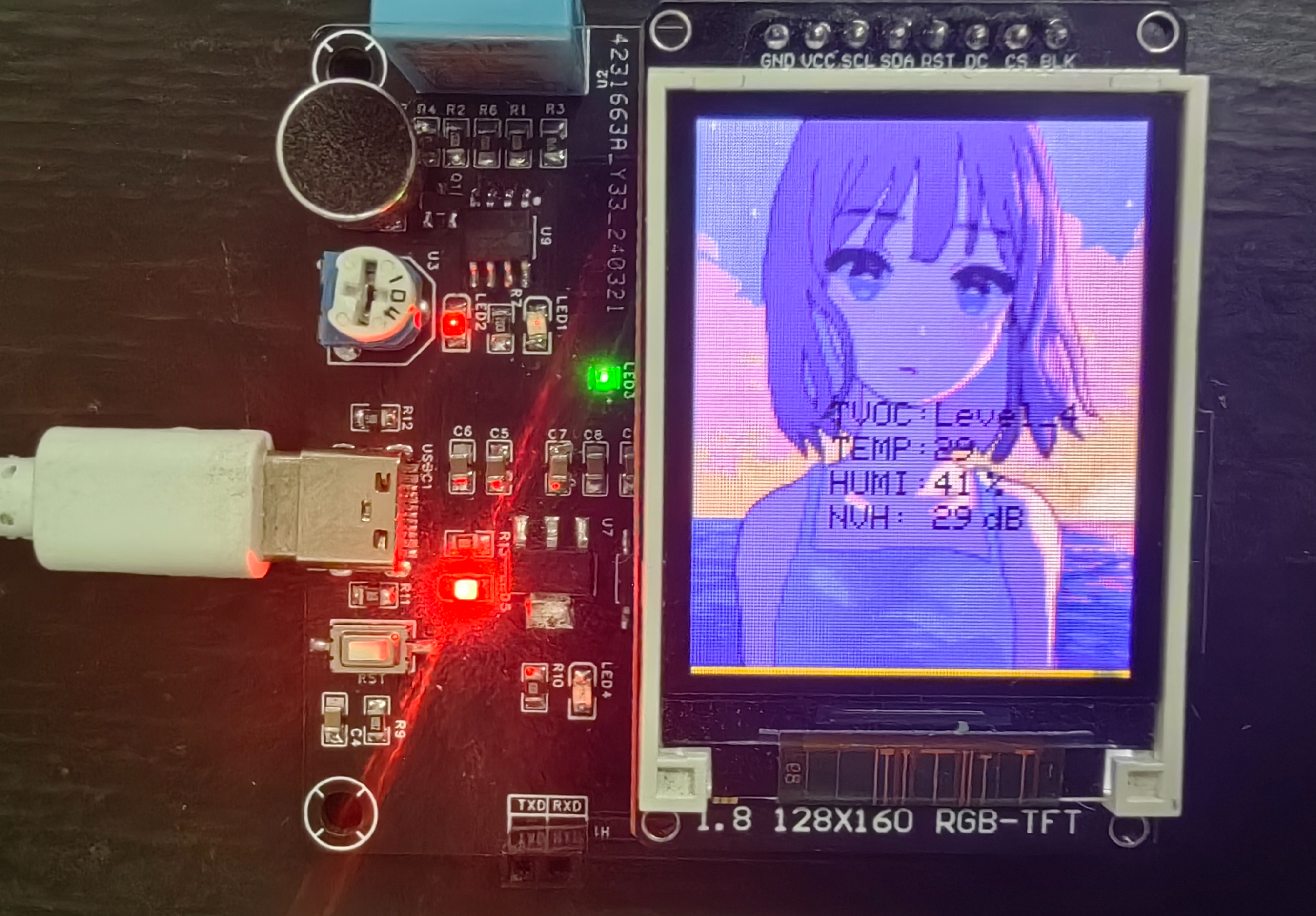

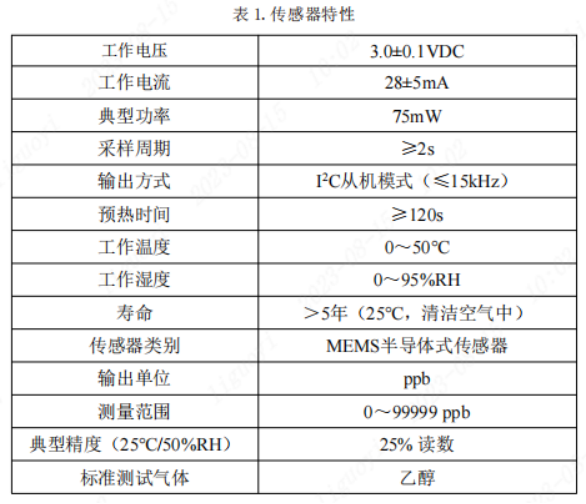

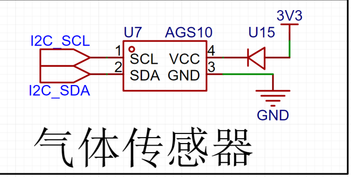

This case uses the AGS10 TVOC sensor, a MEMS TVOC sensor with digital signal output. It is equipped with dedicated digital module acquisition technology and gas sensing technology, ensuring extremely high reliability and excellent long-term stability, while also featuring low power consumption, high sensitivity, fast response, low cost, and simple drive circuitry.
The AGS10 is primarily used for detecting various volatile organic compounds (VOCs), such as ethanol, ammonia, sulfides, benzene vapors, and other harmful gases. It can be applied in air purifiers, home appliances, and fresh air systems. The sensor

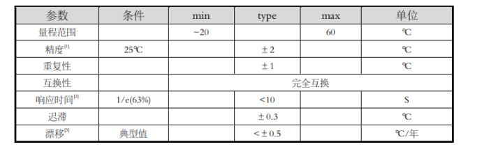

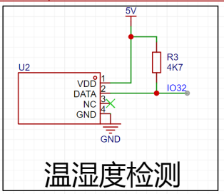

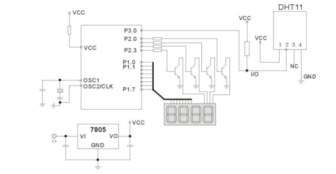

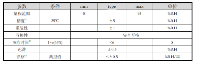

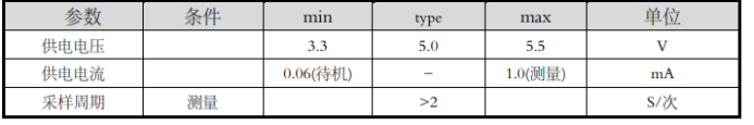

                                                                                                                          uses the standard IIC communication protocol, making it compatible with various devices. The IIC physical interface includes two interfaces: a serial data signal (SDA) and a serial clock signal (SCL). During design, both interfaces need to be pulled up to VDD through resistors ranging from 1kΩ to 10kΩ. The sensor operates at 3V, while our voltage range is only 5V and 3.3V. A Schottky diode can be connected in series at the sensor's VCC pin. The voltage drop of a typical diode is between 0.6V and 1.7V, while that of a Schottky diode is typically between 0.15V and 0.45V. 3.2 Harmful Gas Sensor Design: The DHT11 digital temperature and humidity sensor is a composite temperature and humidity sensor with a calibrated digital signal output. It utilizes dedicated digital module acquisition technology and temperature and humidity sensing technology to ensure high reliability and excellent long-term stability. The sensor includes a capacitive humidity sensing element and an NTC temperature sensing element. Applications include HVAC, dehumidifiers, agriculture, cold chain storage, testing and inspection equipment, consumer goods, automobiles, automatic control, data loggers, weather stations, home appliances, humidity regulators, medical devices, and other related humidity detection and control. Advantages include low cost, long-term stability, relative humidity and temperature measurement, excellent quality, ultra-fast response, strong anti-interference capability, ultra-long signal transmission distance, digital signal output, and precise calibration. Pin descriptions: VDD: 3.3~5.5V DC power supply ; DATA: Serial data, single bus ; NC: Unused pin; GND: Ground, negative power supply. Product parameters: 1. Relative humidity ; 2. Temperature; 3. Electrical characteristics . Typical circuit: Serial communication description (single-wire bidirectional)  . Single bus description: The DHT11 device uses simplified single-bus communication. A single bus means there is only one data line; data exchange and control in the system are all completed by the single bus. Devices (master or slave) are connected to the data line via an open-drain or tri-state port, allowing the device to release the bus when not transmitting data, thus enabling other devices to use the bus. A single bus typically requires an external pull-up resistor of approximately 4.7kΩ, so that the bus is in a high-level state when idle. Because they are master-slave junctions, the slave can only respond when the master calls it. Therefore, master access to devices must strictly adhere to the single-bus sequence; if the sequence is disordered, the device will not respond to the master. Application circuit diagram 3.3 Noise sensor introduction: Using a microphone to detect sound and thus noise. Advantages: An electret microphone is a sound-to-electrical conversion device that converts sound signals into electrical signals. Its characteristics include small size, light weight, simple structure, wide frequency response, high sensitivity, vibration resistance, and low price, making it widely used in electronic devices such as recorders, wireless microphones, and voice-activated switches. Product parameters and application circuit design: The output voltage of a microphone typically ranges from a few millivolts to several hundred millivolts, depending on factors such as the sound pressure level of the sound source, the pickup distance, and the microphone's sensitivity. Generally, the microphone's output voltage is 5–10 mV. While a single-chip microcomputer may not be able to detect it initially, with the addition of a suitable amplification circuit, it can be detected by the microcontroller. This enables the implementation of a simple noise sensor.
(Performance is relatively poor, but cost-effective)

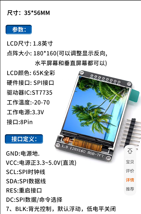

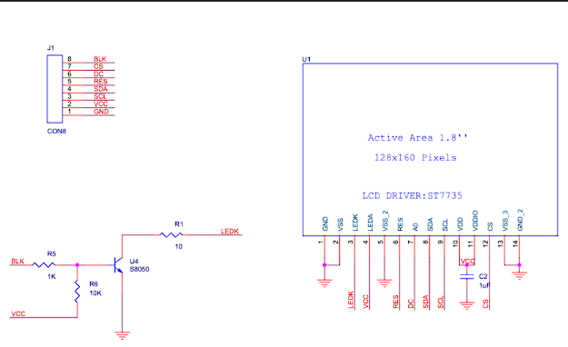

3.4 TFT Display Introduction,
Physical Object and Parameters,
Schematic Diagram,
Physical Display ,

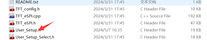

Notes:
This TFT screen is driven by ST7785, so to display correctly, you need to modify the User_Setup.h file in the Arduino IDE library functions.
For specific procedures, please refer to the video by Teacher Eva on Bilibili: https://b23.tv/ueGo1L7 (Other videos are also very helpful!!!).
