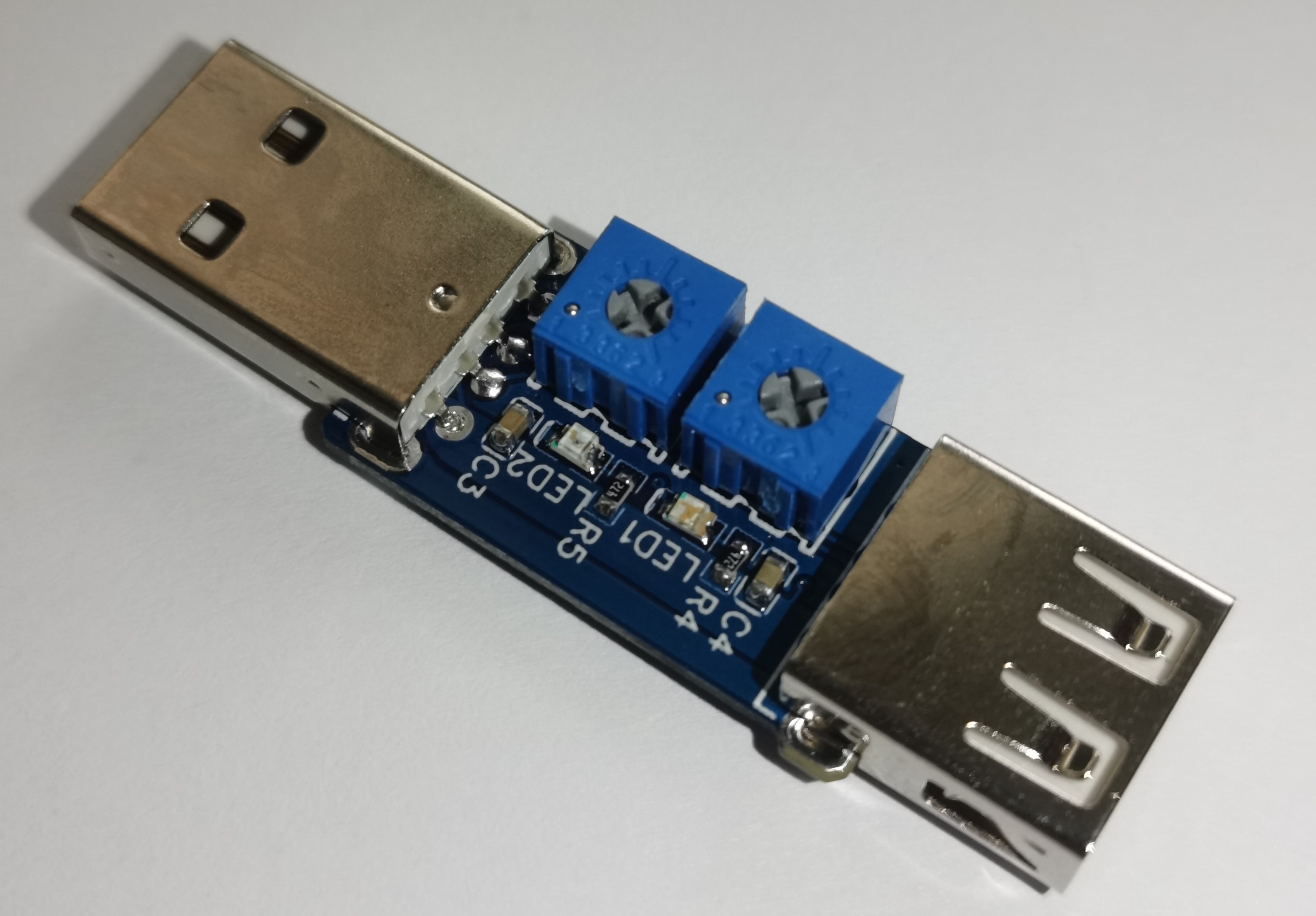

[Power bank low current anti-power-off plug-in]
555 classic circuit + pnp transistor drives 36 ohm dummy load.
When the load of the 2512 package is 1W, the working voltage of the fast-charging power bank should not be higher than 5V. If the conduction time is short, it should not get hot.
