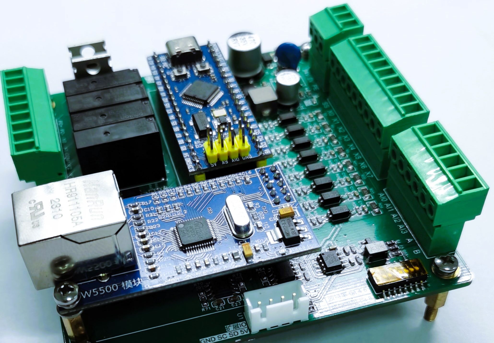

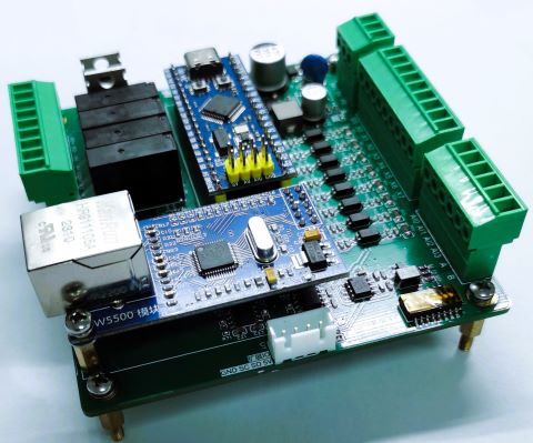

A Modbus remote I/O board based on the STM32F103C8T6 microcontroller, suitable for host computer communication, remote control, and other scenarios.
Main control chip: STM32F103C8T6 microcontroller
; Power supply: DC24V;
Inputs: 8-channel isolated digital inputs; Outputs
: 6-channel isolated digital outputs
; Analog inputs: 4-channel 16-bit analog inputs;
Communication interfaces: RS485, Ethernet, TTL serial port, IIC
communication; Parameter settings: Station number, baud rate, and 120-ohm terminating resistor can be set via DIP switches;
Operating indicators: One ERR indicator and one RUN indicator;
Communication protocols: Modbus RTU, Modbus TCP;
Development environment: Visual Studio Code;
Development framework: PlatformIO + Arduino;
Software architecture: FreeRTOS + watchdog
timer; Open source program: HEX program file is included in the attachment; the program needs to be downloaded to the microcontroller;
Debugging software: Debugging tools are included in the attachment; need to be connected to the module via RS485 or network; External interfaces
use pluggable terminals for easy and quick wiring.

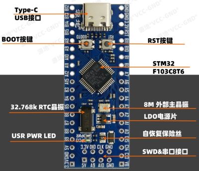

Main control chip: STM32F103C8T6 minimum development board.
Using the YD-STM32F103C8T6 microcontroller with a Type-C interface, the build quality and performance are excellent, and I personally feel it offers great value for money.

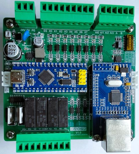

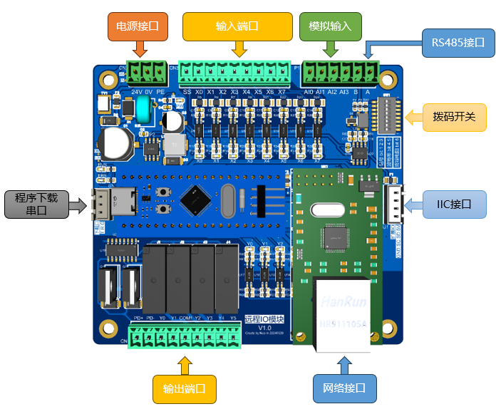

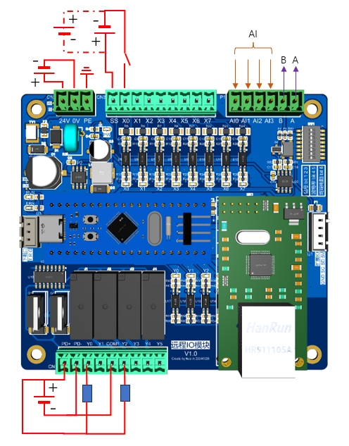

Let's look at the module's
power supply: designed for DC 24V, but tested to work normally from 9-24V.
24V is positive, 0V is negative, and PE is ground.
Inputs: 8 isolated digital inputs.
Bidirectional optocouplers are used for isolation.
SS is the common terminal, X0-X7 are input ports, compatible with NPN/PNP inputs.
Designed to operate at DC 24V, but tested to work normally from 9-26V.
The inputs include a filtering algorithm with a default 5ms response time.
Analog inputs: Uses the ADS1115 chip.
IIC is used to read data from the ADS1115 analog chip.
A voltage follower is used to increase input impedance.
4 inputs, 16-bit ADC accuracy.
Input voltage range 0-5V.
Outputs: 6 isolated digital outputs
, isolated by optocouplers.
PD+ and PD- are the output power supplies; due to the use of a 24V relay, a DC 24V power supply is required.
2 NPN outputs, connected to PD- during output.
4 relay outputs, COM is the common terminal, shared by Y2/Y3/Y4/Y5. Although the maximum current per relay is 3A, the total COM current should not exceed 3A.

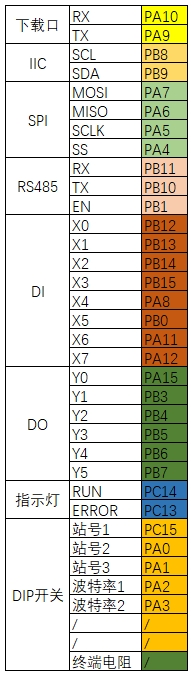

Communication interfaces: RS485, Ethernet, TTL serial port, IIC.
RS485 x1: Supports Modbus RTU protocol.
TTL serial port x1: Used for downloading programs or printing information.
IIC interface x1: For future expansion.

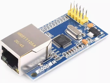

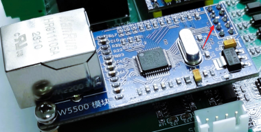

Ethernet x1: Supports Modbus TCP protocol. Ethernet communication is implemented through the W5500 module. Note the module pin orientation adjustment (this module is not needed if only Modbus RTU is required).
Note: The module pin orientation needs to be changed to downwards.

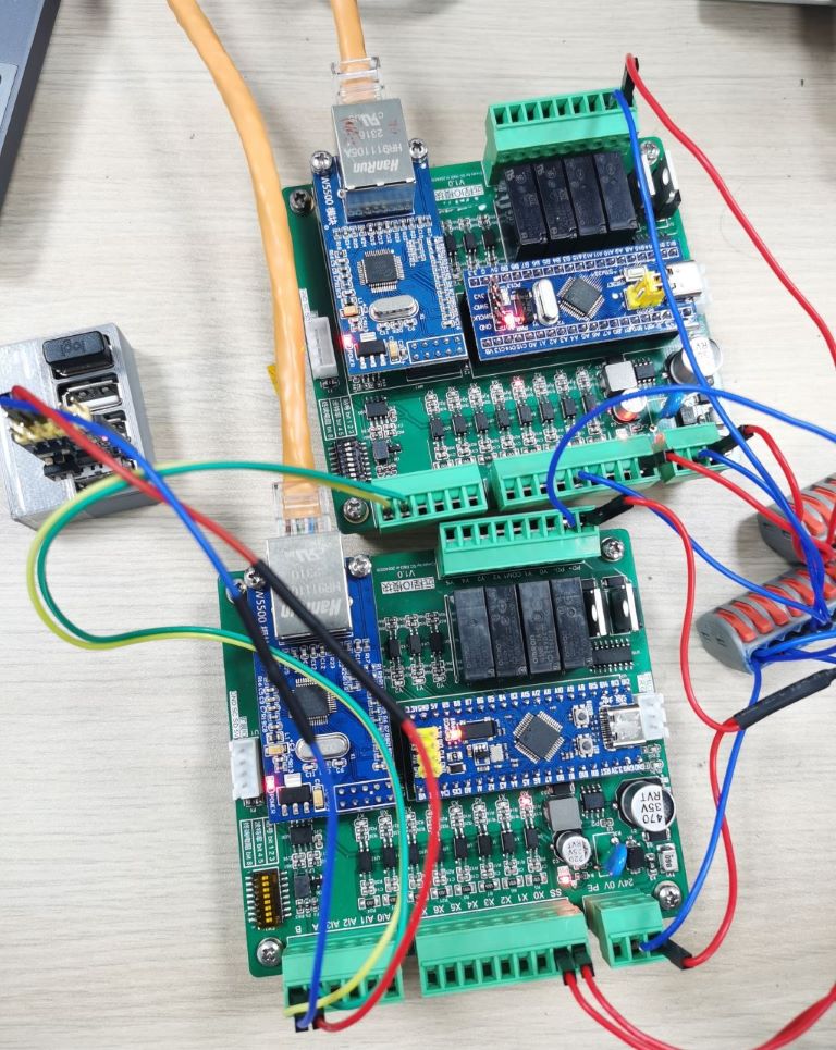

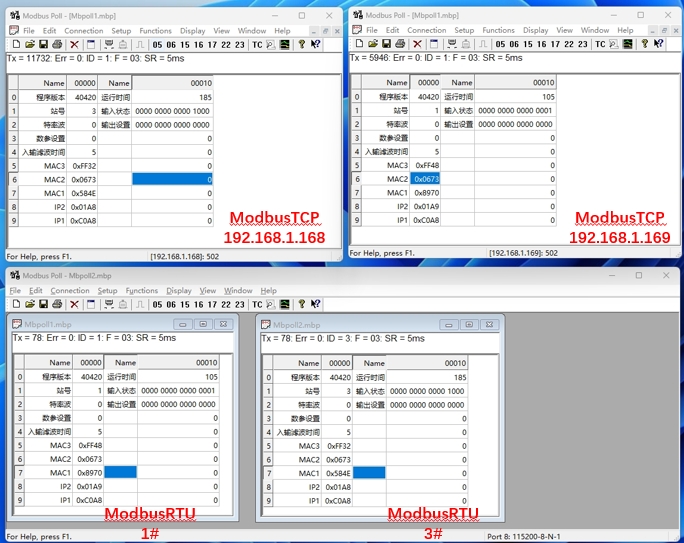

The wiring
test section

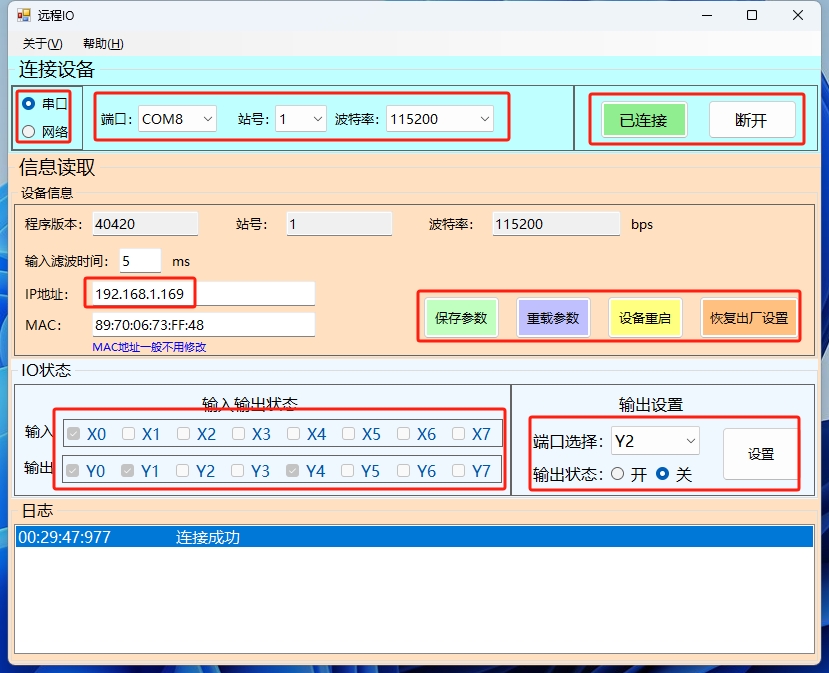

uses ModbusPoll software
. Test software: Modbus software I used.
Link: https://pan.baidu.com/s/1gVSAOsch675w53tLc9f6kw?pwd=um7m Extraction code: um7m Copy this content and open the Baidu Cloud mobile app for easier operation.
Hardware wiring: Connect the IO board power supply; you can connect the output or input side power supply as needed.
Software: Used ModbusRTU and ModbusTCP to connect to the IO board simultaneously .
For example, you need to set the IP address to 192.168.10.5.
Connecting the IO board: Connect to the IO board via ModbusRTU or ModbusTCP.
IP address to hexadecimal conversion: You can use a computer calculator to calculate the hexadecimal value, which is C0.A8.0A,05.
Set IP: Set address 9 to 0xC0A8 and address 8 to 0x0A05.
Save parameters: Set address 3 to 10.
Restart: Set address 3 to 30.
Configuration complete, the IP address of the IO board has been modified. The debugging tool
software is included in the attachment;
