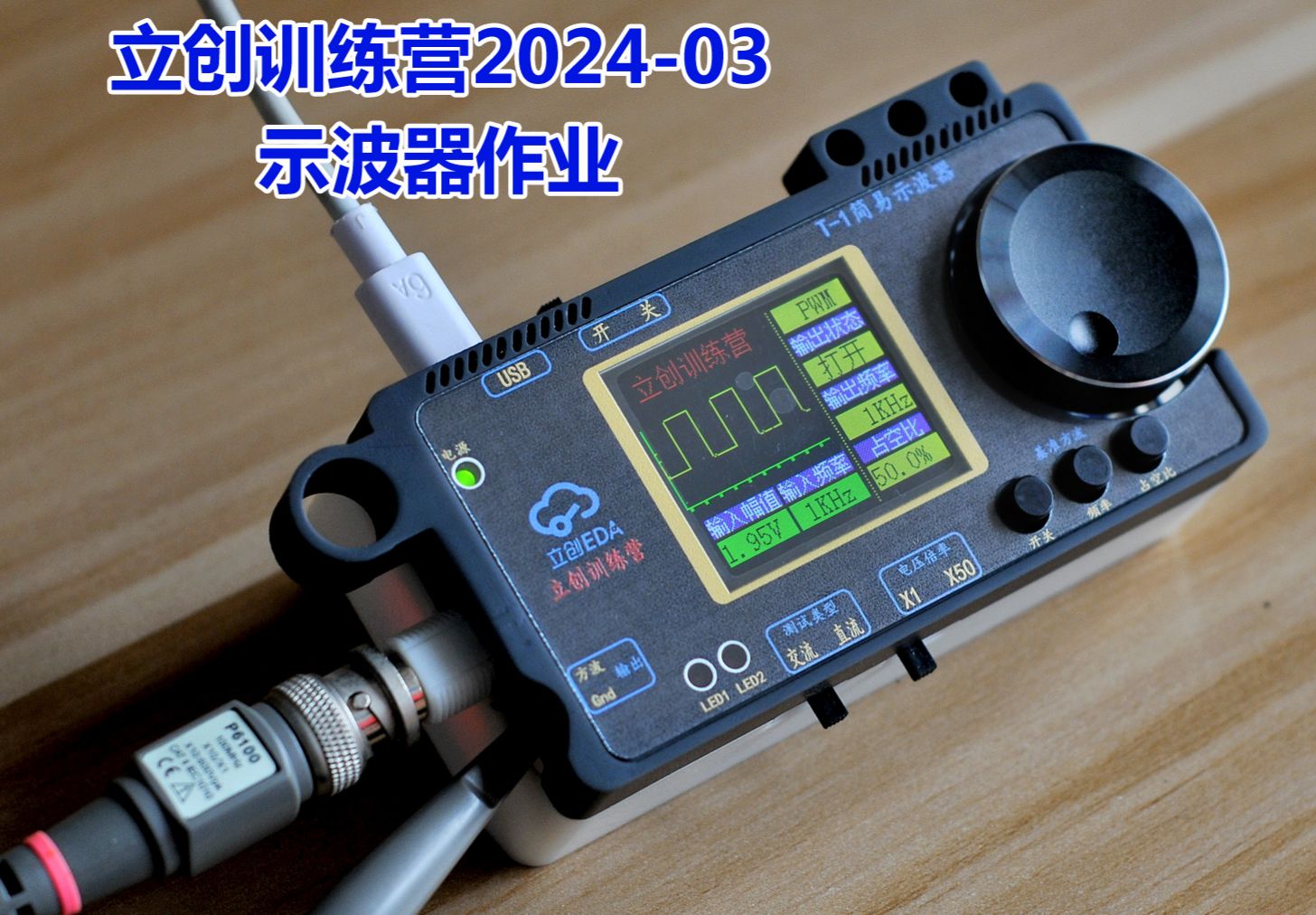

   , I participated in the LCSC training camp, learning the principles of a simple oscilloscope, PCB fabrication, GD32 microcontroller programming experiments, and how to design the casing for LCSC EDA. It was my first time using LCSC EDA to design casings and panels, and I was truly impressed by its power, ease of learning, and convenience. Crucially, LCSC has promised to provide LCSC EDA permanently free of charge; LCSC's contributions to the nation are immeasurable, and I deeply admire them.
   As an audiophile who frequently works on audio circuits, I already own an oscilloscope, but it's quite bulky. For a long time, I've wanted a mini oscilloscope—not requiring high precision or high frequency measurements, just something convenient for checking circuit waveforms. This training camp was perfect for me.

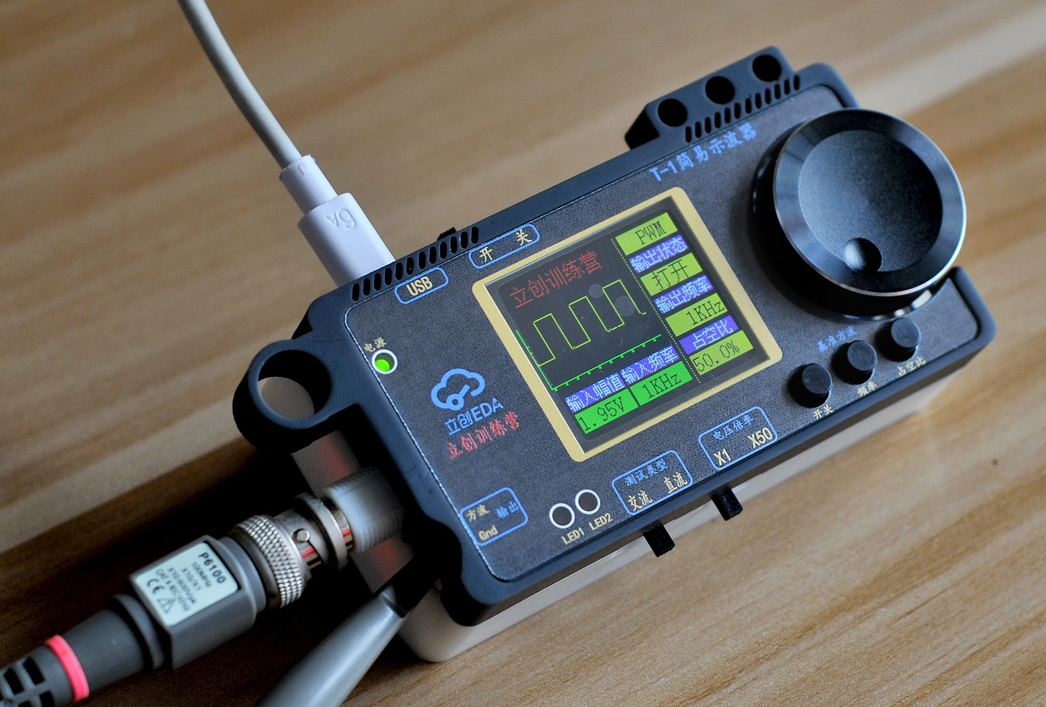

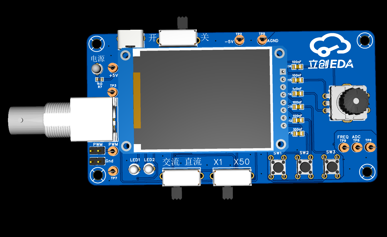

          After learning, I modified the layout, prioritizing practicality and ease of use: the left hand operates the probe (input is on the left), and the right hand operates all function keys and knobs (most function keys are located within right-hand reach), conforming to my usual usage habits.

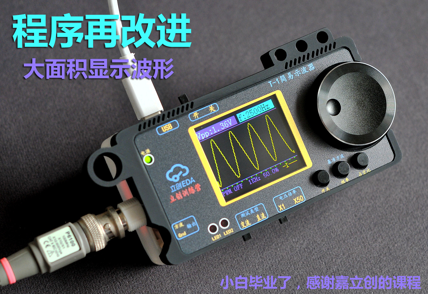

       On the software side, I'm a complete beginner with the GD32 microcontroller (I had never even heard of it before joining the training camp). I'm currently learning programming, referencing the default program from the training camp, replicating and improving it. The improved version is available for download in the attachment. (Links to the official tutorial videos and complete materials are below; I won't repeat the principles and circuits here.)

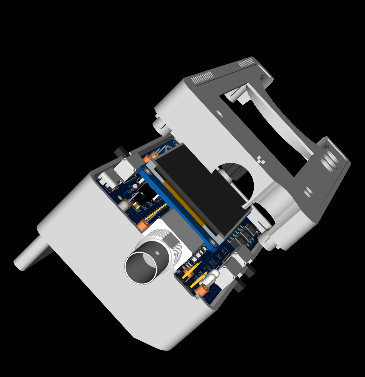

       Regarding the casing, I was surprised how convenient it was to design the casing using "LCSC EDA" (I've never learned any other 3D modeling software, always considering it a huge hurdle). Because this PCB design uses connectors for the microcontroller and display, the overall thickness is relatively high. This was my first time designing a casing, so the focus was on familiarizing myself with the software's functions and the order-making process. Next time, I'll design a second version with an integrated circuit board, where the casing can be made ultra-thin.
       The actual product is more refined and attractive than the pictures. I often play with it on my desk. Aside from its functionality, I use it as a stress-relieving toy (like a ZIP lighter)
