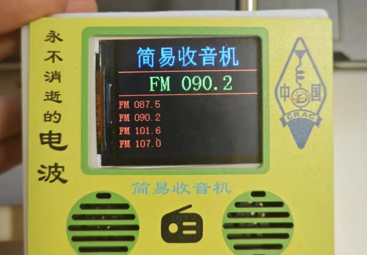

Project Introduction:
This is a simple FM radio. In the summers of my childhood, I loved listening to the radio in my grandfather's room. Tick-tock, tick-tock, it's 8 PM Beijing time, China National Radio, Voice of China, and then tick-tock, kids, the little loudspeaker is broadcasting.
Many years have passed, and I can't remember which sister was the host, but I cherish the memory of my grandfather and my childhood. This summer-themed activity involves making a simple radio to reminisce about my childhood. I am also an amateur radio enthusiast. Amateur radio plays a vital role in countless disaster relief efforts, and this project also pays tribute to the intelligence workers who sacrificed their lives during wartime, and to the ever-burning radio waves.
This project includes an ESP32 version, with the open-source link at https://oshwhub.com/laobainb/jian-yi-shou-yin-ji-esp32-ban.
The radio chip chosen is the DRA5807m, a new generation microcontroller-based FM stereo tuner with minimal external components. It uses I²C for communication with the microcontroller
. The audio amplifier chosen is the PAM8403, a stereo power amplifier that provides Class AB power amplifier performance with Class D amplifier effects. This requires very few external components, saving PCB space and reducing design costs.
The power management uses the IP5306, a multi-functional power management SOC integrating a boost converter, lithium battery charging management, and battery level indicator. It also requires few external components, using only one inductor to achieve buck and boost functions. The synchronous boost system provides a maximum output current of 2.4A with a conversion efficiency of up to 92%. Under no-load conditions, it automatically enters sleep mode, with the quiescent current dropping to 100uA.

power indicator LED. The RDA5807 supports I²C communication, which can be achieved using both software and hardware I²C. For code simplicity (I'm too lazy to write complex code to handle timing signals, data signals, error detection, signal conflicts, etc.), and since this is a radio, we will use hardware I²C. Referring to the chip datasheet, we will use PA0 and PA1. Define variables and crystal oscillator #ifndef __RDA5807_H // Positive and negative feedback #define ACK 0 #define NACK 1 // Boolean variable #define TRUE 1 #define FALSE 0 // Read/write flag #define READ 1 #define WRITE 0 #define ADRW 0x20 // RDA5807P write register address #define ADRR 0x21 // RDA5807P read register address /* * This radio uses the RDA5807M module, which uses a 32.168KHz crystal oscillator. If using other crystal oscillators, use different macro definitions according to the frequency */ //#define _SHARE_CRYSTAL_24MHz_ // 24MHz crystal oscillator //#define _SHARE_CRYSTAL_12MHz_ // 12MHz crystal oscillator #define _SHARE_CRYSTAL_32KHz_ // 32KHz crystal oscillator //#define _FM_STEP_50K_ //50K steps. Then, configure the I²C. Different manufacturers have different configuration methods, but the process is the same: enable the clock, configure the pin multiplexing and function of SCL and SDA, configure the IC address, and enable the response. This project is applicable to GD32, CW32, and STM32. Different main controllers have different function libraries and initialization methods, but the way to manage RDA5807 is the same. Setting the frequency void RDA5807_SetFreq(short int curFreq) { unsigned short int curChan ; curChan = RDA5807_FreqToChan(curFreq); //SetNoMute RDA5807_REGW[0] |= 1 << 7; RDA5807_REGW[2] = curChan >> 2; RDA5807_REGW[3] = (((curChan & 0x0003) << 6) | 0x10) | (RDA5807_REGW[3] & 0x0f); OperationRDAFM_2w(WRITE, &(RDA5807_REGW[0]), 4); delay_ms(50); } Read frequency unsigned short int RDA5807_RegToInt(void) { unsigned char RDA5807_REGR[10] = {0x0}; unsigned short int temp; OperationRDAFM_2w(READ, (unsigned char *)&RDA5807_REGR[0], 10); temp = RDA5807_REGR[0]; temp = ((temp << 8) | RDA5807_REGR[1]); temp = (temp & 0x03FF) * 10 + 8700; return temp; } Set mute void RDA5807_SetMute(int mute) { if(mute == TRUE){ RDA5807_REGW[0] &= ~(1<<6);//Enable bit 14 of register 02H to be 0, enable mute } else{ RDA5807_REGW[0] |= 1<<6; }
OperationRDAFM_2w(WRITE, &(RDA5807_REGW[0]), 2);
delay_ms(50); //Deadly 50 ms
In conclusion
, I want to say to everyone that it's over. I don't know what to say, but the sense of ritual in summarizing is still necessary. Let's pay tribute again to the never-ending radio waves. This is BG5AWB
