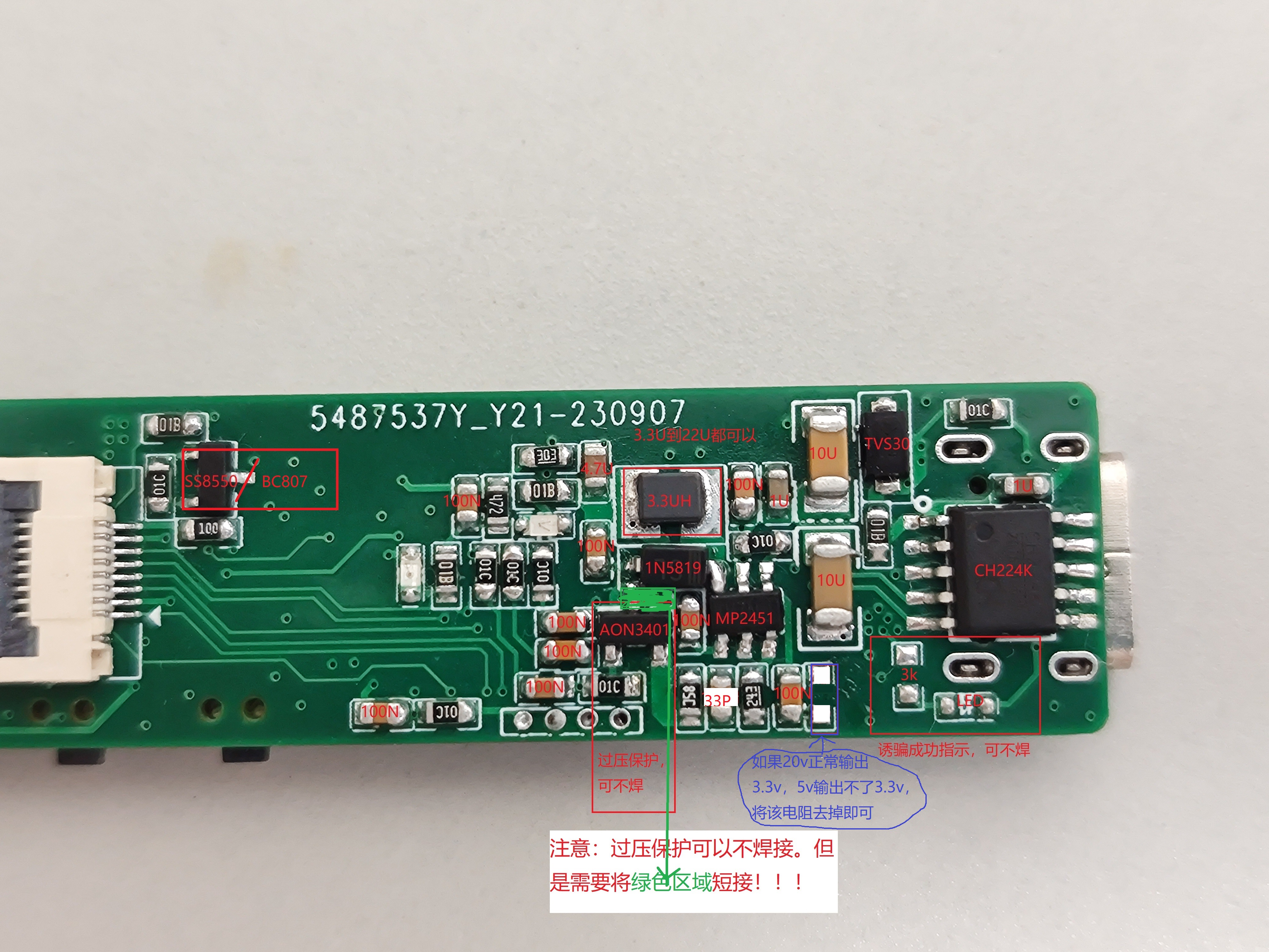

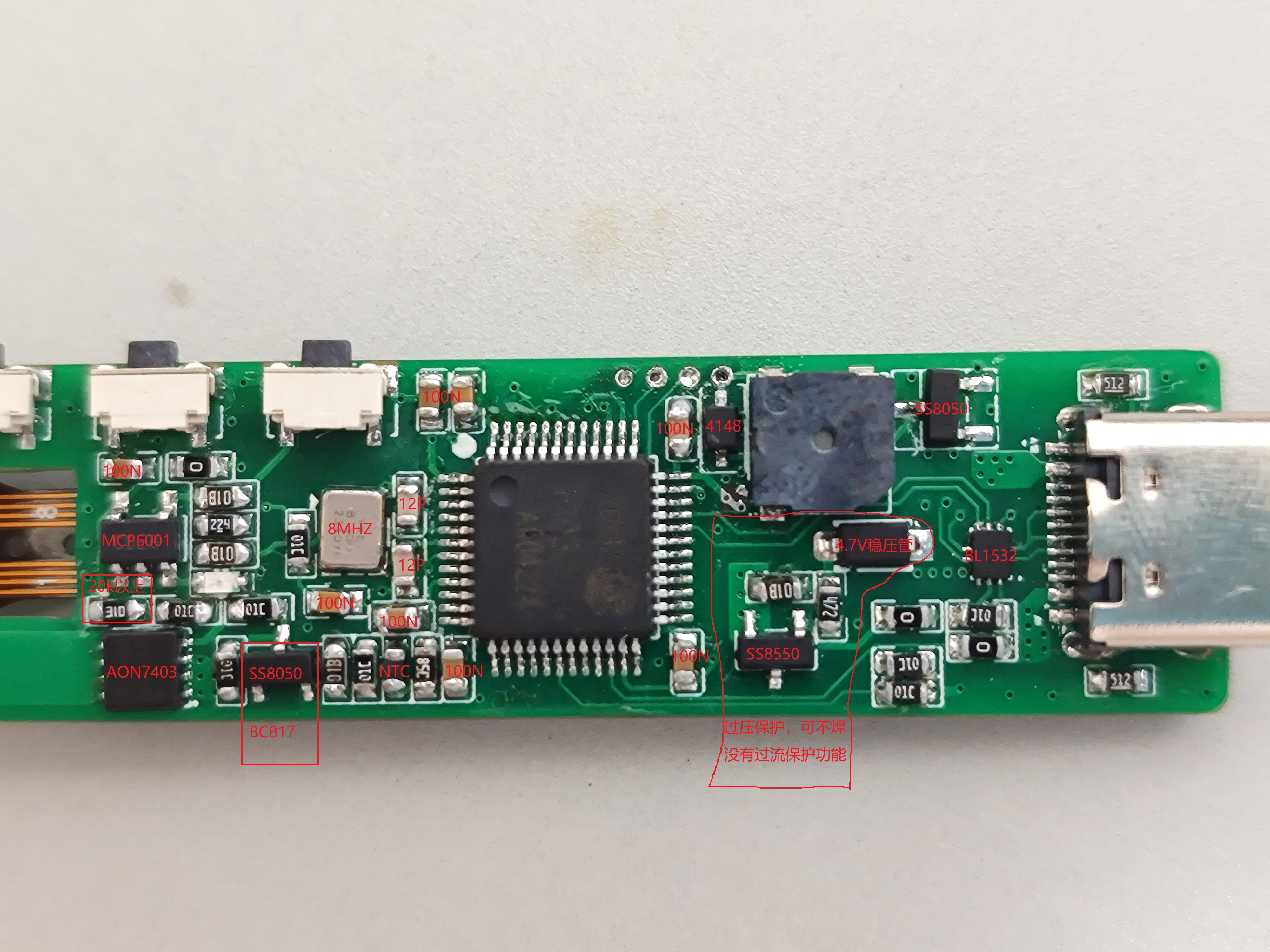

(Hardware): This is a portable color screen soldering iron designed using the AIR32F103CCT6 microcontroller. This version is a redesign by Blue Sky Unprotected, replacing the protocol chip with a CH224K voltage decoy chip, changing the key resistor and capacitor packages to 0603, and replacing the original BC817 and BC807 transistors with SS8050 and SS8550 (larger SOT23 packages). It supports PD and QC power input; supports power supply from standard 18W, 12V/1.5A and above power banks; uses a standard T12 soldering iron core for strong compatibility; and uses an SW200D vibration switch for sleep detection.

The resistance value of transistor R19 in the backlight section of the schematic diagram has been updated to 10K. The DC-DC power enable resistor soldering diagram has been updated.

Regarding the op-amp chip selection, the MCP6001 is currently used. OPA336/SGM8251/GS8331 or other similar rail-to-rail op-amps can be selected. Pay attention to the output pins, as temperature fluctuations may vary depending on the op-amp used.
Soldering diagrams:
CH224K side soldering diagram,
TYPE-C side soldering diagram. Firmware upgrade: The
