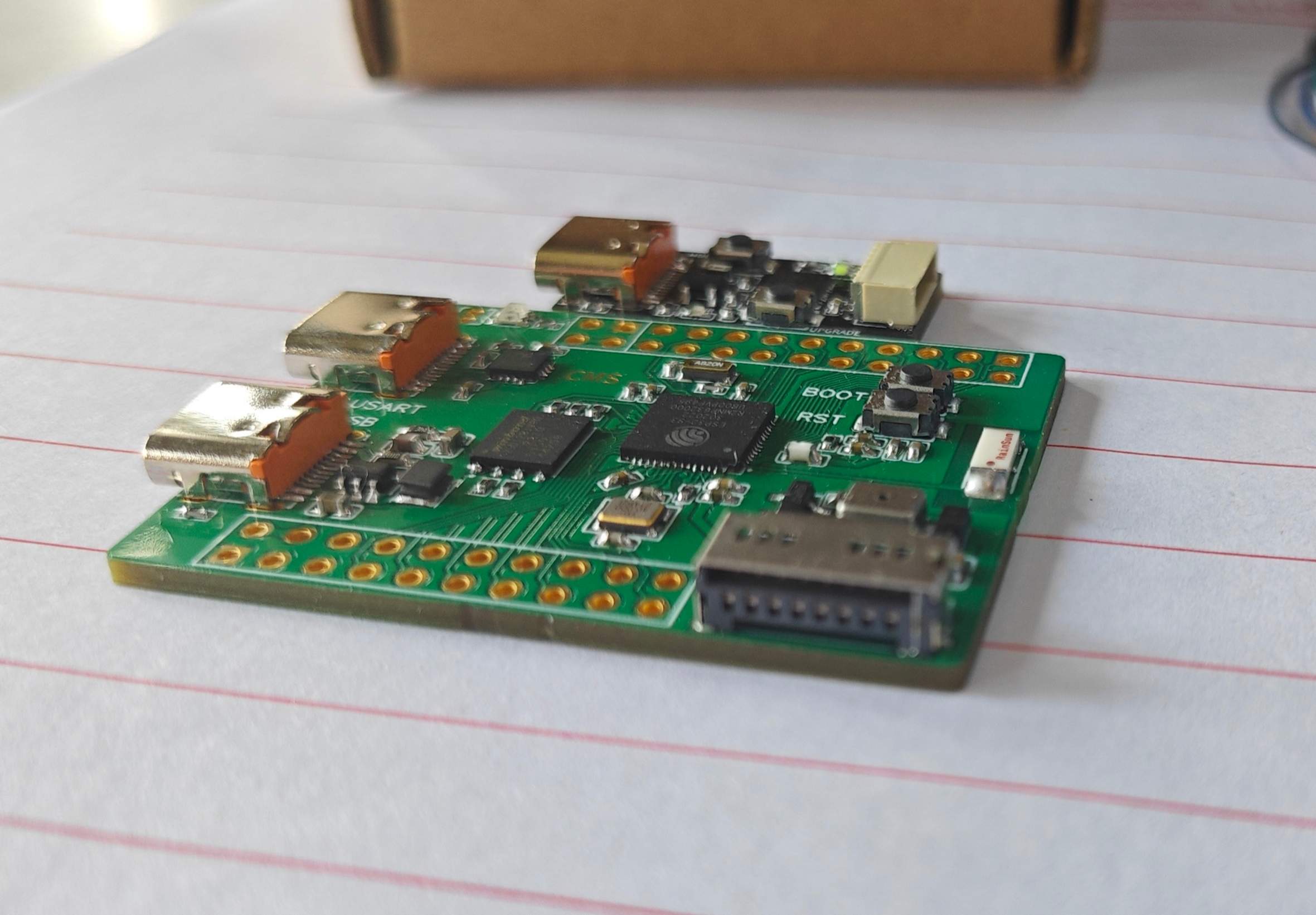

ESP32-S3 Core Femto ultra-small core board
According to the ESP32-S3-PIE card portable terminal based on ESP32-S3 - Jialichuang EDA open source hardware platform (oshwhub.com), the schematic is modified and redrawn. The board
size is very small, only 3.5x4.5cm
, using a six-layer board design. There are no circuits in layers 3 and 4 that can be deleted (it’s a waste of money).
Onboard CH343 serial port, buzzer, WS2812 full-color LED, ceramic WiFi antenna (this is a doodle, no impedance matching is done), Flash, TF card groove
