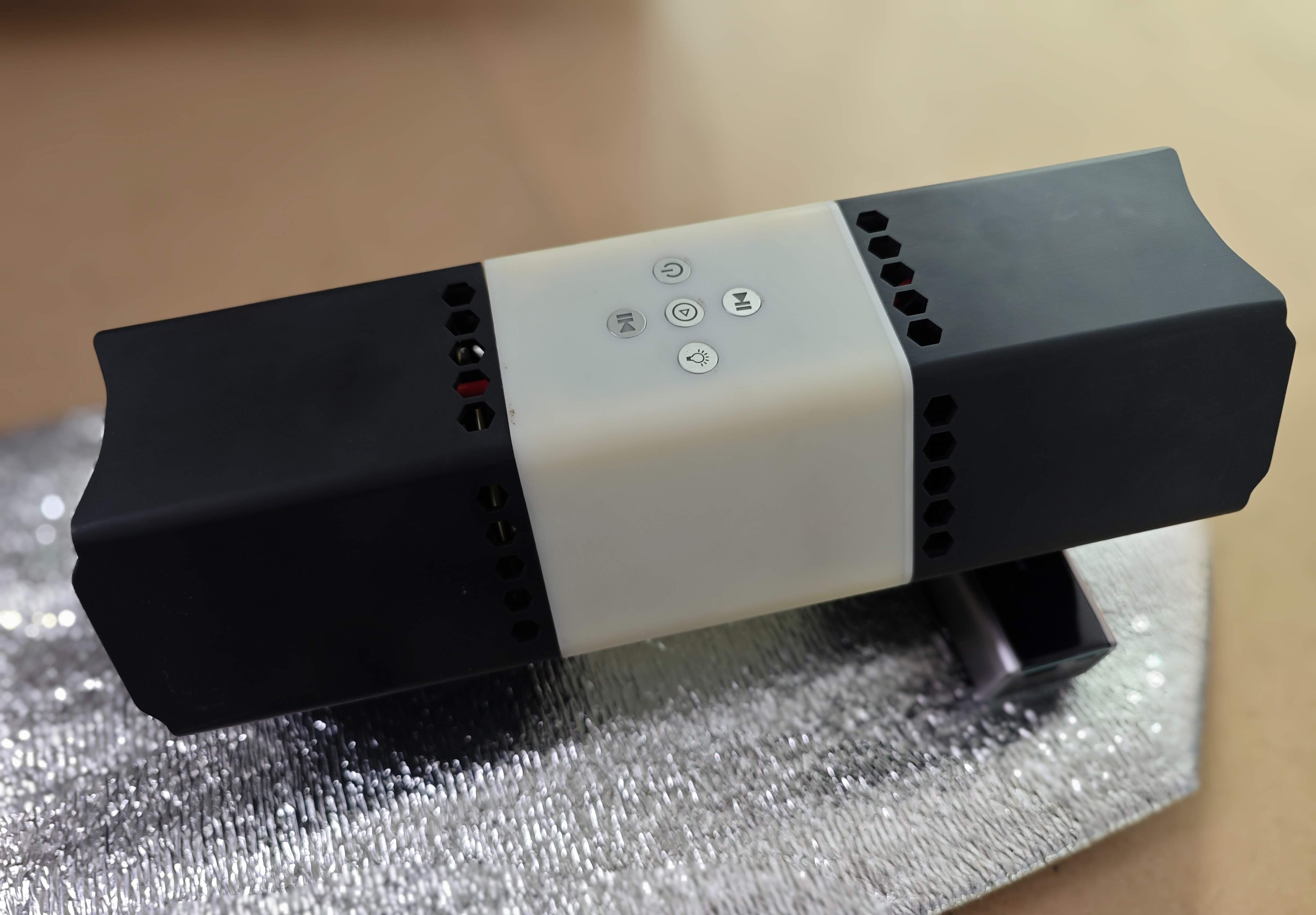

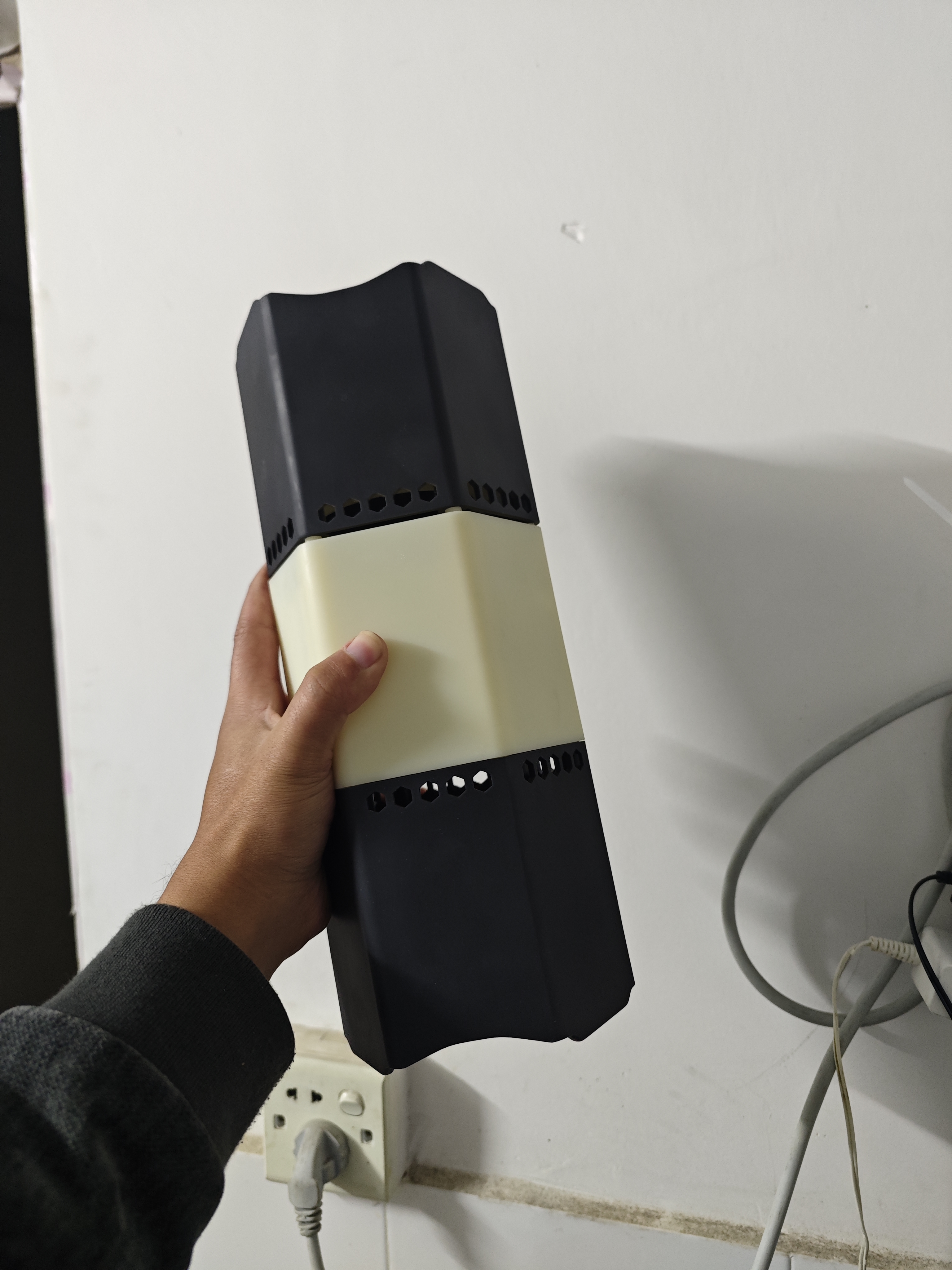

A Bluetooth speaker with a perfect ceremonial atmosphere

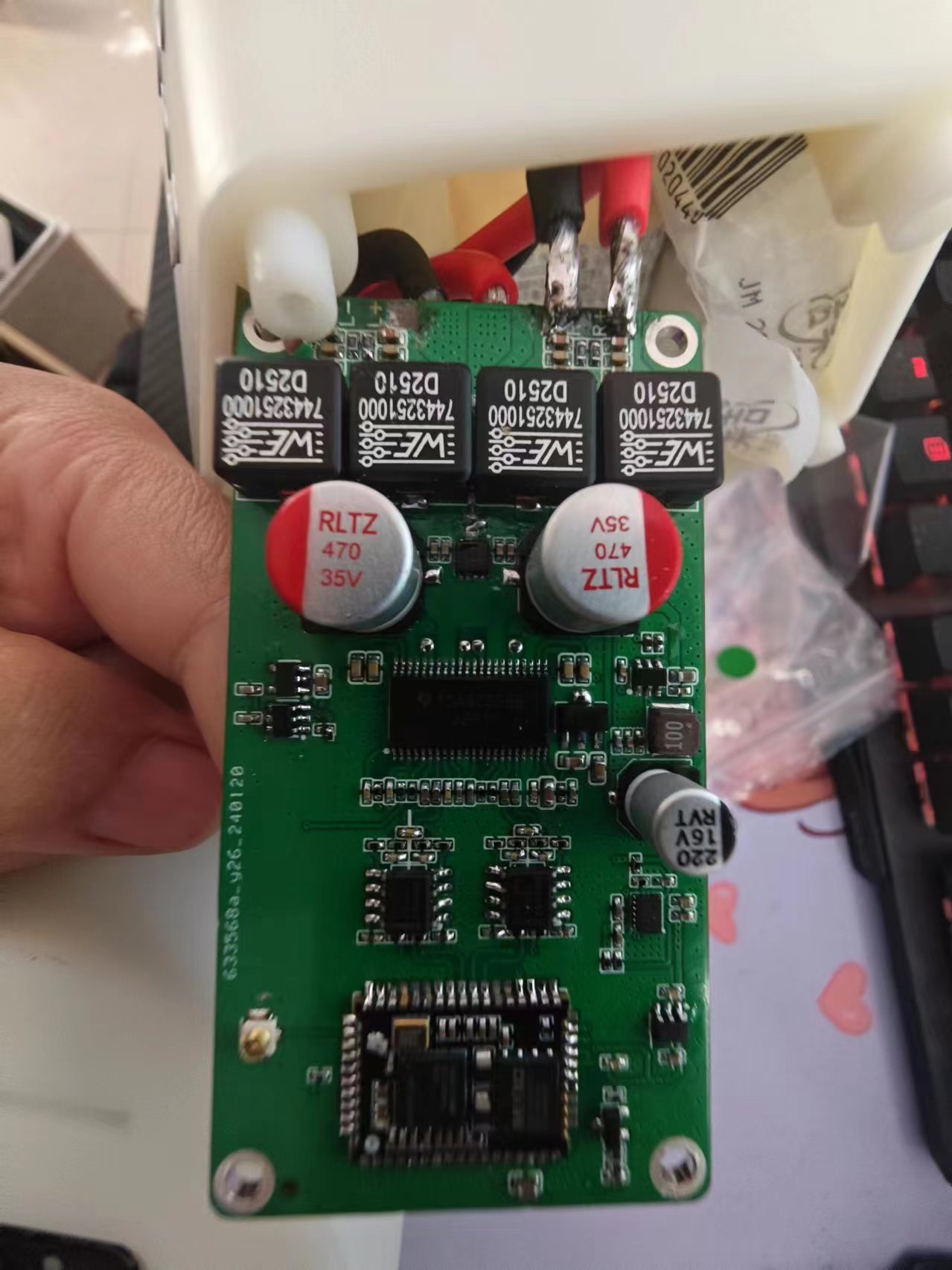

This amplifier board is based on the QCC3034 and TPA3244. Two speakers can be configured as a TWS speaker pair.

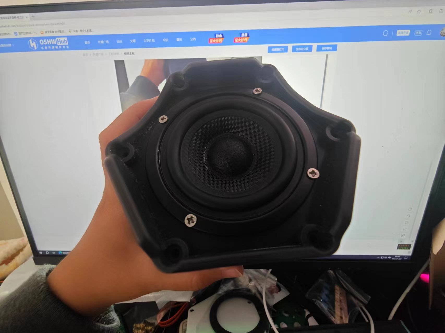

It uses two 3-inch full-range drivers. The power supply uses five 21700 batteries in series. The amplifier supports a maximum of 2*30W (8 ohms) at 21V and a maximum of 2*50W (8 ohms) at 30V (unverified).
Reproduction of this project is not recommended at this time; the exterior will be redesigned and ambient lighting added next month.
The following issues currently exist:

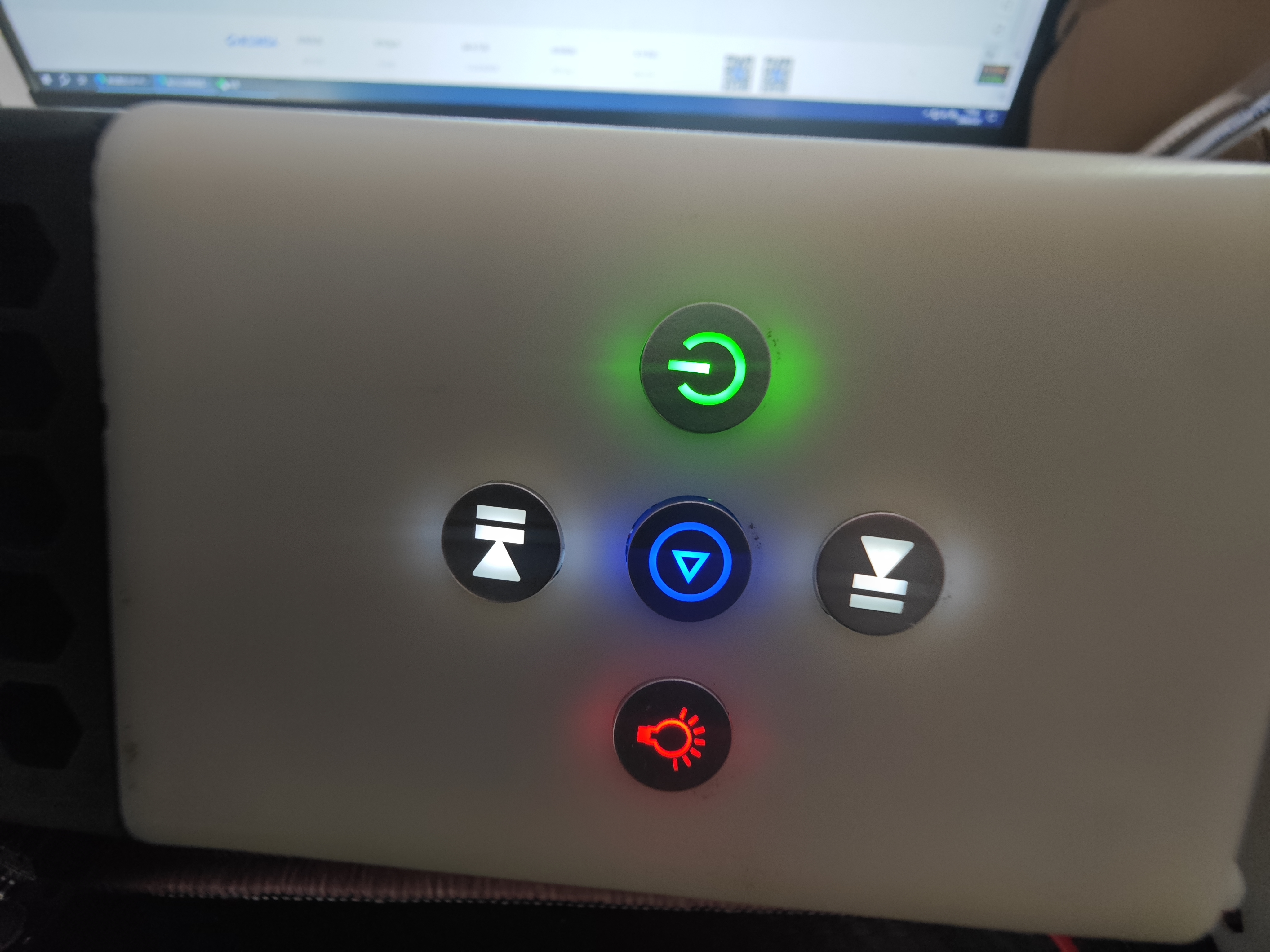

1. One-button power on/off is ineffective, so it cannot be turned off.
2. Incorrect button orientation.
3. The rear acoustic chamber is too small, resulting in poor sound quality.
