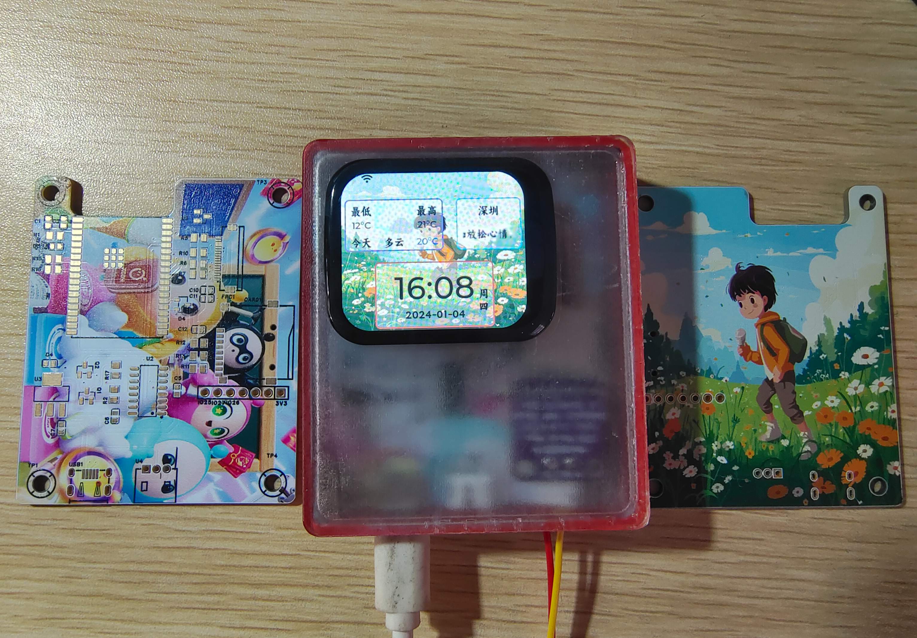

Materials used: ESP32 + MAX98357 + 1.69-inch touchscreen CST816 driver Project environment: ESP-IDF + ESP-ADF + LVGL Project progress: The weather clock interface was completed using the development board (see image).
Project description: 1. Connect to WiFi. On first use, you can choose to scan for WiFi networks; the screen will display the found WiFi networks for manual connection.
2. After successful connection, the WiFi username and password will be saved to NVS. Subsequent connections do not require scanning. 3. A weather clock interface created using LVGL can display the time and weather for today and tomorrow, and also has a scrolling suggestion. City names can be manually entered. 4. A music playback interface was created using LVGL and ESP-ADF to play MP3 files from an SD card,
with functions such as next track, previous track, pause, playback progress bar, progress bar dragging, and selecting specific songs.
Full video demonstration available on Bilibili: BV1Se411m7B3
##############Note#########
If the ESP32 screen doesn't fit, do not force it in. Do not force it in. Try to sand it down. Don't break the screen! 555555555555555555555
Updated January 16, 2024:
Added the ability to play three favorite online radio stations to the MP3 interface. The "Warm Winter Creations" ZIP file was also re-uploaded.
