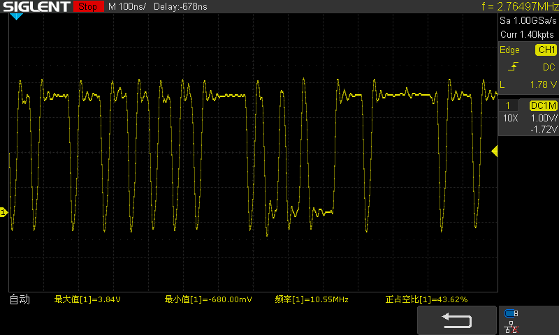

2023-09-04 00:45 Program readjusted before release; current test shows SWCLK clock reaches 10MHz, downloading 1000KB program takes approximately 8.5 seconds.

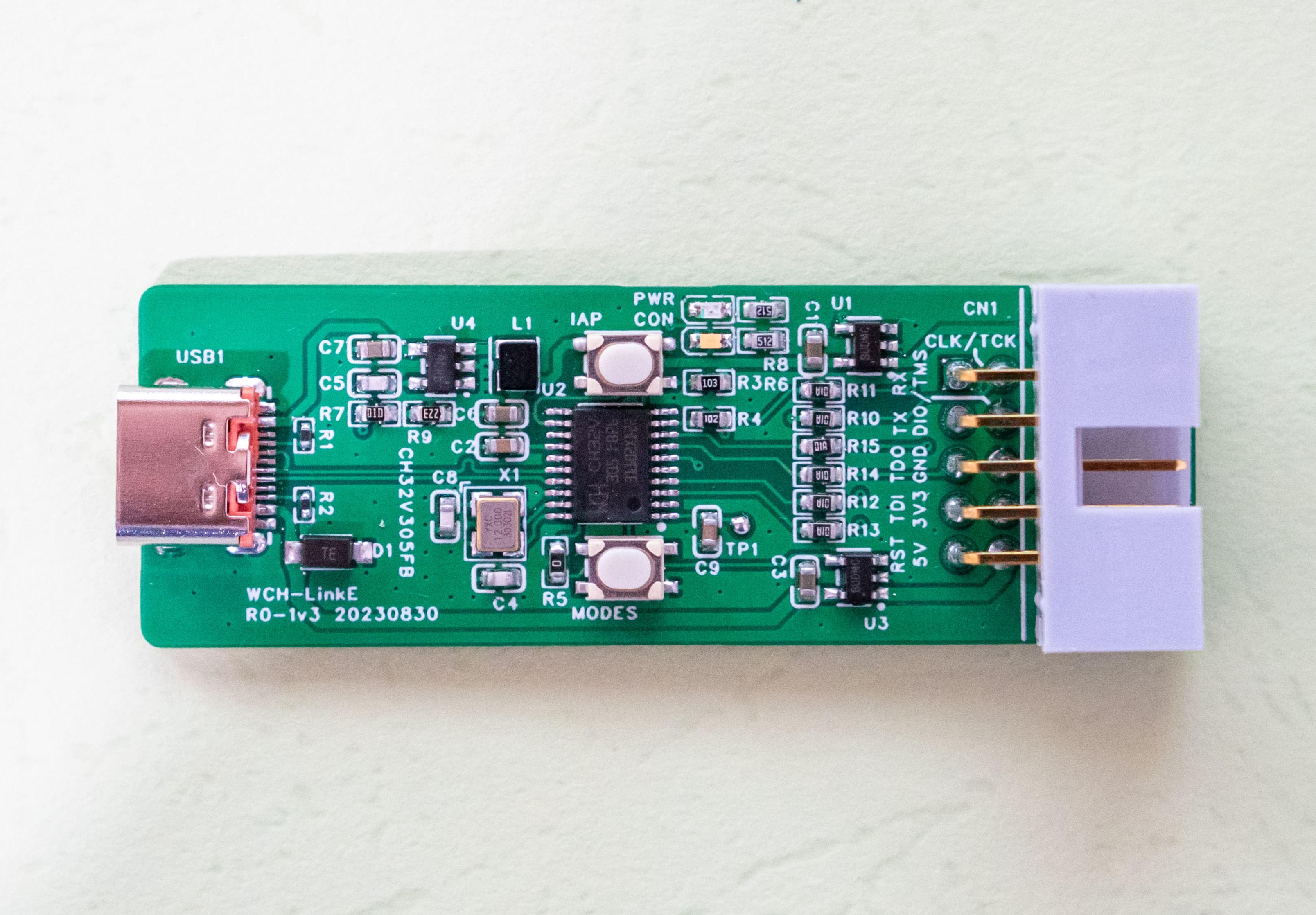

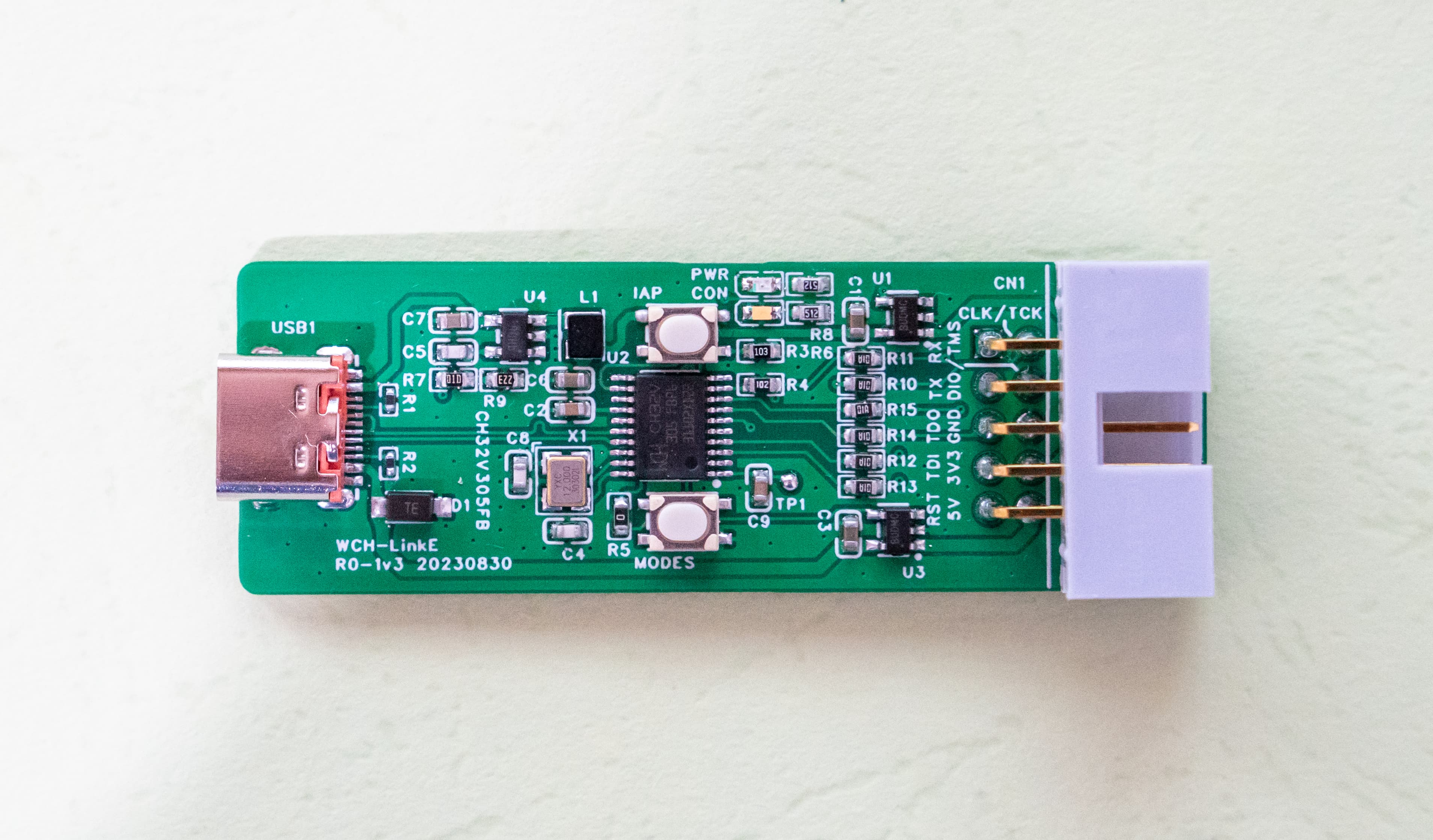

Project Description:

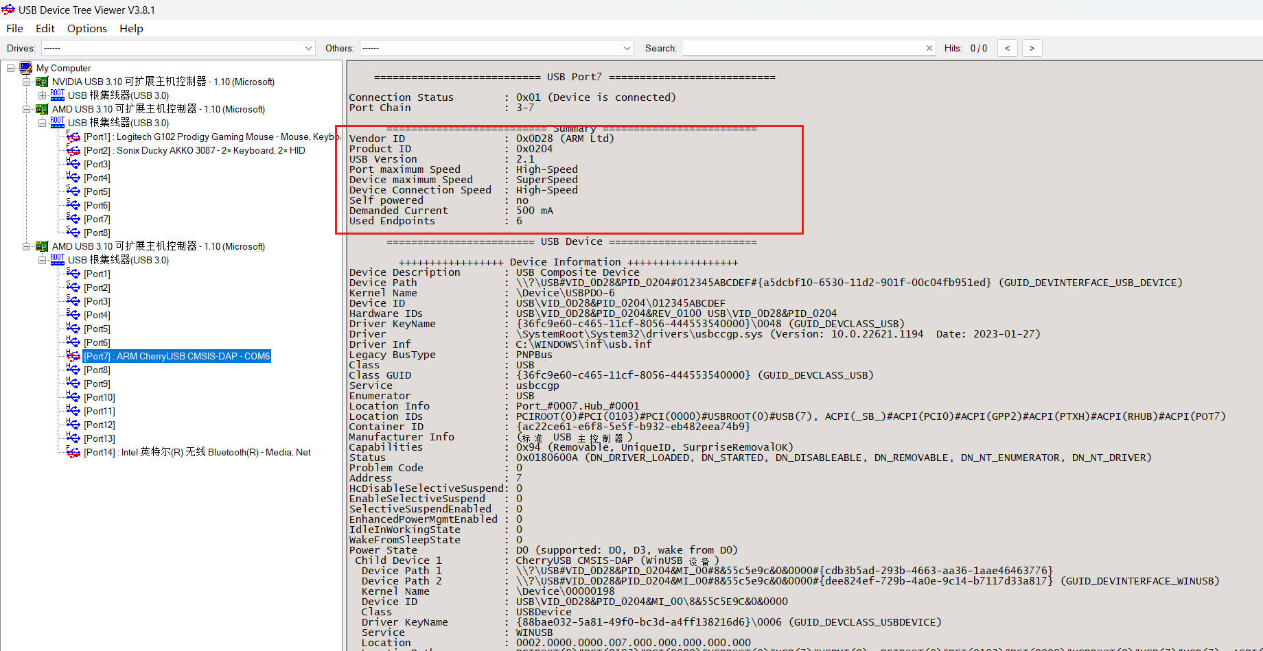

This is a high-speed DAPLINK based on the CH32V305FBP6. Originally, this project was intended for flashing the original WCH-LinkE firmware. However, it was discovered that the original LinkE firmware only supports USBFS, and the CDC serial port only supports a maximum baud rate of 921600, with packet loss during high-speed transmission and reception. Therefore, I ported the CherryDAP project from a senior developer, implementing DAP flashing and CDC serial port functionality under USBHS (480M).
This project is fully compatible with WCH-LinkE. Those who need RV kernel debugging can flash the original firmware; a flashing tutorial is provided below.
Features:

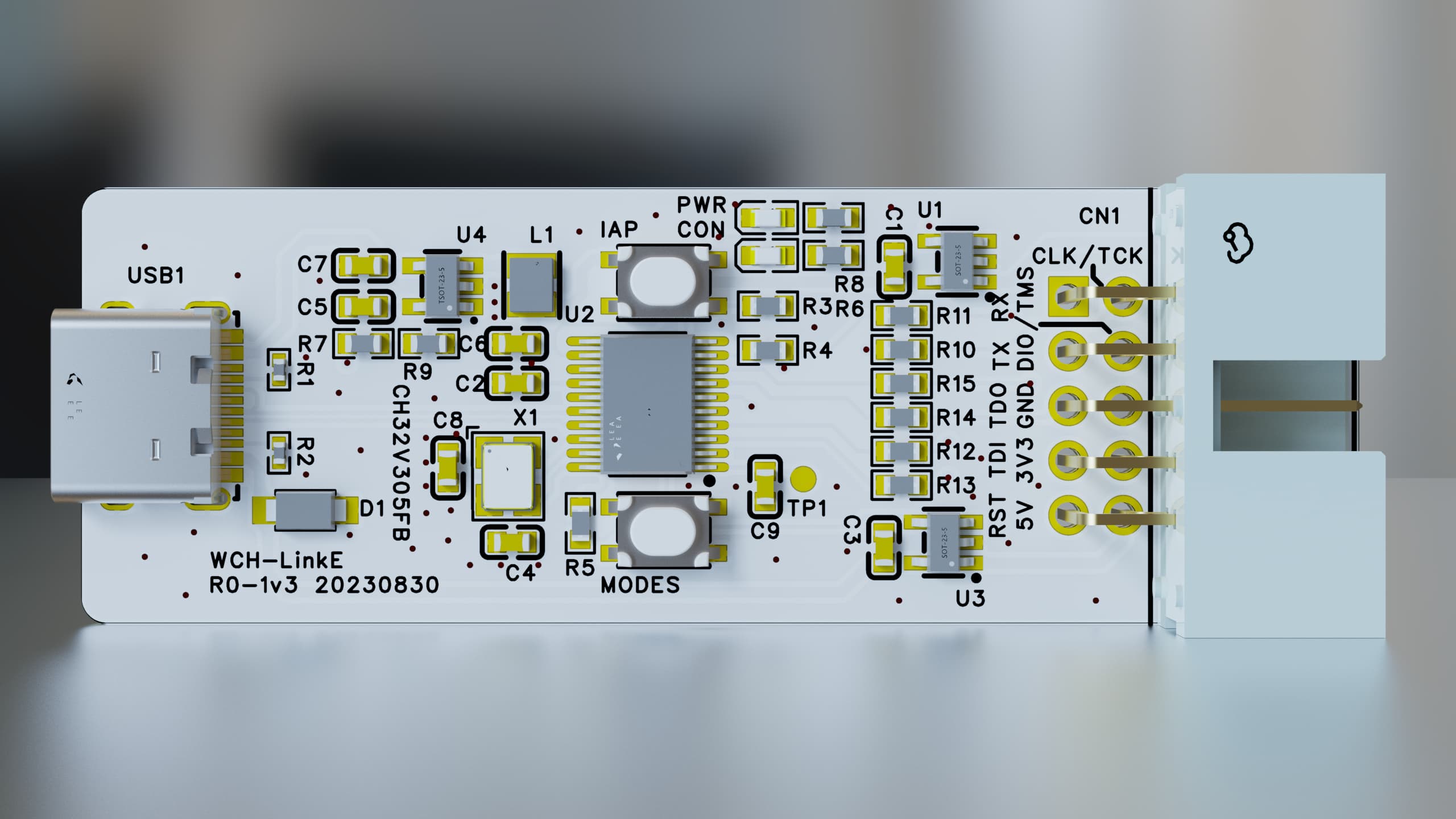

Utilizes CH32V305, built-in high-speed 480M USB PHY, supports up to 4M serial port transmission, SWD clock supports up to 10MHz
, includes SY6288DAAC, built-in reverse current and overcurrent protection, preventing external current from flowing back into the USB port .
3V3 power supply uses SY8089A1AAC 2A DCDC, supports high current output at 3V3.
TYPE-C interface for easy wiring.
Supports SWD and JTAG interfaces (high-speed JTAG can be flashed with WCH official firmware).
Fully compatible with WCH-LinkE firmware .

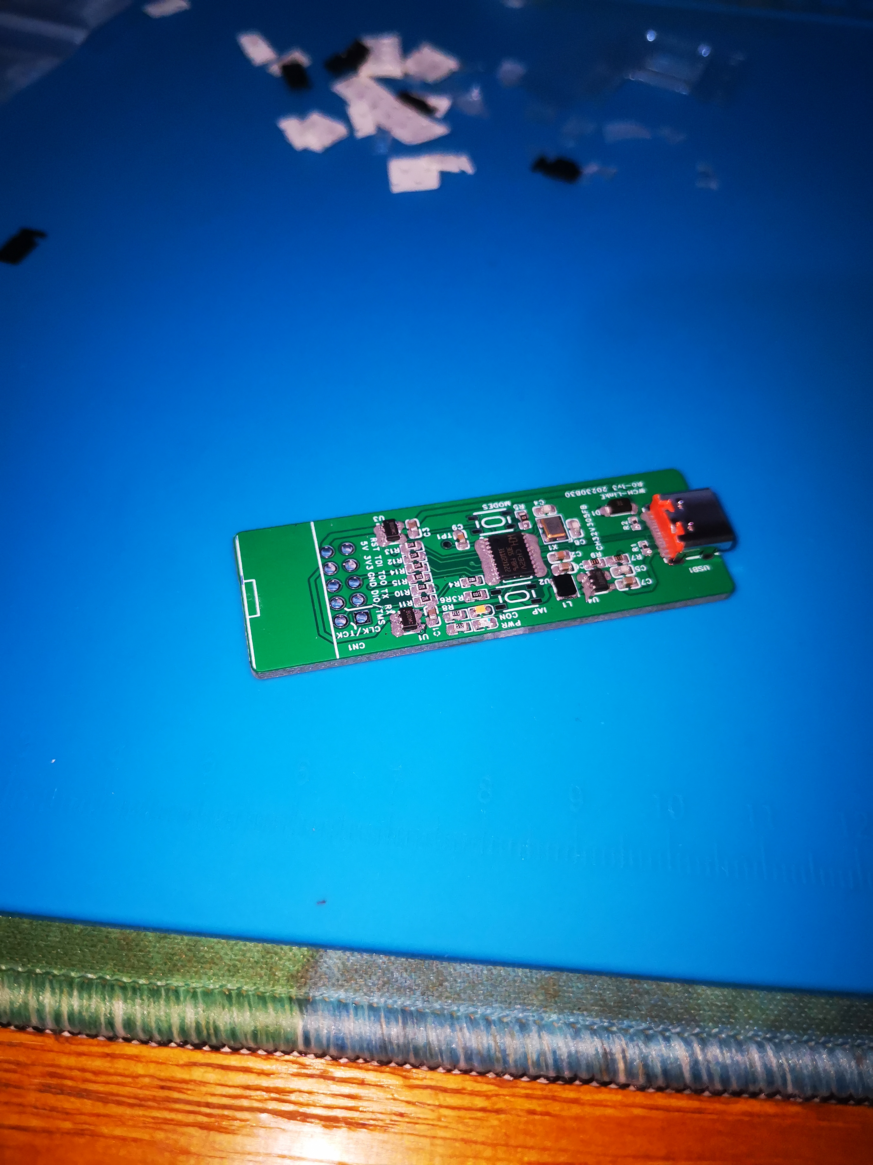

Soldering instructions:
Component model and attributes have been checked; simply refer to the BOM below for matching.
2520 inductors are only readily available from LCSC; difficult to find on Taobao. If needed, you can modify the package yourself.
Current limiting switch: Remember to purchase the SY6288D low-level active version; when replacing replacement parts, pay attention to the active level.
DC3 socket: Unless there are special requirements, a regular socket is sufficient. For a gold plating finish, purchase the socket listed in the BOM. If
the TYPE-C socket is unavailable, replace it with a TYPEC-304A-ACP series socket. (Represents plastic color; search "LCSC Mall" without **, multiple colors available).

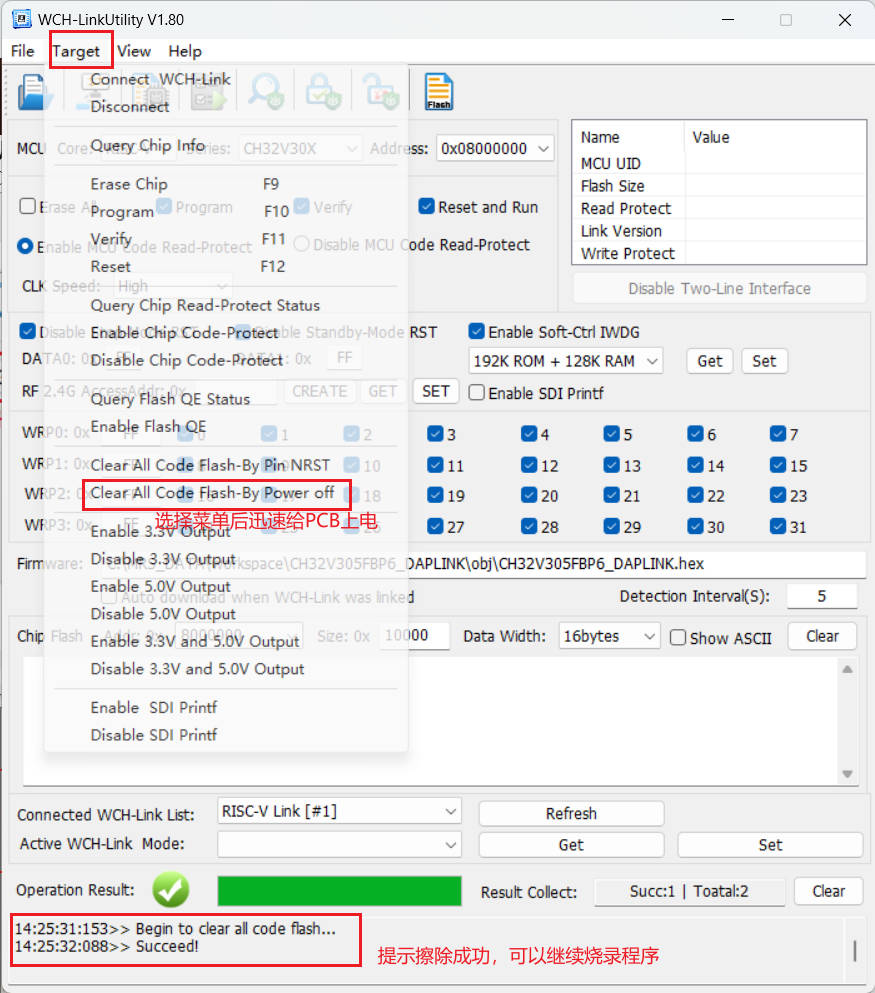

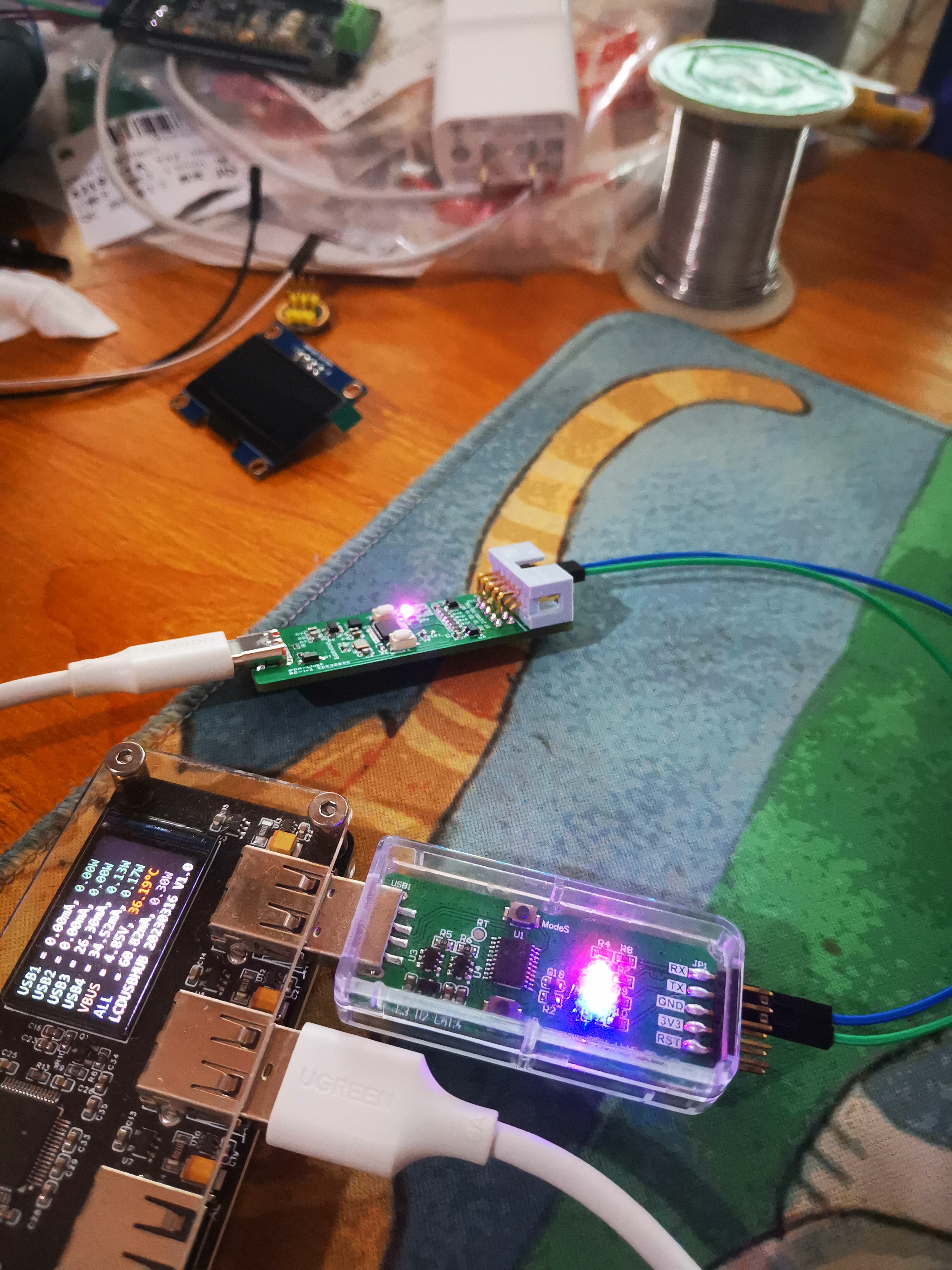

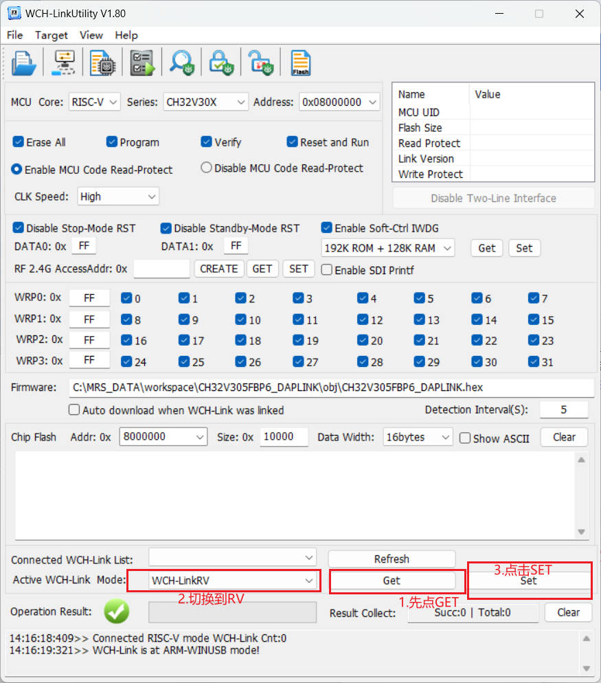

Burning Instructions
: Prerequisites: You must have a WCH-Link chip. It is recommended to purchase LinkE, which supports full code flash erasure.
The chip used in this project has no BOOT pin. Using a first-generation WCH-Link chip will prevent it from being programmed again after initialization. Purchase link: https://item.taobao.com/item.htm?spm=a21n57.1.0.0.6ce4523cS2mfot&id=704098651367&ns=1&abbucket=15#detail
Switch WCH-LinkE to RV mode

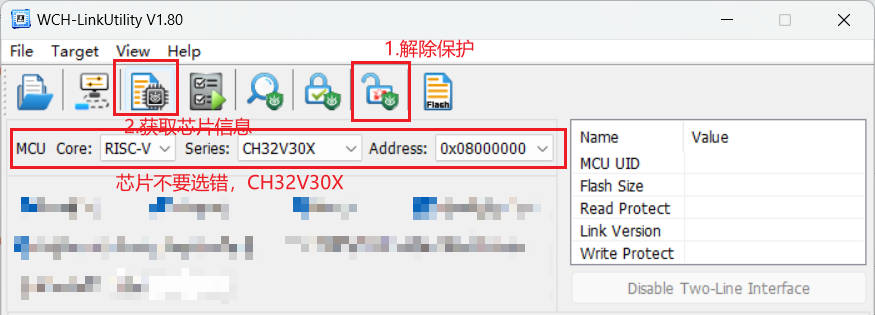

and open WCH-LinkUtility (attached). Modify according to the screenshot: Connect WCH
-LinkE to the PCB to be programmed. Connect
the DIO and CLK of WCH-LinkE to the DIO and CLK of the PCB (the PCB also needs power), as shown in the figure below:
After connection, remove read protection in the software and read the chip information
(updated on September 8th, after the first programming, you can press the IAP button to power on and then refer to the steps below to download. The erase steps below are not required!).
Follow the steps in the figure below. If it cannot be read, it means that the chip's DIO/CLK is occupied. You need to refer to the next step to power on and erase.
Power-on erase
After programming, the DIO CLK pin will be occupied, preventing connection to the MCU. Power-on erasure is required. First, disconnect the PCB power supply and follow the instructions below to erase:
RST Erasure
Power-on erasure requires quick operation. If it fails multiple times, you can connect a jumper wire from the TP1 test point on the PCB to the RST reset pin of the LinkE or Link. Then select "Clear All Code Flash-By Pin NRST".

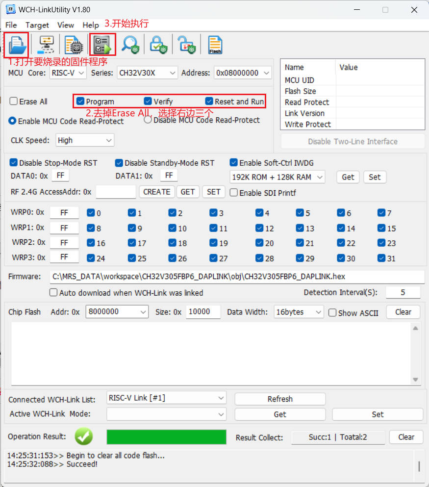

Programming
follows the steps shown in the image below. The original WCH-LinkE firmware is programmed in the same way.

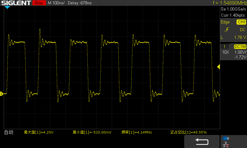

Test images:
SWCLK pin frequency in 10M mode;
SWCLK frequency in 5M mode;
USB HS test;

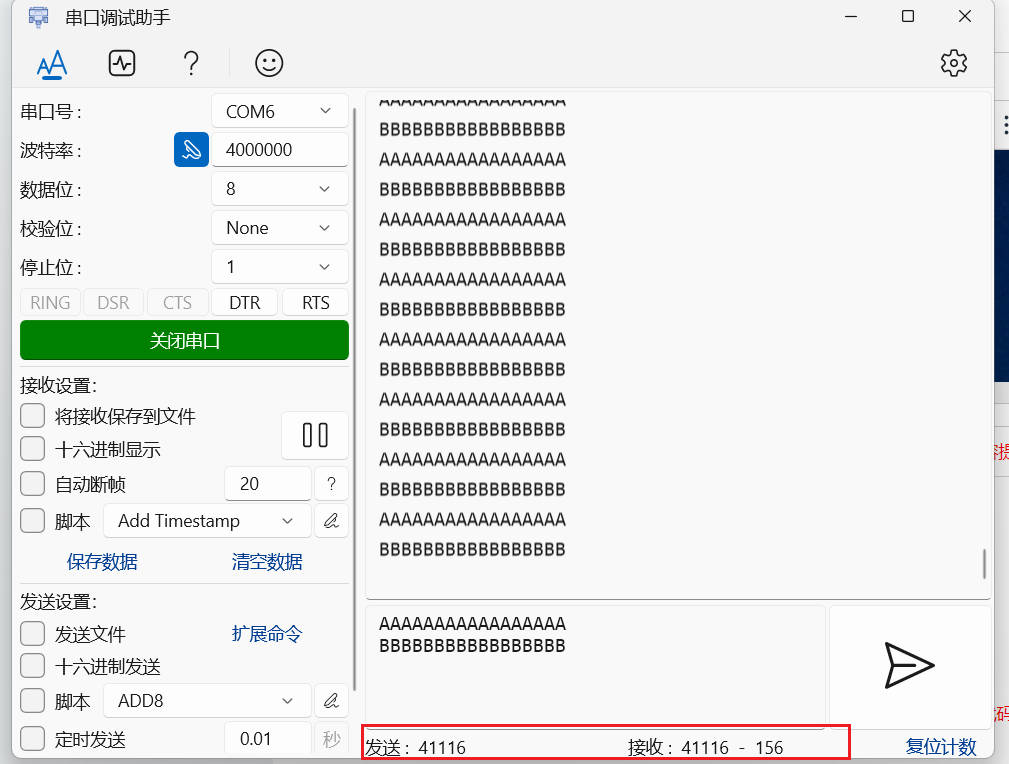

CDC serial port loopback test (TX and RX connected together, no packet loss in 4M mode);
