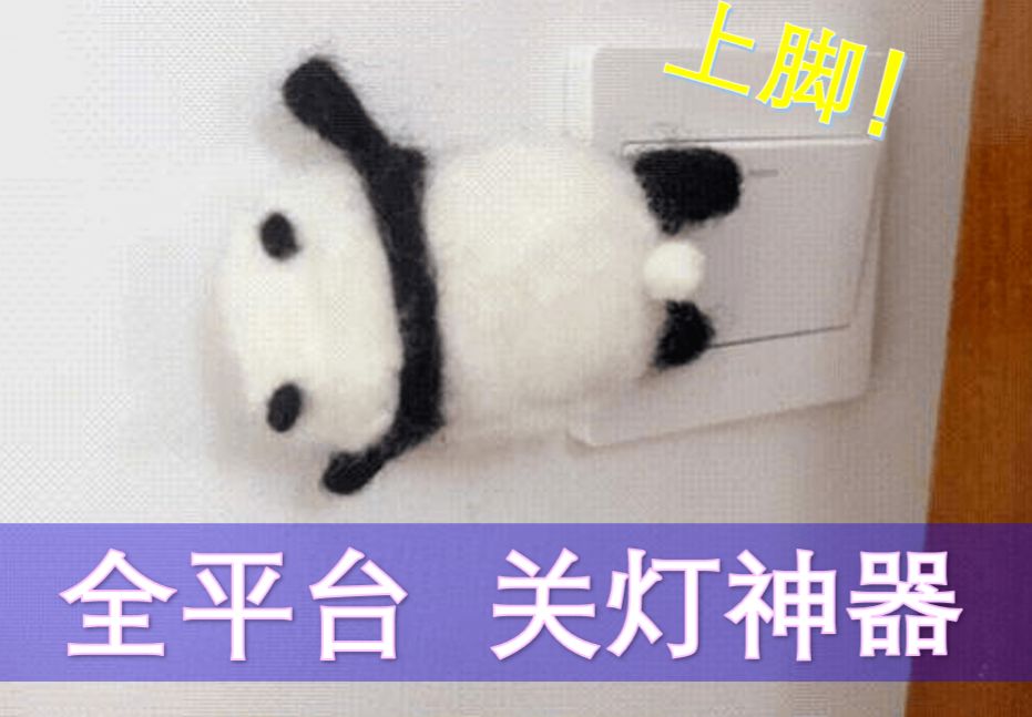

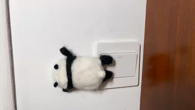

The ESP32-C3 Panda Tube Light
is designed for lazy people, eliminating the need to get out of bed to find the light switch. Simply pull down the notification bar and tap to enjoy an elegant and convenient lighting control experience. Let the panda handle the switch with its feet; lazy people should be able to lie flatter and more comfortably. This project essentially solves the major problem of needing to turn off the lights before bed in winter.

1. Adjust the servo installation angle: You can adjust the position of the servo motor that is pressed to turn on and off in the Rainmaker APP.
