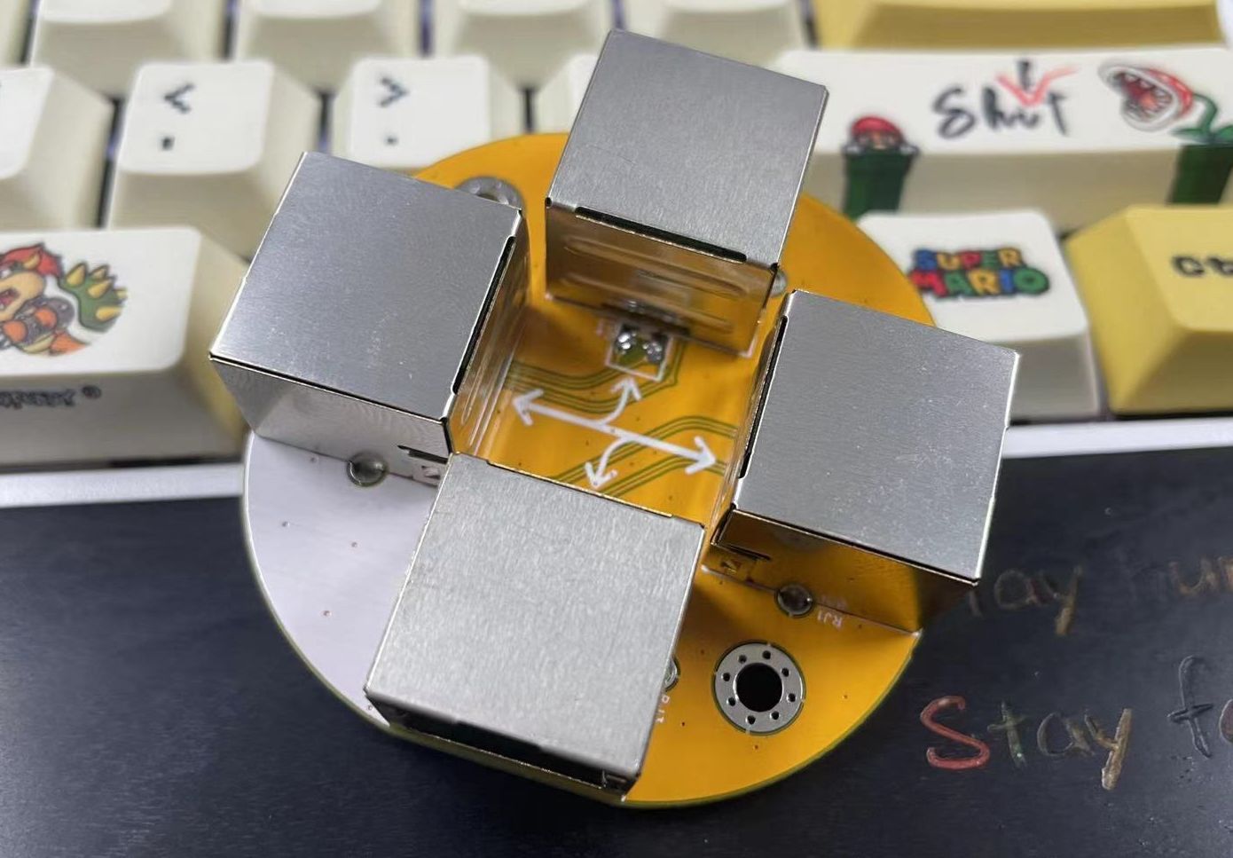

construction
is very simple,
soldering 4 RJ45s. The original author used Amphenol. RJHSE-5080/RJHSE-5380, this project is based on C2828082, which is not recommended. I just happened to have some of this model with LEDs left over.
For the capacitors, the original author used a 220pF KEMET C315C221K1G5TA monolithic capacitor. This project is compatible with both 100mil and C0805 through-hole packages. A C0G (NP0) 220pF capacitor is recommended. The original 100VDC
connector did not have shielded interfaces. In this diagram, the four RJ45 shields are interconnected and connected to the screw holes. There will be no difference in actual use.

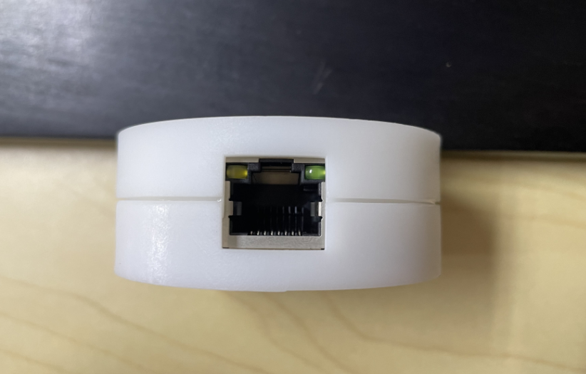

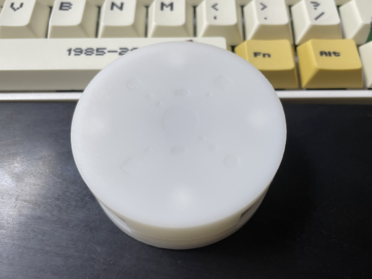

The casing
uses the EDA's built-in casing design; a rounded shape looks better. The dots on top indicate straight-through, and the square ports are for monitoring. Using colored pens to make raised dots would be better.
I'm not very good at EDA design, so there are a few issues:
As shown in the image above, the distance between the bottom shell and the bottom edge of the network port isn't right. It doesn't affect usability, and I'm too lazy to fix it.
There's a tiny gap between the top and bottom shells; it might look nice as a dark-colored trim after some wear and tear (not really).
The support posts for the screw holes inside the bottom shell are too short and don't reach the PCB. The positioning posts for the network port are supported on top of the bottom shell (actually, the above two issues are also due to this; I don't want to cut the support posts, as it would look even worse if it's uneven)
. I don't know how to add clips in EDA, so I used top and bottom studs to press down on the PCB for fixation (even though the design is a bit short). Then, I used glue to fix the top and bottom shells at the interface.
