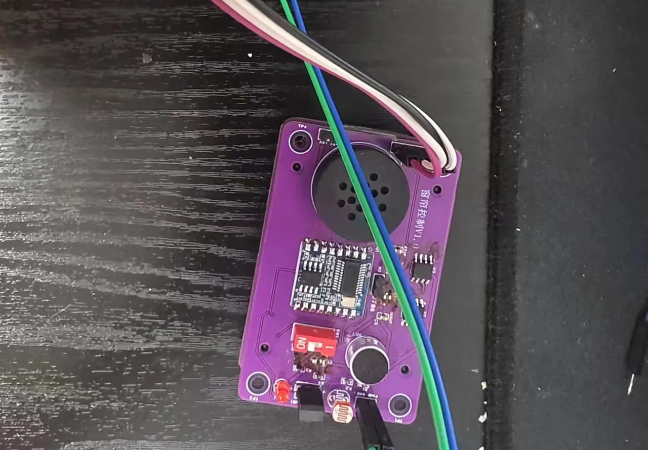

![1698287126209.png] V. Physical demonstration
![a2a6fd735995d03f14fa00e4cbdf847.jpg] Video: ![Uploading_daf7b76e-78d4-46da-b28c-be83f741b5a7]()
