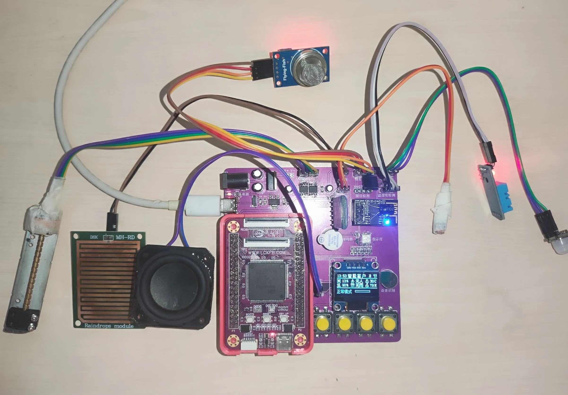

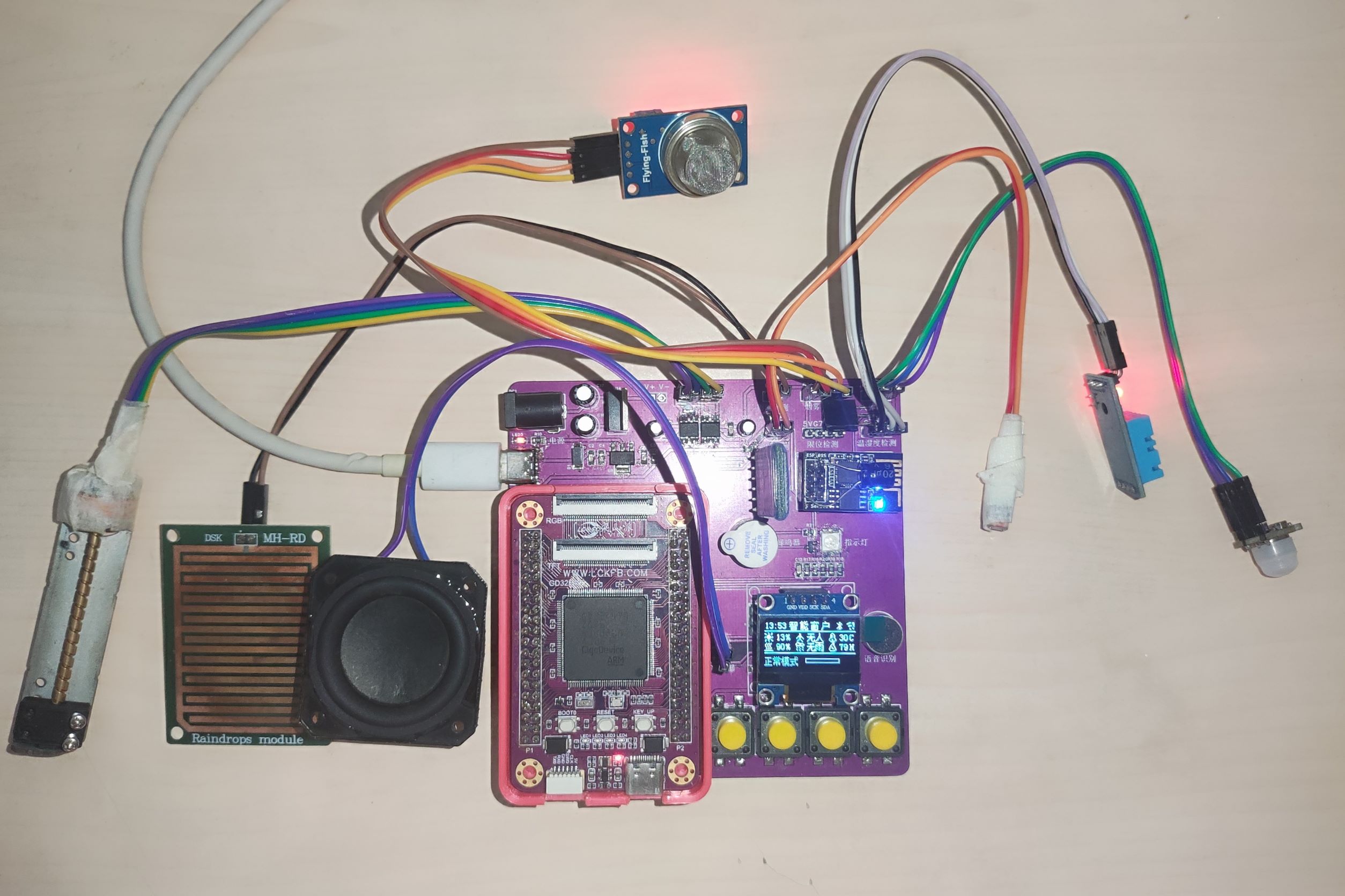

Smart Window
Project Overview:
This project is a smart furniture window based on the Liangshanpai development board, referencing the official smart curtain case study. It features raindrop, light, human body, smoke, and temperature/humidity sensors to detect environmental data and automatically open and close the window according to set modes. The window can be controlled via buttons, Bluetooth, Wi-Fi, and voice. The Diandeng Technology APP allows users to view environmental sensor data and control window functions.
Project Functions:

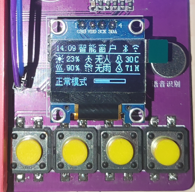

Window opening and closing and mode selection are controlled via buttons, Bluetooth, Wi-Fi (APP), and voice.
Real-time monitoring of environmental data (raindrops, light, human body, smoke, temperature, and humidity).
Environmental thresholds can be set via four independent buttons.
Features include smoke and intrusion alarms.

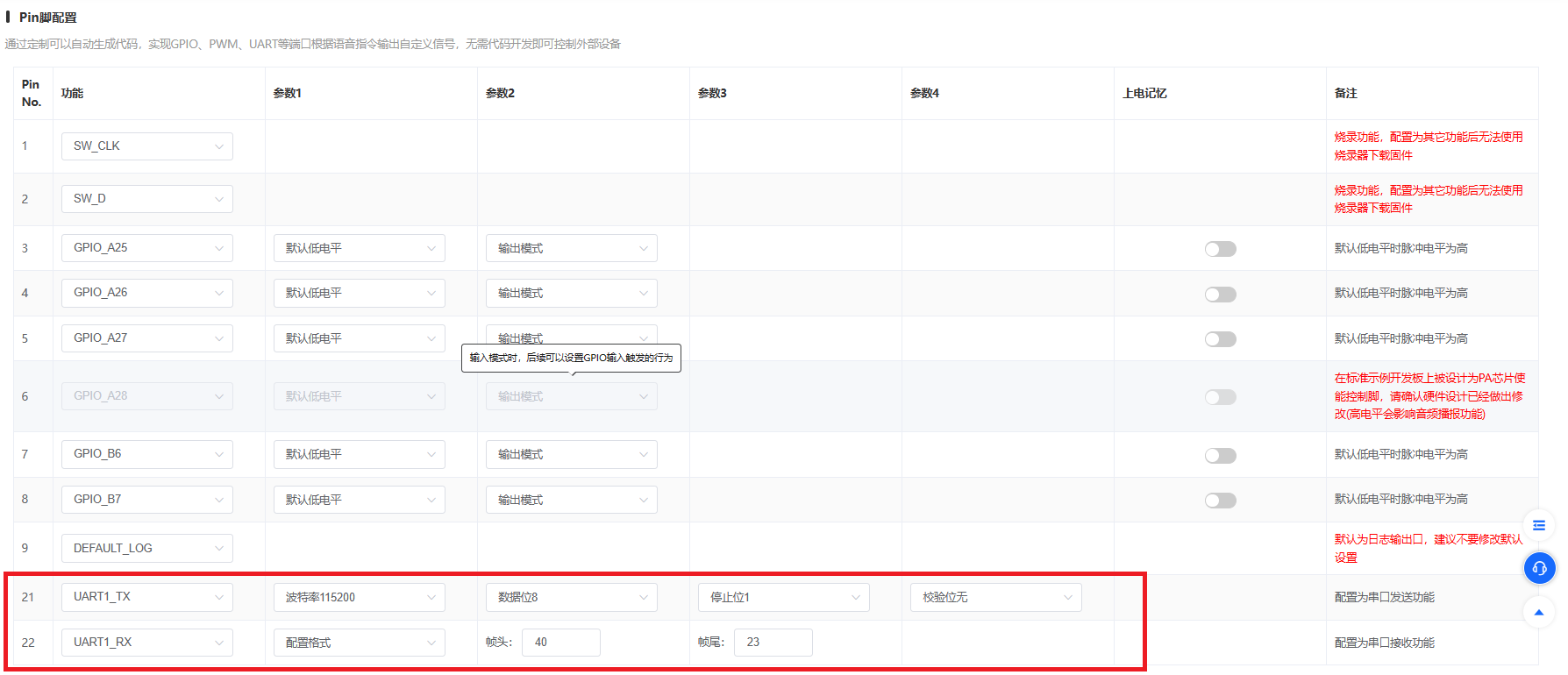

Hardware Block Diagram
I/O Assignment
Pin Name
Multiplexed Function
Peripheral Pin
Remarks
Category
VBAT
VBAT
VBAT+
Backup Power
Supply
PC1
ADC012_IN11
PC1
Rain Sensor
PC2
ADC012_IN12
PC2
Light
Sensor
PC3
ADC012_IN13
PC3
Smoke Sensor
PB0
PB0
DHT11_PB0
Temperature and Humidity Sensor
PD1
PD1
SR_PD1
Human Body Sensor
PD0
PD0
ESP_IO0
WIFI Module IO0
WIFI Module
PD4
PD4
ESP_RST
WIFI Module Reset
PD5
PD5
EPS_IO2
WIFI Module IO2
PB10
USART2_TX
EPS_RXD
WIFI Module RXD
PB11
USART2_RX
EPS_TXD
WIFI Module TXD
PA0
UART3_TX
BL_RX
Bluetooth Module RXD
Bluetooth Module
PA1
UART3_RX
BL_TX
Bluetooth Module TXD
PF10
PF10
BL_STATE
Bluetooth Module Status
PA2
USART1_TX
HLK_B2
Voice Module RXD
Voice Module
PA3
USART1_RX
HLK_B3
Voice Module TXD
PA8
PA8
BAK_A
Motor A Phase BAK
Motor Driver
PA11
PA11
FOR_A
Motor A Phase FOR
PA12
PA12
BAK_B
Motor B Phase BAK
PA15
PA15
FOR_B
Motor B Phase FOR
PF8
PF8
KEY1_PF8
Button 1
Independent Button
PF6
PF6
KEY2_PF6
Button 2
PF9
PF9
KEY3_PF9
Button 3
PF7
PF7
KEY4_PF7
Button 4
PC6
PC6
BUZZ_PC6
Buzzer Pin
Buzzer
PB12
PB12
LED_PB12
Red Indicator
Indicator
PB13
PB13
LED_PB13
Green Indicator
PB14
PB14
LED_PB14
Blue Indicator
PB7
I2C0_SDA
OLED_SDA
Screen Data Pin
Display Screen
PB6
I2C0_SCL
OLED_SCL
screen clock pin
firmware download
Liangshanpai firmware download
uses SWD programmer.
ESP-01s firmware download
Connect ESP01s and programmer according to the table below.
ESP01s
programmer
GND
GND
TX
Connect the downloader to the computer and use Arduion to download.
For
HLKv20 firmware download , disconnect all power and connect the HLKv20 and downloader according to the table below. Connect the downloader to the computer, open the software, select the firmware, and download. When
the COM port number appears, plug in the development board power and wait for the download to complete. For software configuration , copy the image configuration file below for the DianDeng Technology APP and ESP01s software configuration . {¨config¨{¨headerColor¨¨transparent¨¨headerStyle¨¨light¨¨background¨{¨img¨´´}}¨dashboard¨|{¨type¨¨btn¨¨ico¨¨fad fa-blinds¨¨mode¨Ê¨t0¨¨window¨¨t1¨¨text2¨¨bg¨É¨cols¨Í¨rows¨Í¨key¨¨btn_mado¨´x´É´y´Ê¨speech¨|÷¨lstyle¨Ë¨clr¨¨#076EEF¨}{ß8¨deb¨ßCÉßHÉßIÑßJÌßK¨debug¨´x´É´y´¤EßNÉ}{ß8ß9ßA¨fad fa-atom¨ßCÉßD¨Normal mode¨ßFßGßHÉßIÍßJÍßK¨btn_mode0¨´x´Í´y´ÊßNËßOßP}{ß8¨num¨ßD¨Light sensor¨ßA¨fal fa-question¨ßO¨#389BEE¨¨min¨É¨max¨¢1c¨uni¨´%´ßHÉßIÍßJËßK¨num_light¨´x´É´y´ÑßN˨rt¨«}{ß8ßVßD¨Smoke sensor¨ßA¨fad fa-chart-network¨ßOßYßZÉßaº0ßb´%´ßHÉßIÍßJËßK¨num_smoke¨´x´Í´y´ÑßNËßd«}{ß8¨tex¨ßD¨rain sensor¨ßF´´¨size¨¨¨18¨ßHÉßA¨fad fa-tint¨ßIÍßJËßK¨tex_rain¨´x´É´y´¤CßNÌ}{ß8ßhßD¨human sensor¨ßF´´ßjßkßHÉßA¨fad fa-house-return¨ßIÍßJËßK¨tex_body¨´x´Í´y´¤CßNÌ}{ß8¨ran¨ßD¨Window position¨ßOßPßaÍßZÉßHÉßIÑßJÊßK¨ran_num¨´x´É´y´ÐßNÌßd«}{ß8ß9ßA¨fad fa-server¨ßCÉßD¨Smart mode¨ßFßGßHÉßIËßJËßK¨btn_mode1¨´x´É´y´ÎßNÉßOßP}{ß8ß9ßA¨fad fa-bed¨ßCÉßD¨Sleep mode¨ßFßGßHÉßIËßJËßK¨btn_mode2¨´x´Ë´y´ÎßNÉßOßP}{ß8ß9ßA¨fad fa-sun¨ßCÉßD¨Sunlight mode¨ßFßGßHÉßIËßJËßK¨btn_mode3¨´x´Í´y´ÎßOßP}{ß8ß9ßA¨fad fa-fan¨ßCÉßD¨Ventilation mode¨ßFßGßHÉßIËßJËßK¨btn_mode4¨´x´Ï´y´ÎßOßPßNÉ}{ß8ßhßD¨-----------------Smart window control-----------------¨ßFßGßj´24´ßHËßA´´ßIÑßJÊßK´0´´x´É´y´ÉßNÎßOßP}{ß8ßVßD¨Temperature sensor¨ßA¨fad fa-thermometer-three-quarters¨ßOßYßZÉßaº0ßb´°C´ßHÉßIÍßJËßK¨num_temp¨´x´É´y´¤AßNÊ}{ß8ßVßD¨humidity sensor¨ßA¨fad fa-humidity¨ßOßYßZÉßaº0ßb´Hm´ßHÉßIÍßJËßK¨num_hum¨´x´Í´y´¤AßNÊ}÷¨actions¨|¦¨cmd¨¦ßL‡¨text¨‡´on´¨Open Window¨¨off¨¨Close Window¨—{ß1D{¨btn_mode¨´on´}ß1E¨Automatic Mode¨}{ß1D{ß1Iß1G}ß1E¨Manual Mode¨}÷¨triggers¨|{¨source¨¨switch¨¨source_zh¨¨Switch Status¨¨state¨|´on´ß1G÷¨state_zh¨|´Open´´Close´÷}÷ßd|÷} Follow the instructions in the image. Paste the copied key into the code to modify the WIFI name and password. char auth[] = "1122334455"; //Lighting Key char ssid[] = "NiseKana"; //Wi-Fi Name char pswd[] = "12345678"; //Wi-Fi Password Re-download after compiling firmware. Bluetooth Control APP Configuration Function Mode Normal Mode Smart Mode Sleep Mode Sunlight Mode Ventilation Mode Open Window Open Window 2/3 Open Window 1/2 Open Window 1/3 Close Window Send Data @mode0 @mode1 @mode2 @mode3 @mode4 #0 #1 #2 #3 #4 Voice Module Software Configuration Voice Module Configuration Platform: Smart Pi/AI Product Zero-Code Platform (smartpi.cn) Voice Module Configuration Reference: 15. Software Design - Voice Recognition Command Configuration - Platform 2 [Graduation Project - Smart Curtain Project] Hailing Technology Download Tool: Hailing Technology Download Tool First set the serial communication pins, command words, and serial input configuration, then set the wake-up word, exit reply, etc. according to personal preferences. Set the serial port parameters according to the picture, configure the frame header to 40 and the frame tail to 23. Configure serial port data sending and receiving. Serial port send configuration includes: behavior name, command word, and response.

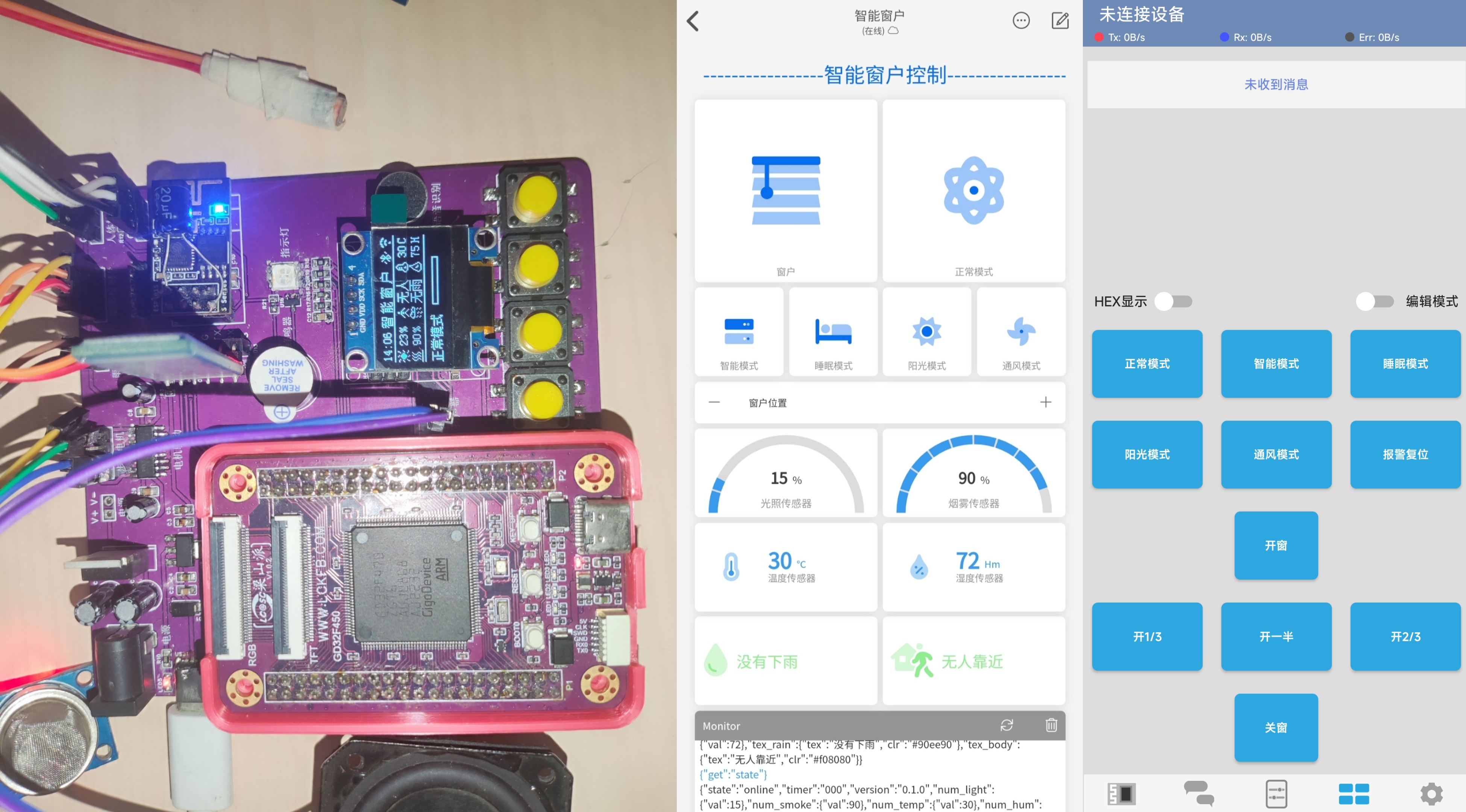

Serial port sending parameters
ON
Open window
Open window
Opened
OFF
Close window
Close window
Closed
Window 1 Open window to
one-third Close window to two-thirds OK Window 2 Open window to one-half Close window to one-half Open window half Window 3 Open window to two-thirds Close window to one-third OK Mode0 Normal mode Set window to normal mode Set to normal mode Mode1 Smart mode Set window to smart mode Set to smart mode Mode2 Sleep mode Set window to sleep mode Set to sleep mode Mode3 Sunshine mode Set window to sunshine mode Set to sunshine mode Mode4 Raindrop mode Set window to ventilation mode Set to ventilation mode volumeUpUni Increase volume volumeDownUni Decrease volume volumeMinUni Minimum volume volume max volumeMaxUni Maximum volume serial port input configuration behavior name Serial port input parameters Speed ​​test (send) message value Play voice NO1 no 40 01 01 23 Window open OFF1 off 40 02 02 23 Window closed MODE00 mode0 40 03 03 23 Set to Normal Mode MODE11 mode1 40 04 04 23 Set to Smart Mode MODE22 mode2 40 05 05 23 Set to Sleep Mode MODE33 mode3 40 06 06 23 Set to Sunlight Mode MODE44 mode4 40 07 07 23 Set to Ventilation Mode OK ok 40 08 08 23 Got it SMOKE smoke 40 09 09 23 Detected a lot of smoke, window opened LIGHT light 40 0A 0A 23 It's getting dark, window closed RAIN rain 40 0B 0B 23 It's raining, window closed BODY body 40 0C 0C 23 Someone passed by, window closed LIGHT1 light1 40 0D 0D 23 It's getting light, window opened RAIN1 rain1 40 0E 0E 23 The rain has stopped, and the windows are open. WINDOW1 window1 40 0F 0F 23 The window is open to one-third. WINDOW2 window2 40 11 11 23 The window is open to one-half. WINDOW3 window3 40 12 12 23 The window is open to two-thirds. Note: 1. Add a 100ms delay before voice broadcast and data transmission. 2. The capitalization of the letters in the action name and serial port input parameters cannot be changed. After verifying the configuration is correct, generate the firmware and download it. Project Demonstration: After powering on, the motor will automatically reset, and then the screen will display the main menu. The main menu is divided into three columns. The top column displays status information: time, title, and connection information. The middle column displays sensor information. The bottom column displays window mode, current window position, and alarm information (not displayed if no alarm occurs). The four buttons below the main menu are parameter setting, mode selection, window opening button, and window closing button. Pressing the parameter setting button will enter the secondary menu, with the button functions of OK, Back, Previous Page, and Next Page. After selecting the parameter to be set in the second-level menu, press the OK button to enter the second-level sub-menu. The button functions are to switch, save, increase, and decrease.
Remotely control windows and view environmental data via the DianDeng Technology APP. Windows can also be controlled via Bluetooth remote control or voice assistant.
Overall demonstration.

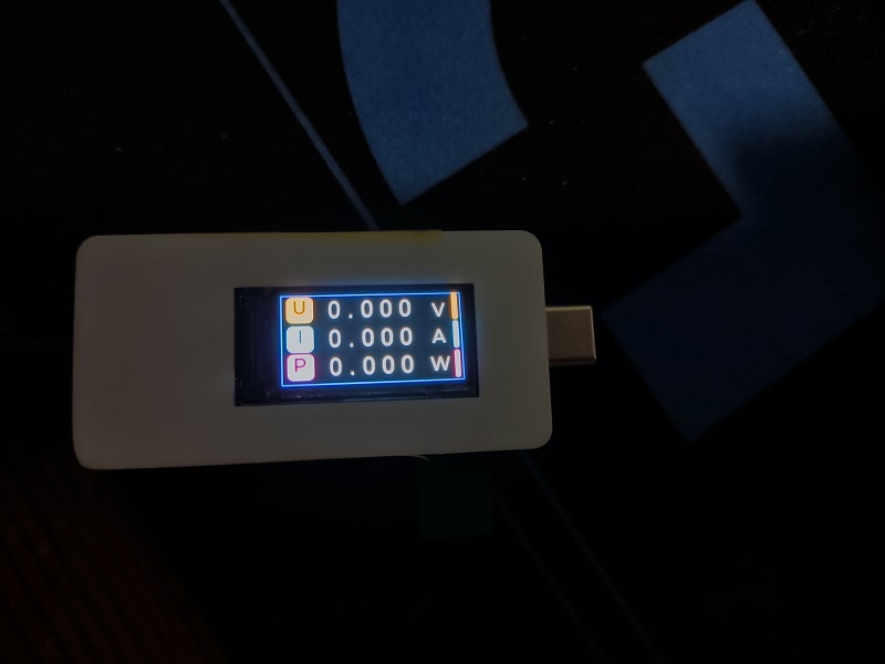

ESP32-Type C Ammeter
ESP32-Type-C Ammeter (with PD decoy function)
Project Name: ESP32-Type-C Ammeter (with PD Spoofing Function)
Project Description:
This project is a Type-C ammeter based on the ESP32 microcontroller, using a button and a CH224 chip for PD (Power Delivery) spoofing. It implements PD protocol power management through the Type-C interface, monitors current and voltage in the circuit in real time, and displays the data on a 0.96-inch TFT screen. The project integrates a TI INA226 sensor for high-precision current and voltage acquisition, providing accurate reference for power management of USB devices.
Hardware Components:
ESP32 Microcontroller:
   - Model: ESP32S3R8N8
   - Provides Wi-Fi and Bluetooth functionality, with rich peripheral interfaces.
   - Communicates with the INA226 sensor via I2C and drives the TFT screen via SPI.
TFT Screen:
   - Size: 0.96 inches
   - Interface: SPI
   - Function: Displays parameters such as voltage, current, and power.
TI INA226 Current Sensor:
   - Function: Used for accurate measurement of current and voltage.
   - Features: Supports I2C communication, built-in 10 milliohm sampling resistor.
USB Type-C Interface:
   - Connects devices via the USB-C interface for current and voltage monitoring, and supports PD protocol power management.
CH224 PD Spoofing Chip:
   - Function: Triggers the PD protocol, simulating device PD fast charging voltage selection.
   - Features: Can be triggered by a button to select different voltage levels, spoofing the device to output a specified voltage (e.g., 5V, 9V, 12V).
Buttons:
   - Two physical buttons are designed:
     1. Voltage Level Selection: Used to select different voltage levels for the PD fast charging protocol.
     2. Display Mode Switching: Used to switch the content displayed on the TFT screen (e.g., display modes for different parameters such as voltage, current, and power).
Working Principle:
Data Acquisition: The INA226 sensor communicates with the ESP32 via I2C to acquire voltage and current data in the circuit in real time.
PD Spoofing Function: Through the PD spoofing function of the CH224 chip, users can select different voltage levels by pressing a button to simulate the device's request for a fast charging power source.
Data Processing: The ESP32 processes the acquired data and displays the current voltage, current, power, and other information in real time on the TFT screen.
Type-C Interface Monitoring: Power and data transmission are handled via the Type-C interface, monitoring the current and voltage passing through this interface.
Project Features:
PD Spoofing Function: Using the CH224 chip, a button allows for PD protocol fast charging voltage selection, enabling users to choose different charging voltages for monitoring.
Button Interaction: Two buttons switch between PD voltage levels and TFT screen display modes, increasing user interaction flexibility.
High-Precision Current and Voltage Monitoring: The TI INA226 sensor ensures high-precision current and voltage measurements.
Real-Time Display: Power, current, and voltage information are intuitively displayed on a 0.96-inch TFT screen.
Application Scenarios:
USB PD Charger Testing: Can be used to test whether USB chargers supporting the PD protocol correctly output the target voltage.
Electronic Device Power Consumption Monitoring: Monitors the power consumption of various PD devices.
Development and Debugging: Suitable for developing and debugging electronic devices requiring PD spoofing functionality, facilitating verification of power consumption performance under different voltages.
By integrating the PD spoofing function, this project not only monitors current and voltage but also has PD protocol voltage selection capabilities, suitable for scenarios requiring fast charging management.
