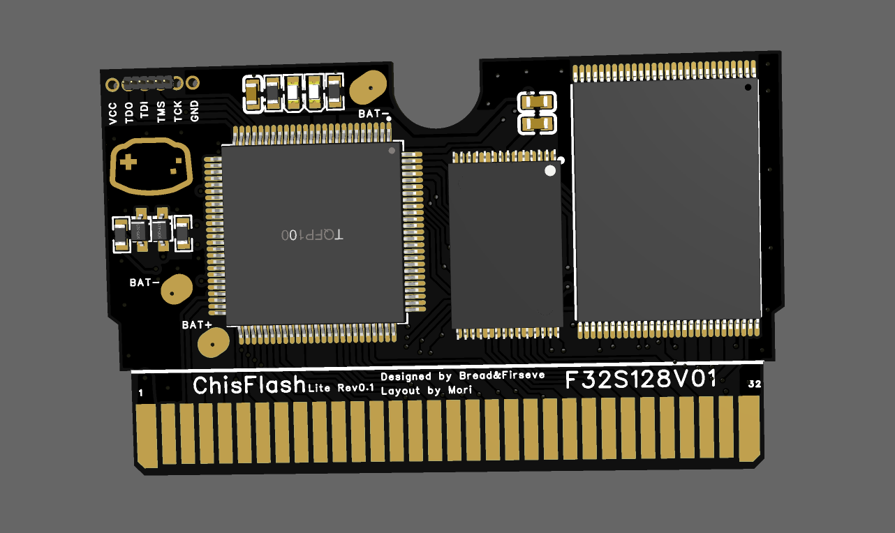

ChisFlash V0.1 Youth Edition Open Source GBA Flashcart
The functionality is the same as ChisFlashV1.0.
ChisFlash V0.1 (Pichu) uses 256Mbit Flash and 1Mbit SRAM, compatible with 99% of GBA games, and supports NDS and GBcartRW burning.
Important notes:
When making the PCB, ensure the thickness is 0.8mm.
The FM28V100-TG in the BOM should be the same packaged SRAM. Specific selection will be updated in real-time within the group.
Currently in beta testing, the firmware needs to be obtained from the QQ group (chisflashlitx_xxx.pof). After beta testing is complete, the firmware code will be open-sourced on GitHub.

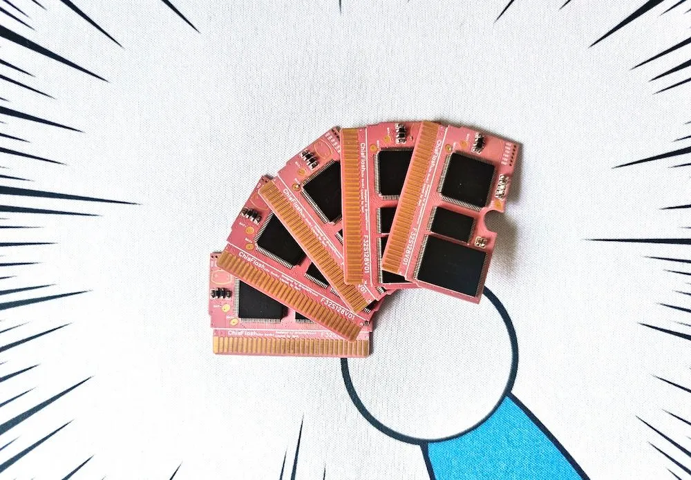

Product showcase
video demonstration
[[ChisFlash] Can you use a 2u immersive gold-plated card within a budget of 30 yuan? The first batch of DIY all-purpose GBA flashcarts has already left - Bilibili] https://b23.tv/K90WHhc

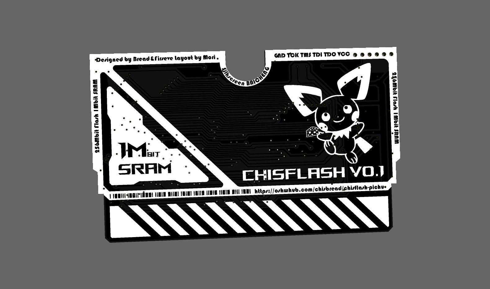

The card back features a Pichu silkscreen print.
Thanks to
@firseve for the mature SRAM circuit design and selection advice,
@mori for the excellent schematic design and layout,
@白橙's silkscreen design
