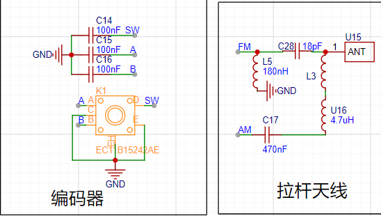

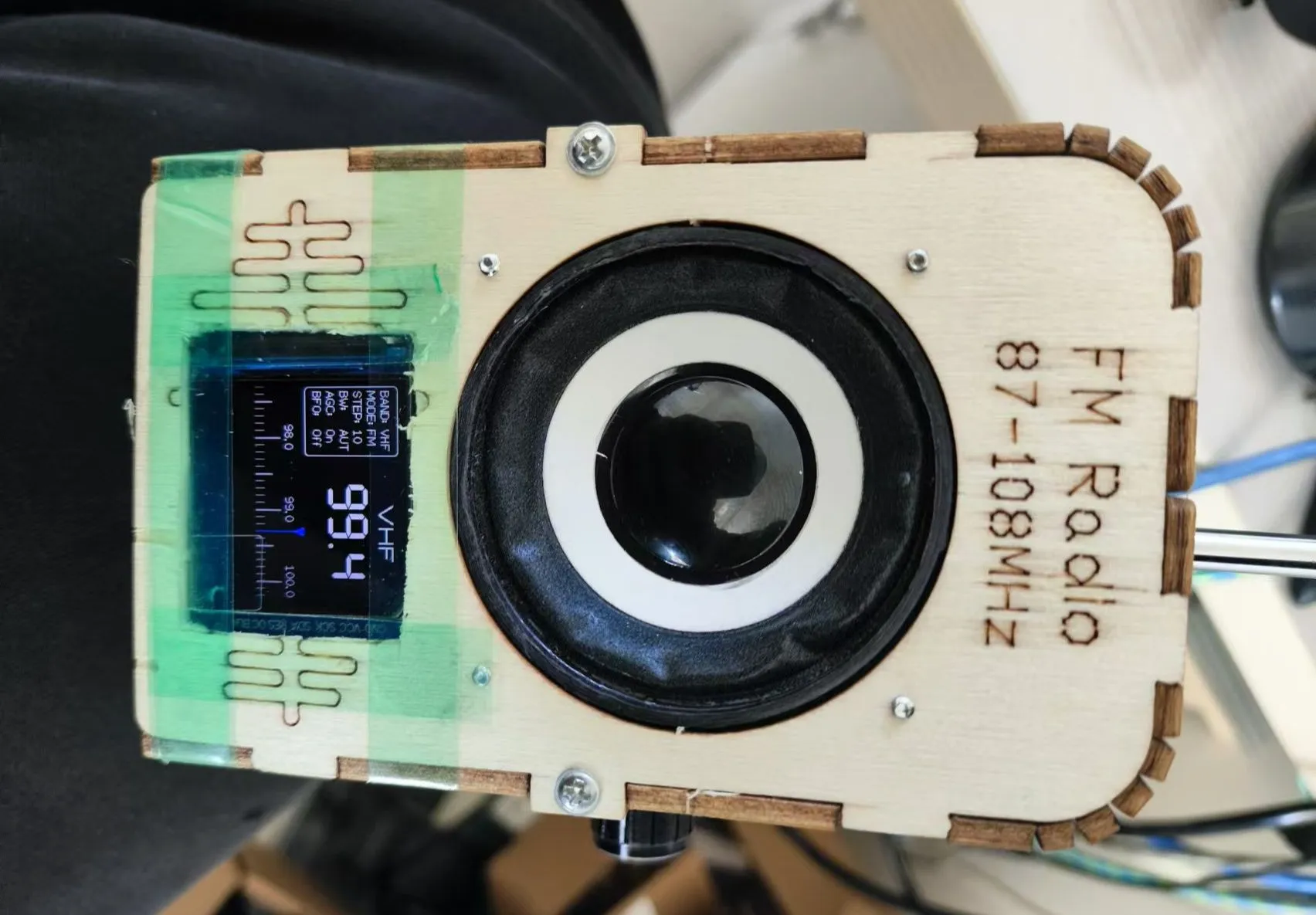

The radio supports FM, AM, and SSB, and the reception is currently quite good.
The front cover hole cutting failed; a 3D-printed front cover has been completed but hasn't arrived yet.
The screen display is incomplete and is still being modified.

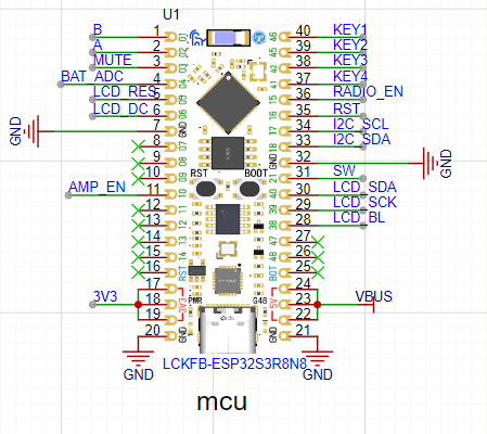

It uses a LCSC development board with
an ESP32R8N8

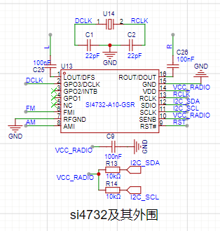

, an ME6217C33M5G power supply, and
an SI4732 peripheral circuit.

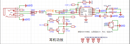

For the

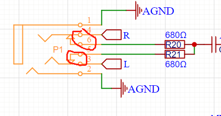

screen and headphone amplifier circuits,
if the headphone jack is not soldered, please short
the encoder and telescopic antenna
. Points of deficiency are welcome. Guidance is warmly welcomed.
