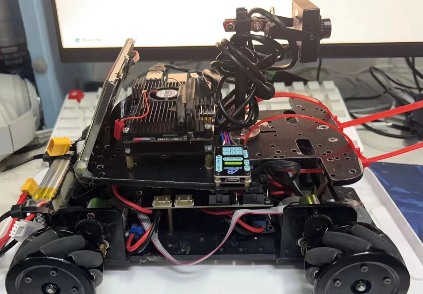

Project Introduction:
This is a McLaren car based on the STM32 SkyStar and Orange Pie.
The car software can be found on Github:
https://github.com/Chenpeizhe03/stm_car.git
. A video demo can be found on Bilibili:
https://www.bilibili.com/video/BV1MiyKYUEVj?vd_source=33af242665874bedfa0f8f94c2bd3778
. Project Functions
: 1. The Orange Pie acts as the host computer, using an industrial camera for recognition. It can run neural networks and upload video streams using Flask. The video stream can be viewed on a specified host using a computer or mobile phone on the same local network as the Orange Pie.
2. It reads data decoded from an Xbox and communicates with the STM32 via USB for human-machine interaction. The STM32 uses the FreeRTOS operating system for control, employing a quadrature encoder for speed closed-loop control and an IMU660RA gyroscope for angle closed-loop control. McLaren calculates and controls the car's omnidirectional movement.
3. Use the Taojingchi serial port screen for human-computer interaction, which mainly has two functions: 1. PID parameter tuning (speed loop, angle loop, position loop) 2. Self-test function (can check whether the motor, gyroscope, encoder, and XBOX data are normal)
