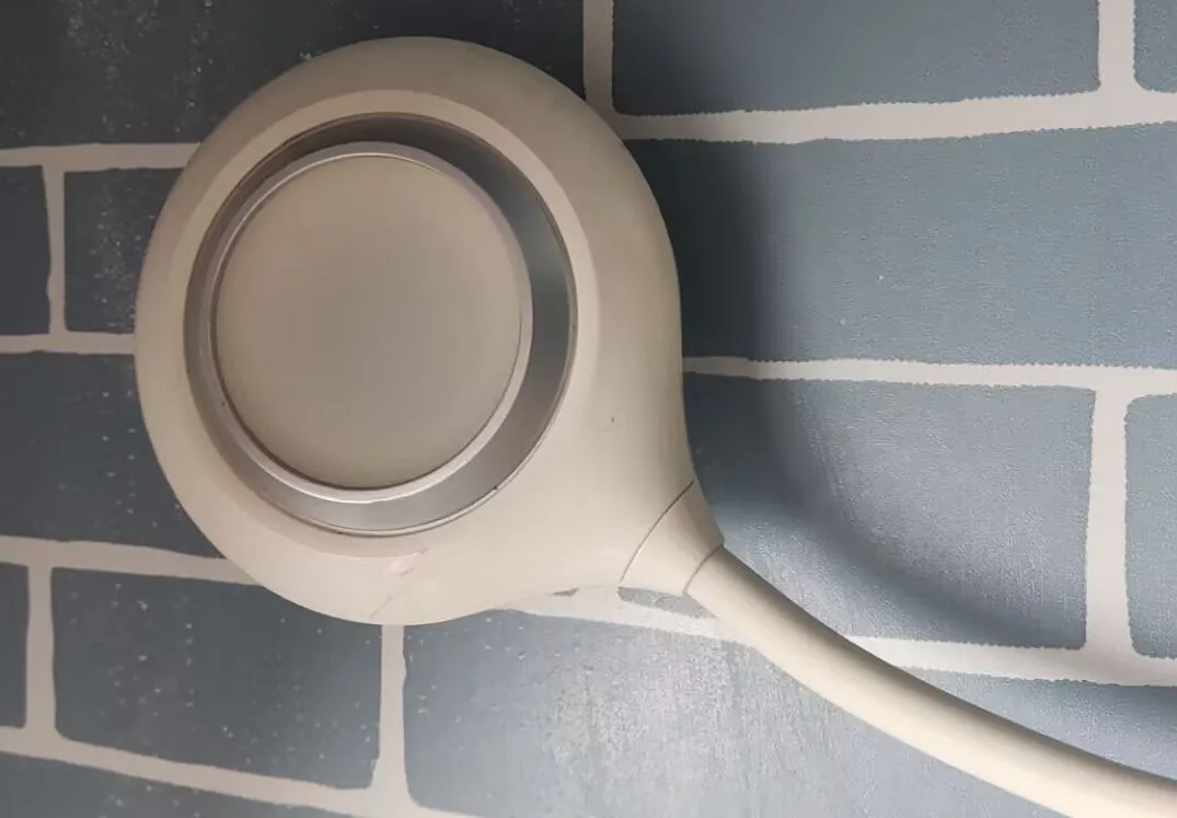

I. System Scheme
        1.1 Illumination Adjustment Circuit Scheme
   Scheme 1: Uses an STM32 microcontroller to generate a PWM signal, and the PWM output can be controlled and adjusted by a 100K potentiometer.
   Scheme 2: Uses a 555 timer to output a PWM signal, and the PWM output can be controlled and adjusted by a 100K potentiometer.
Scheme Selection: Scheme 1 is more expensive; Scheme 2 has a simpler circuit; considering all factors, Scheme 2 is chosen.
1.2 Power Supply Scheme
   Scheme 1: Uses an adjustable power supply. Scheme
2: Uses a combination of a battery pack, Type-C interface, and boost module.
Scheme Selection: Scheme 1, the adjustable power supply is not portable; Scheme 2, the desk lamp is a practical product and should prioritize user convenience, therefore dry batteries are considered for easy disassembly, or a Type-C interface for easy replacement; considering all factors, Scheme 2 is chosen.
1.3 Light Board Scheme
Scheme 1: Use strip light strip combination
Scheme 2: Use dot light board combination
Selection: Scheme 1, if the requirement is for uniform and stable brightness across the entire A4 paper area, with an illuminance difference of less than 5% between points, requires adding many light strips. The LEDs in the light strips are denser, resulting in higher power consumption and making it uneconomical and environmentally unfriendly. Scheme 2, with its smaller area, allows for more flexible distribution of dot light boards. It also allows for adding or changing the position of any light board at any location, and is easily customizable. Furthermore, the LEDs are not too dense, saving energy. Considering all factors, Scheme 2 is preferred.
1.4 Illuminance Display Scheme
Scheme 1: Use 4-digit LED display
Scheme 2: Use OLED screen
Selection: Scheme 1 can only display numbers; Scheme 2 can display text and other content, providing a better display interface. Considering all factors, Scheme 2 is preferred.
