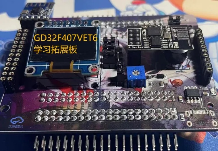

This expansion board is a learning expansion board based on the GD32F407VET6. It can be used by beginners to learn GD32 and master the use of related peripherals, laying the foundation for building projects. The source code implements the usage of onboard peripheral resources, controlled by macro definitions. Enabling different macro definitions allows you to see the specific phenomena.
The board has a variety of rich resources, including:
(1) SPI OLED
(2) 2.8-inch LCD
(3) ESP01-S
(4) EEPROM 24C64
(5) Bluetooth module
(6) Buzzer
(7) Type-C serial port
(8) ADC potentiometer
(9) Buttons
Onboard peripheral module usage:
(1) SPI OLED
software: SPI basic display
(2) 2.8-inch LCD
software: Simulate 8080 LCD display
(3) ESP01-S:
AP mode and STA mode .
AP mode: Send data to the microcontroller via mobile phone connection.
STA mode: Connect to Alibaba Cloud, and Alibaba Cloud can issue commands to control the LED
(4) EEPROM 24C64
: Read data
(5) Bluetooth module:
Control LED via Bluetooth.
(6) Buzzer
: The buzzer sounds a prompt.
(7) Type-C Serial Port
: Data can be sent and received with the host computer via a Type-C data cable.
(8) ADC Potentiometer
: The input voltage can be adjusted by adjusting the potentiometer.
(9) Button:
Used to control custom functions.
(10) LED Indicator:
Two-way LED indicator
principle analysis (hardware description)
1. Expansion Pin Header:
All pins are brought out through the pin header for easy expansion
. 2. SPI OLED: The
OLED is connected to the hardware SPI pin for easy use of software/hardware SPI driver
. 3.
LCD: CN1 of the LCD is connected to the FMC interface, and CN2 is connected to the SPI. The display can be driven by 8080 or SPI through FMC.
4. ESP01S
Communication Connection: Serial port PB10/PB11.
5. EEPROM:
SCL and SDA are pulled up to VCC for easy use of hardware IIC and configuration of open-drain output.
6. Bluetooth Module :
The Bluetooth module is connected to the serial port.
7. BEEP
Buzzer: Connect the buzzer to PC8 through a jumper cap, or connect it to other pins through a curved jumper cap. PC8 has PWM
. 8. Type-C CH340N
connects to Type-C, allowing direct connection to a computer using a Type-C cable. CH340N is also compatible with the best soldering .
9. Potentiometer:
The potentiometer is connected to 5V via a jumper cap for voltage input measurement.
10. Buttons: The board
has four buttons. Since there is no hardware pull-up, a pull-up input needs to be configured.
11. LEDs:
Two LED indicators are connected to fixed pins via jumper caps, or DuPont wires can be used.

Notes:
This section can be used to fill in points that require special attention during design and production, or areas prone to errors. Examples:
1. The color silkscreen printing was unclear; this has been corrected in the project
. 2. It is recommended to solder the four fixing pins of the Type-C port on both sides. I accidentally removed mine, damaging the circuit board and causing communication errors. Actual
product images :
