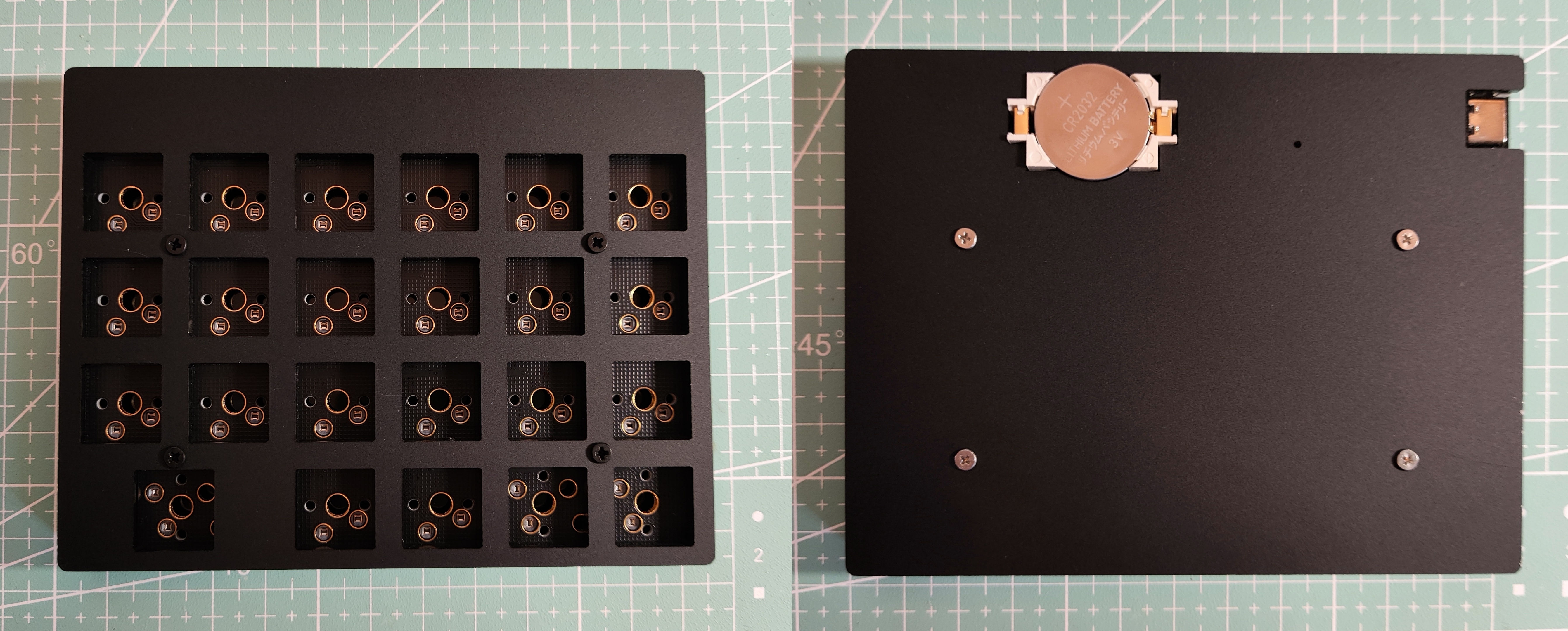

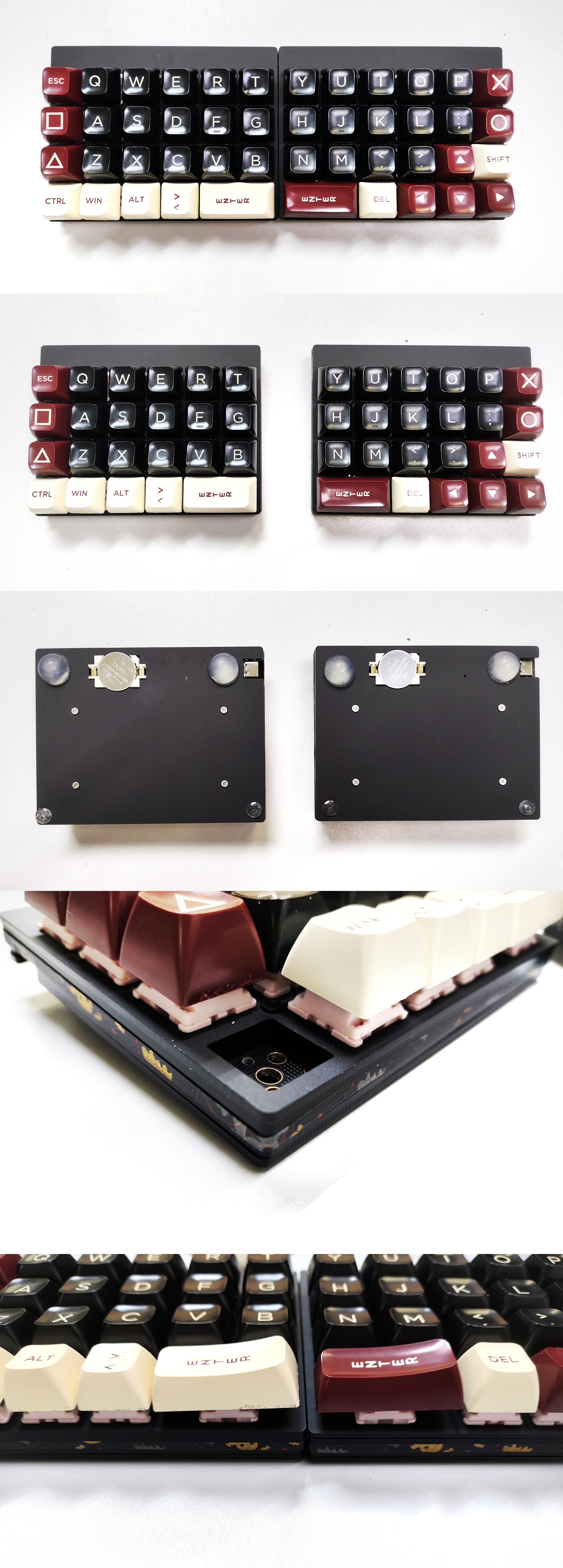

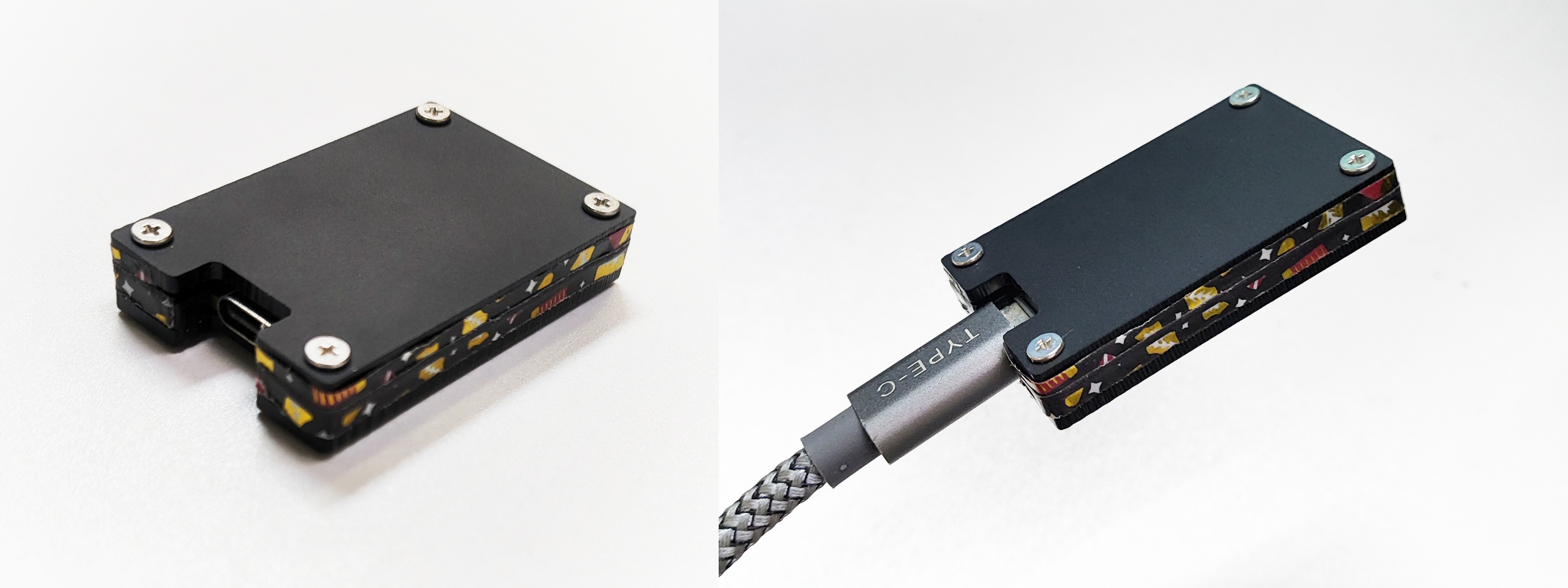

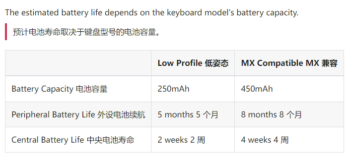

The shell is made of stacked acrylic, and the thickness after assembly is approximately 1.1cm. The PCB side will be exposed; you can use washi tape to cover the bleed lines.

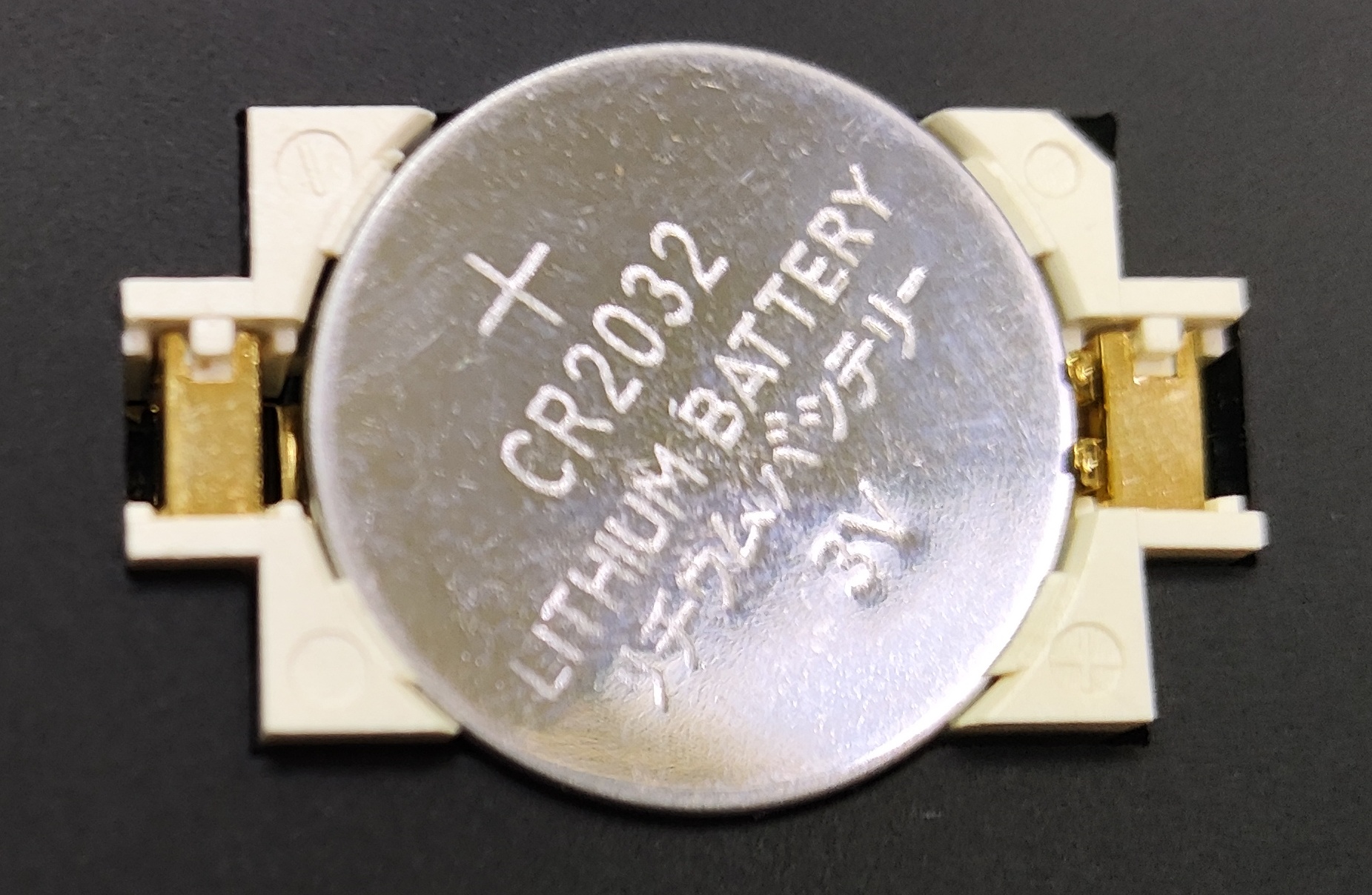

The PCB is compatible with lithium batteries and CR2032 button batteries, but currently only a button battery version of the shell has been made.
Main Control Board: The
main control board is ProMicro NRF52840, also known as SuperMini NRF52840, which can replace Pro Micro, Nice!Nano, nRFMicro, etc.
Related materials: I, II.

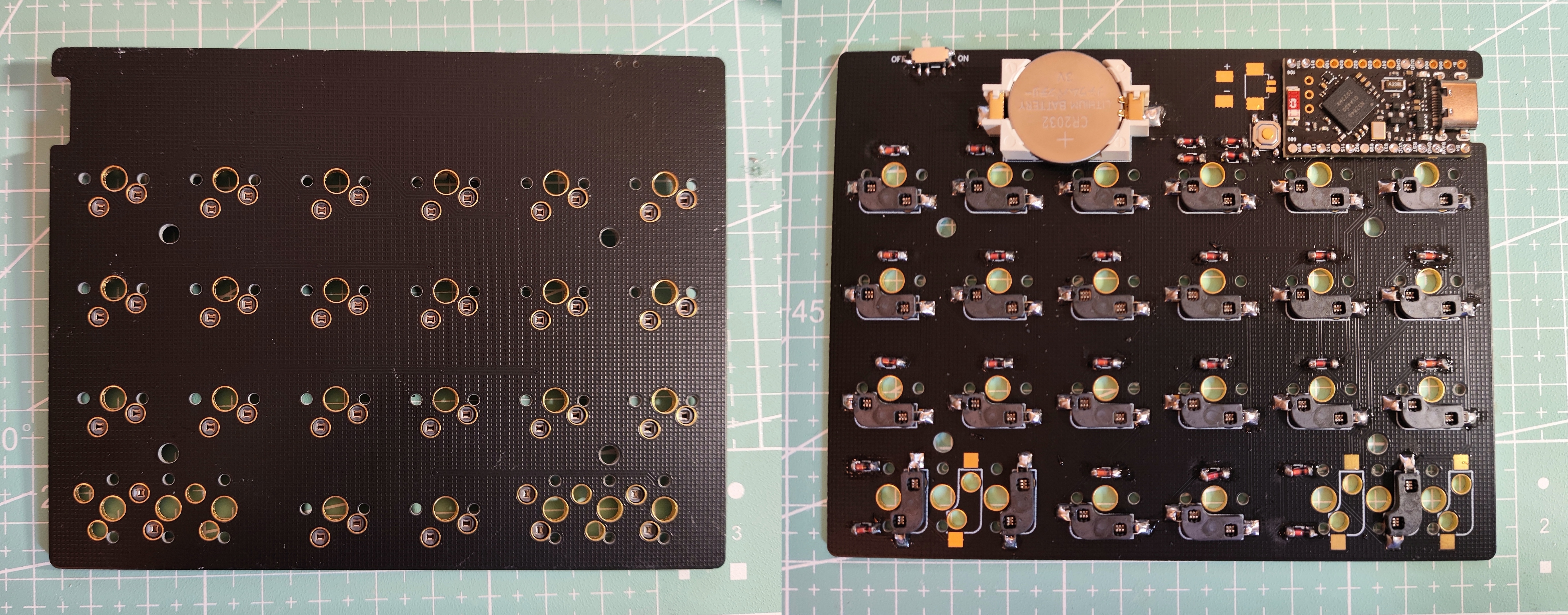

The main control board is directly soldered onto the PCB to reduce thickness (the holes in the upper half, except for the leftmost one and the two GND holes, can be left unsoldered):
The PCB
is the same for both sides. Compatible with 2U space.
If using a lithium battery, the power switch must be turned on during charging.
Soldering order: Diodes and hubs in the first row -> Reset button, power switch -> Battery holder (optional) -> Main control board -> Remaining diodes and hubs

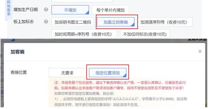

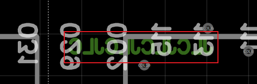

The "JLCJLCJLCJLC" on the board is used to specify the customer-designed printing position during PCB fabrication (no need to confirm the production draft). It can be deleted if not fabricating with JLCPCB:

uses ZMK firmware.
Bluetooth connection supports 5 devices by default. Switch devices via buttons. See the official documentation: Bluetooth, Bluetooth Behavior for details. Two firmware versions were created:
4x12_Split (Wired & Bluetooth Dual Mode): This uses a pair of keyboards as separate keyboards. The left keyboard is the central device, and the right keyboard is the peripheral device (the right keyboard sends signals to the left keyboard, which then sends them back to the host). The right keyboard can only be used when the left keyboard is switched on; the right keyboard does not support wired mode. By default, only the left keyboard's battery level is displayed (see the official documentation: Battery Level). You can enable the option to display the right keyboard's battery level in the configuration file (this firmware already has this option enabled) and check the right keyboard's battery level using battery display software (such as ZMK Split Battery). The right keyboard consumes less power than the left keyboard. The corresponding firmware needs to be flashed separately for each keyboard, and then each keyboard needs to be reset to pair. 4x12_Split_Dongle (2.4G & Bluetooth Dual Mode): Essentially a three-part keyboard: a ProMicro NRF52840 development board is used as the central device (i.e., receiver), and the left and right keyboards are used as peripheral devices. The receiver can be plugged into a computer via a data cable or an A-to-C adapter to use the keyboard on computers that do not support Bluetooth (similar to 2.4G). It can also be connected to a charger or battery case to use Bluetooth. The input voltage should be below 5V. A Google search for "zmk dongle" will find more information, such as: zmk-enki42-dongle, SliceMK Docs - Dongle vs Dongleless. A schematic of the receiver's acrylic casing is provided at the end of this document. Power consumption difference between the central and peripheral devices (via SliceMK Docs): Receiver (casing schematic attached): (The sample height was miscalculated, resulting in a gap, so it was sealed with washi tape). - Tutorials on compiling firmware online via GitHub can be found in the official documentation: Installing ZMK. Firmware writing tutorials can be found in the official documentation: New Keyboard Shield. Many keyboard firmware source codes are also available in the official repository for reference. You can set sleep time, battery display, and other items in the conf file: - ZMK Studio now supports real-time key remapping in wired and Bluetooth modes, but the software is still in beta, with very limited functionality, cumbersome operation, and bugs, so its use is not recommended. (October 2024) It is recommended to use Keymap Editor in conjunction with GitHub for online key remapping. Website information can be found at: Keymap Editor WIKI. Each key remapping requires recompiling and flashing the firmware. (The firmware provided here only has a basic letter layer and is for testing purposes only.) Clicking this option allows you to quickly modify key values ​​using an existing keyboard (pressing a key on the keyboard will automatically fill the corresponding key in the selected cell): --- Keyboard Shell - Button Battery Version: (The drawings are for a single keyboard; if you want to make a split keyboard, you need to cut it into two parts.)  4 acrylic panels. Color annotations can be changed using CAD. There are three versions: left spacebar, right spacebar, and full 1U. The difference lies only in the top two panels (i.e., the positioning panels). Receiver Housing: --- Materials List Keyboard: Item No. Name Quantity Reference Diagram Remarks 1 Switch Number of Keys 2 Surface Mount Diode (1N4148 LL34 1206) Number of Keys 3 Kailh Hot-swappable Switch Number of Keys 4 ProMicro NRF52840 Development Board 2 5 MSK-12C02 Miniature Toggle Switch (Horizontal) 2 Handle Length 1.5mm 6 4*4 Tactile Switch 2

Thickness below 4mm (choose either lithium battery or button battery holder);
8.
CR2032 BS-6 button battery holder;
