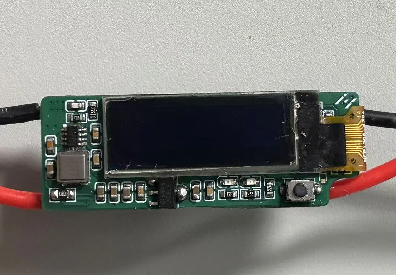

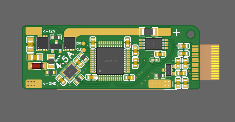

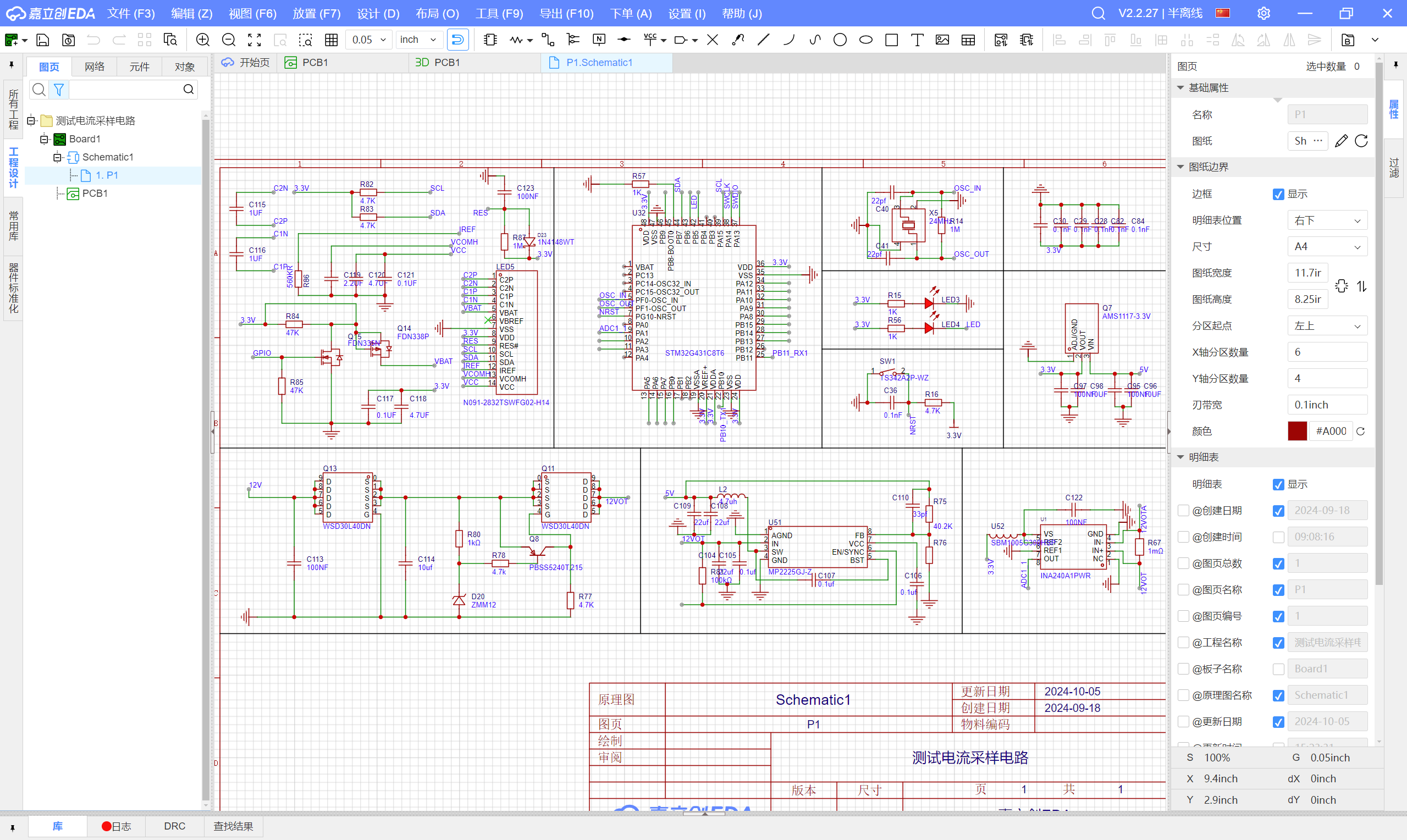

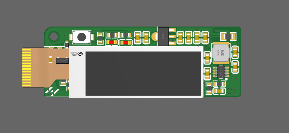

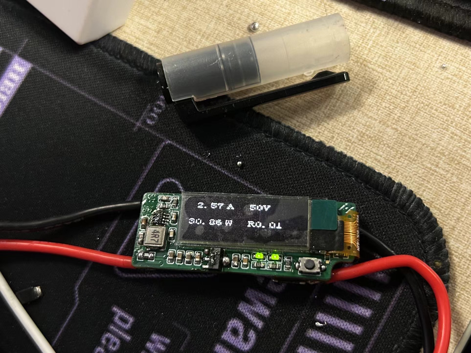

Project Introduction
This power meter is used to test the feasibility of FOC current sampling schemes. It features 12V to 5V, 5V to 3.3V conversion, reverse connection protection, overvoltage protection, and OLED display of system information.
Project Functionality
This design is a current sampling system based on the STM32G431C8T6 microcontroller. The software includes a filter, allowing a maximum current of approximately 4A~4.5A through a 12V input.
Project Parameters
Main Peripherals: STM32G431C8T6 main control chip, INA240A2PWR current sampling chip, and step-down chip, etc. The detected current is displayed on an OLED screen for user observation.
Principle Analysis (Hardware Description)
