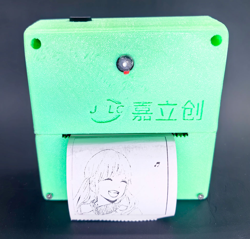

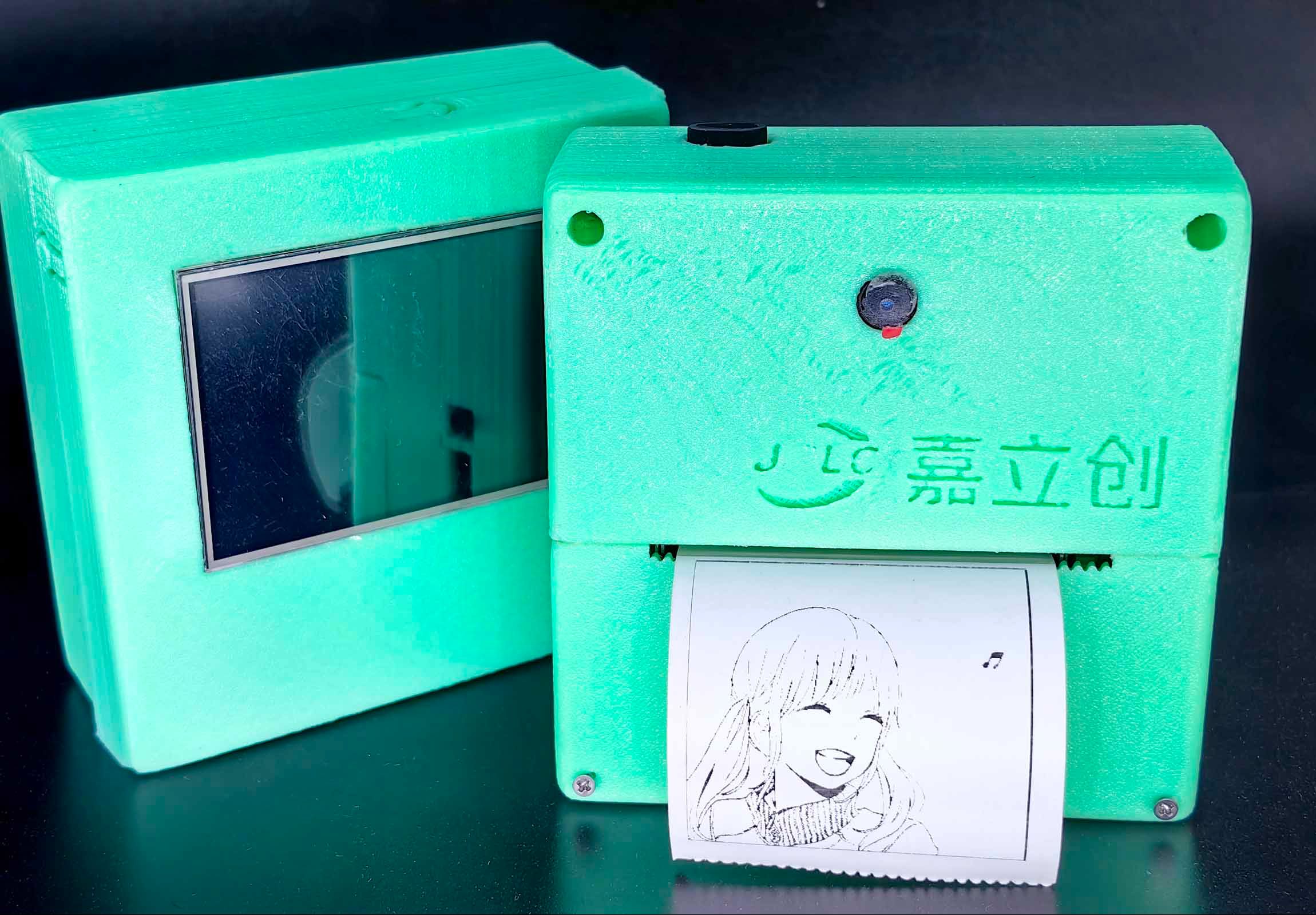

Project Description:

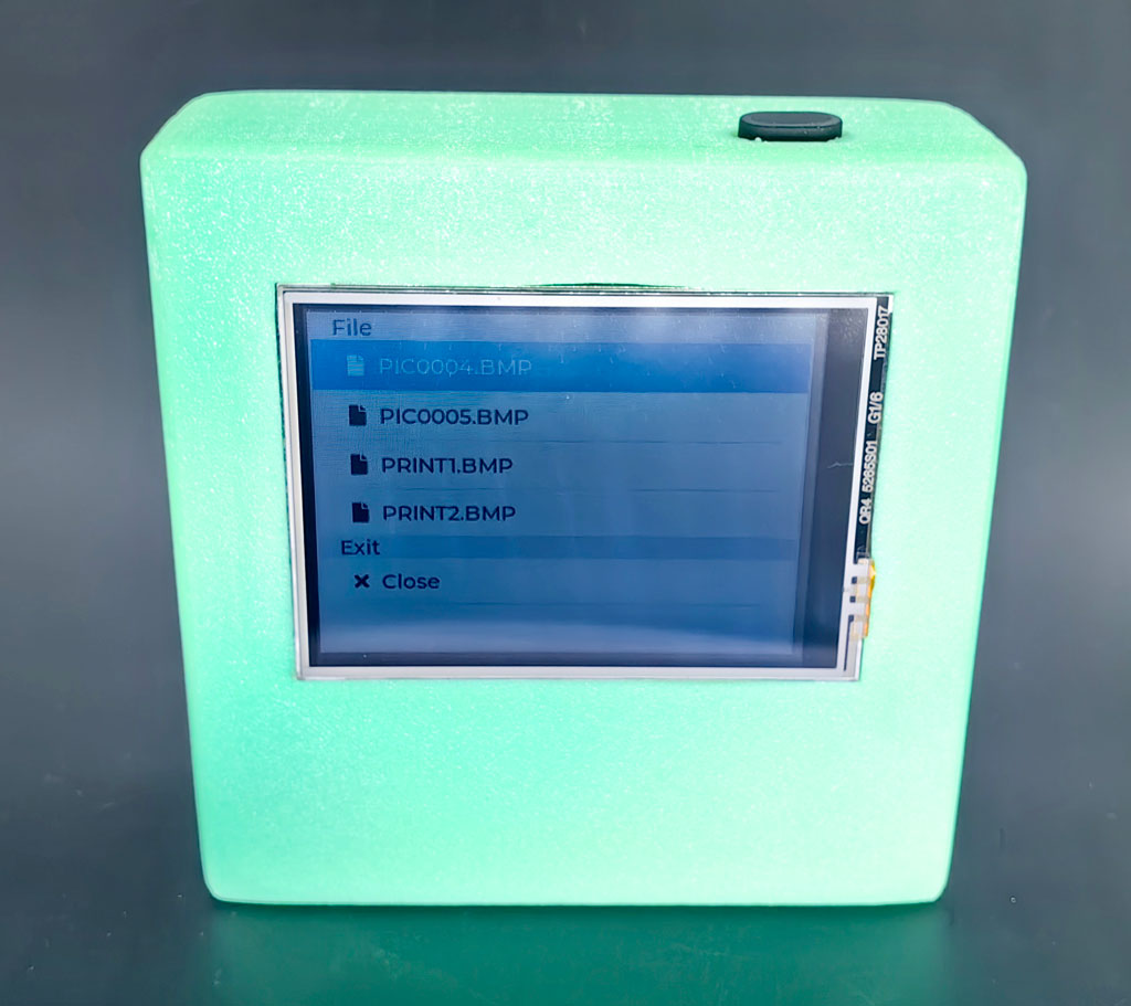

The main controller uses an STM32 microcontroller, with LVGL8.2 ported.
It features a 2-megapixel camera for photo capture.
A 2.8-inch TFT LCD screen with a resolution of 240×320 displays photos, enabling display, printing, and deletion.
A built-in thermal printing unit allows for photo printing.
It has a built-in 500mAh lithium battery with a built-in charge/discharge management panel. No external power supply is required; it is compact and portable.
Operation is convenient with a dial button, along with a power on/off button and a shutter button.
It supports timed sleep mode, one-button sleep and wake-up to reduce power consumption.

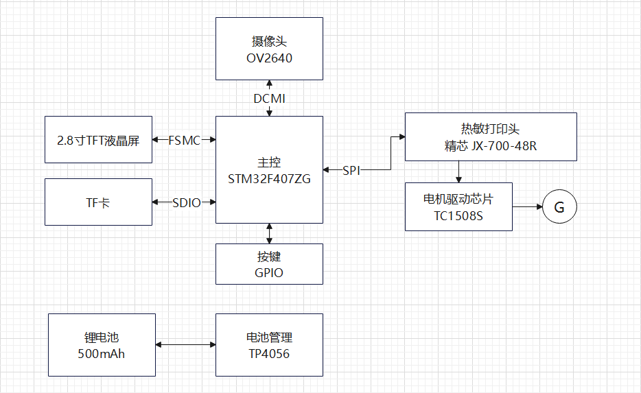

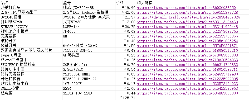

Hardware design
: Main controller: STM32F407ZG.
This microcontroller was chosen because the STM32F4 series offers excellent computing power and real-time response capabilities. It can provide sufficient IO and resource support for the camera, screen, memory card, thermal printhead, battery management, button control, etc. in the project.
Screen: 2.8-inch TFT LCD screen.
This 2.8-inch screen has a resolution of 240*320, offering good display quality while maintaining a compact size. Connecting to the STM32 controller via FSMC simplifies circuit design and wiring, reducing system cost and complexity.
Camera: OV2640 camera module.
This 2-megapixel camera not only offers excellent cost-effectiveness but also fully meets the image acquisition requirements of this project. Connecting to the STM32 controller via DCMI provides high-speed data transmission capabilities.
Thermal printhead: Jingxin JX-700-48R.
When designing an instant camera, image printing is crucial; it needs to be compact, lightweight, and have low power consumption, making thermal printing an excellent choice.
Battery Management: TP4056
The TP4056 employs a constant current/constant voltage (CCCV) charging mode, automatically completing the entire charging process, including trickle pre-charging, constant current fast charging, and constant voltage charging stages, effectively ensuring battery health and long lifespan.
Software Design
: Software Interface:
Due to space limitations, only some key code snippets are explained here.

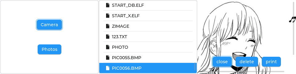

Thermal Printing Function Implementation:
When the system detects a print button press, it retrieves the path to the current image and calls the following function. This function reads a BMP image file from the given path and converts it to the thermal printer's data format for printing.
static void PrintFile(char *path)
FRESULT res;
FIL file; // File object
UINT br; // Number of bytes actually read
uint16_t line = 0; // Current line number
uint16_t lineDateTemp[384]; // File content cache, save one line of image data
res = f_open(&file, path, FA_READ);
if (res != FR_OK)
printe("File opening failed
/* Get image information from BMP header */
BITMAPINFO hbmp;
res = f_read(&file, &hbmp, sizeof(BITMAPINFO), &br);
if (res != FR_OK)
printe("File reading failed
uint32_t bfOffBits = hbmp.bmfHeader.bfOffBits; // Bitmap data offset
uint16_t w = hbmp.bmiHeader.biWidth; // Image width in pixels
uint16_t h = hbmp.bmiHeader.biHeight; // Image height in pixels
printi("Bitmap data offset: %d, width: %d, height: %d.
", bfOffBits, w, h);
f_lseek(&file, bfOffBits); // Move the file pointer to skip the BMP file header
memset(lineDateTemp, 0xFF, sizeof(lineDateTemp)); // Line data points are white by default
do{
res = f_read(&file, lineDateTemp, w*2, &br); // Read 1 line of pixels at a time, 16 bits, 2 bytes per pixel
if(w < 384) // Image width is less than print width
memmove(lineDateTemp + (384 - w)/2, lineDateTemp, w*2); // Move the entire data to keep the image centered
memset(lineDateTemp, 0xFF, (384 - w)/2); // Fill with white
if(res != FR_OK)
printf("File read failed
break;
uint8_t printLine[48]; // Print 48 bytes of data per line
for(uint16_t i = 0;i < 384;i+=8) // Process the current DOT point, print width
uint8_t packedByte = 0; // Merge 8 binary pixels into one byte
for(uint8_t j = 0;j < 8;j++) // 3. Merge 8 binary pixels (1 bit per pixel) into one byte
uint8_t gray = RGB565ToGray(lineDateTemp[384 - i - j]);// 1. Convert RGB565 format to grayscale, uint16_t => uint8_t
packedByte |= GrayToBinary(gray, 127) << (7 - j); // 2. Binarize based on grayscale value, threshold is 128
if(j == 7)
printLine[i/8] = packedByte; // 4. Add the processed data to the print array and wait for printing
printf("Print line%d
",line);
LinePrint(printLine);
if (res != FR_OK)
printf("f_lseek err
line++;
}while(br > 0);
PrinterStep(80);//Printed paper length
StopPrint();
f_close(&file);

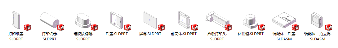

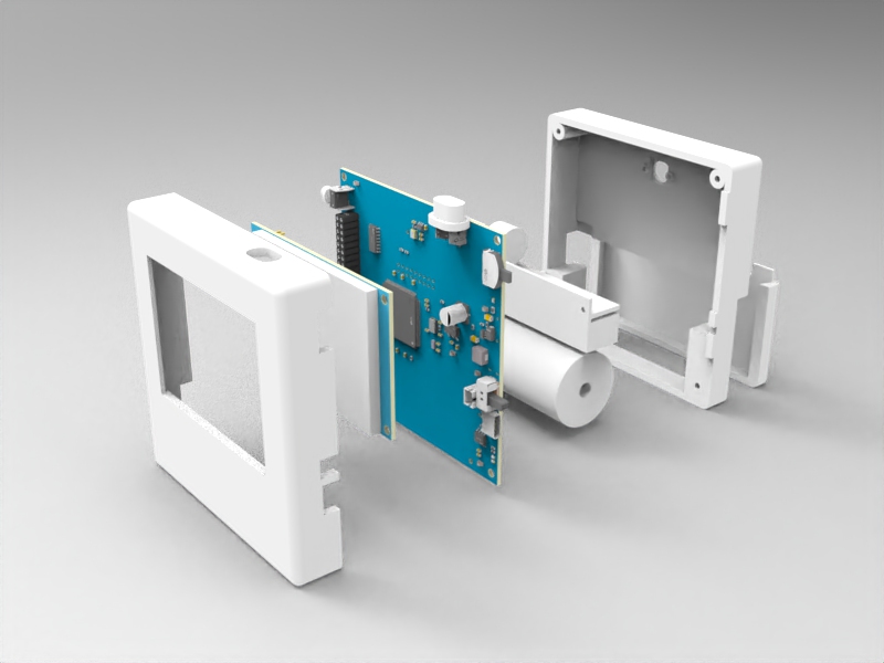

Structural design
physical demonstration
and material procurement
tables can be downloaded from the attachment.
