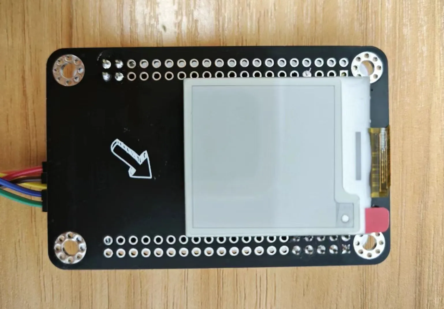

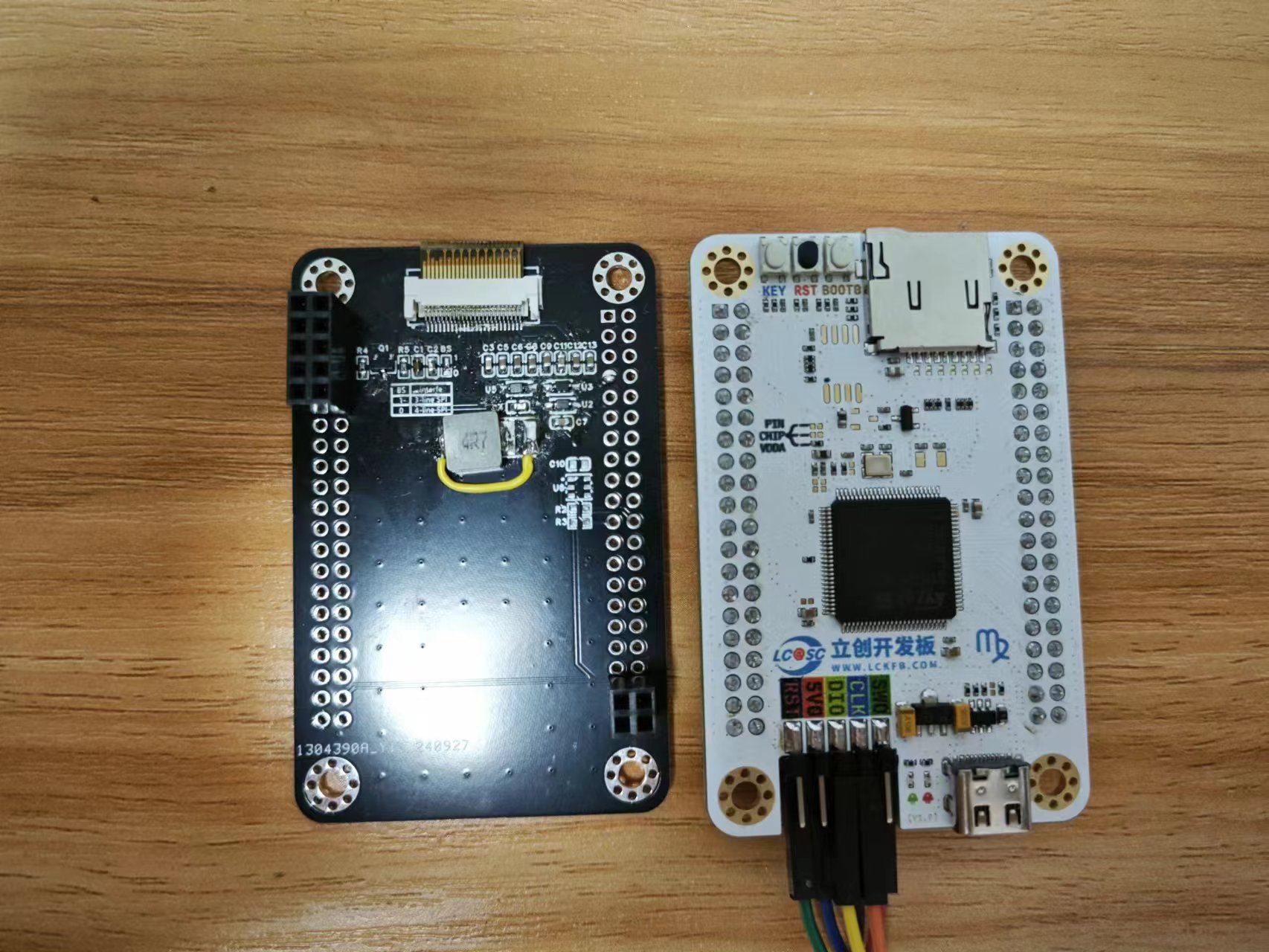

This is a 1.54-inch e-ink display, based on the Liangshanpai-SkyStar development board,
displaying a perpetual calendar, temperature, humidity, and air quality.
It's used for learning from the SkyStar STM32F407 development board and for circuit verification of the Orient Display 1.54-inch e-ink screen
. The circuit design is complete, but the inductor used had an incorrect package, requiring flying wire soldering.
The e-ink IC is the SSD1681, the same IC used in the Waveshare 1.54-inch e-ink screen. The Waveshare 1.54-inch e-ink driver has been ported, but the screen still doesn't light up. Further investigation is needed to determine if it's a hardware or software issue.
