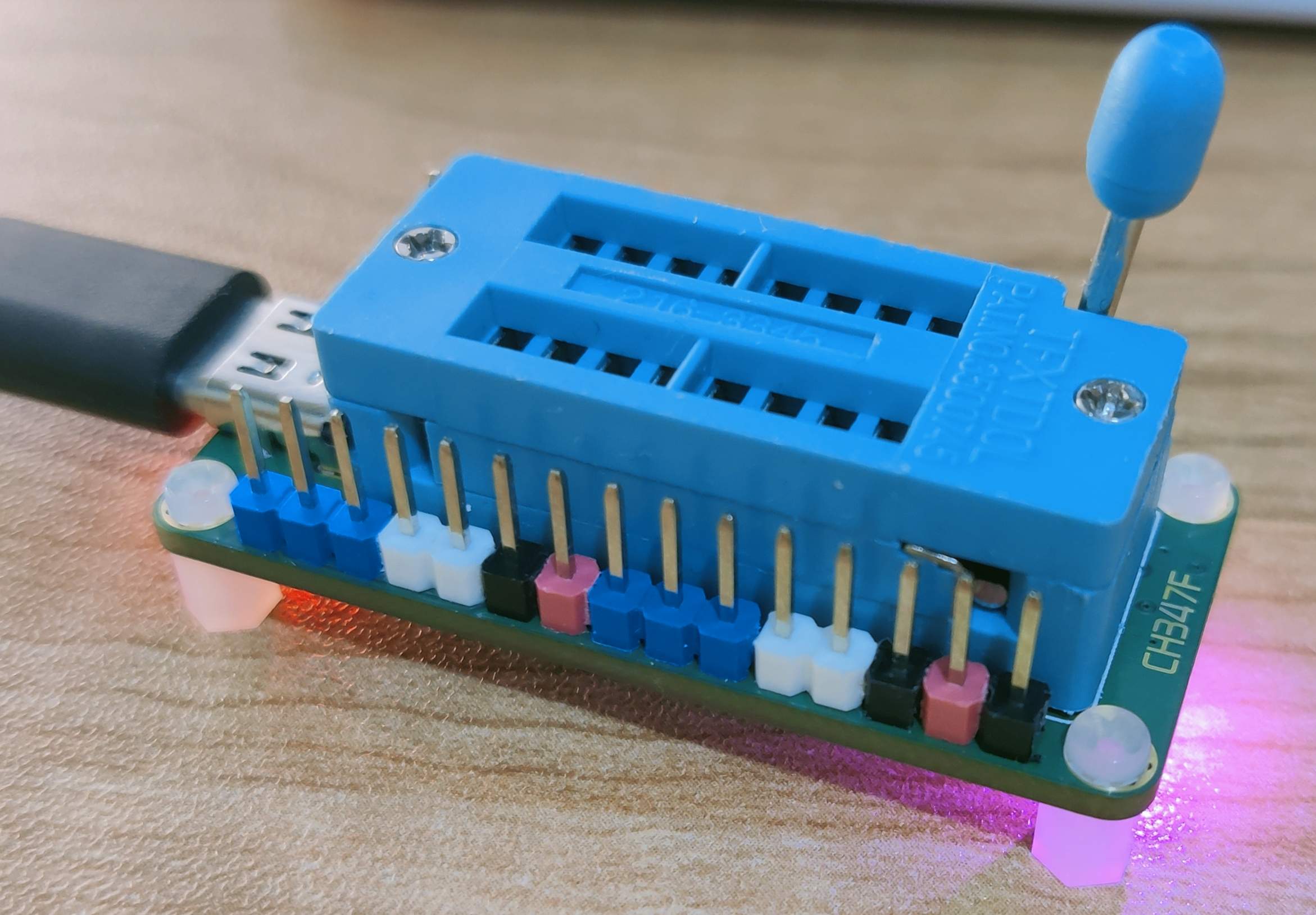

CH347F Multi-Voltage Programmer (UART+I2C+SPI+JTAG+SWD Debugger)
The
CH347 is a high-speed USB bus adapter chip that provides asynchronous serial ports, I2C synchronous serial interfaces, SPI synchronous serial interfaces, and JTAG interfaces via the USB bus.
In asynchronous serial port mode, the CH347 provides two high-speed serial ports, supporting RS485 serial port transmit/receive enable control, hardware flow control, and common modem handshake signals. It is used to expand asynchronous serial ports for computers or to directly upgrade ordinary serial devices or MCUs to the USB bus.
In synchronous serial interface mode, the CH347 provides one 2-wire I2C interface (SCL line, SDA line) and one 4-wire SPI interface (SCS line, SCK/CLK line, MISO/SDI/DIN line, MOSI/SDO/DOUT line). It is used to expand 2-wire or 4-wire synchronous serial interfaces for computers to operate EEPROM, FLASH, and sensors.
In JTAG interface mode, the CH347 provides one JTAG interface, supporting 4/5/6-wire interfaces (TMS line, TCK line, TDI line, TDO line, TRST line, and SRST line), used to expand the JTAG interface for computers and operate devices such as CPUs, DSPs, FPGAs, and CPLDs.
In SWD interface mode, the CH347 provides one SWD interface (SWDCLK line, SWDIO line), used to expand the SWD interface for computers and operate devices such as ARM MCUs and CPUs.

The CH347F supports independent I/O power supply, supporting 3.3V, 2.5V, and 1.8V power supply voltages.
The CH347F does not require configuration of operating modes and supports high-speed serial ports, I2C, SPI, JTAG, and SWD interfaces. The functions of multiplexed pins can be switched and controlled through the driver.
The CH347T chip configures its operating mode by detecting the voltage levels of the DTR1 (PIN10) and RTS1 (PIN13) pins during reset.
See the official manual for details: https://www.wch.cn/products/CH347.html.
